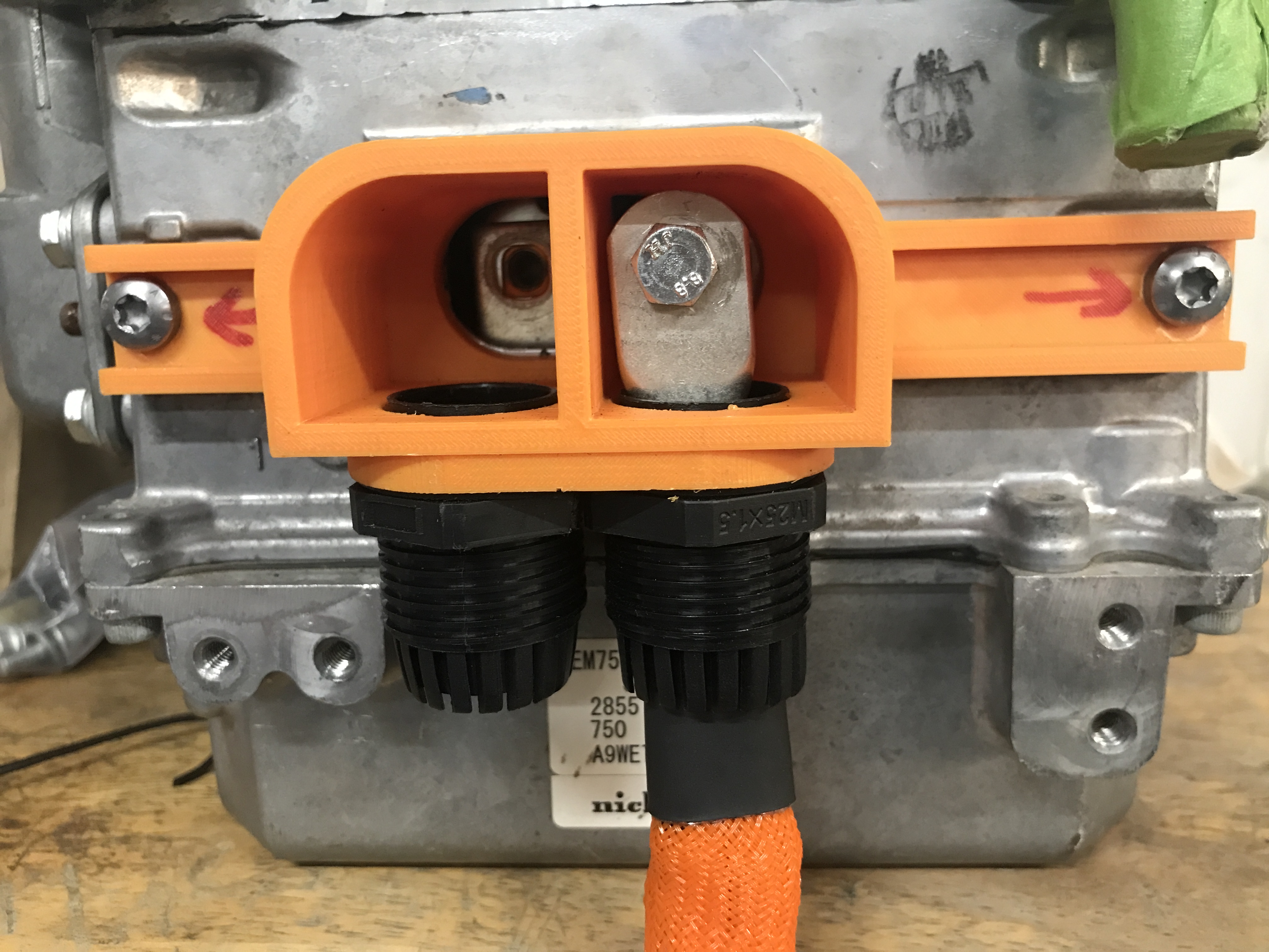

well I am big on repurposing OEM stuff like cables, Safety Boxes, brackets, etc. so this project started with me wanting to figure out a way to connect the BMW Safety box directly to an Inverter (the Lexus GS450 heitch in my case, but it does not really matter) I wanted cables with ring terminals like the EV gods intended not some orange plastic Ls
  • I wanted the output cables from the safety box to be longer
  • I wanted them to have ring terminals on the ends
  • and as a bonus I wanted the ability to add another lead to the plug

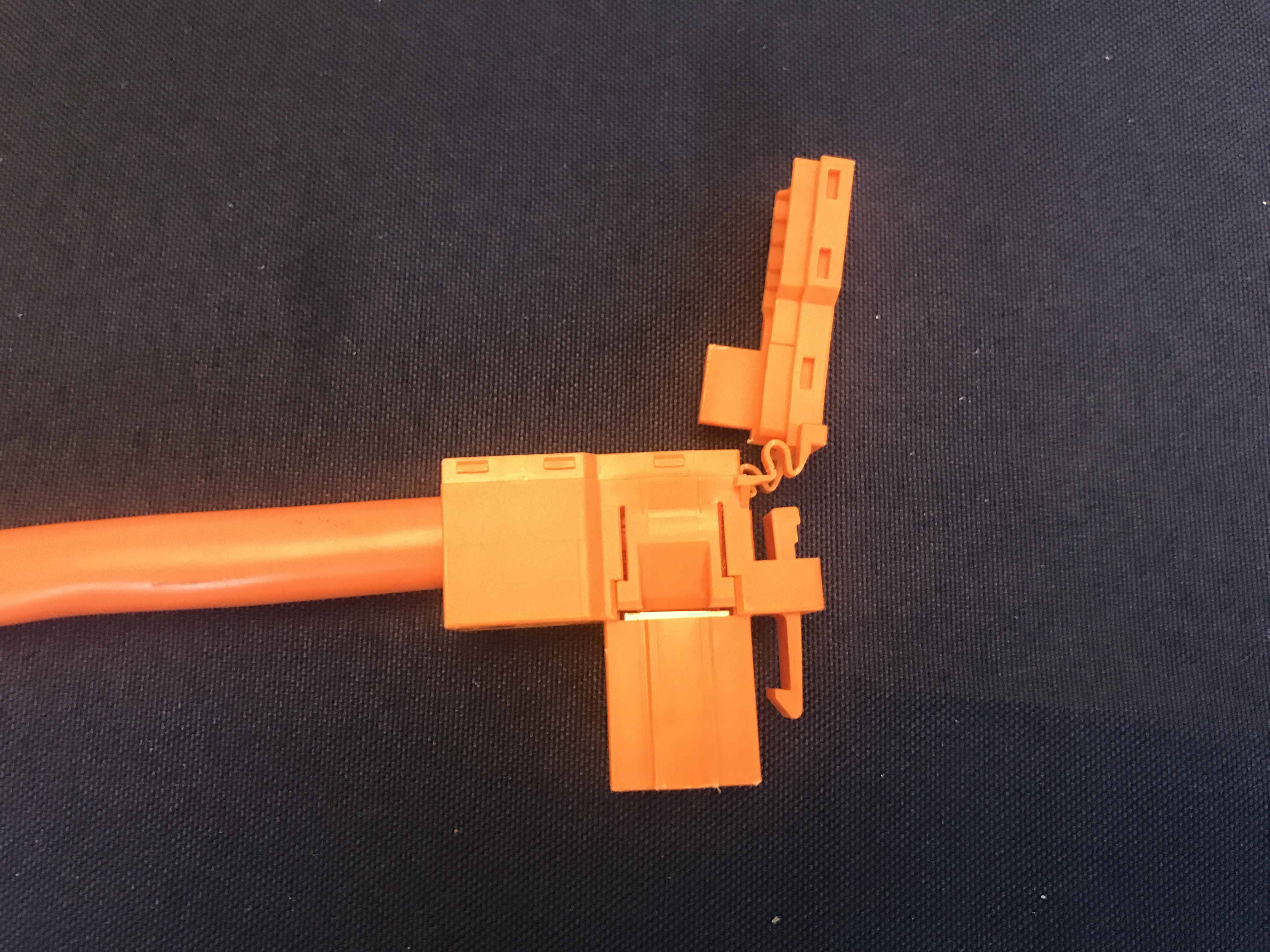

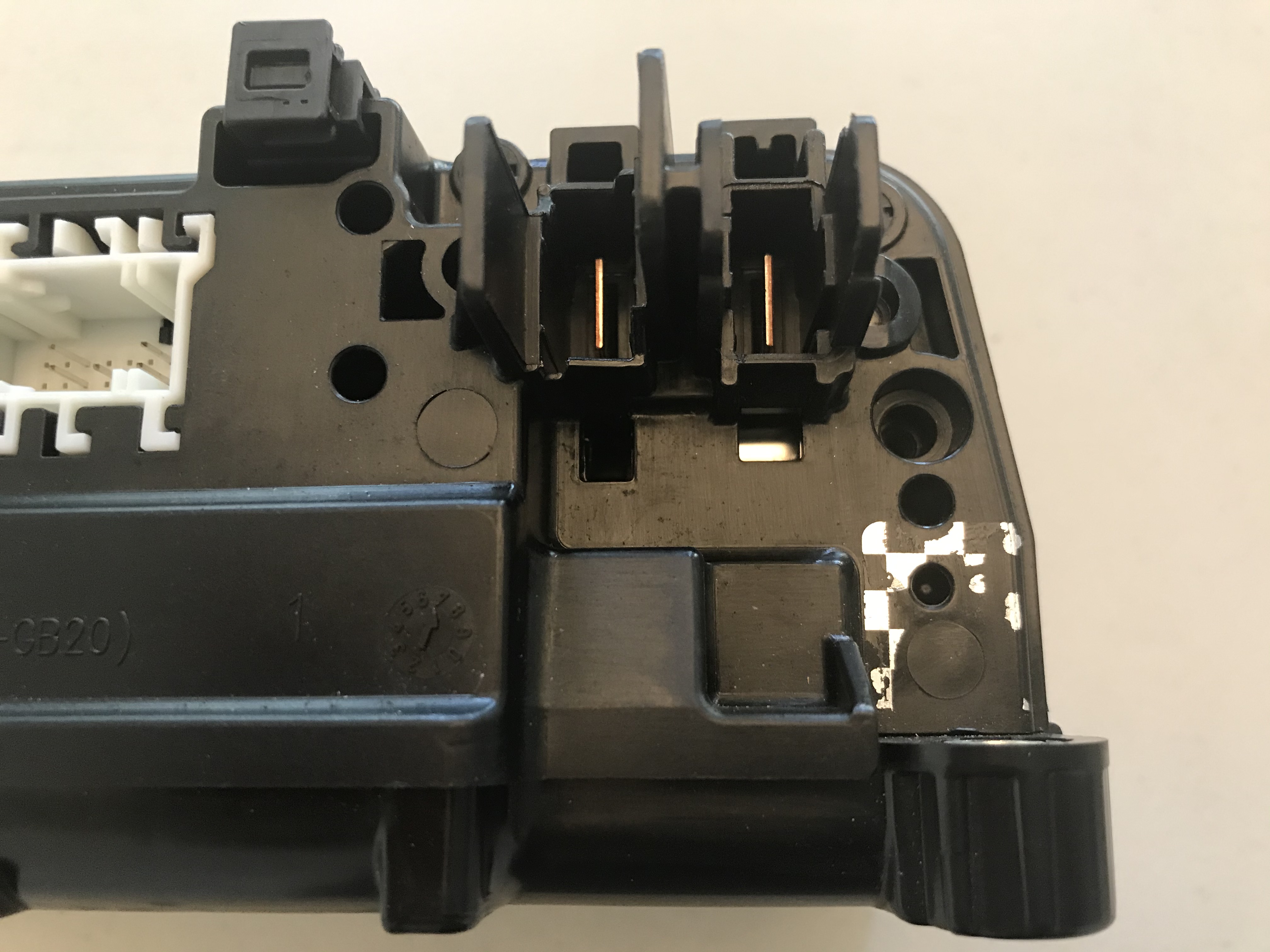

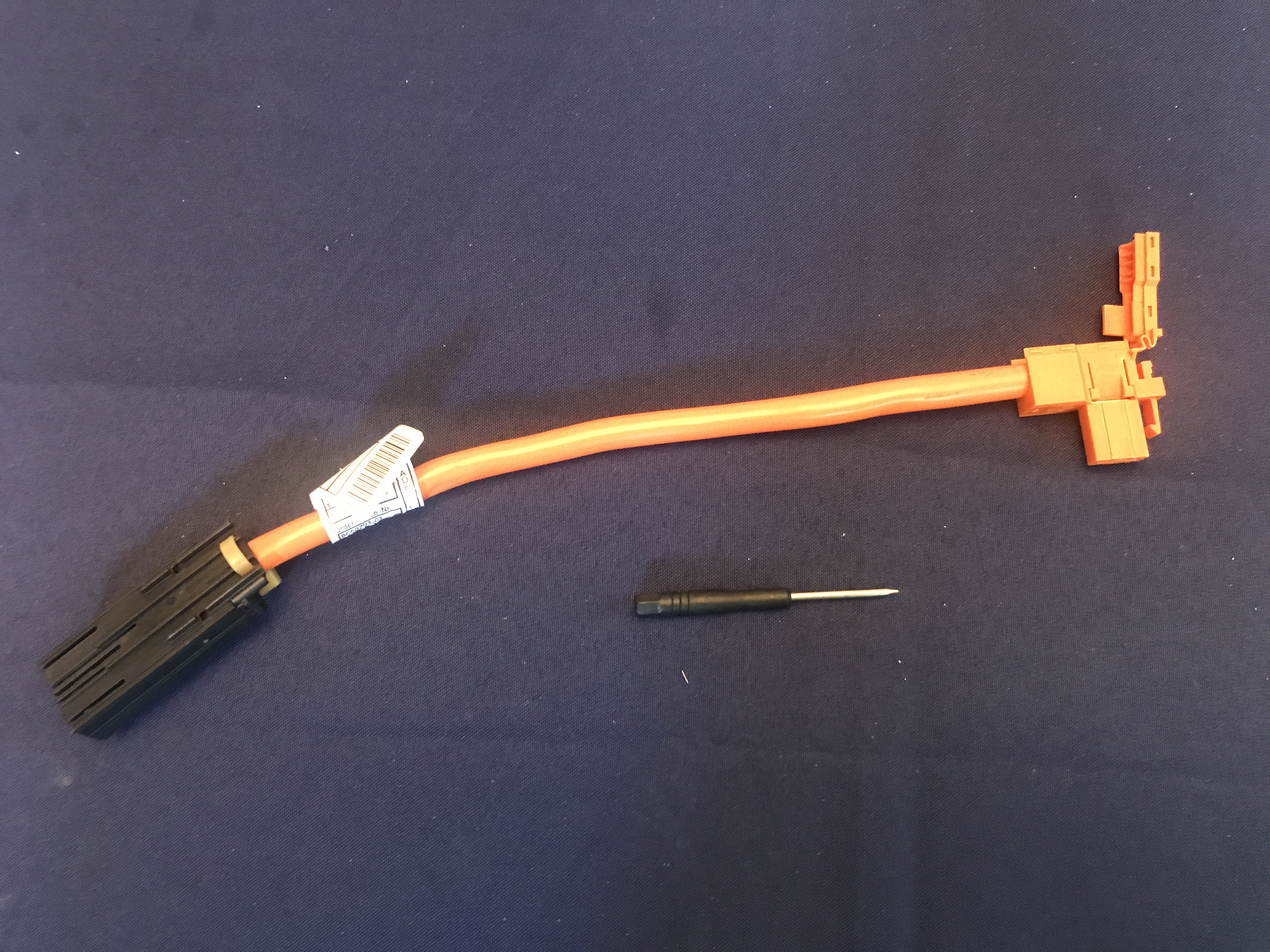

The safety box sports two kinds of connector types or styles, the outside ones are different from the inside ones
Re: BMW Hybrid Battery Cable Connectors Reconfigured Rekeyed
Posted: Wed Jul 12, 2023 12:54 am
by Gregski
What if we swapped the orange connectors from the inside wires to the outside and vice versa? Is it possible? are the guts the same? But why, so that we could use the much longer leads from the actual modules as our Safety Box new output leads, therefor eliminating the need for that external square bulky OEM connector.
let's start with the Output Positive lead

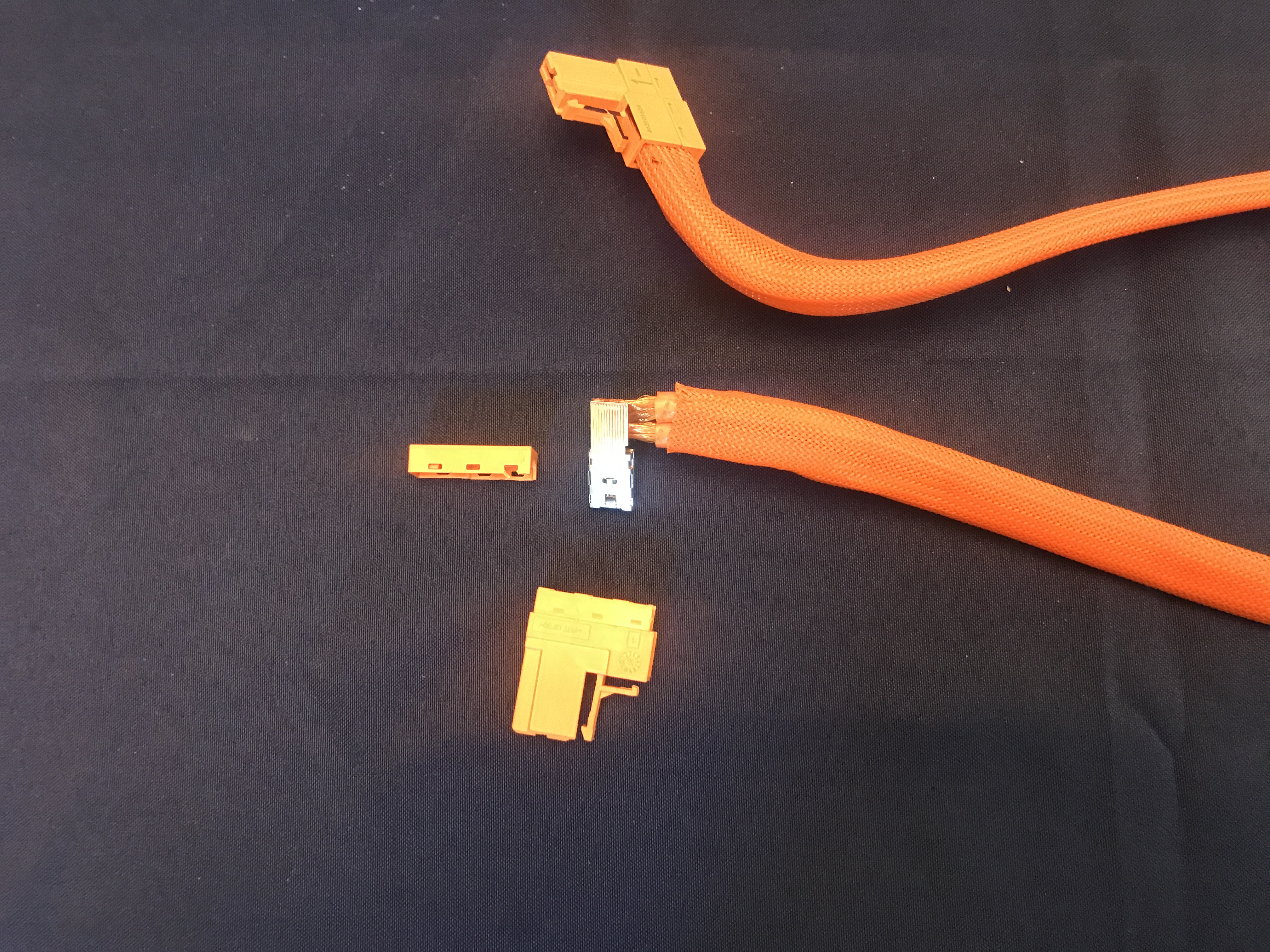

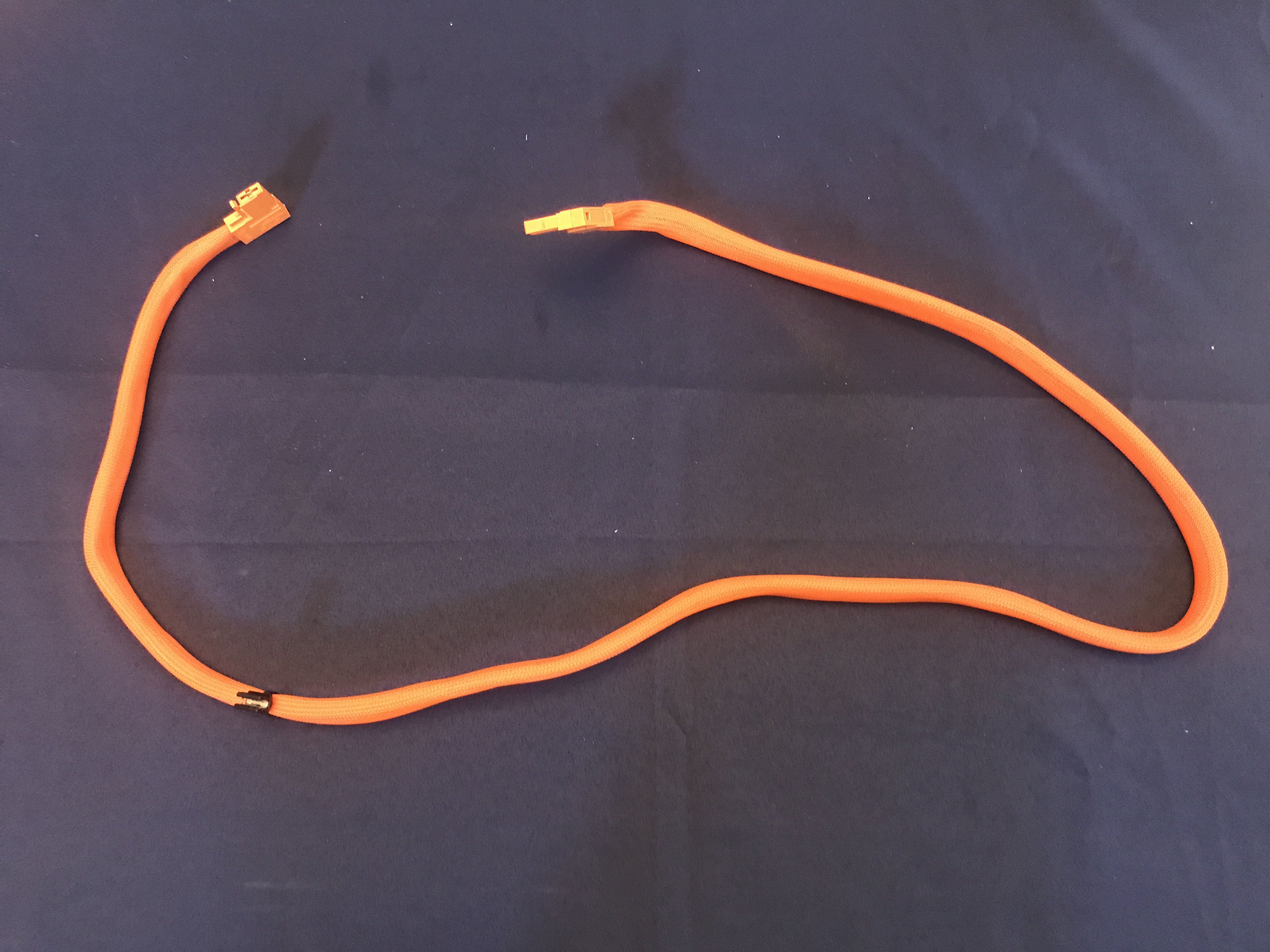

OK, now let's do the same to the longest cable in the pack, this is the negative lead from the #1 module to the Safety Box. It does not matter that it's an official OEM negative lead as we will remove the positive terminal housing. If this makes your brain hurt, then know that I could have grabbed the much shorter official Positive lean from the #6 module that runs to the Safety Box, but again I was shooting for the maximum reachability using stock cables.
This will make more sense as we move along.
Posted: Wed Jul 12, 2023 1:02 am
by Gregski
Mandatory Stare & Compare
Posted: Wed Jul 12, 2023 1:06 am
by Gregski
and result, we just replaced the OEM smooth single foot long cable with the webbed loom dual cable 5 foot lead, we could just lop off the other end and crimp on a 2 AWG ring terminal and call it good for this side if that's the distance we need to cover from our pack to the inverter

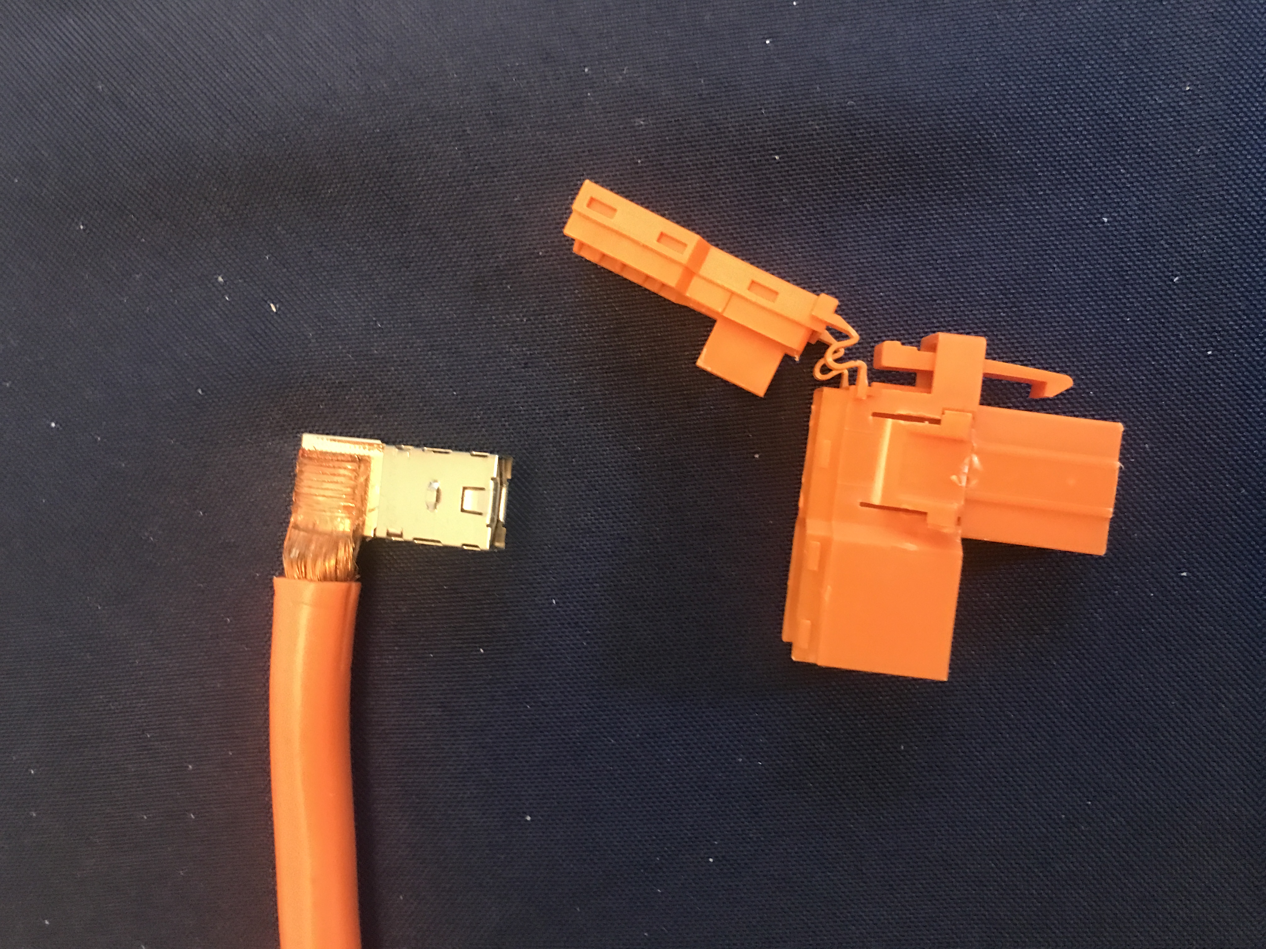

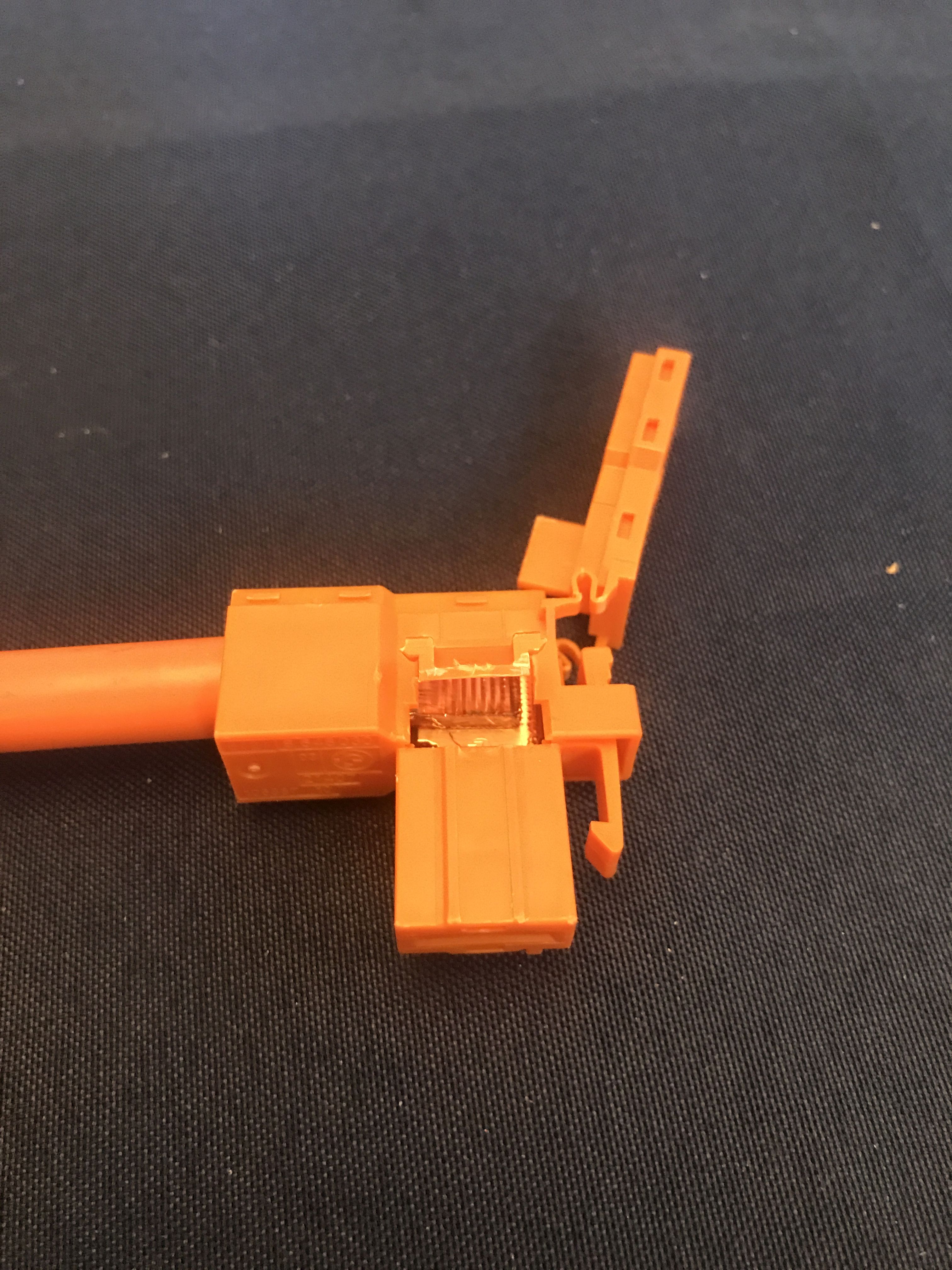

Couple Lessons Learned about this swap or Reconfigure method.
  • the OEM output cables are round the battery pack cables since there's two of them in that webbing are sort of rectangular so some filing is required in order to fit the bit larger two cables into the housing meant for one
  • though you can gently pry these orange housings apart they were really not meant to be opened up so getting your hands on brand new ones would snap them back together like they came from the factory

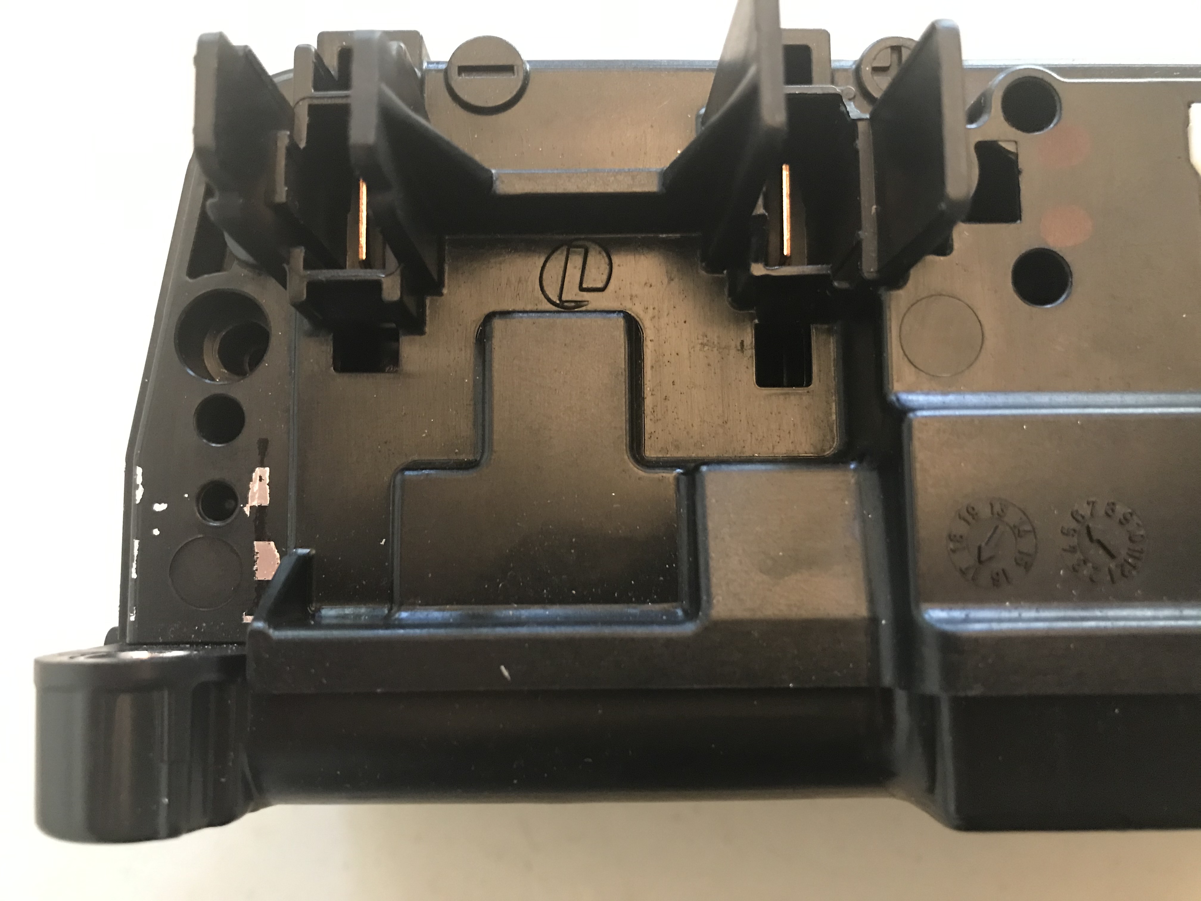

now let's take a look at the "Rekey" method, this method does NOT require us to remove the house, it involves a knife instead... BONUS !
this does require something called "patience" and surgical like precision
there is one additional trim/cut that I am not specifically showing, it's a tiny ridge on the back side

and there we have it a perfect fit, we now have a longer Negative Output lead (bottom of pic). I learned that all four of the Safety Box ports can accept clips on the front (like those stock OEM output stubby cables) or their back sides (like the stock OEM webbed long battery leads)

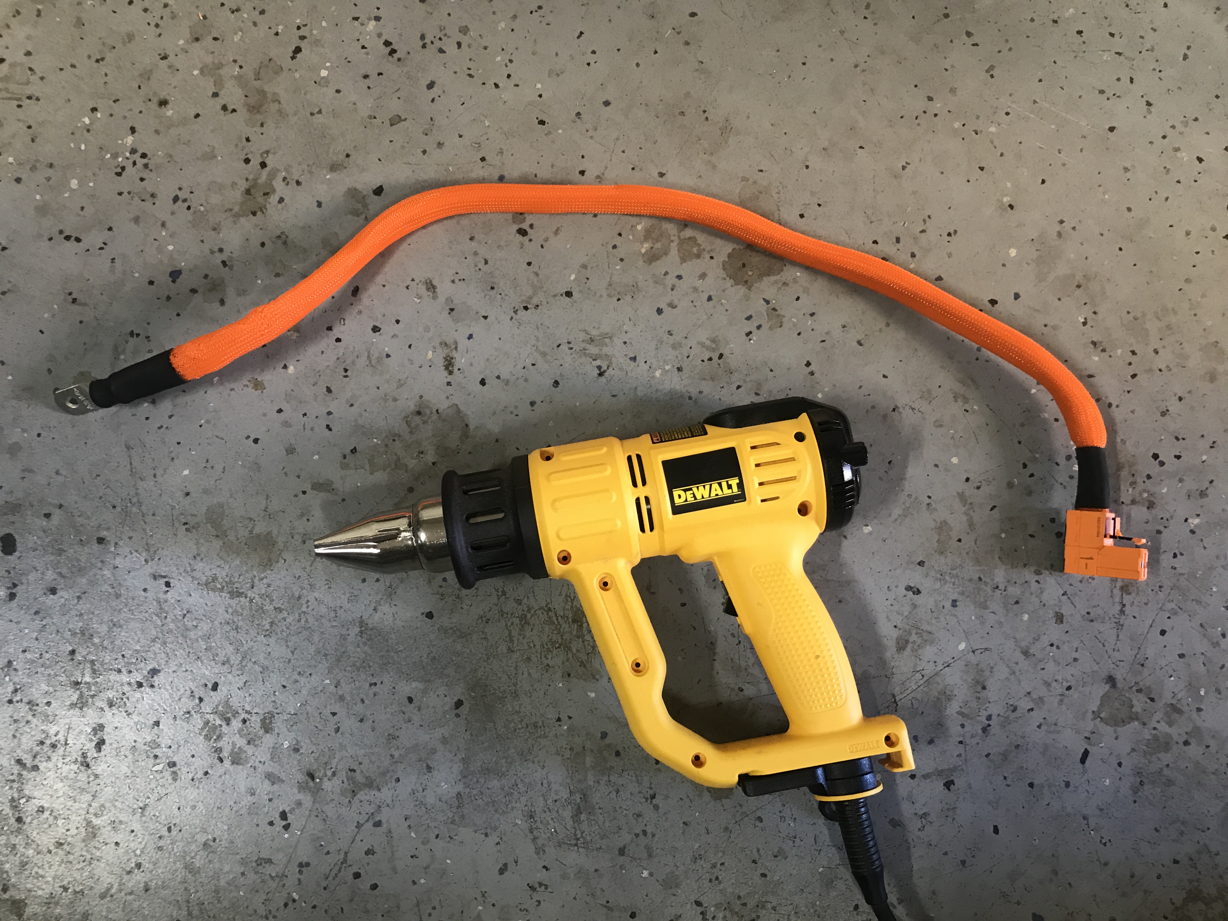

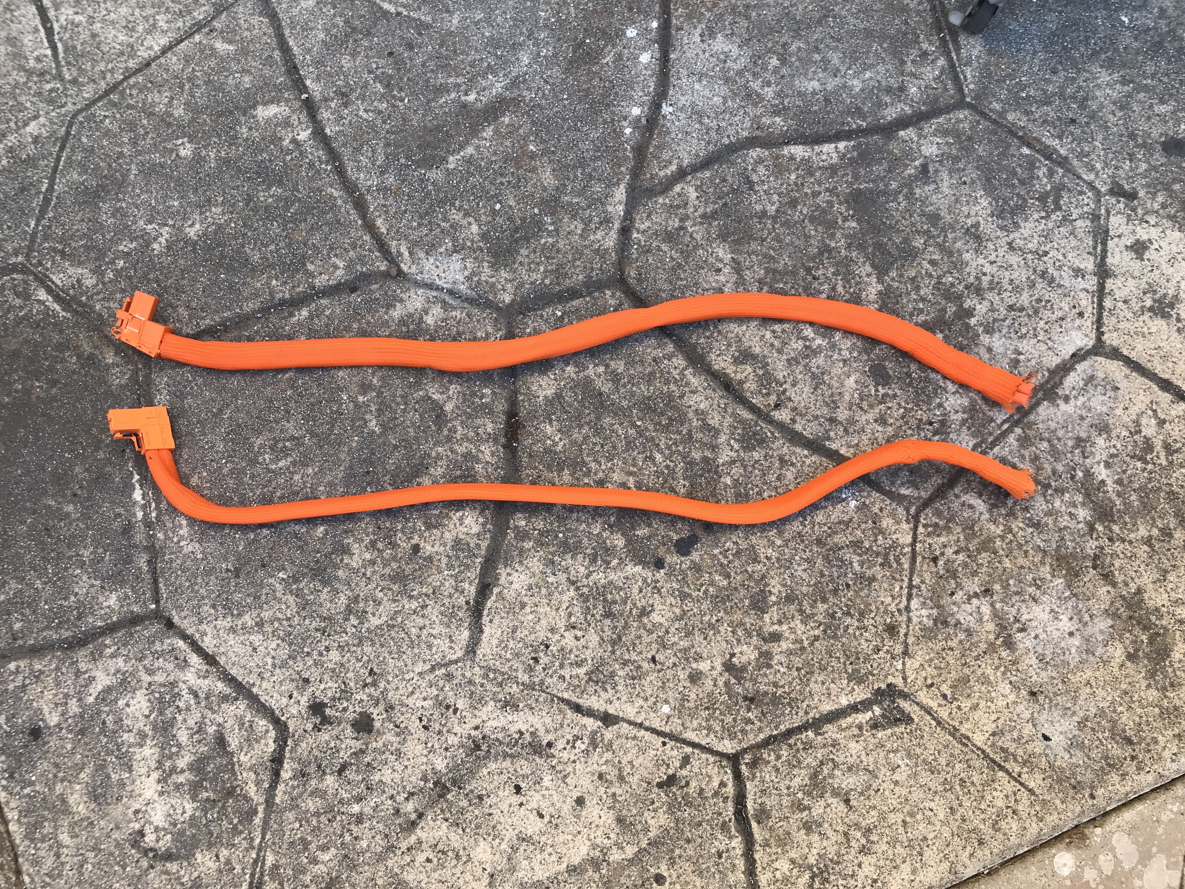

so here I am taking one for the team and cutting the longest cable in the BMW 530e battery pack (that of module #1) in half
and it's all over but the crying

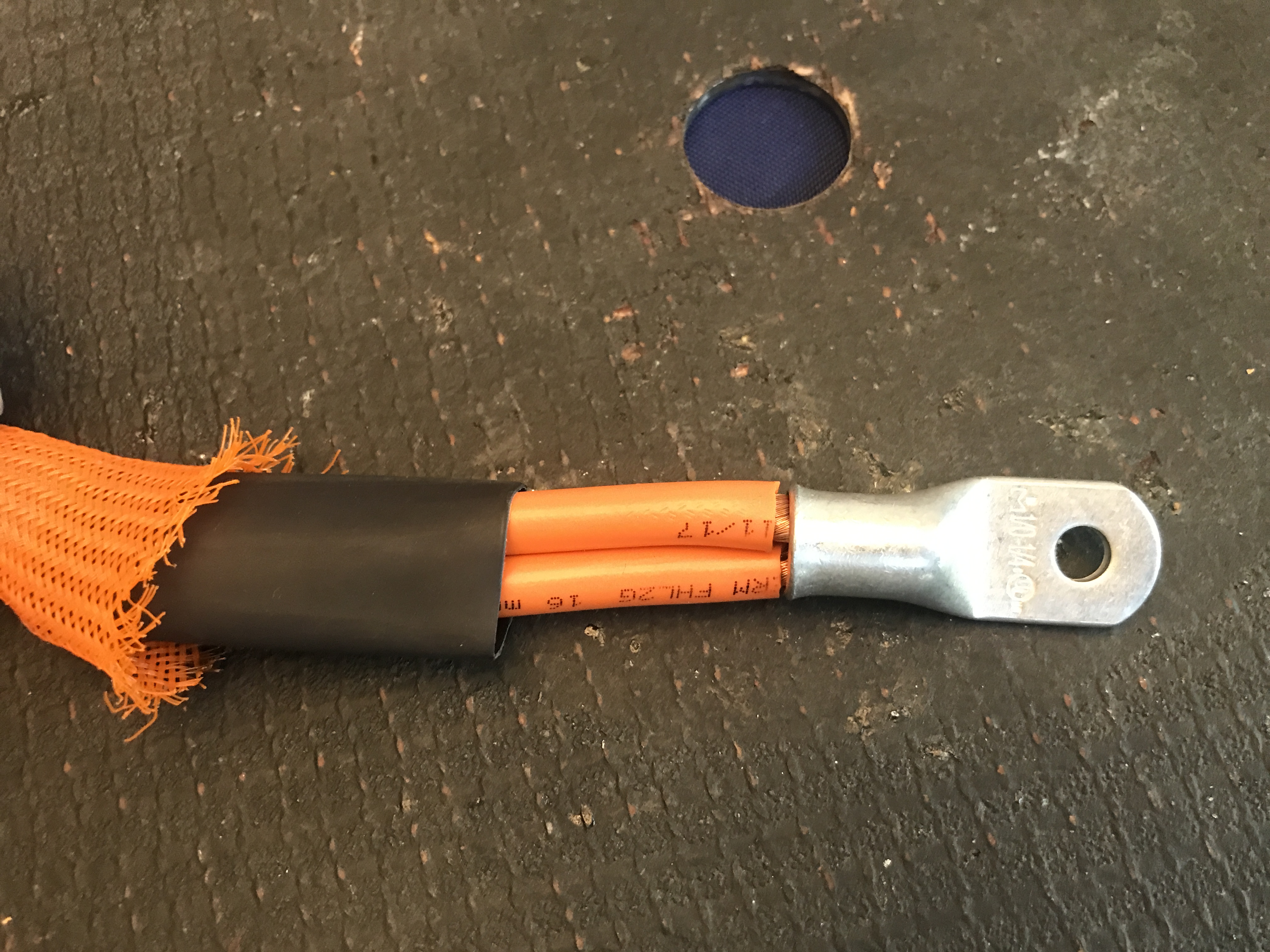

I am still investigating if this 1/0 AWG 6mm lug is the optimal size there is actually a slight difference between it and the 1 AWG 6mm, and I just ordered some 2/1 AWG and just 2 AWG, I really wanted this to be a snug fit
Posted: Wed Jul 12, 2023 11:41 am
by Gregski
so then it was time to make the cable, note how I deliberately put black heat shrink on both ends just to make sure I know that is the negative lead
I am not too in love with this hydraulic terminal crimper as it tends to leave sharp edges
Posted: Wed Jul 12, 2023 11:49 am
by Gregski
and here's one longer lead connected to an inverter with a ring terminal and a proper bolt
