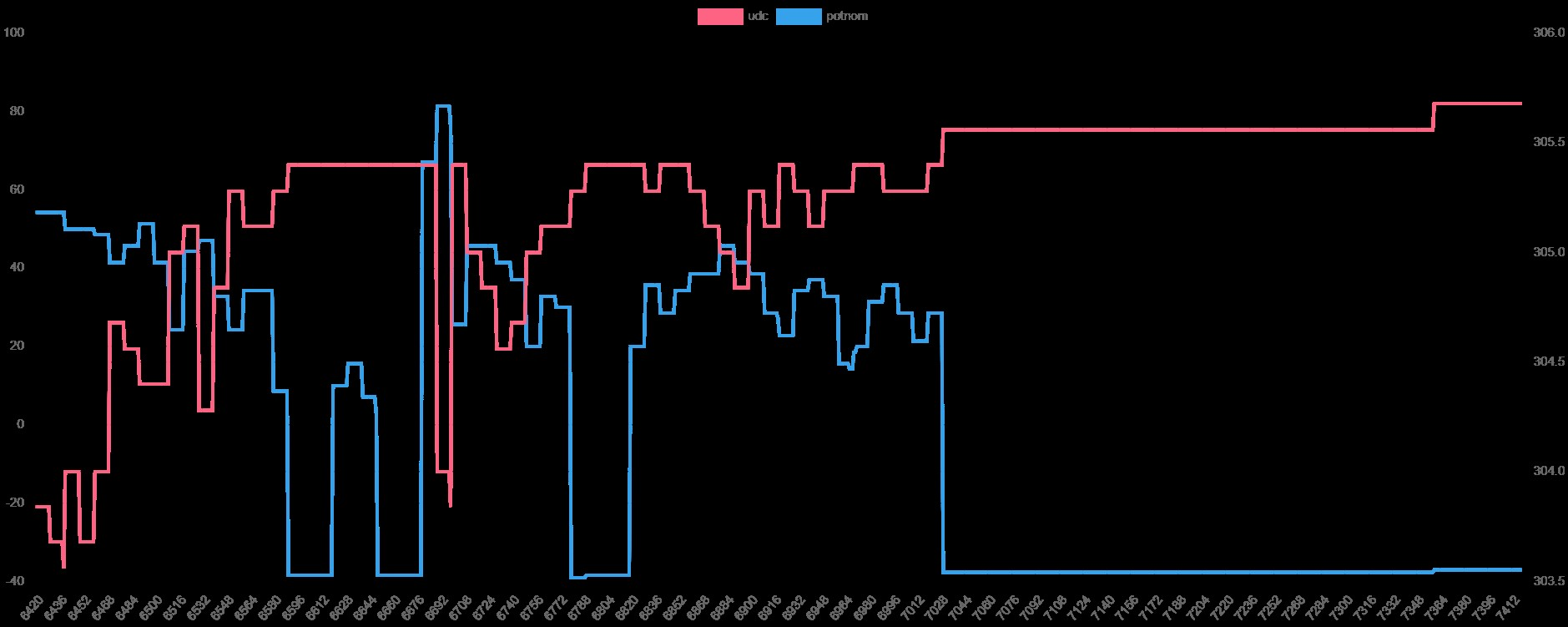

I was able to plot now, keeping the laptop on the back seat. What hit me, was that udc showed 305V! That’s above my 302 udcmax. Quickly pulled multimeter and checked the motor + and - poles, and it showed 287V. Is this normal?
I then tested to up the udcmax to 310V and I was able to see some negative potnom values, but didn’t feel any Regen happening still.
Something is off here 🤔

Ok, seems you need to tune udcgain . It may be hidden. If you don't see it, type "flag udcgain ~hidden" into the custom command field and send it.
Apart from that, -40% should cause considerable regen force. Did you try at very low speed? You set regenrampstr=40 so only at 40 Hz do you get full regen and half at 20 Hz. This doesn't display in potnom to make standstill tuning easier.

Thanks! I got the voltage now adjusted. It was weird that udcgain felt reversed, less gain means more voltage. Ended up with udcgain = 8.15.
After that, I upped some regen values and I was able to feel regen happening! Though it's way milder than I'm used to. These are my current settings, but even with these, it's rather mild. I wonder if some of these settings are reversed too?

Your regen parameters are so strong now they should throw you out the window. Something still holds it back.
Decrease regenrampstr to 20
Before driving make sure potnom actually reaches the desired negative value

Potnom goes to all the way -95% that I've configured. So that seems to be working. I'll set that to -100 and brakeregen too. But that's not a big difference.

It's in his first post. The odd thing is that potnom reaches -100 during standstill, so that's after all deraters (but before regenrampstr)
The only thing I can see is voltage rising too close to udcmax during regen. A plot of udc and potnom while driving would show this

So, setting udcgain made the voltage right, which made regen to work initially. But I'm not getting more than -25kW of regen at max. potnom goes to -100.
I'll do a plot of udc and potnom when I get to the car. Thanks for suggestions.
