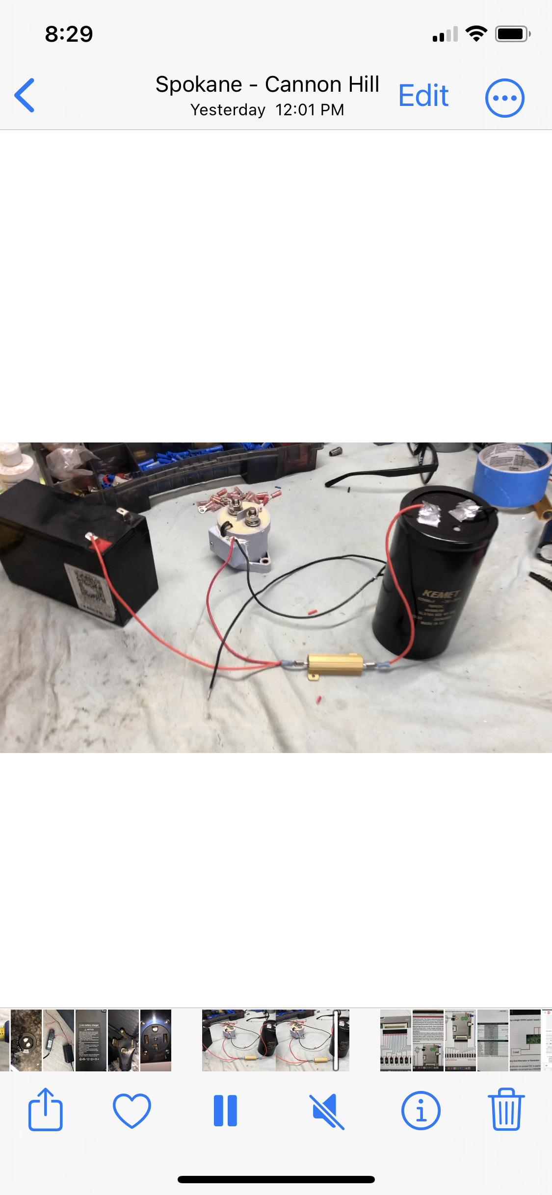

I took some comprehensive notes on this video because I want to make sure the information is as accessible as possible as I believe it is critically important to understand every part of this when using an LDU for a conversion.
https://docs.google.com/document/d/1jCw ... sp=sharing
I also typed out some chapters for the YouTube video. This will help a long but informative video be much easier to navigate if someone can get these to Damien so he can put them in the description. All he has to do is copy and paste this into the description of the video and the chapters will show up when scrubbing through.

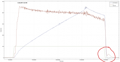

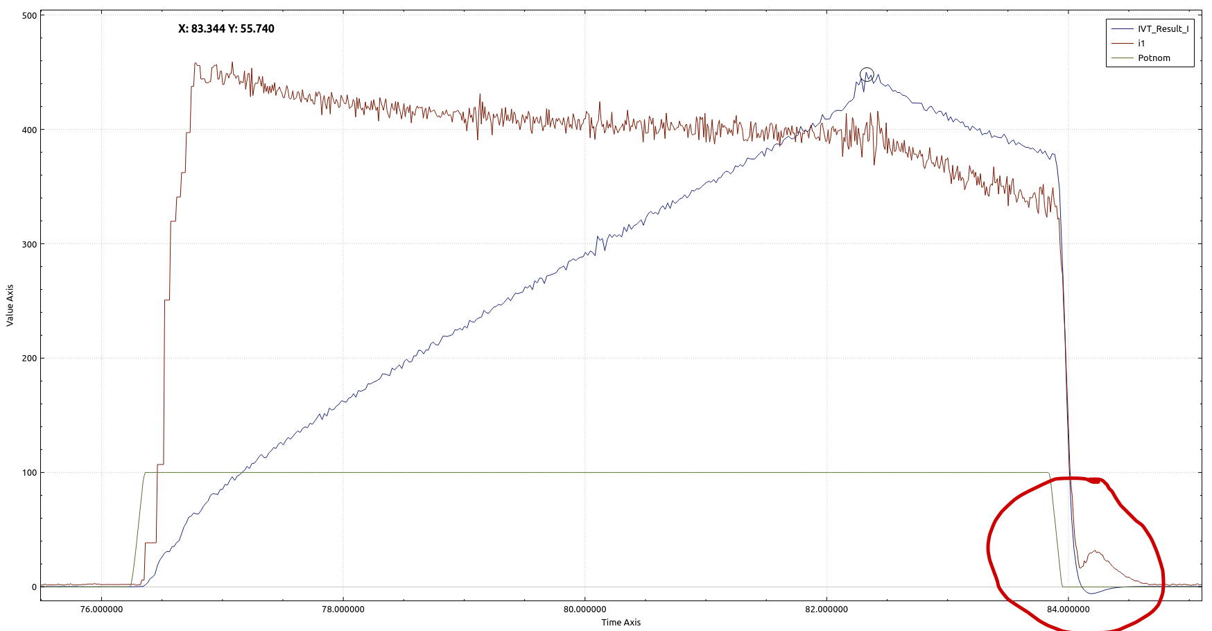

johu wrote: Sat Nov 25, 2023 8:31 pm the deadtime. It sits at its default of 63 or ~1us for the LDU which could indicate it was never tuned to fit. But I guess that would have shown earlier, or would it?
I'd defer to your expertise on whether that would matter, but I don't believe anyone has tried tuning that parameter. All of the example sets I have saved show it at 63. What would be the benefit/danger to changing that?
Been thanked: 1913 times
Re: How to not kill a tesla drive unit
P.S.Mangelsdorf wrote: Mon Nov 27, 2023 1:40 pm I'd defer to your expertise on whether that would matter, but I don't believe anyone has tried tuning that parameter. All of the example sets I have saved show it at 63. What would be the benefit/danger to changing that?
Setting it too low means high current flows across the phase legs and potentially destroys it. So I certainly wouldn't advise a lower value. Setting it higher means you loose some output voltage and with it some performance.
I always tuned it by diminishing returns with a current limited power supply. Start at a low value (say 30) and observe the input current with no motor connected and the inverter idling in manual mode or something (it just needs to run the PWM). You should then observe that the input current becomes smaller as you increase deadtime. There will always be some residual current (say, 50 mA) that you can't get rid off even with the highest deadtime setting. So you're tuning for the point where only that is left.
Thing to note: deadtime is only changed on starting the inverter. So when tuning
1. Change value
2. Start
3. Test
4. Stop
5. back to 1

Hi Everyone, I have spent extensive time developing 3 phase inverters.
I feel its needed to comment on the dead time settings.
Dead time is not to be adjusted after setting it the 1 time.
And Dead time is to be set to worst case for all components involved.
So dead time is set as you add up all the longest off times of all components and compare that to all the fastest on times of all components.
So when you have the IGBTs (or what ever power switches used) in the Hi and Low side of 1 phase you are looking to prevent having both of them be in the on state at the same time.
What you start with is the main IC that sends the PWM Look at the fastest on time subtracted from the slowest off time
Next you add all items in the series from the Main IC to the IGBT it self. So it might look as follows
Note: these are all made up example numbers just to show how you do it.
IC slowest off (20ns) - fastest on (10 ns) = 10ns
Optic isolators (if used) Slowest off (30 ns) - fastest on (10ns) = 20ns
IGBT drivers Slowest off (150ns) - Fastest on (50ns) = 100ns
IGBT (or what ever powerswitch used) Slowest off (1200 ns) - fastest on (300ns) = 900 ns
So that would look like 10ns + 20ns + 100ns + 900ns = 1030ns or 1.03uS
There might be more components in the series. So you need to add worst case of any other components as well
When we talk worst case you need to look at the data sheet and see for all temperature and currents what is the worst case for both the fastest and slowest at all temperatures and all currents.
If we know all the component part numbers I would be happy to do this based on the data sheets.
I will also comment IGBTs are usually quite slow. 1uS dead time is likely too short or just on the edge of what is ok.
My first inverter using Fuji IGBT moduals and good gate drivers needed 2uS dead time for instance.
-Arlin

I previously suffered an LDU failure in low voltage bench testing which I assume is due to the exact reason that Damien explains in the video.
Damien explains at the end of this video how to avoid the same overcurrent failure during driving, i.e by setting trip mode so that the contactors stay closed allowing current flow back to batteries. This obviously only works if the contactors are being controlled by the LDU...
In my case I have contactors controlled by zero ev ccs contactor controller which is switched on and off with the ignition key. If I am interpreting Damien's video correctly if for some reason the ignition was switched off while the vehicle was driving (the ignition key is relatively close to drivers knee), the contactors would open and likely inverter failure would occur.
Am I interpreting this correctly? I have the car finally finished and working well and I'd hate to think that a trivial 12v failure would destroy the inverter
I have never tested what drops out first, gate drive/logic power or the contactors.
Contactors usually stick down to 2V while the gate drivers would cut out much sooner, maybe 9 V. Without them working the drive unit is basically in neutral and wouldn't be damaged. Theoretically.
Practically I have killed ignition to an over-revving Leaf drive stack and it survived. But their protection seems superior to Teslas, so not sure what actually saved the day

I had an issue where contactor did open once on regen and once when cruising. When contactor did open during about 35kW regen, one of inverter power phases burnt. When contactor opened during cruising (about 80km/h), nothing broke. Still using that same motor.
