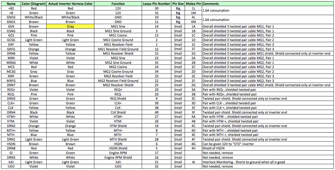

Connector pinout including plug and pin part numbers :
https://github.com/damienmaguire/Lexus- ... Pinout.pdf

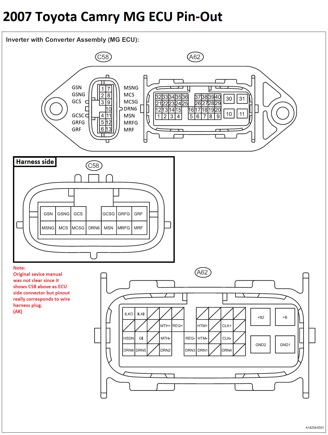

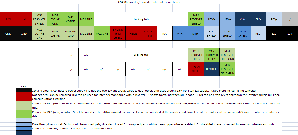

Just wanted to confirm this VCU works with 2007 - 2011 Toyota Camry Hybrid inverters.
Below is a link to my earlier post.
viewtopic.php?f=14&t=205&p=4199#p4199
Note that Camry inverter has different external connectors (2) vs Lexus (1). This seems to be the only difference and should not matter for most since it is better to replace it anyways. In case someone is going to use its original external connector I found out that pin-out for resolver is incorrect in original service manual. I uploaded picture with correction/clarification of resolvers pin-out.
Internal control board (brain) on Camry inverter is identical to Lexis one (same part number F1759-30010-01, therefore pin-out is the same).
It is possible for the firmware to be slightly different but it does not seem to affect general functionality.

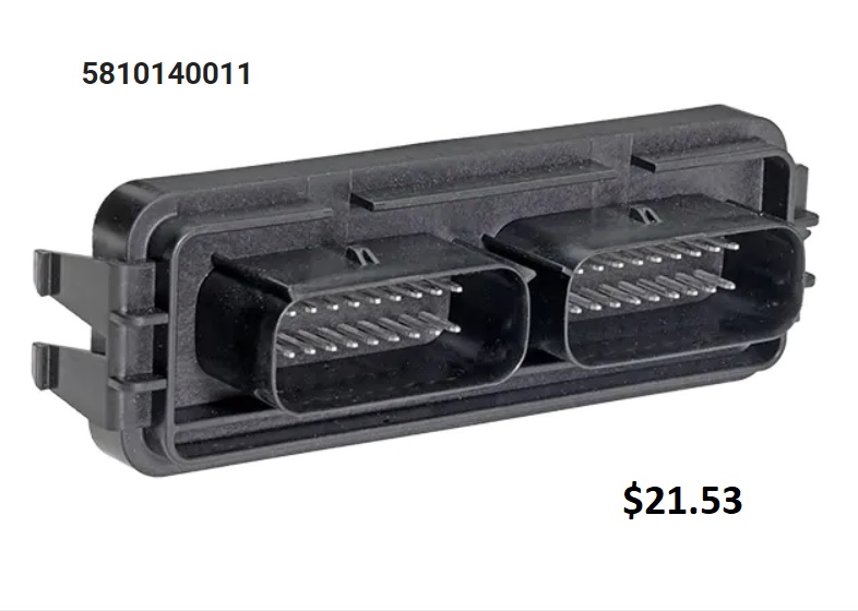

Anyone know the Toyota part number for the inverter connectors? the A62 and C58 connectors
- arturk
- Posts: 148
- Location: United States, MD
- Has thanked: 7 times
- Been thanked: 4 times
C58 is Sumitomo 6189-1092.
It is available from Aliexpress
As far as A62, I would love to know as well...
Did you know about this thread?
viewtopic.php?f=14&t=271&sid=0ab5df525e ... f8faf52e2a
We are posting information about connectors there.
Thank you Arturk. Once I have time next 2 week, I will scan in the connector and share on here.

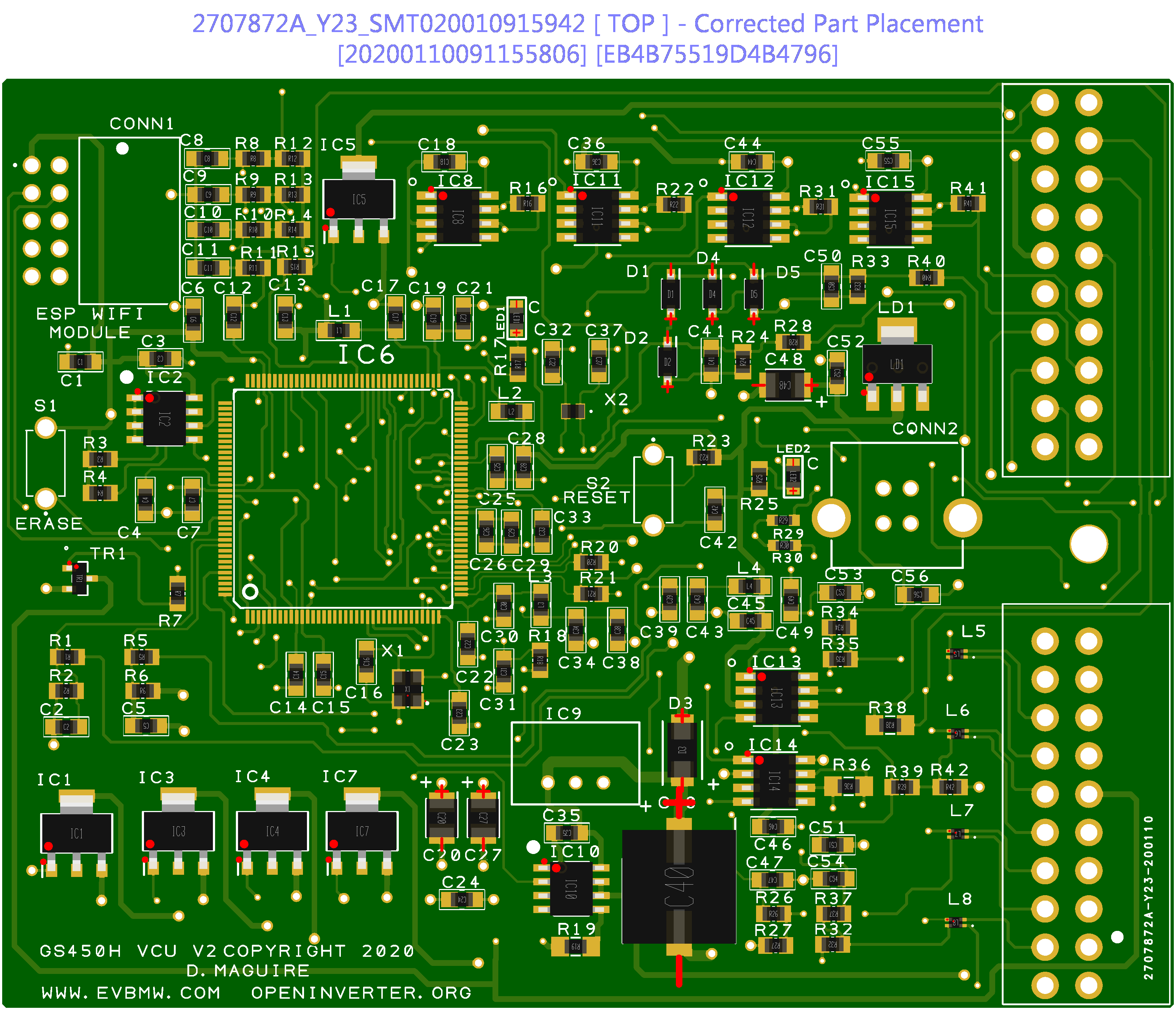

GS450H vcu V2 now in production at JLC.

Great job Damien!
Are you going to share design files on GitHub?
Looks like you may have forgotten pull-down resistors on digital drivers.
- Posts: 4007
- Been thanked: 1139 times
Yes all will be shared once the boards are received and tested.

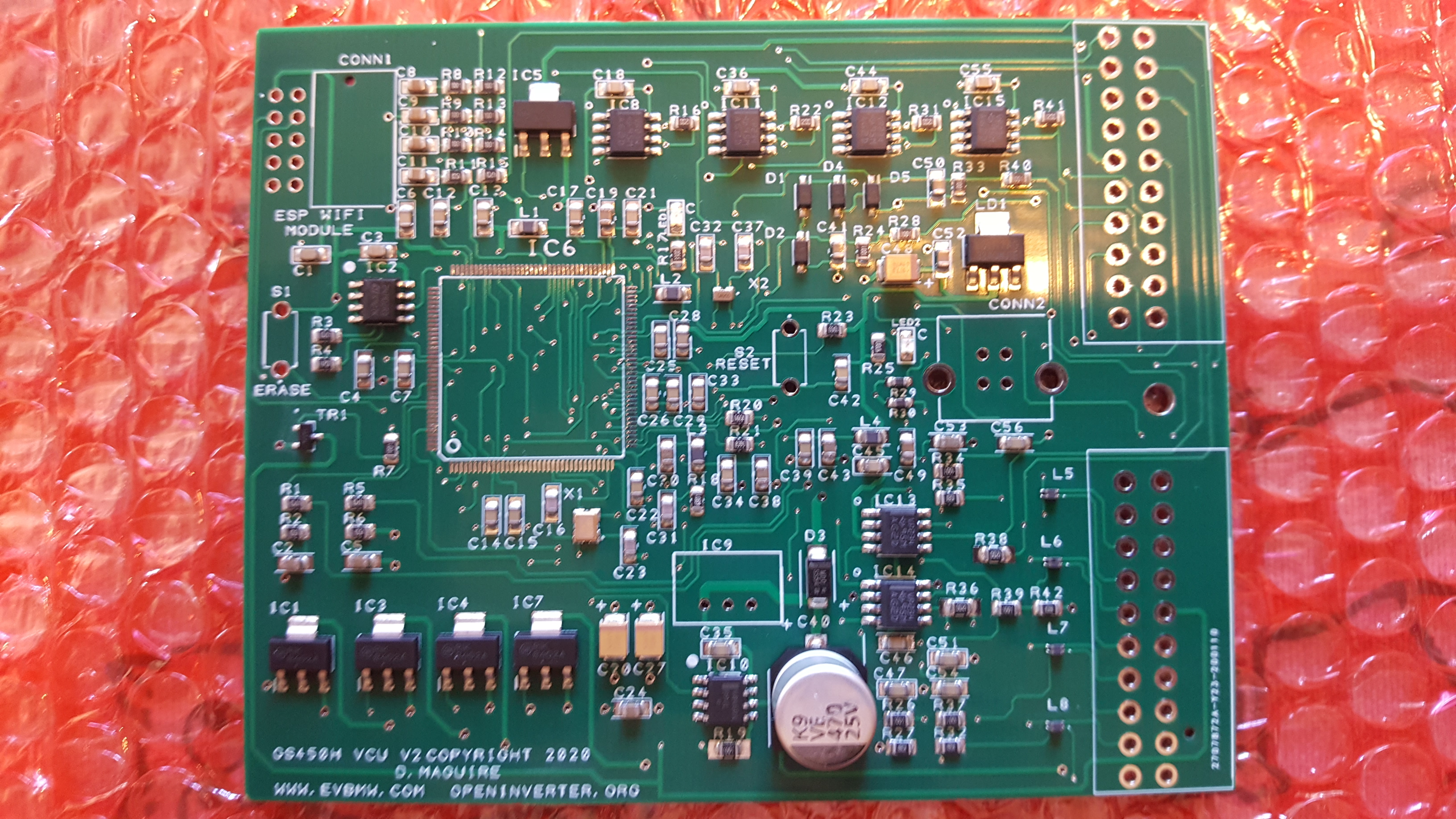

My V1 board just arrived yesterday here in Australia safe and sound thanks Damien, you're a blooming' marvel!
Now you have me curious about what is different with the V2 board ...

- Posts: 4007
I'll give a full update once I get boards in from JLC. Not many changes in the V2 but there will be big price drop on all built and tested boards:)

The new V2 boards have arrived from JLC:)
