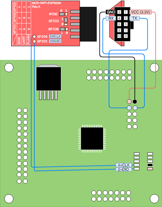

Well this maybe a challenge, but looks promising.
Olimex ESP8266 has free GPIOs:
GPIO4 -> Clock - Pin4 (SWD)
GPIO5 -> Data In/Out - Pin2 (SWD)
UPDATE: Success !!! I can connect (send magic sequence to change JTAG to SWD) and do basic commands like "halt" and read registers
const int swd_clock_pin = 4;
const int swd_data_pin = 5;

Re: SWD over ESP8266
Exciting news! SWD (Serial-Wire-Debugger) works now.
...code update coming soon to your web-interface
Need to connect GPIO4 and 5 from Olimex to CLK and DIO on SWD port.

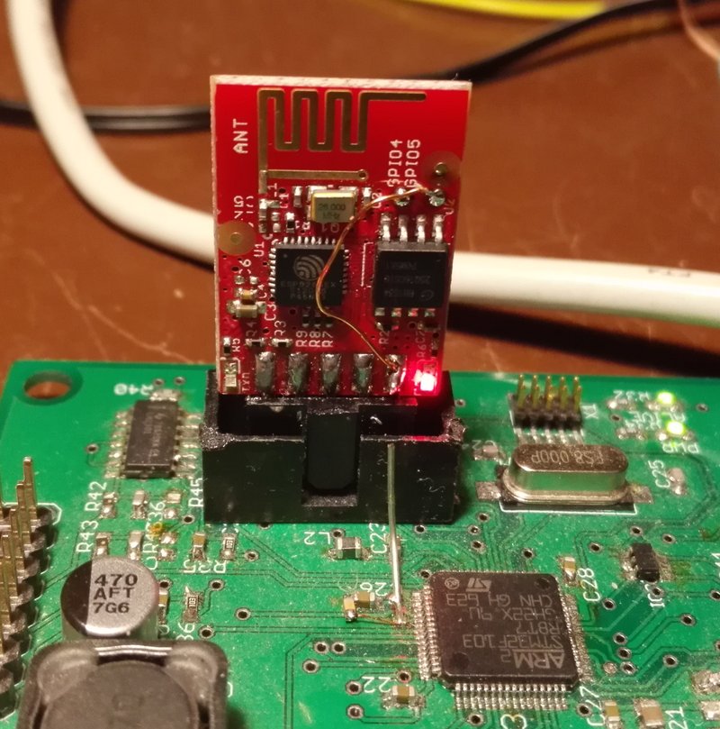

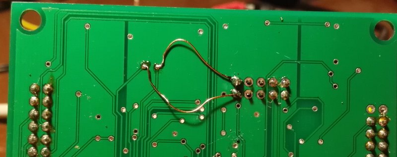

Very nice addition, when it finally works people don't need an STLink anymore to program fresh boards
Here is how I patched it to a V3 mainboard, just routed SWDIO and SWDCLK to the unused pins 9 and 10 of the ESP socket. This could be done by default in new designs. Then on the ESP module I also bridged GPIO4 and 5 to those pins. GPIO4=CLK=Pin 9 Esp=Pin 2 SWD and GPIO5=DATA=Pin 10 Esp=Pin 4 SWD
Gpio4 is bridged on the back side.

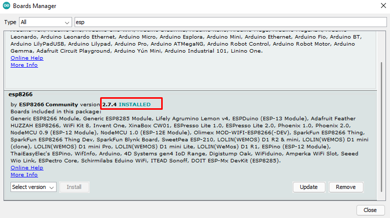

FYI, Latest Arduino ESP8266 Core Library v3.x does not work with SWD (Single Wire Debug) web interface flashing. They changed a lot how memory is handled, it crashes the esp and the web-server.
Use v2.7.4 for best results.
