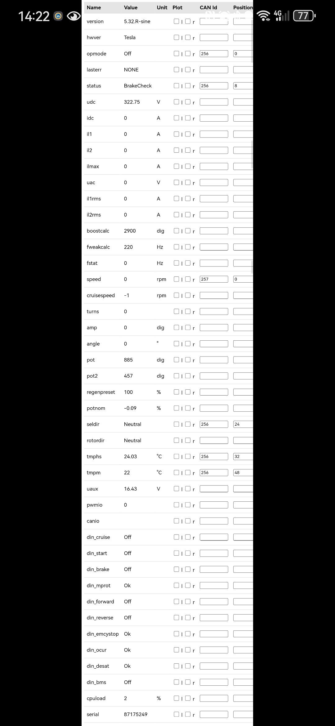

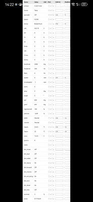

Did some more testing. There are no errors shown when I power up the inverter.
din_ocur = Ok,
status = None,
lasterr = None.
But immediately when i choose direction, lasterr becomes = OVERCURRENT. Still status is None, din_ocur = Ok.. and nothing happens if I apply the throttle. From spotvalues I can see potnom going up if I press throttle, but nothing happens.
I'm at loss. Is the LDU now broken, or is it possible that something broke from the board?

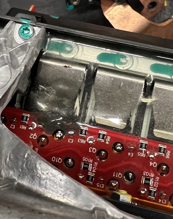

Just checked with diode mode. Positive lead to positive gives rising voltage. Positive to negative shows only 0,283V. So I guess it's the end of that motor? :(
I'm wondering that went wrong. How can it break like that? Is it the low fweak value that caused something bad with regen?

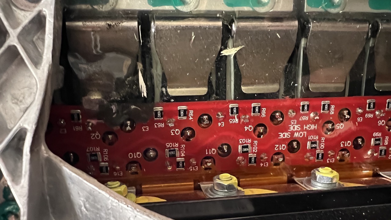

You might be able to swap the transistors of the broken phase if you're patient. It's buried somewhere here in the Tesla section
EDIT:
Look here viewtopic.php?t=2440 and here viewtopic.php?t=1625

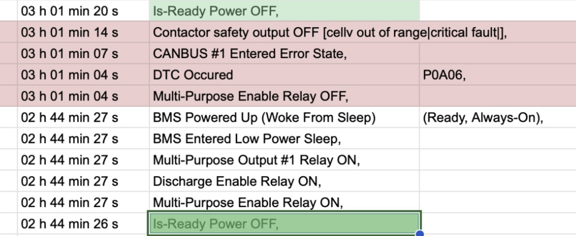

BMS controls the main contactors. So once BMS thinks something is badly off, it will open contactors to keep the battery safe. In this case, it was catastrophic .. and should actually never open contactors when car in "discharge" mode, as it probably will break the inverter every time.

Found it from bms logs.. multi purpose relay off, is where the contractors open.

I could only see one phase having one burnt spot. Maybe I should try to revive that..
