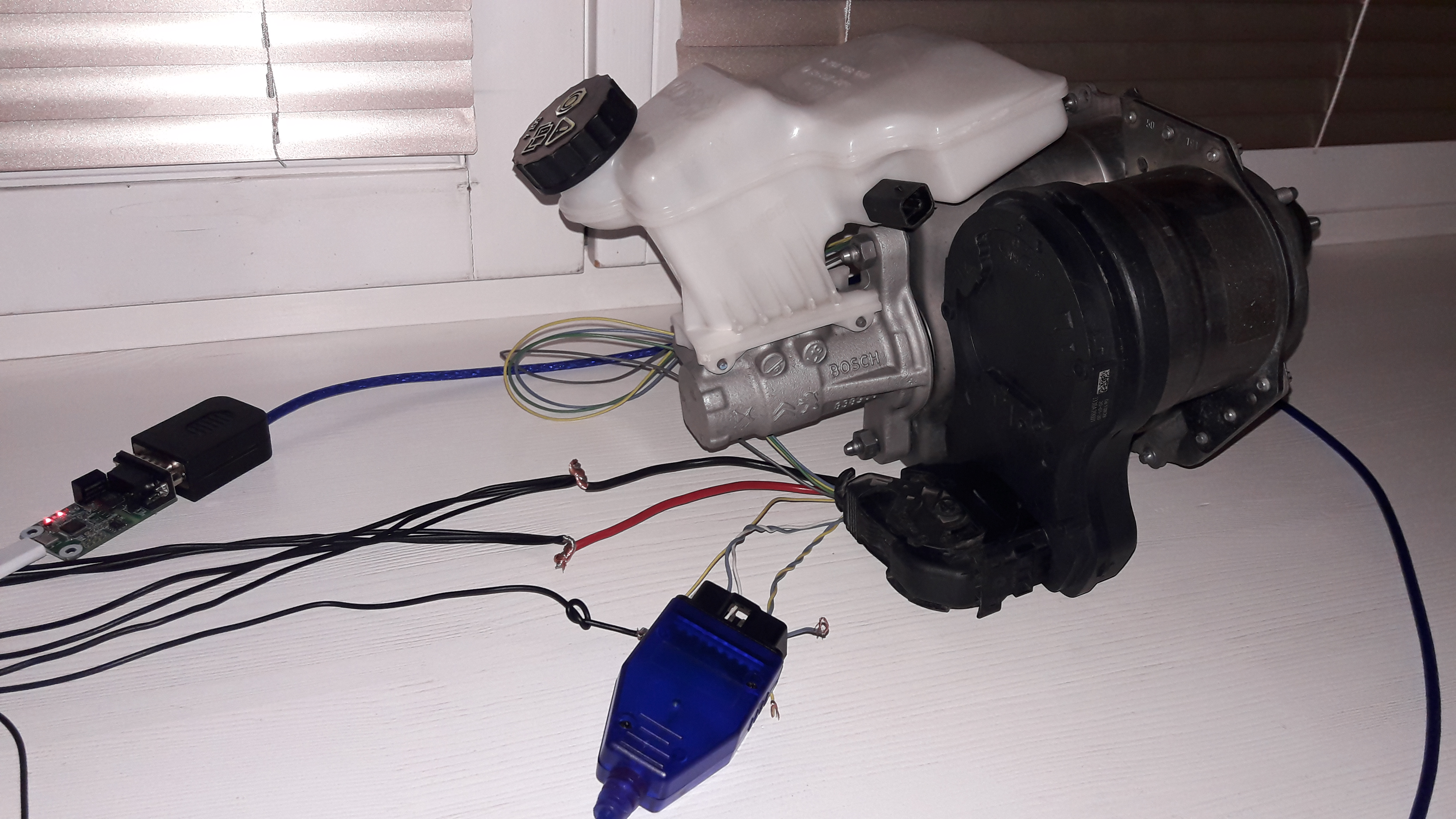

Hello. I have wired ibooster properly without any problems using ev create article https://www.evcreate.com/wiring-the-tesla-ibooster/
It works fine, makes assist but! When I do nothing motor tries to make a little spin every 10-15 seconds. What is that? Does it need a canbus to operate in fail safe mode?
Here is what ibooster is sending to me.

If you provide a pulse to the "ignition 12V in" it should "unlock" the shaft and provide assistance.
viewtopic.php?p=51532#p51532
The Gen2 Iboost I have from a Renault Zoe does the same thing. So I would suspect it looking for a Vehicle Ignition state to be broadcast over the canbus. It would be good to get a log of a Renault/Citroen with a Gen2 iBooster for review.

It is from ds7. It works immediately when power is applied to the wake up pin. Makes assist and so on but every 10 sec shaft is moving a little (about 1-2 mm)
I think that ibooster is trying to self iniatlize and is searching for "zero" position of the shaft. I have already tried to play some traces for ibooster from psa can2010. I see one byte is changing when I'm sending specific message "ignition on". Also I know that ibooster works in pair with esp and it needs data about brake fluid pressure. It is like a feed back for ibooster from esp module that everything is fine.
Maybe everything what is need is just make adaptaition of ibooster via psa diag cable because in the original PSA documents it is written that: 5. "training" - initialization

Does the Ibooster "unlock" when you give it 12V ignition Pin 20? As in you hear it move the motor and it draws more current.
Does it transmit any CAN on the CAN bus at 500kbps? Ofcourse with it terminated at 2x120 ohm.
yes and yes

Does it then provide assistance for a little while and then stop again, or does it not provide assistance at all and just pulses the lock/unlock of the system?
You tried pulsing the 12V line for it to unlock and then see it it "times out"?
It is possibly looking for a vehicle terminal state (KL50/KL15/KLr)

When +12V is present on pin 20 it provide assistance all the time. If I disconnect pin 20 canbus is shutting down after ~20 sec. Then after short time i hear that motor is "parking" and ibooster become quiet.

AMP3R wrote: Sun Sep 17, 2023 8:58 am When I do nothing motor tries to make a little spin every 10-15 seconds.
AMP3R wrote: Fri Dec 22, 2023 9:30 pm Makes assist and so on but every 10 sec shaft is moving a little (about 1-2 mm)
If the brake pedal position sensor is wired up it may do a check to see that the position sensor moves to check the position sensor or maybe calibrate itself. If the sensor output doesn't change when it's moving it can't calibrate or verify the sensor is good. So it may be repeatedly trying to calibrate or check the position sensor.

Today I tried to preload the push rod slightly by hand. And guess what? ibooster is not "clicking" now.  I don't know what exact position of rod is needed but I think I'm on the right way. Is it normal when the push rod is preloaded? Idk how it is on the donor vehicle.

AMP3R wrote: Sun Dec 24, 2023 3:00 pmIs it normal when the push rod is preloaded?
Yes!
I forget the amount, but yes. And adding that has fixed the problem for some.
There was some discussion about an "out of range" error, though I forget where that discussion took place. Oudevolvo (Lars, from EvCreates) has postulated this same error and the reason for it.
I recall there being some known amount of default displacement in the original setup (which may vary by vehicle).
Some early tests from me, doing the adjustment, showed that this might not be true. When I'd adjust, and then reset, I was still getting the shuddering at the same amount of pushrod push. Which made me perhaps conclude that on powerup, the iBooster calibrates where "start" is (wherever it currently is) and then from then forward it knows its range.
I also suspect the shuddering is actually just iBooster maxing out, and instead of killing the pump it rapidly turns the pump on and off trying to push that last little bit harder. I won't know if this is a relevant thing until I'm trying to stop my car at speed and notice whether this shuddering occurs well past wheel lockup (i.e. well past full brake pressure anyways).

MattsAwesomeStuff wrote: Mon Dec 25, 2023 2:51 am I also suspect the shuddering is actually just iBooster maxing out, and instead of killing the pump it rapidly turns the pump on and off trying to push that last little bit harder. I won't know if this is a relevant thing until I'm trying to stop my car at speed and notice whether this shuddering occurs well past wheel lockup (i.e. well past full brake pressure anyways).
On a different site of someone else who's reverse engineered the CAN protocol for the Tesla (only) iBoosters, he said when that happens you actually lose all braking pressure and so it's vital to not go out of range. I don't think that's true.
If the ibooster is maxed out you can't push the brake pedal any further. If it's limiting brake master cylinder or pedal travel it's an obstruction and dangerous. You don't lose all braking, you lose further braking from the obstruction. Say the obstruction is after a medium braking push of the pedal but the obstruction is right after. When you try to do an emergency stop the obstruction his and you only get the medium braking level.
So 2 things to check, when adding an ibooster, make sure the booster travel and brake master cylinder travel are able to swing through the complete brake pedal travel.
You also need to ensure the stack isn't pushing on the brake master cylinder when the brake pedal is all the way up. Preloading the brake master cylinder means the fluid can't get back to the reservoir and it can build up pressure as the brakes / fluid warn up. This means dragging brakes immediately or after a bit of driving.
