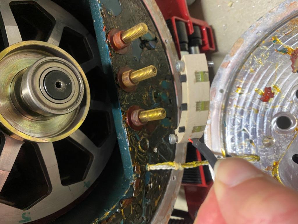

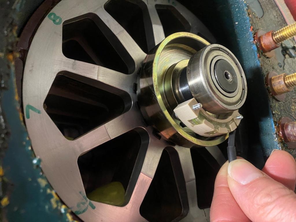

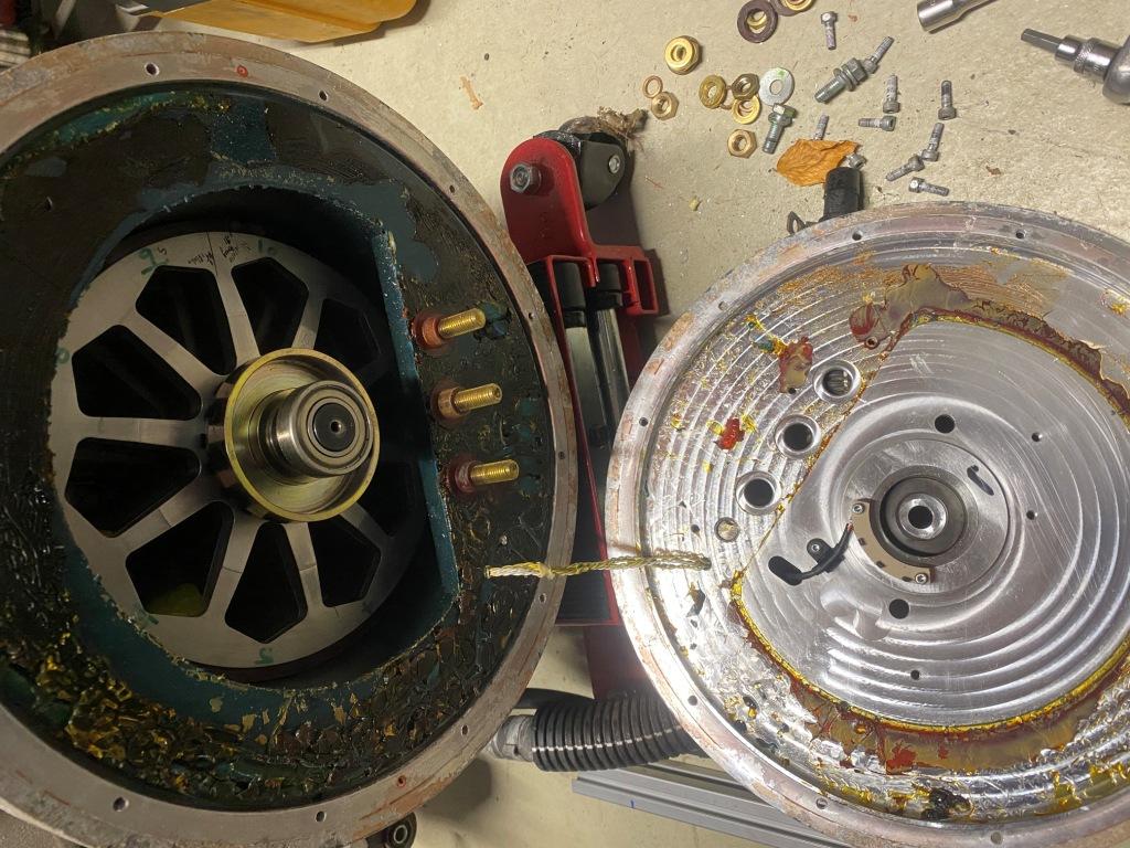

I have removed the motor to open it for the encoder/resolver.
Does anybody recognize this? The ring is magnetic.
And the other big question is: Can this work with the Main board rev 3? Or should I try to fit another resolver?

Been thanked: 1918 times
Re: [WIP] Volvo V50 upgrading to Brain board
Hmm, could be hall sensors. Is it 3 pairs of wires?
If so it is unfortunately not supported
