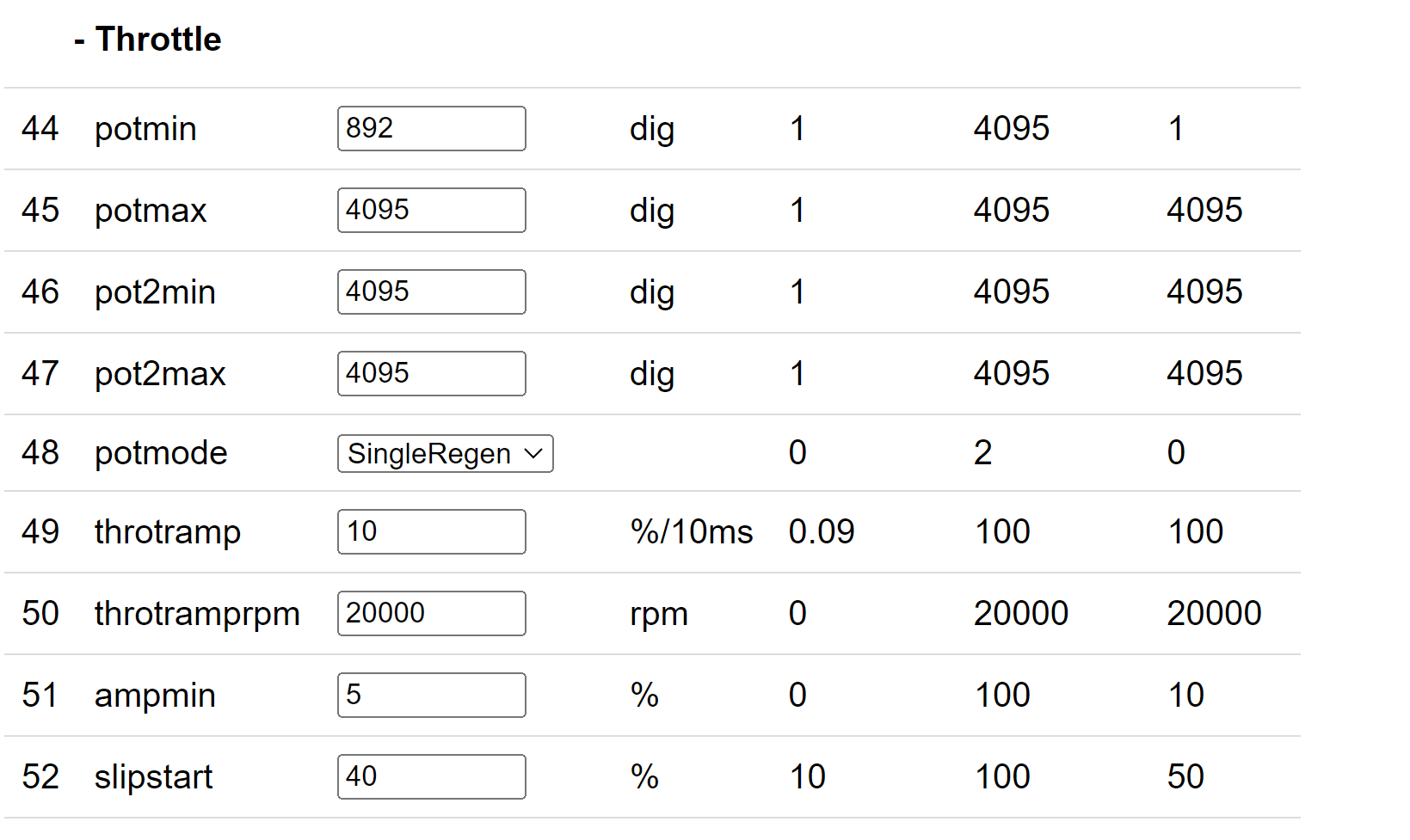

What is the acceptable tolerance on the pot input? I have a V6 board (fmw: 4.90.R-sine) with the bmw e45 throttle pedal. Below are my measurements of the fully released pedal on the multimeter (signal-to-ground) vs. on the web interface. When I fully press the pedal the value stays steady - 4095.
As you see the meter is pretty steady on the pedal released, but the values are jumpy on the web....Trying to figure out if it's a problem or not...
Multimeter:
Web interface:
Wiring: I use just vcc1, gnd1, sig1
Throttle parameters:

Re: Tesla Small Drive Unit (SDU) pot tolerance
Seems like 50 digits jitter - a bit too much for my taste as well. With the pedal disconnected do you still see the jitter? I wonder whether the onboard low pass filter has the wrong capacitor or resistor value

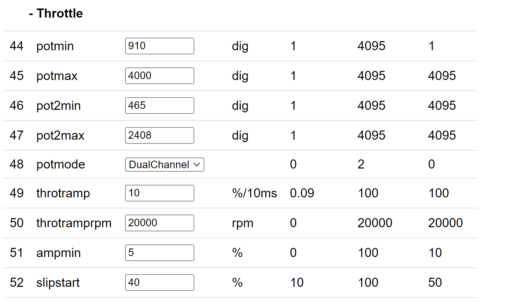

New throttle params:
potmin's and potmax's are now taking into account broken wire or short wire.
potmin's = min value +10%, potmax's = max value - 10%.
web interface live values: initially showing the pretty steady values when the throttle is released, then randomly pressing (and trying to hold in place) the throttle and finally throttle all the way down.
