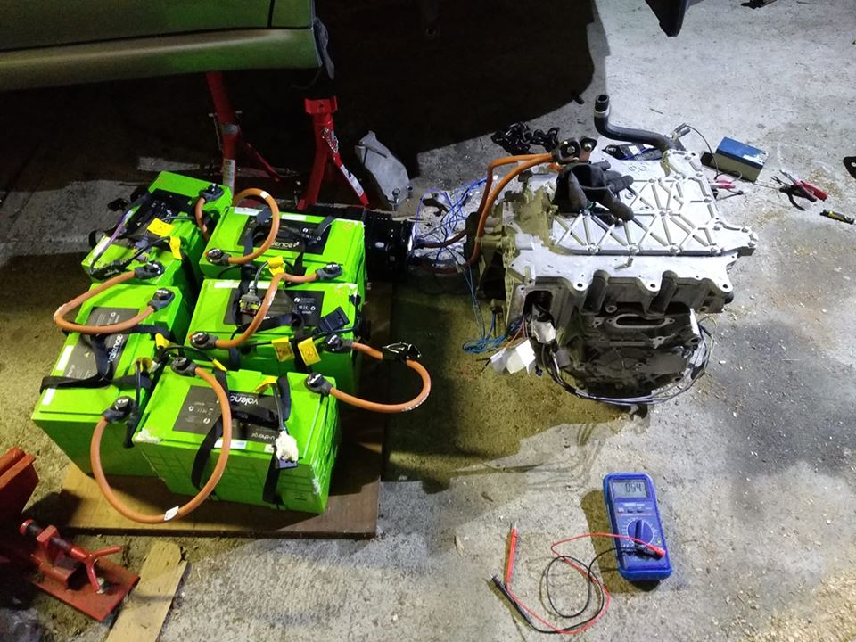

Update:

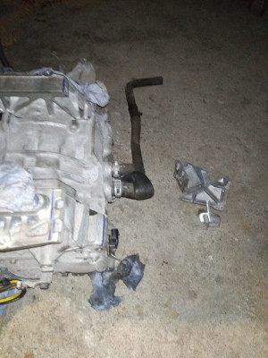

-Rear subframe was removed from car (leaf motor placed beside car for reference)
-Motor top of motor required some surgery(originally I planned for a gen 1 motor, Gen 1.5 is taller)
-Subframe required some cutting to fit motor( modifications to follow)
-Motor is now spinning on 60v using leaf contractor box( Currently using P&S board as that came with motor)
