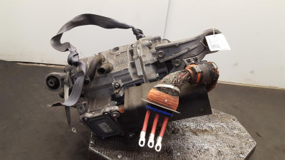

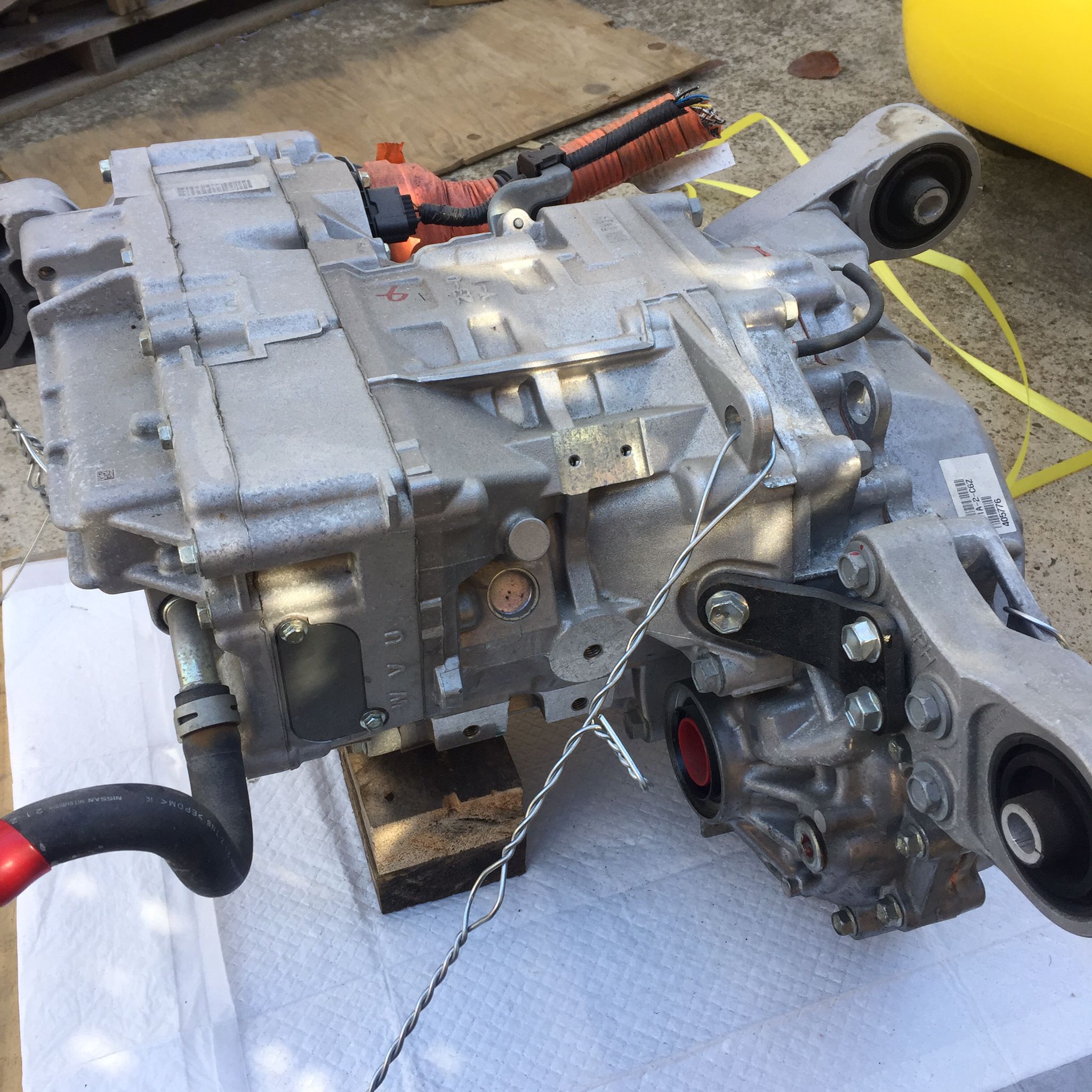

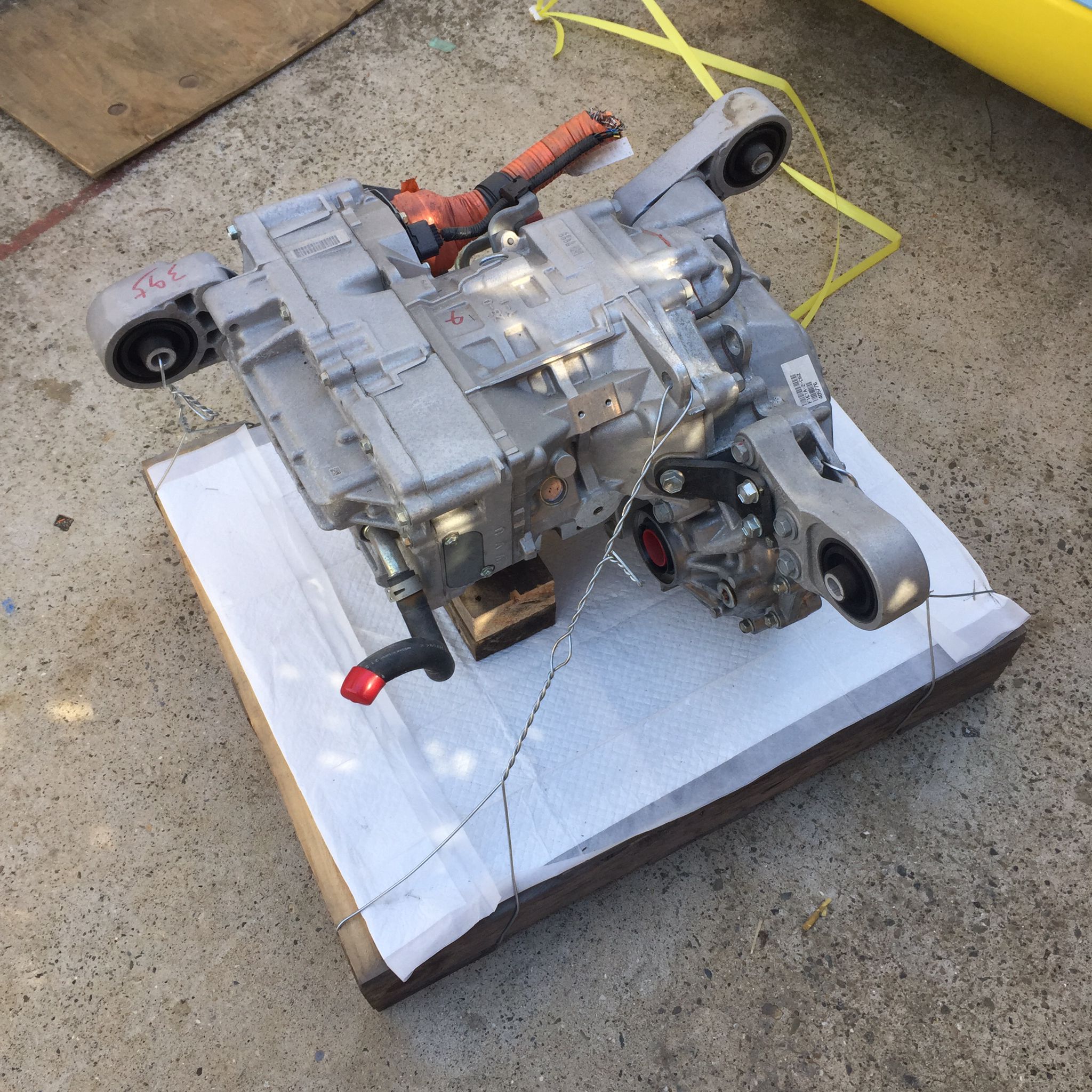

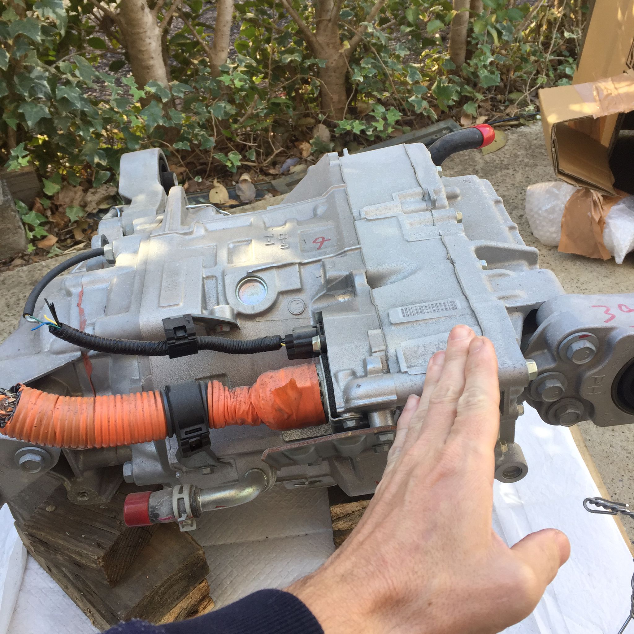

Ive been a long time lurker on this forum and this is my first actual post.
Id like to share my recent acquisition, the rear differential from a 2022 Outlander (GN0W) . As you can see its a total redesign from the GG2W type weve all seen. In particular, the motor, differential and inverter are all a single unit now. In flows what I presume to be DC input (since its only two massive orange wires) and inverter control (the tiny four wires) Removing the "UVW" labeled cover reveals the connection from the onboard inverter to the motor phases. I have no idea what communication this motor will require and Id be happy to execute some tests if anyone would be so kind to help my on my way. I have a range of test equipment and various MCUs to load with whatever could be needed. Im not a total newbie to the electric car world, but this is my first foray into considerably bigger motors. Previous single seat car builds were done with motors from the Yamaha EC-03 electric bike (I believe JDM only).

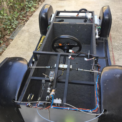

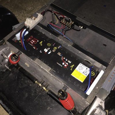

What's the yellow car in the picture?

Wow, that's quite a bargain.
Any chance you can provide some basic dimensions?

Re: 2022 Mitsubishi Outlander rear drive
Hi that is a great motor with inverter built into it
I am using a old setup in my jeep.
would have made my setup much easier I did work for two Japanese companies and enjoyed visiting/working in Japan over the many years.

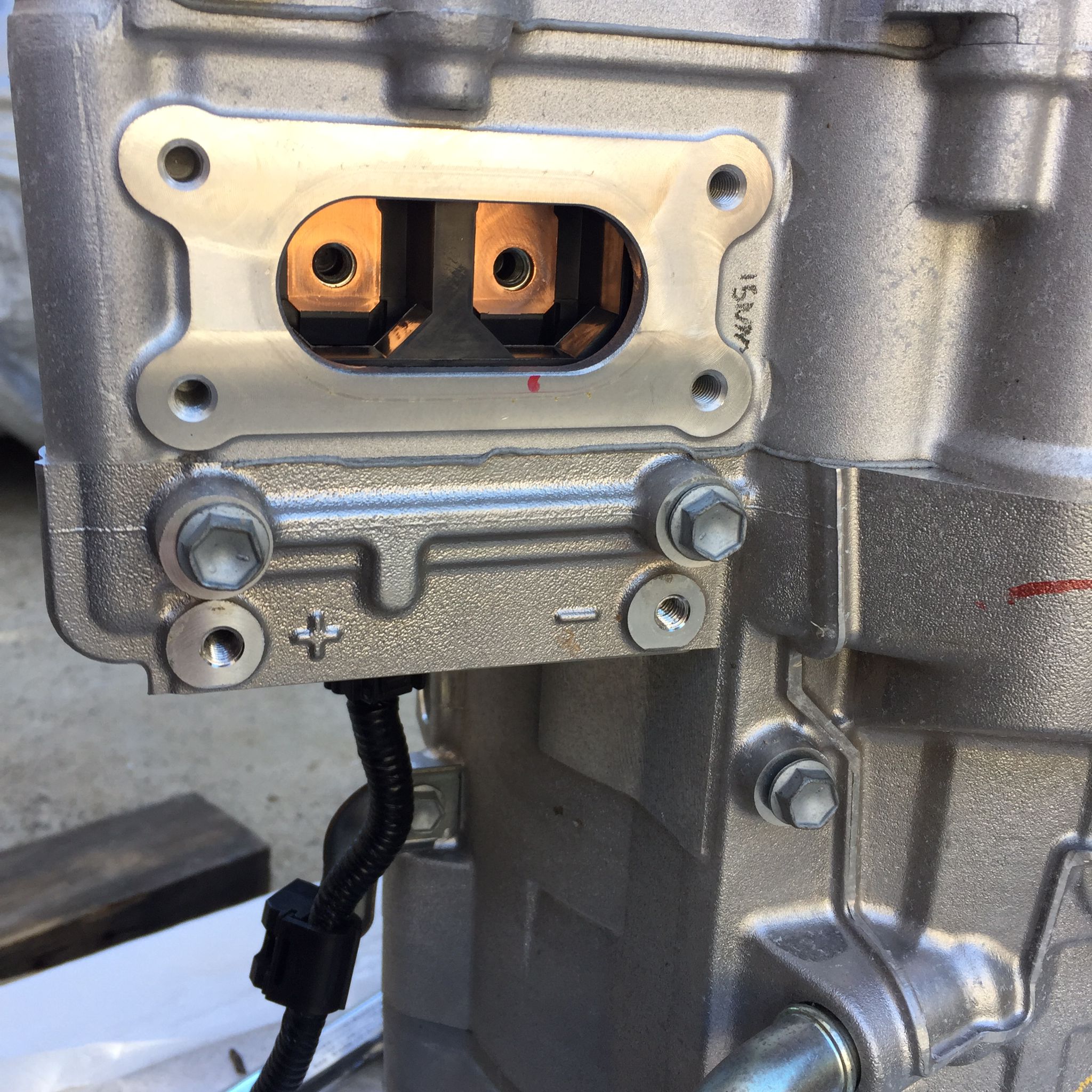

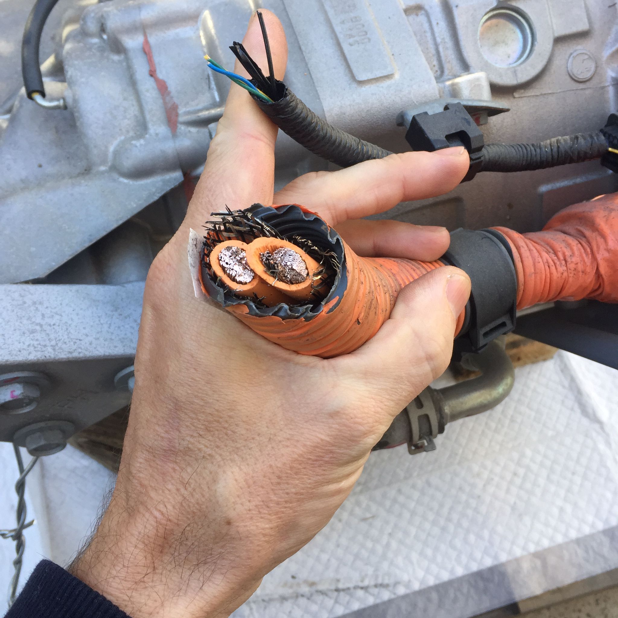

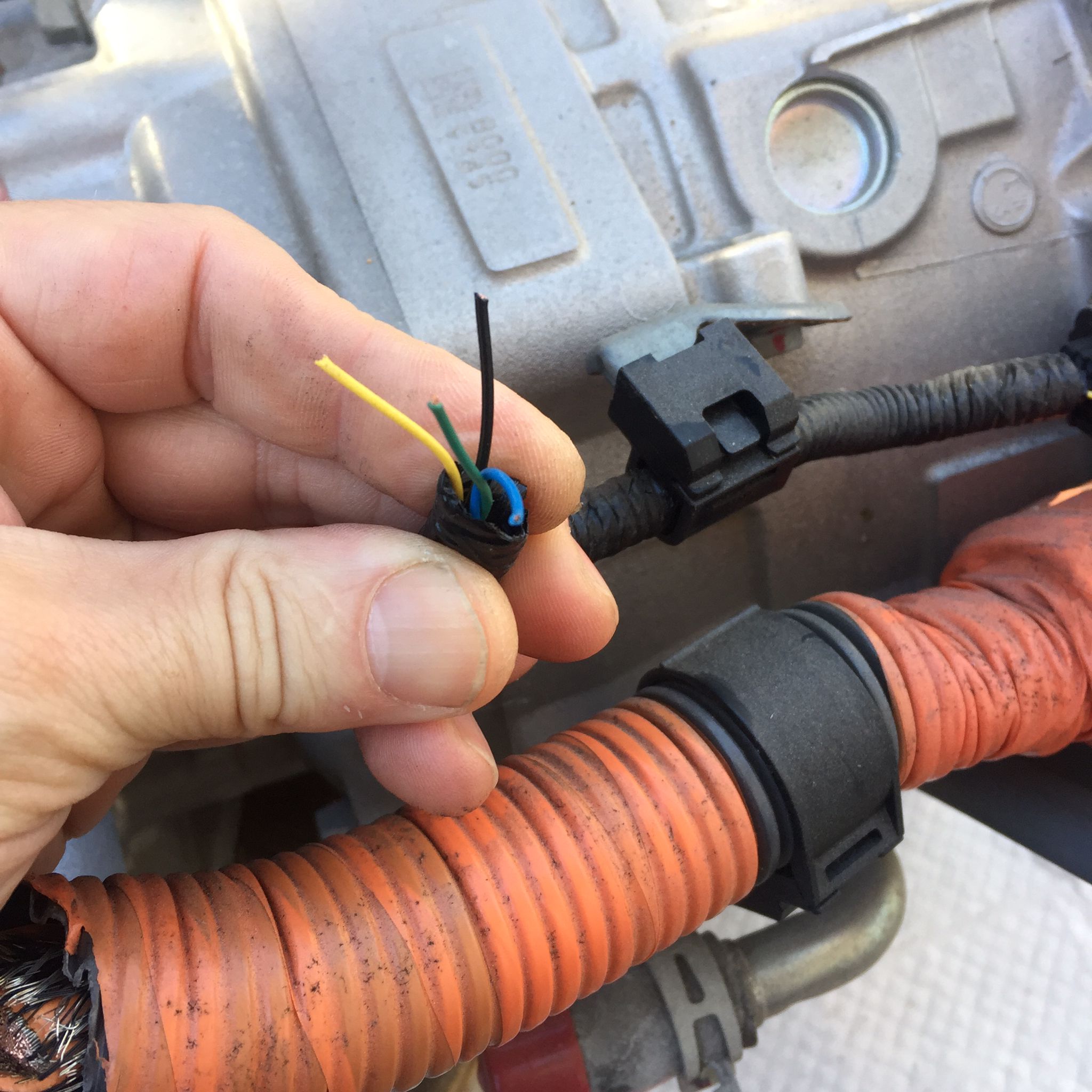

I am pretty sure green/blue wire is CAN twisted pair. Rest is 12V supply and NOTAUS. GND is on the motor case.Alwyn wrote: ↑Wed Nov 29, 2023 4:28 am Ladies and gentlemen!
If you have a DUE CAN board or a CAN reader i could send you simple instructions to observe what kind of
Traffic is on the line.
I could also send you my can shield you can connect with arduino due board for testing.
Interested?
It seems to be 100kW rear drive! Dont know if it is continuous...
https://www.mitsubishi-motors.com/conte ... 022-04.pdf

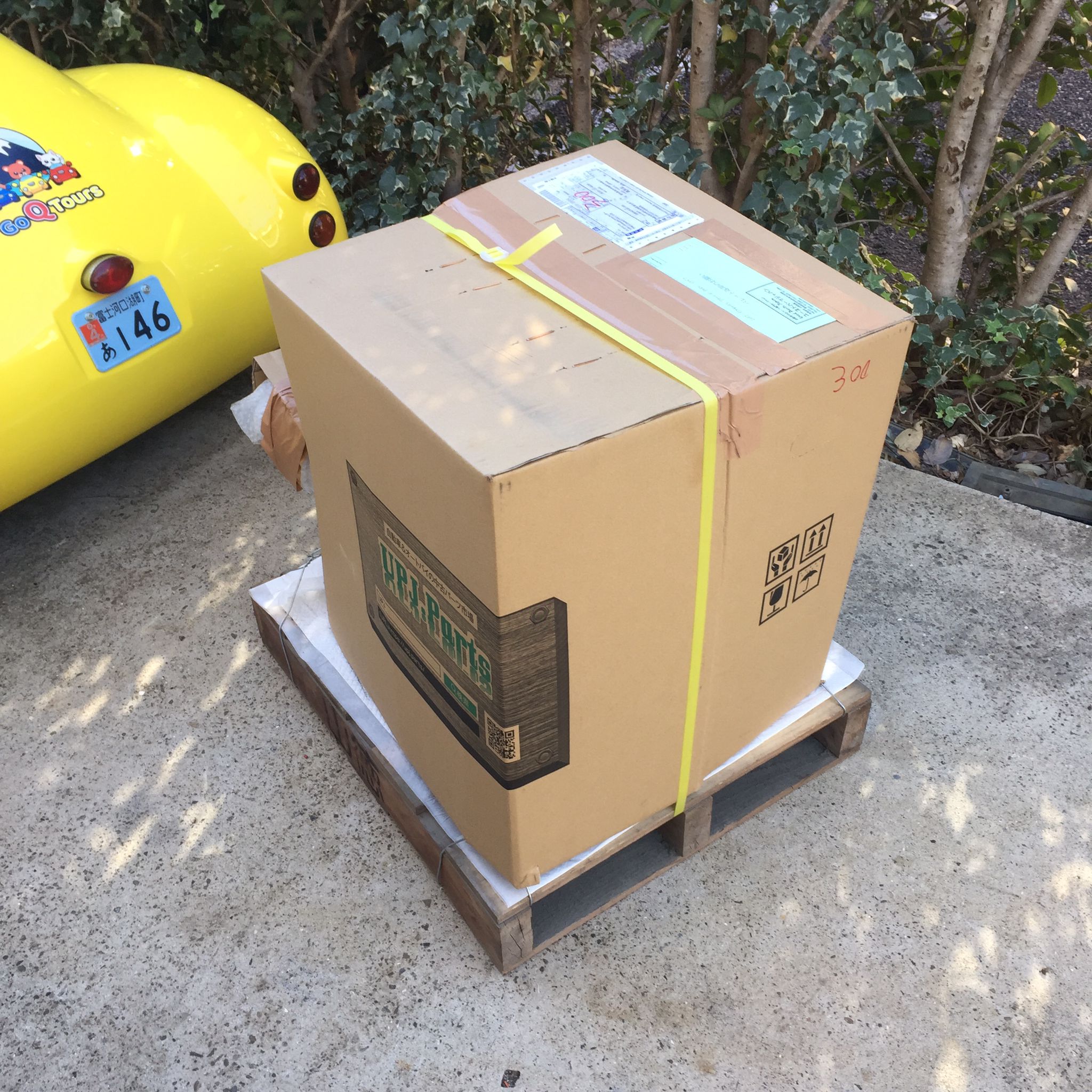

I've investigated shipping from Japan and all quotes for large items come back around £1000 unfortunately.... This was for a GS300H so around 90kg and 700mm x 40mm x 40mm, more if on a pallet.
I just replied to Jacobs PM, but basically I suggested the trans-Siberian land bridge
https://rzdlog.com/for_clients/Trans-Si ... andBridge/
It looks like it may be a viable option for quick and cheap shipping from here (Japan).
Jacob was asking about an IS300H hybrid transmission. I can get one here with 65,000km on for about 20,000JPY, so yeah parts are CHEAP out here. Essentially it starts to become a question of "how big is your imagination", because the cost of critical components is really not much of a thing anymore.

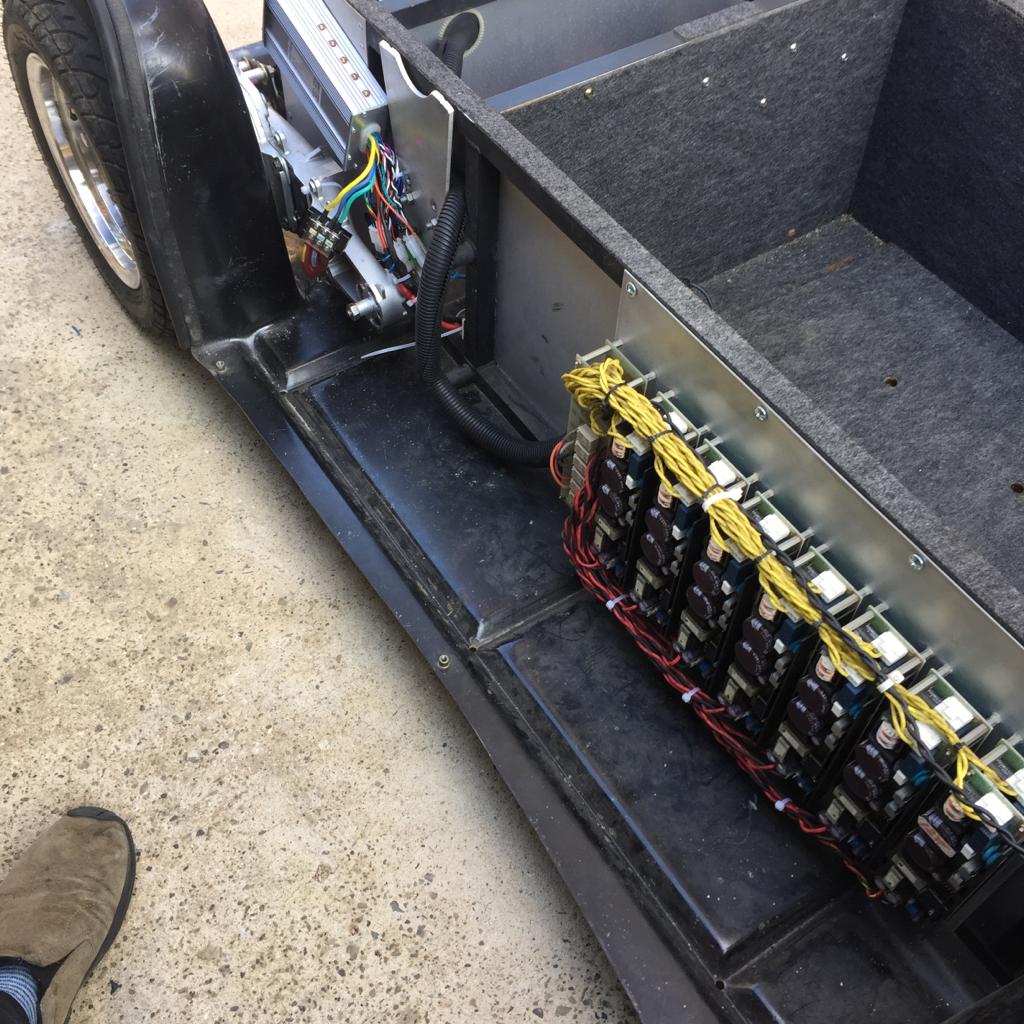

Insofar the yellow car is concerned, its the second one of a pair I'm building/built. Heres some pics of the nicer one of the two: The battery is a 13S2P pack buiult from the Outlander LEV40 cells: Charging is done with a sort of parallel charger: Some pics of the frame: The body is carbon with a TVR inspired pain scheme. Those pics were taken when I delivered the car to its service location as part of a guided tour operation around the Kawaguchi lake at the foot of mt.Fuji. It was exactly a 100km drive from my house to the location and nearly 1000m climb in altitude. In the end the car did super well with a total energy consumption of 4.4kWh over the 100km! The very next day the car was already put into service. One of the punters: -Alwyn

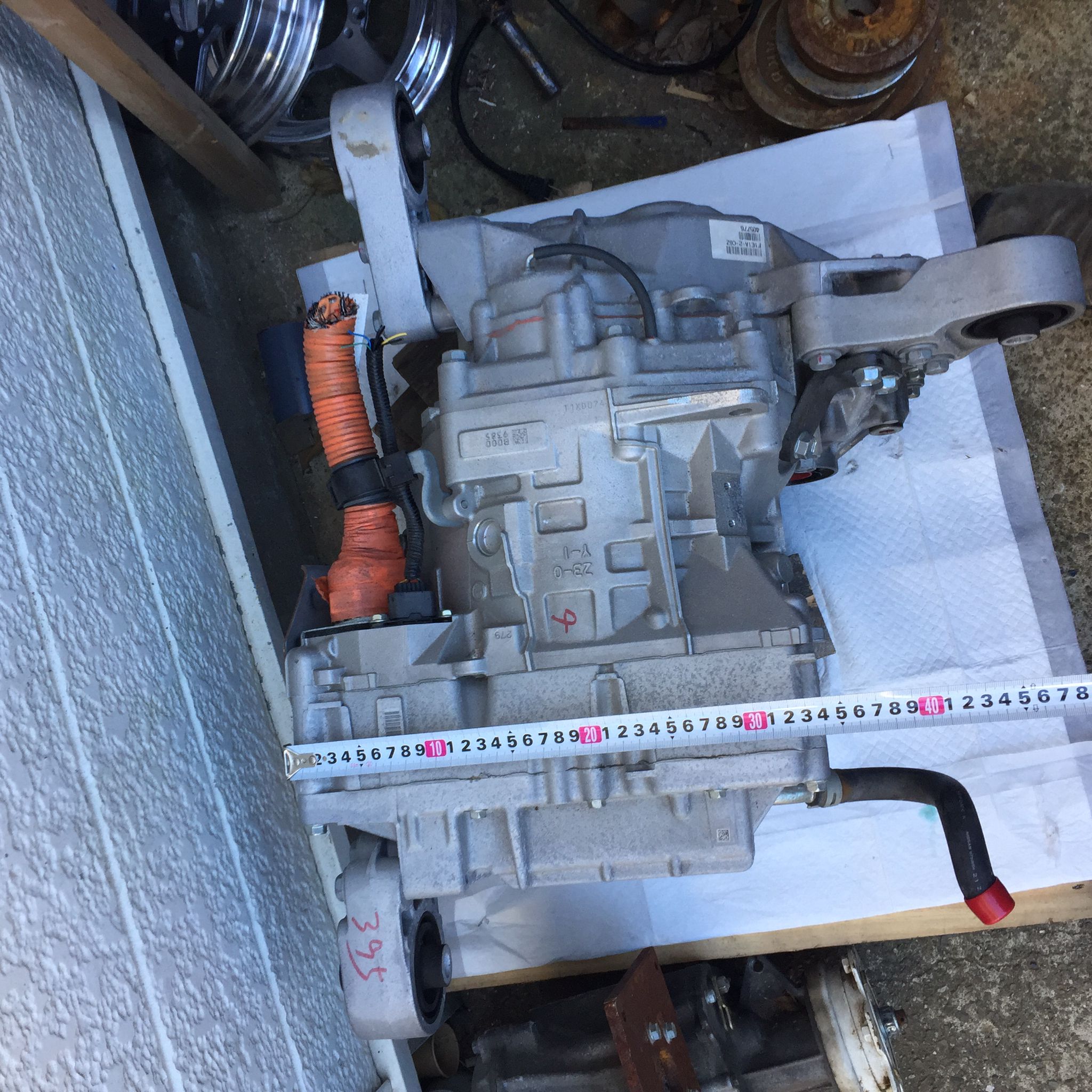

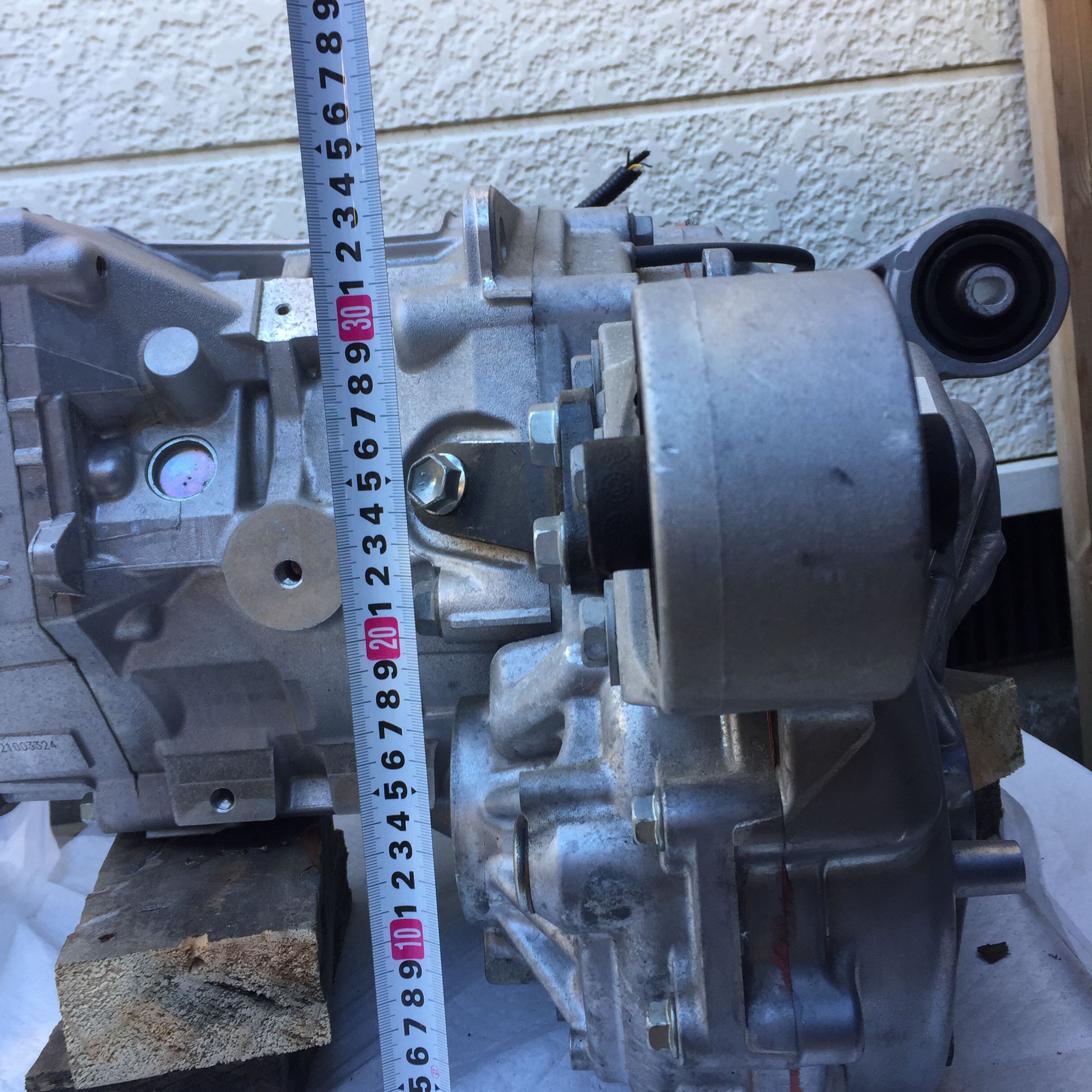

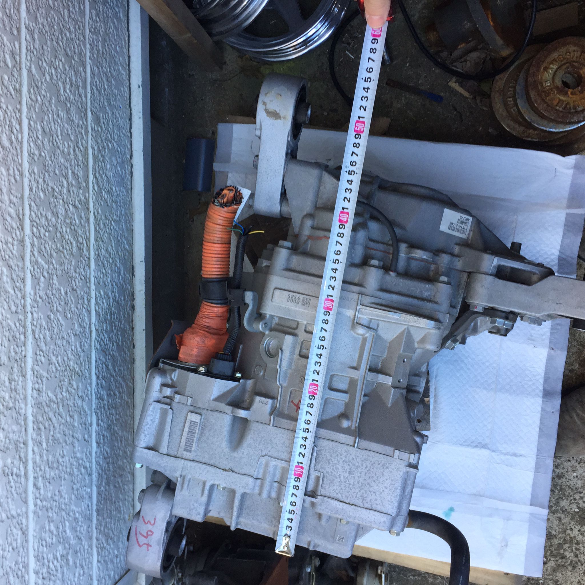

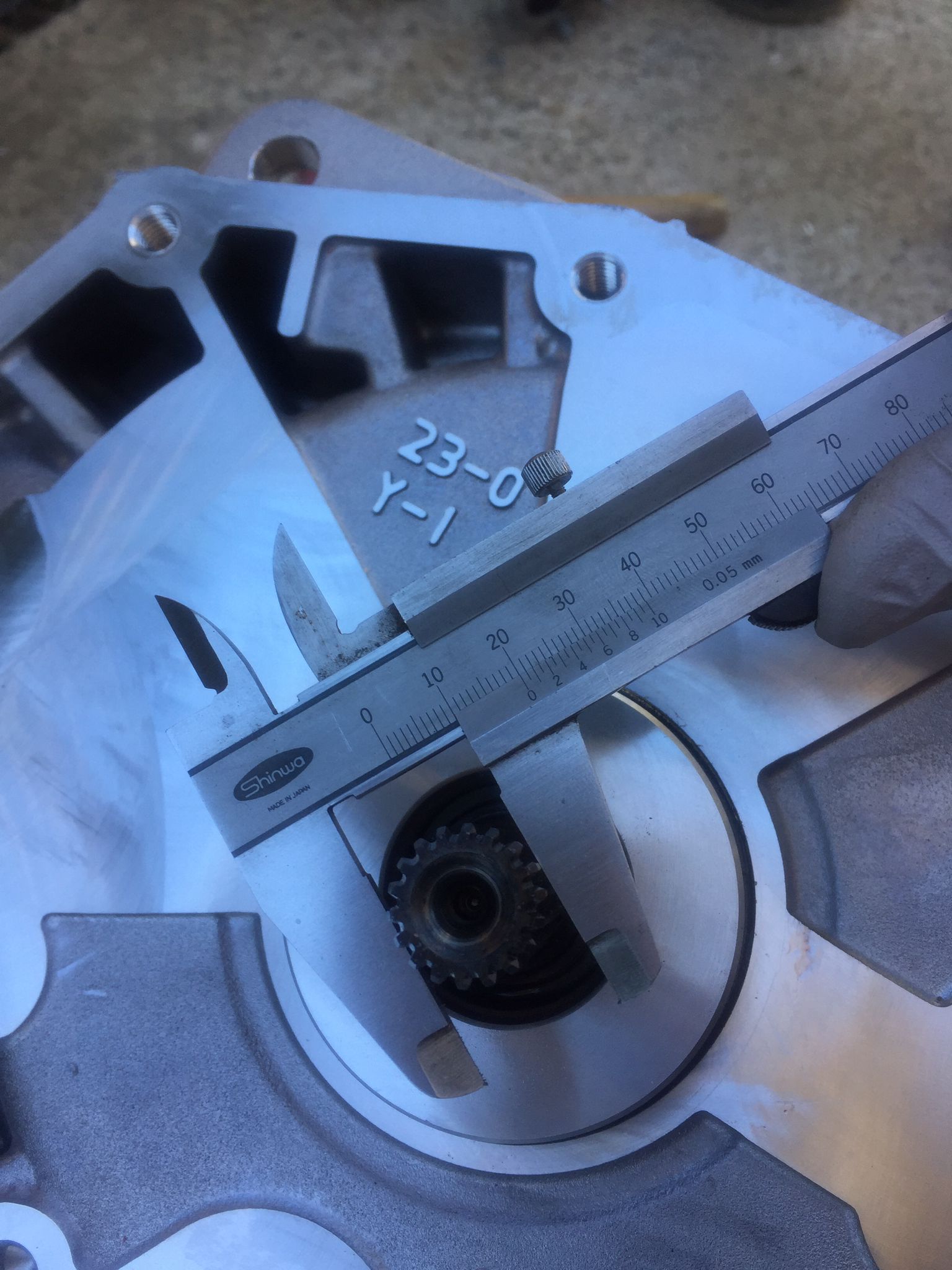

Hello chaps.
I wasnt able to weigh the assembly today as my cable hoist (with scale) is sitting at a friend's garage right now.
Heres some pics of the principal dimensions:
Left to right of the enclosed space (sans (without) mounts) measures 470mm
Front to back measured 340mm. Including the diff housing edge we come to 420mm
From the flat top to the bottom end of the diff housing the measurement comes to 350mm again
All the holes in the mounting dampeners (bushing?) are oblong. The distance from the left mount's extreme inner edge to the right mount's extreme inner edge comes to 570mm.
Curiously, the bolts that hold the gearbox to the motor are all 16mm bolts or alternatively known as 5/8". The rest of the hardware is all metric.

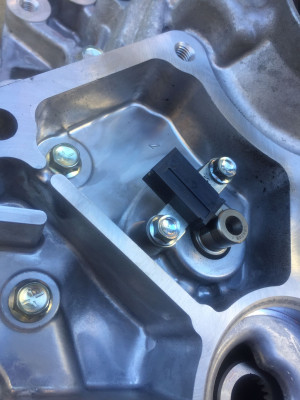

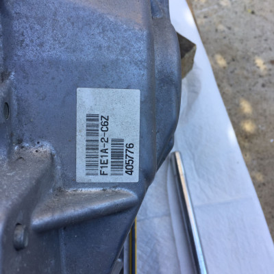

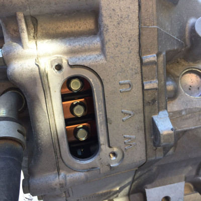

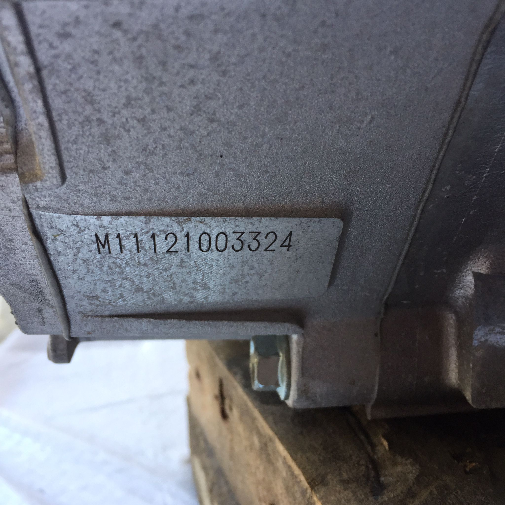

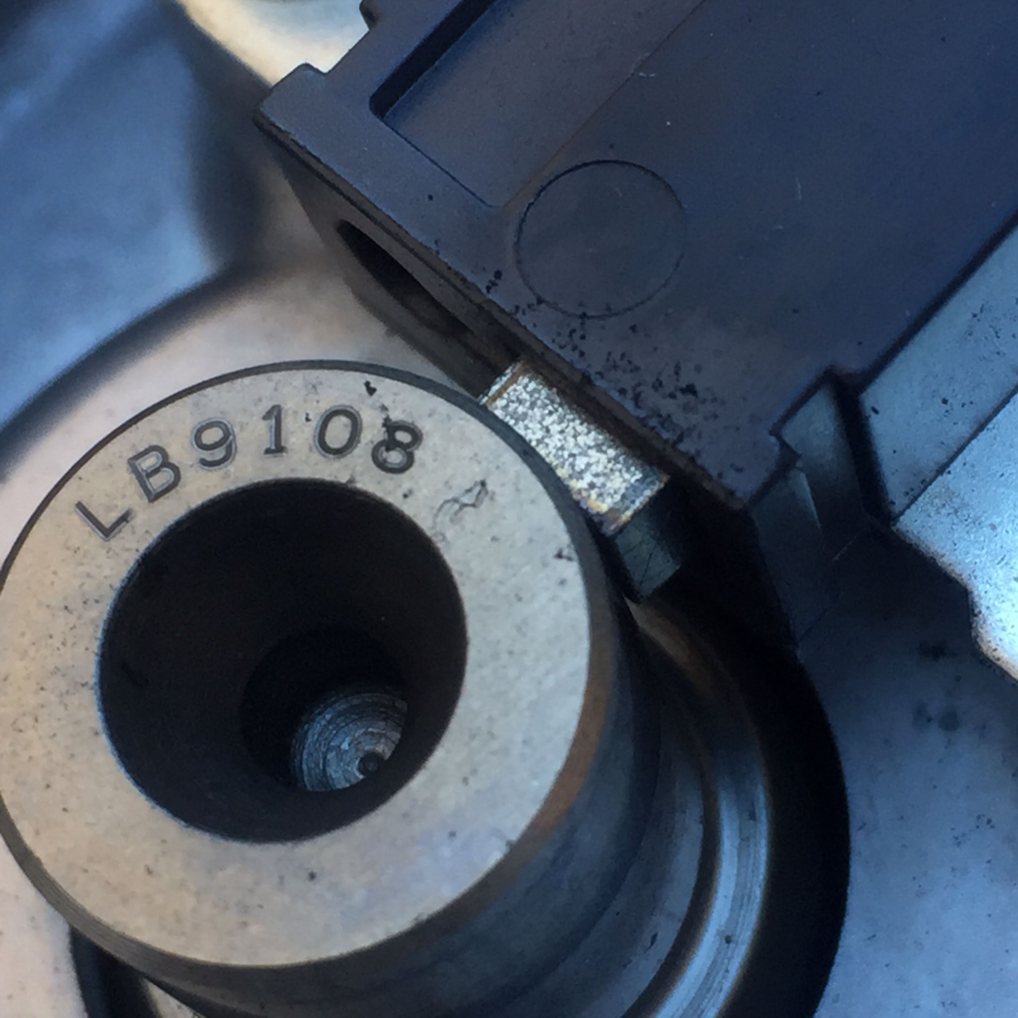

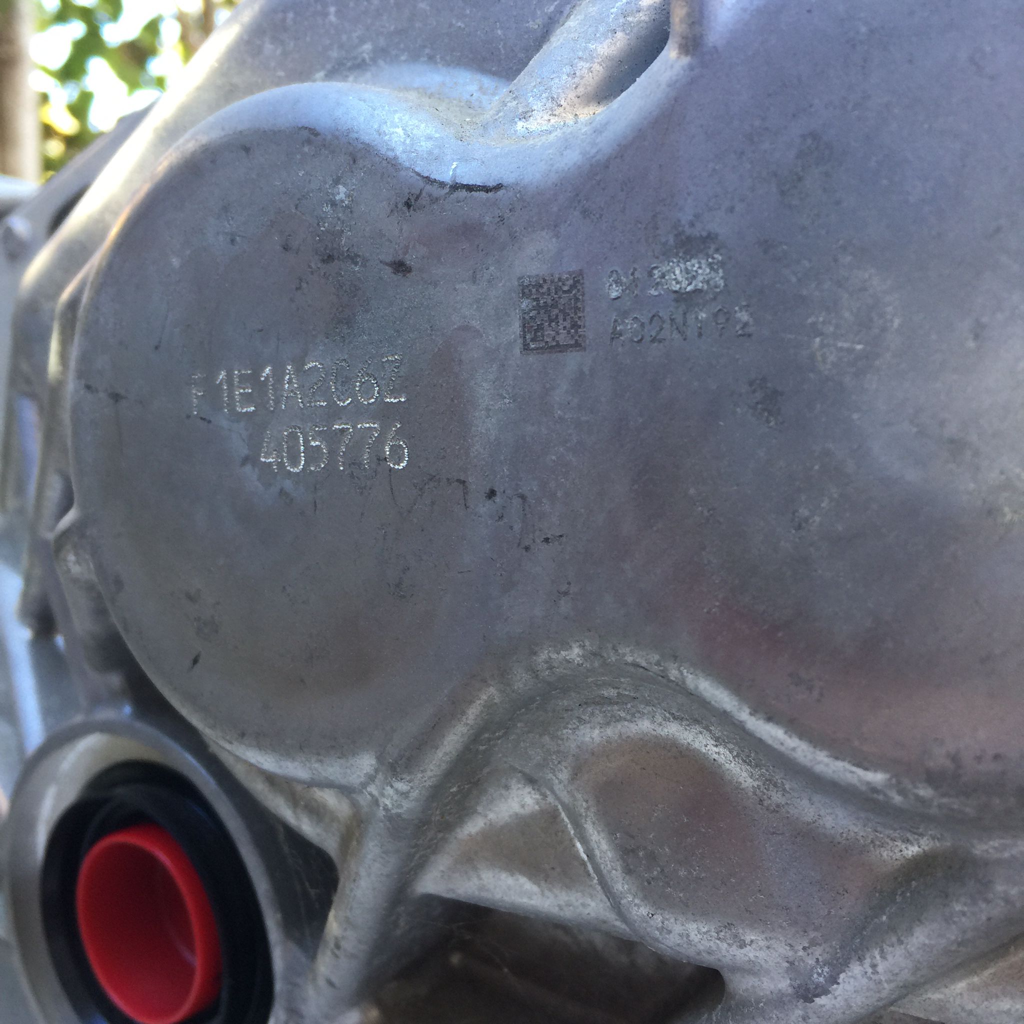

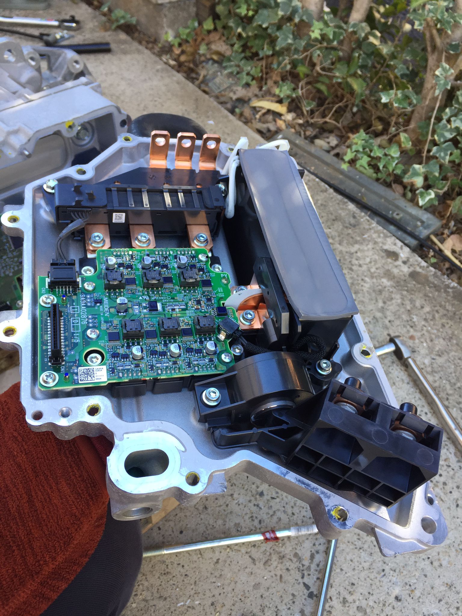

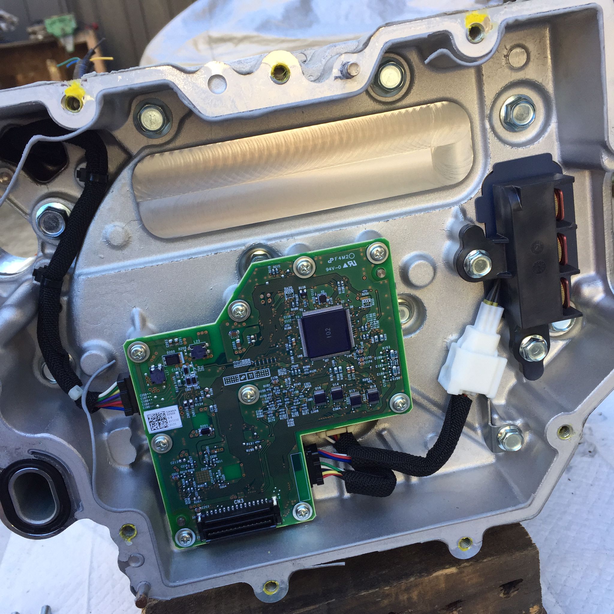

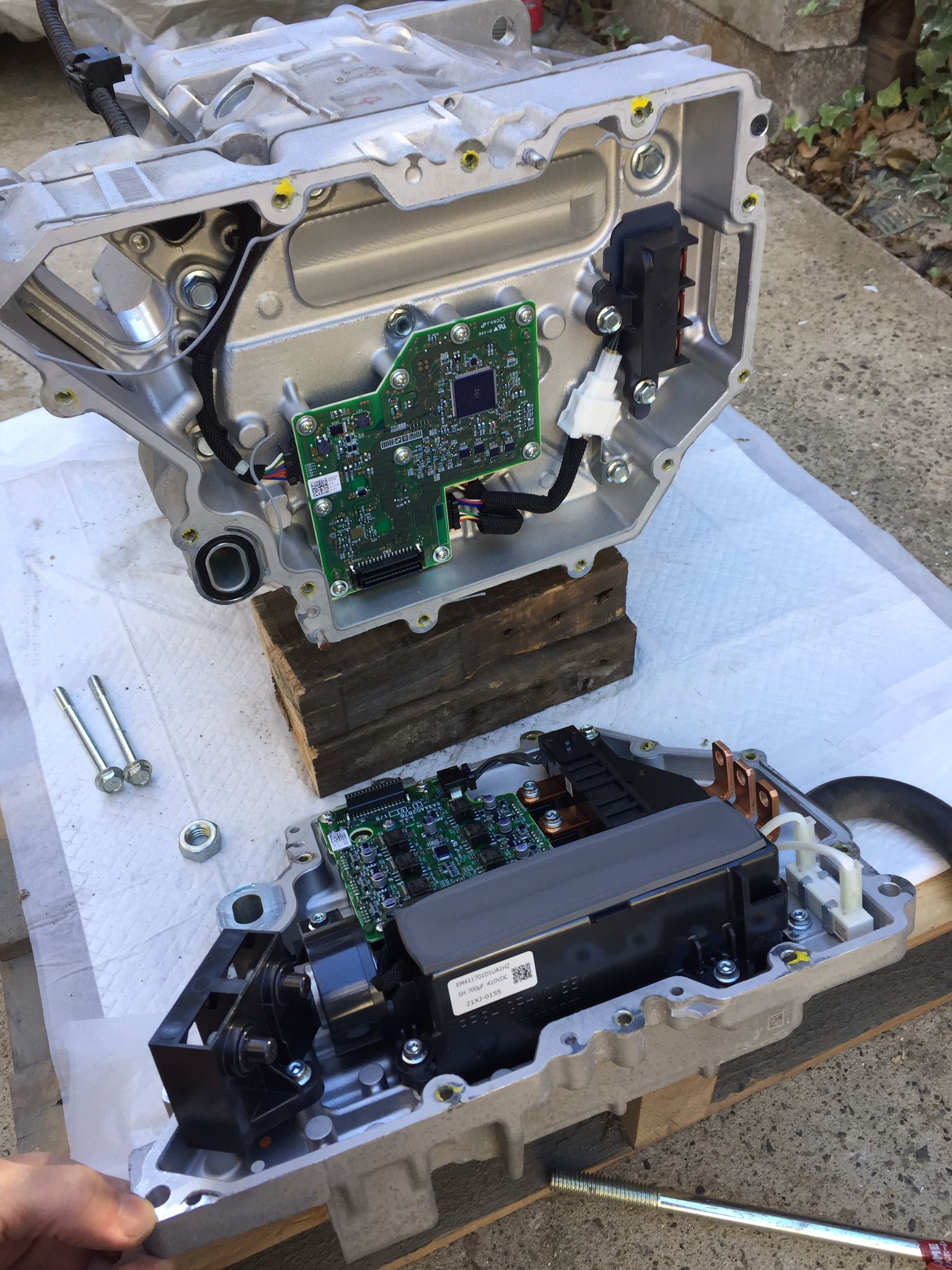

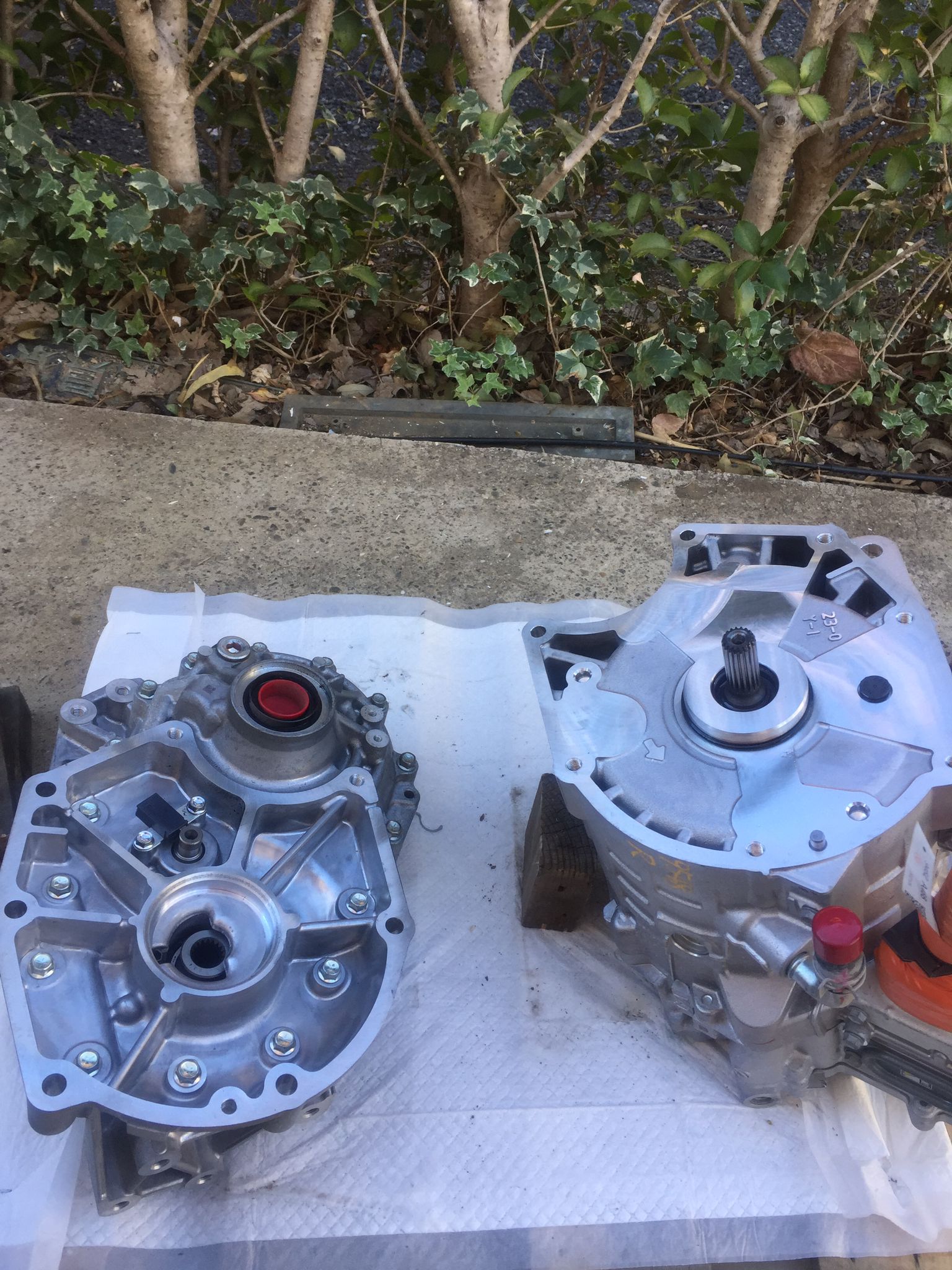

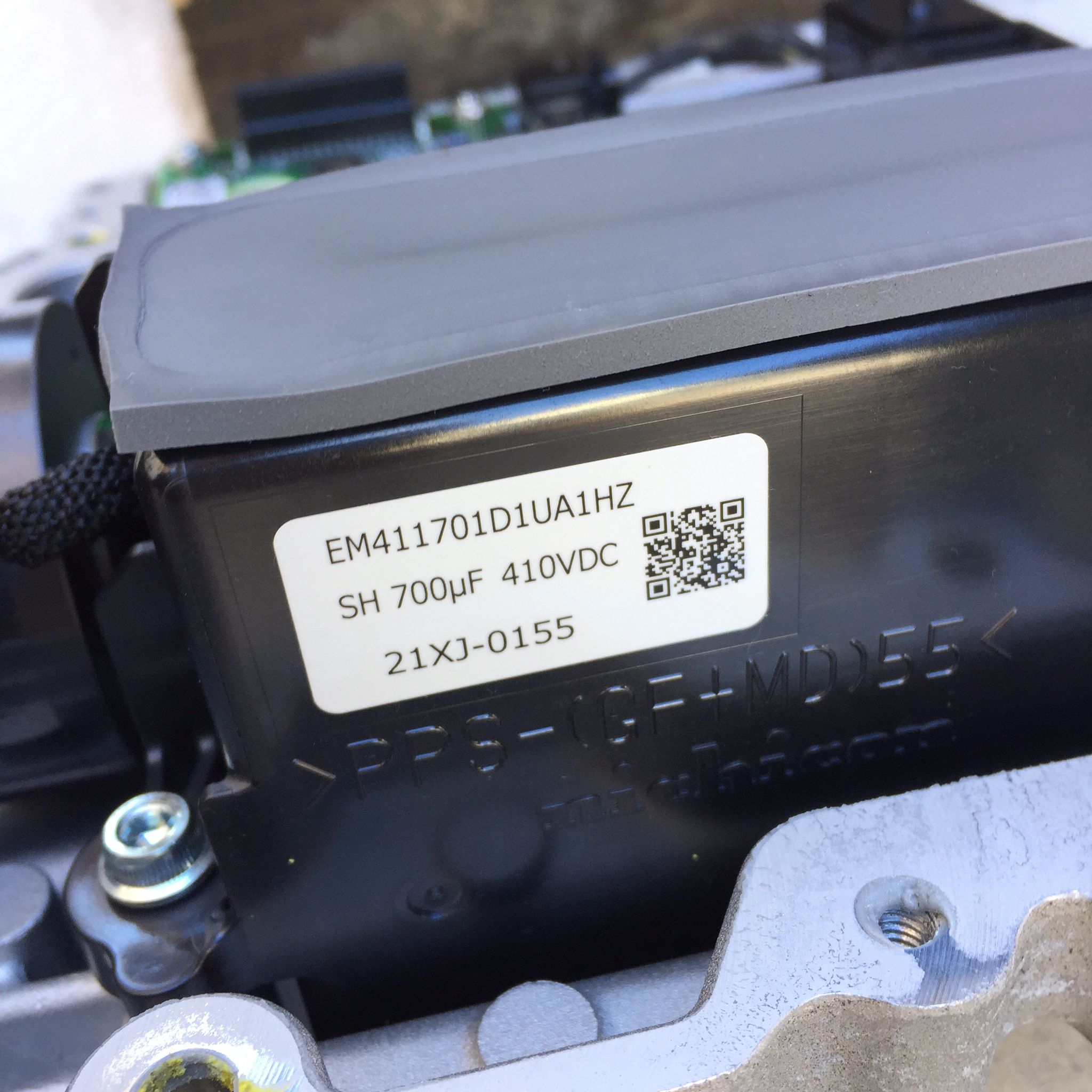

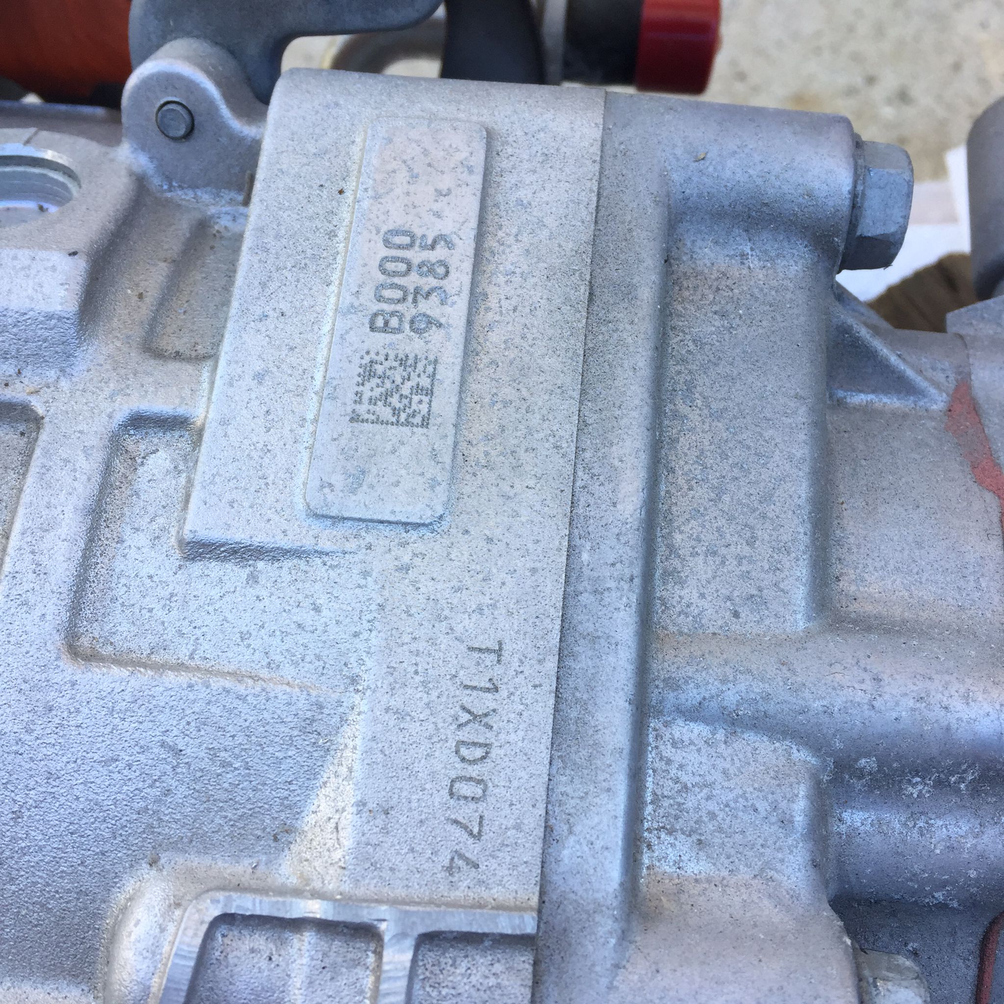

More pics of the motor teardown!
TLDR: Its pretty awesome. 47kg motor+inverter combo. 17kg for the gearbox+diff
Here we go!
First, every number I could find on the device (for those interested). How nice to indicate required polarity: The inverter inside. Truly an amazingly small package considering the power output: Cracked open. Theres this curious brush thats not connected to anything (with a wire). I think its there to ground the gears directly instead of through the bearings. Here we find evidence to support the incredibly low mileage of this specific unit, the brush is not even worn away to full-contact. Please ask some questions if theres anything youd like me to check.
-Alwyn
Here we go!
-Alwyn
