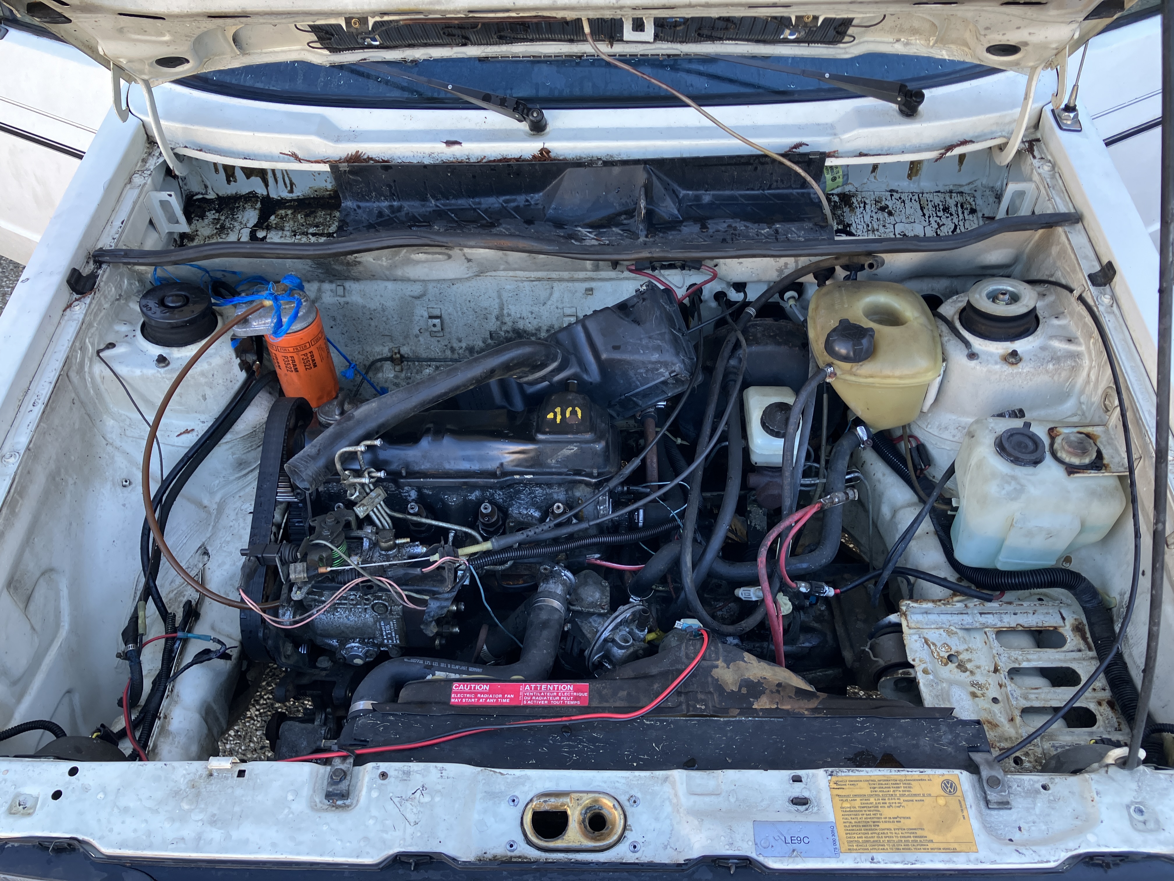

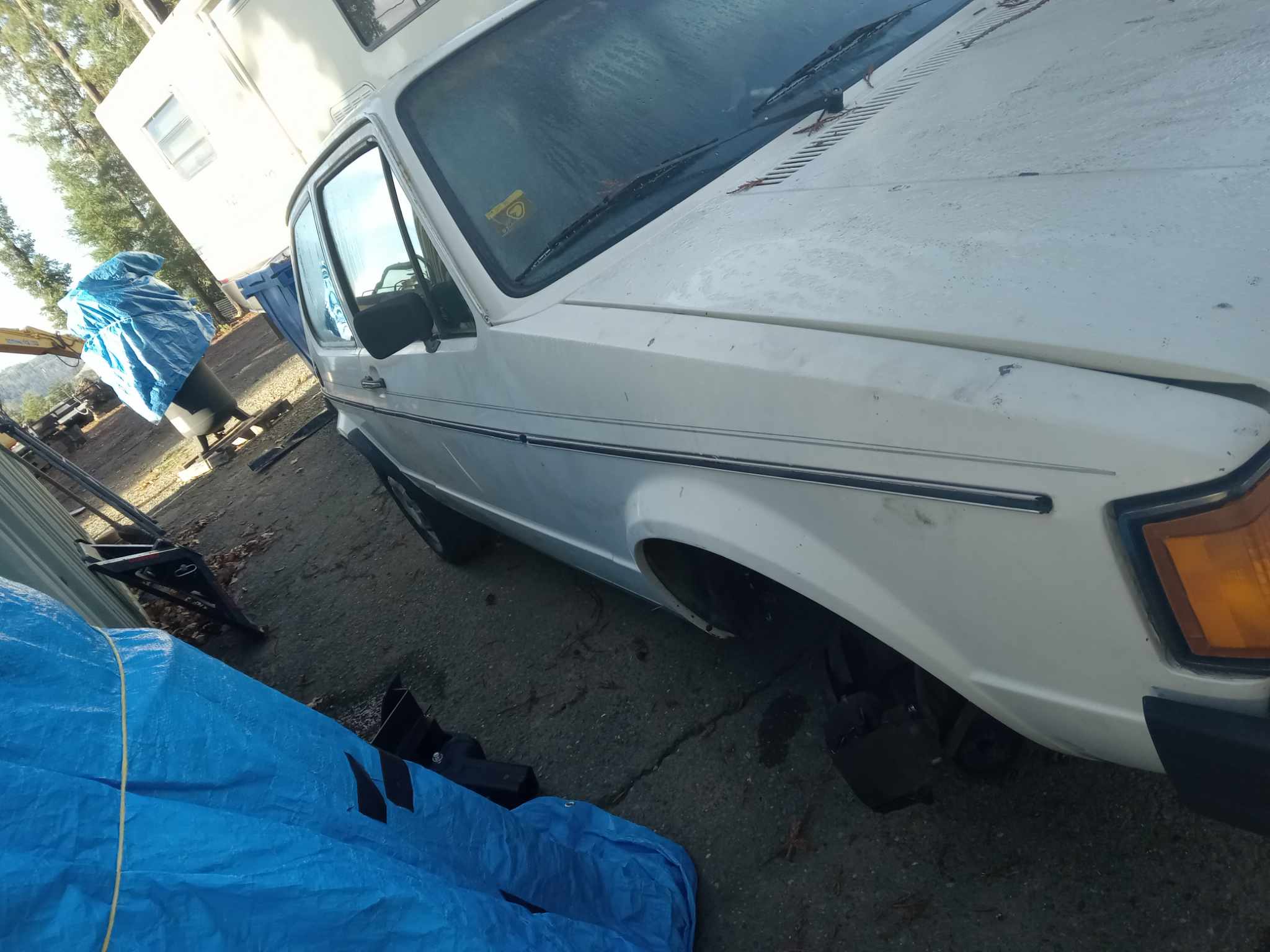

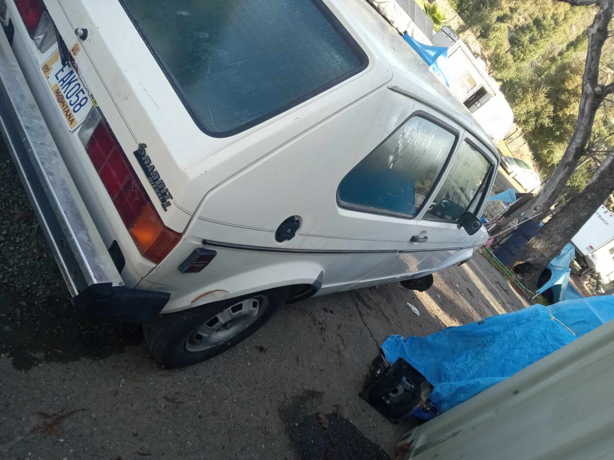

so there I was, left all alone unsupervised, "don't do it, don't you dare click on Facebook Marketplace" said the voices in my head, "go ahead, it won't hurt to [ahem] just look" they retorted - sometimes I talk to myself, cause I need expert advice, you know
at this time in my life I needed another car project like a hole in my head, especially yet another EV Conversion - I'm looking at you Damien Maguire you seed planter you!
... and there she was "Snow White" as I would affectionally call her [sometimes... among a million other things] and she was perfect, checked all the boxes too:
Not red... ✔
Not wrecked... ✔
Not running... ✔
Not gasoline powered (pronounced: diesel) ... ✔
Not four doored... ✔
Not rusted... (well let's not split hairs)
Not too far away... well... you get the idea
She was listed for $1,500 and I am not the type to negotiate over the phone, so I negotiated via Facebook Messenger, I hit him with $1,250 and he said he would do $1,350... I said maybe, then once there after a thorough 30 second inspection I pointed out a grapefruit sized hole in the rear floor pan and we shook on $1K provided I could get her registered back in California since it was a Cali car registered out of state [insert your favorite avoid registration back fees evil scheme here] many many hours and $264 bucks later at the local DMV I had an * INCOMPLETE APPLICATION * for the Title, meaning they would issue me one once I got the VIN verified, all vehicles entering or reentering California must get a VIN verification.

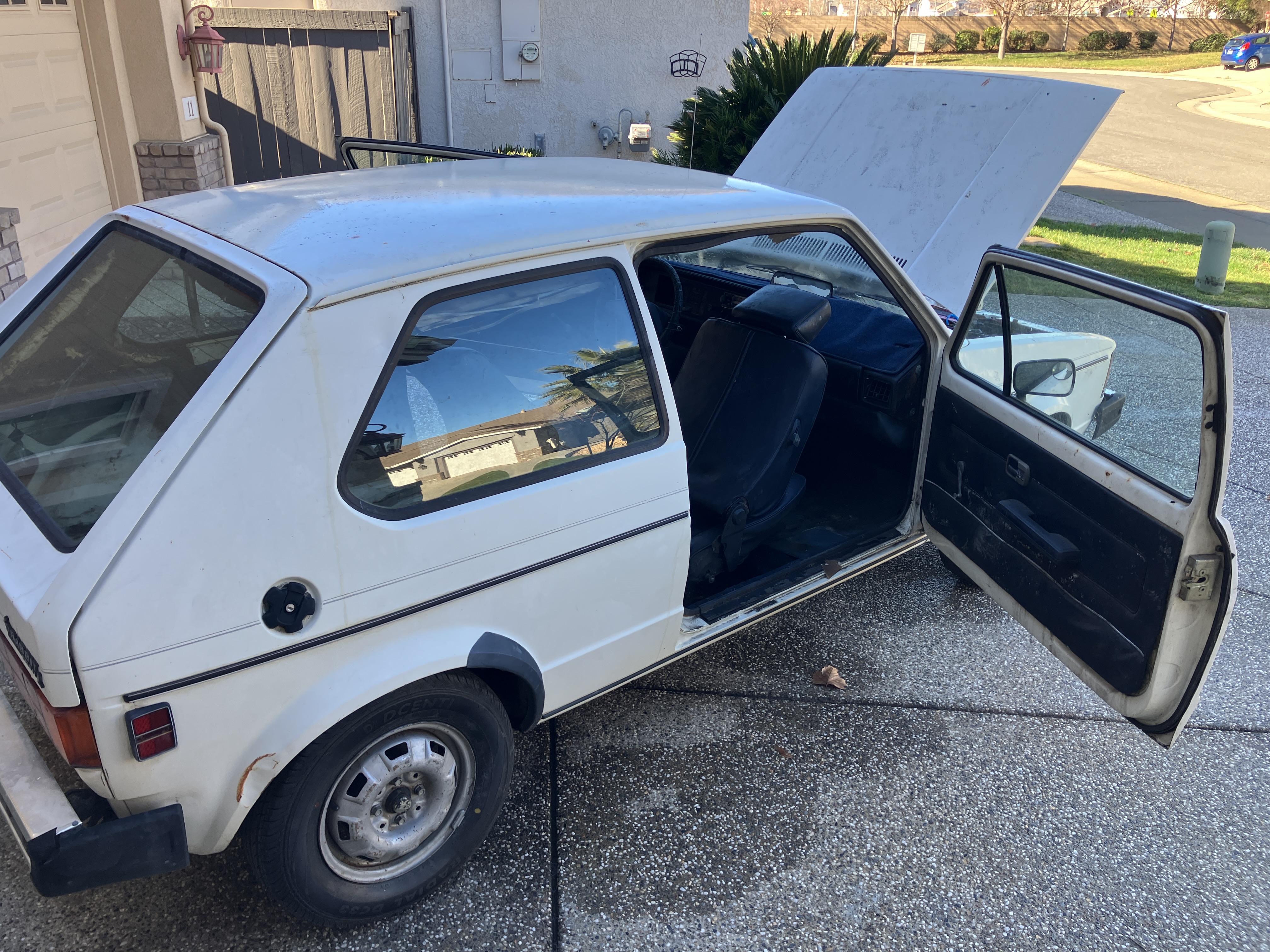

here she is as listed

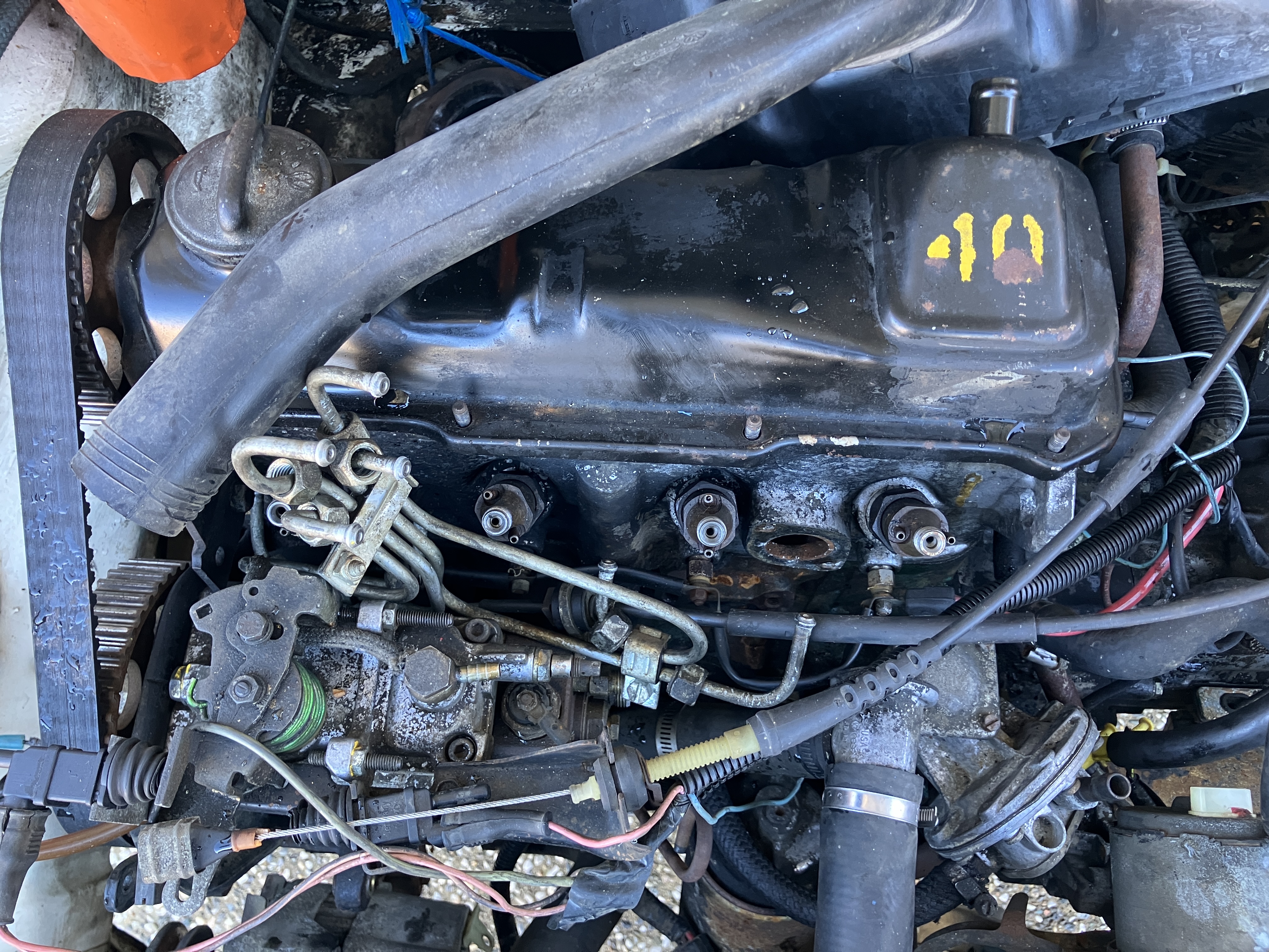

The 1.something fire breathing diesel enjin, coming to a Craigslist near you !
with more enjin crap in the trunk... [ahem, pardon me] the boot
