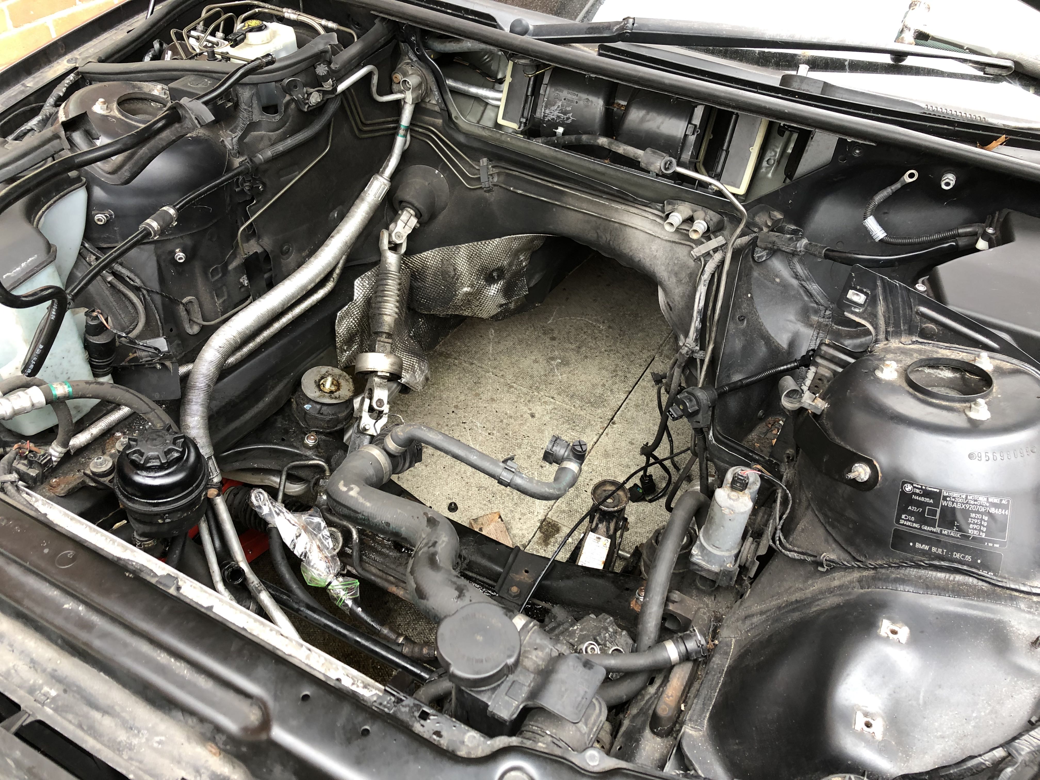

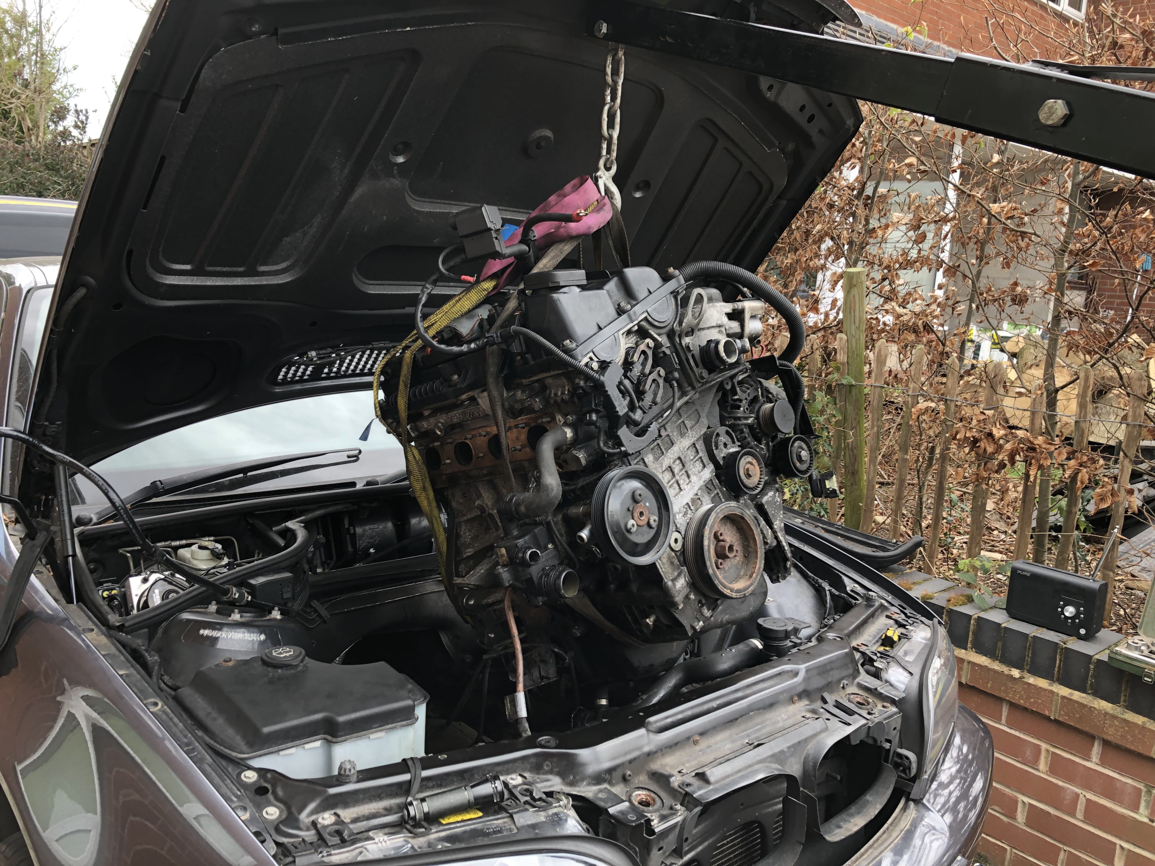

Not wanting to be outdone by Mr Bauer, I finally got the engine and gearbox out of my E46 coupe.
Here's the engine coming out and the hole that's left over:

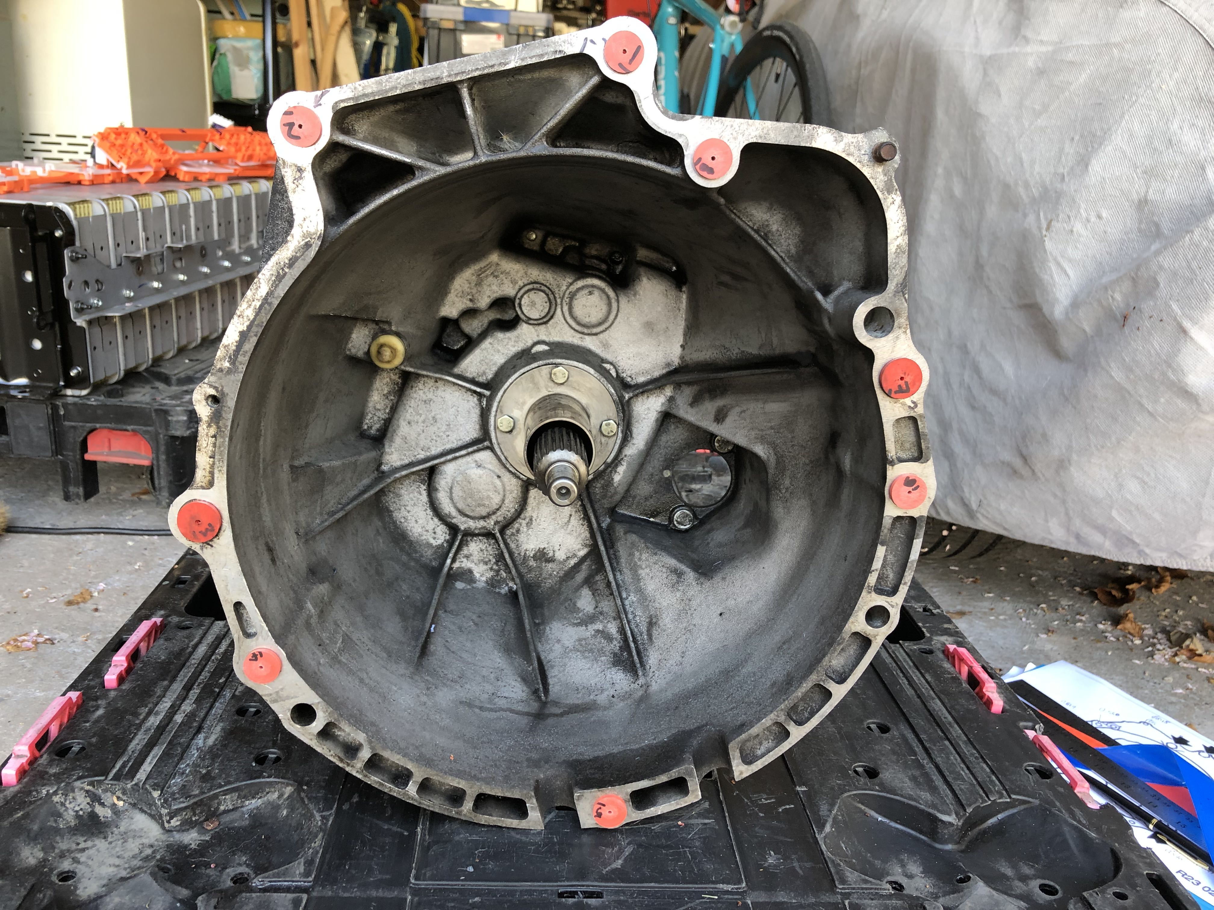

I started thinking about how to measure the flange on the gearbox. I decided to make some plugs with a small hole in the centre to measure to. Here's the gearbox with its protective layer of oil. No wonder the clutch juddered!
Here's the same gearbox cleaned up:
Next up, get the motor mounted up and get the inverter sorted!

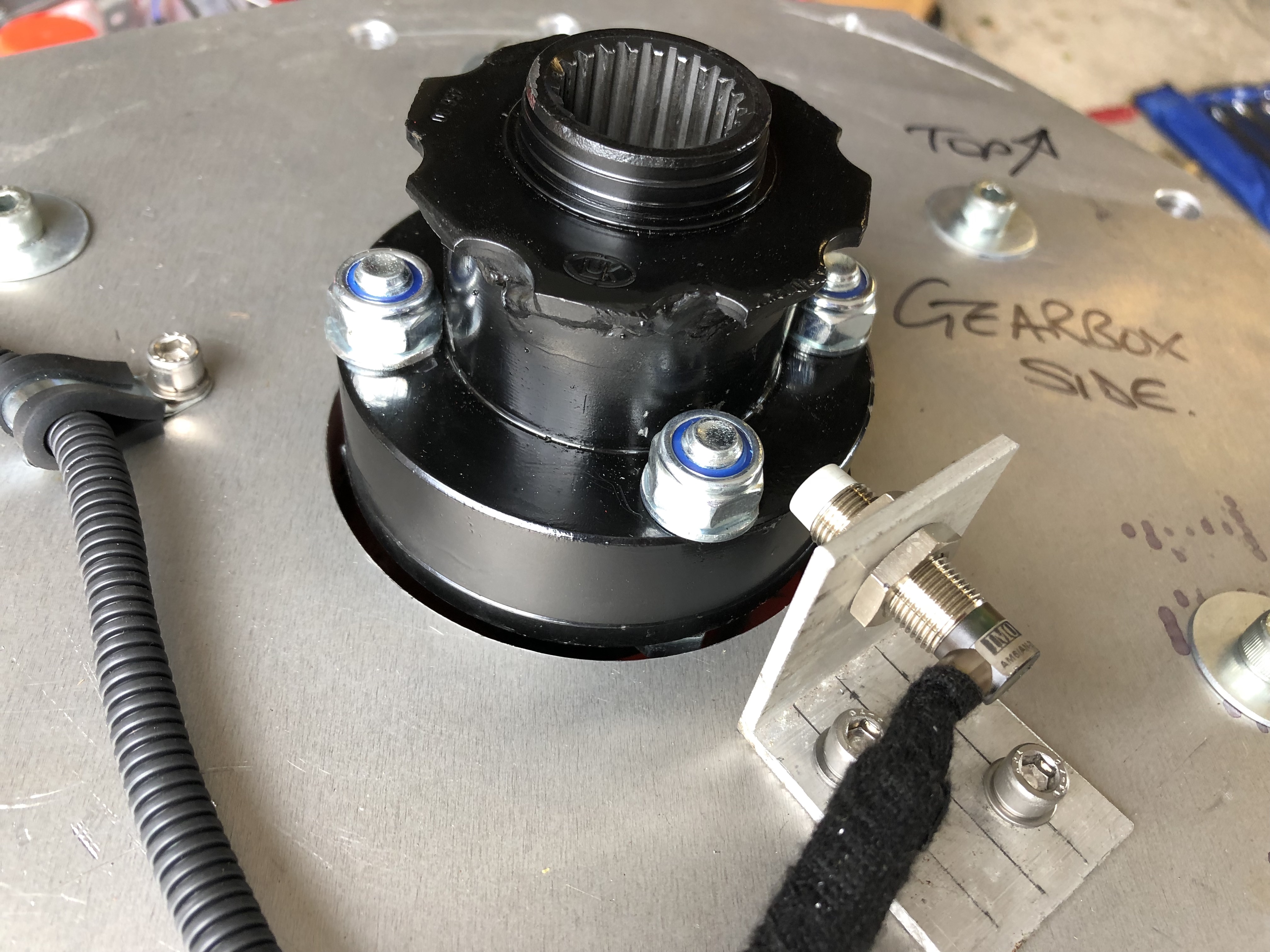

Had a couple of good days on the E46. Got the coupler sorted out and the proximity sensor to measure RPM:
and got the motoring gearbox back in:
Had it running on a 12V battery. All good so far.
Just laying in some ducting for the battery cables underneath, then I can put it back on its wheels.
Also, need to make a front motor mount. Currently I'm using the Jack Bauer patented acme plywood block!
