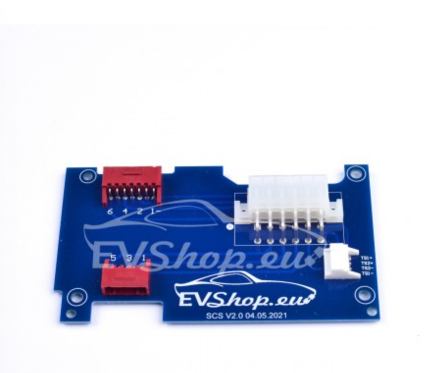

Urgently wanted. I need 8 more of them. Generation 3, that fit the modules with the ribbon cable
I'm in Dublin, Ireland. Can pick up in the greater area or will pay for postage
Like these:
https://evshop.eu/en/bms-accessories/20 ... -rev3.html

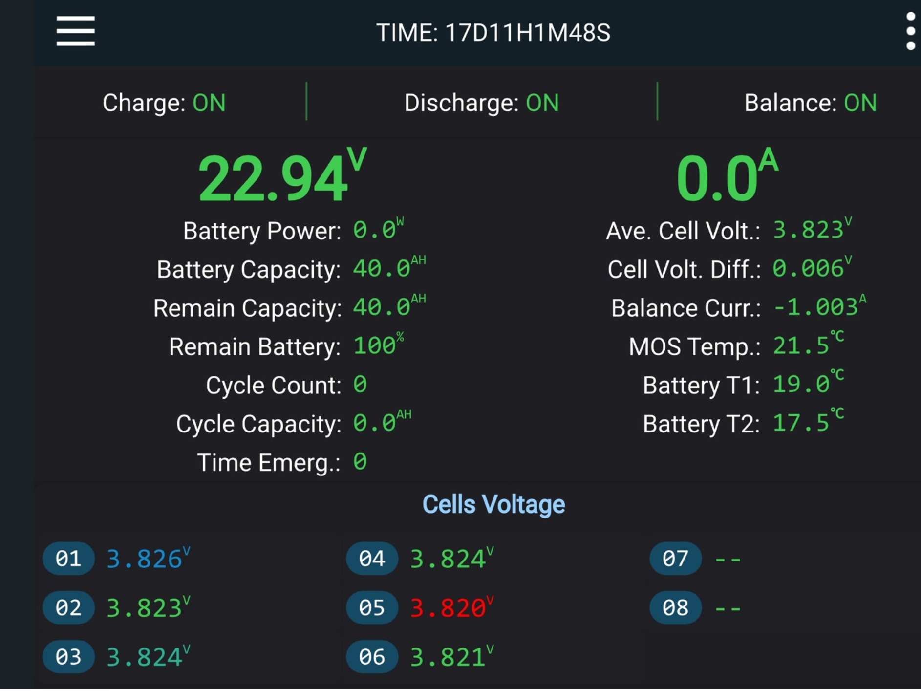

Re: WANTED: Tesla Model S BMS tap boards
Post by unkel »
No longer needed, figured out the Tesla slab uses standard JST 5 pin and 7 pin connectors. So I will just buy a bunch of those for peanuts. Connected to my spare JK BMS this morning and the pack is balancing away:
