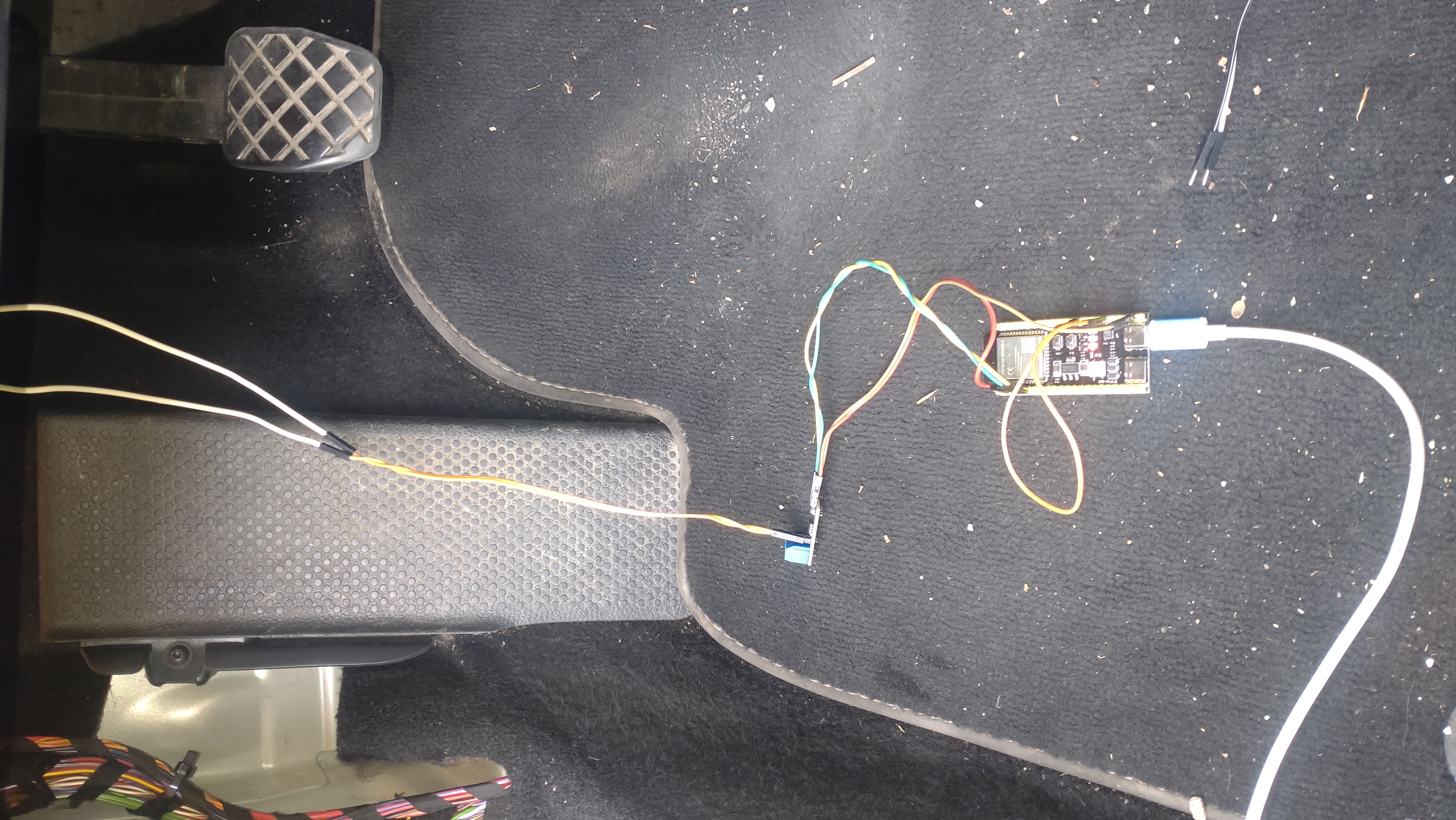

For info, I bought an ESP32-S3 wroom and will attempt your setup.
I (think) I have setup my Nucleo board to send a message in loopback.
Plan now is to copy your .io file using Arduino to ESP32. What I understand is that once that is done, I can connect it via Savvycan and 'listen' to CAN bus .
Then connect the 2 boards via CAN and hope to see traffic....

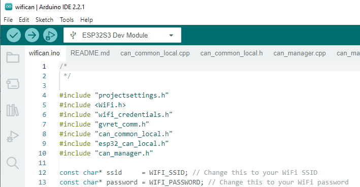

You write "Add zip library", this sounds wrong. You need to get the sources from github, either using git clone, or downloading as zip from github. If you chose the zip download, unzip the project, and the unzipped folder IS your sketch folder. Just "open sketch" and select the folder with the unzipped files. You do not need to install extra libraries (at least I hope).

Re: Use ESP32 Web interface also as GVRET CAN device?
I never used debugging in Arduino, so regarding openocd I have no idea.
Tried a workflow:
1. Create a new folder C:\Sketchfolder
2. Open in a browser https://github.com/uhi22/wifican
3. Green Button "Code", choose "Download zip". This creates a wifican-main.zip in the downloads folder.
4. Copy this zip into C:\Sketchfolder
5. Unzip, and arrange the folders in the way that you have the folder C:\Sketchfolder\wifican, and in this is the wifican.ino. This is because the Arduino IDE takes the folder name as name of the sketch, and the main ino file needs to have the same name.
6. Start the Arduino IDE. In my case it is Arduino IDE 2.2.1.
7. File -> Open..., navigate to C:\Sketchfolder\wifican\wifican.ino. This should directly show all files, with the wifican.ino as most left, because it is the main file.
8. Choose the board "ESP32S3 Dev Module"
The result should be: 9. Rename the wifi_credentials_template.h to wifi_credentials.h, and enter your wifi credentials there.
10. Press the upload button. This takes some minutes to compile. Then it tries to upload.
Besides the failing upload, because I do not have the device connected at the moment, I did not see any error message.

Thanks for the description. I now have a wifican device available in my wifi list!!

Basically, I opened the zip file, changed the template file, put in my wifi details and saved it back in wifican file.
I then connected it to Arduino, opened wifican, verified it, then uploaded it to ESP32-S3.
I put in my current home wifi adress and password in the credentials instructions.

So if I cannot connect to Wifcan from my computer, there is something wrong?
Edit:: on first setup, Pin32 should be pulled High? Connected to Pin 47?
Edit 2 - Should I be connecting a second wifi (dongle) to connect wifican whilst remaining on my home wifi network?
I ask because each time I try to connect to Wifican, I loose home connection first, then computer attempts to connect to wifican,asking to put in my password for home connection as per credentials. This I have done a few times.

@Jacobmess, thankyou for this info!! This was my problem. The Wifican password is "topsecret" and not my home network password.
So once the "credentials.h file has been modified with local your wifi details", load the sketch and connect to the new "wifican network" using "topsecret" as the password. (I assume we can change this directly in the wifi.ino if we want to)
It might seem so simple, that it not need saying. Many days of rebooting later, I have a wifican up and running. I'll add this to the wiki alongside @gregski's CanDue.
Many thanks again....Happy Can sniffing!
