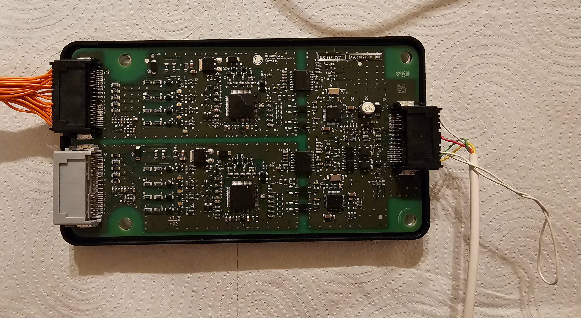

There is one master BMS and six secondary modules. Each secondary has two identical sections: BMS chip (76PL455ATQ) and MCU for communication. There is galvanic isolation between the BMS IC and MCU. (Picture)
Each section monitors nine cells (3 battery modules) or 18 cells for one secondary module. The I-pace battery is a 108S configuration consisting of 36 battery modules. Part of the BMS schematic is here.

The next step was to connect three battery modules. (I have only four available at my lab) There is a specific connection order, and I followed the BMS schematic. After that, the data looks promising:
can0 114 [8] 39 1E 01 58 70 64 3F 10
can0 113 [8] 0E F7 0E F8 0E F8 39 39
can0 111 [8] 0E F5 0E F5 0E F6 39 39
can0 112 [8] 0E F5 0E F5 0E F6 39 39
I've filtered CAN data only from the section with connected cells, and it was easy to find that frames 111, 112, and 113 contain cell data. The first six bytes in each frame are three cell voltages, and the last two are temperatures.
The cell voltage encoding is straightforward: 0xEF7 = 3831mV; I'm unsure if the temperatures 0x39 = 57 may be divided by four to get the actual temperature.
For frame 114, I can say nothing except that byte 8 is alive counter. I will do more testing, and now I'm attaching one log file with live data.
And one picture of the device under test:

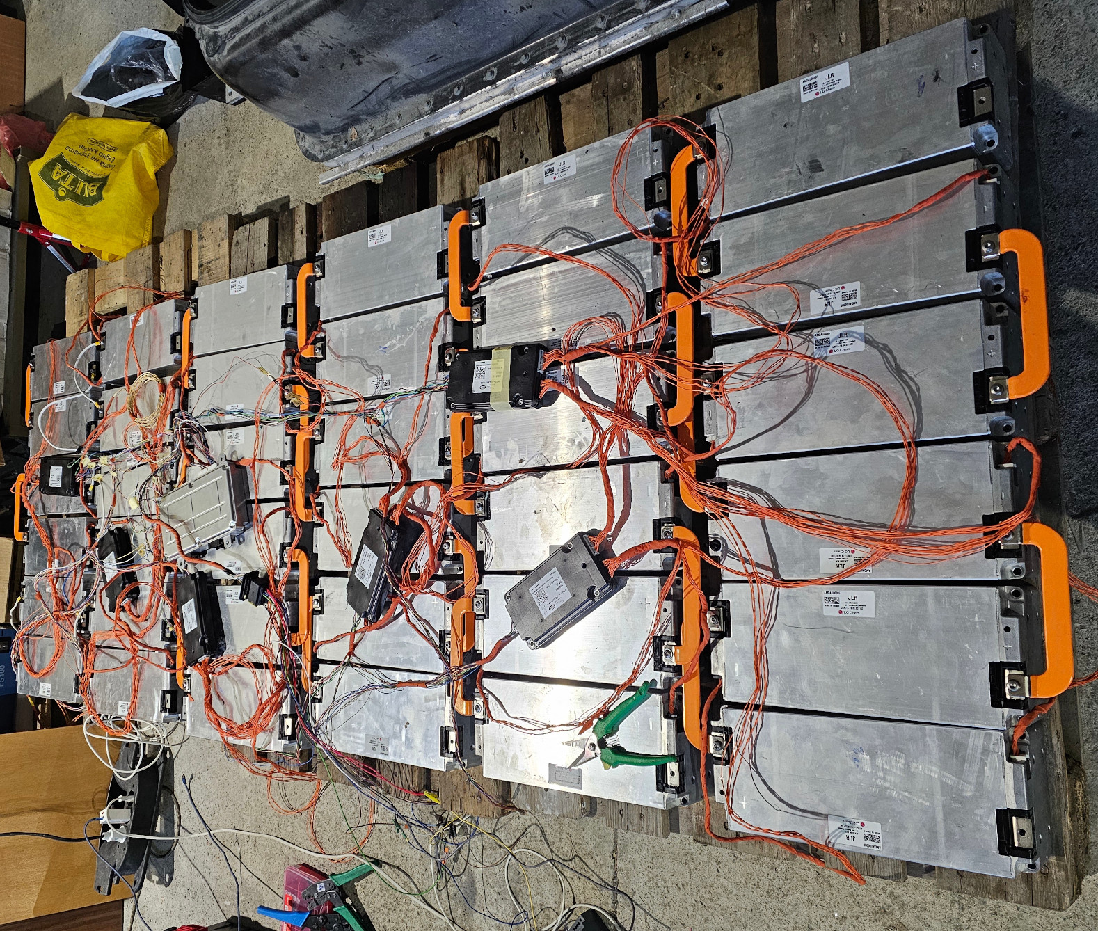

A few weeks ago, I attempted to reconnect the whole battery:
This enormous battery has many wires, and I only had a day to play with it, so reconnecting was incomplete.
I've captured some logs and am sharing them. Some of the findings so far:
* The central BMS probably requires a specific CAN frame to go into an operational state. It wakes up on any CAN frame and starts sending data, but after a while, it stops for a moment and then starts again. (master_CAN_ipace.txt). This bus needs external termination.
* Each secondary module transmits data with its frames: the first one is 0x111-0x114, the second is 0x121-0x124, and so on. There are two logs on the internal CAN bus. The difference is that I swapped the first and second modules.
The first module was out of balance, and I expected some balance commands.
Some frames may be related to the balance commands, and I will experiment with CSC modules when I have more time.
