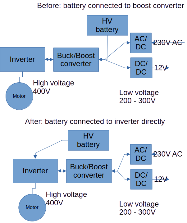

Many hybrid inverters feature a buck/boost converter. It can step down the voltage from the motor to the battery side to charge the battery with a fast spinning motor. And it can boost the voltage from the battery to the motor side to make the motor spin fast from the battery. Battery voltage in hybrids is typically about 200V.
In addition they feature a DC/DC converter from HV to 12V to run the "car" systems. It sits on the battery side of the converter.
The Prius Gen2 inverter features this and due to its not too integrated design we can faff around with it.
First of all, when using the Prius inverter to power an actual EV we will find that the converter is "in the way" as it sits between the battery and motor side and is a bit of a weak link, limiting battery current to about 100A.
Secondly we will find that when using a regular 400V style battery salvaged from a PHEV or EV the voltage exceeds the rated input voltage of the DC/DC converter.
With a simple mod we can fix both these problems We disconnect the positive battery cable from the boost converter input and reconnect it to the boost converter output i.e. the motor side of the converter. This has 2 consequences
1. The inverter bus is now straight connected to our HV battery and can draw as much power as it can handle
2. The DC/DC converter still sits on the buck converter output and by running the latter at, say, 50% duty cycle will feed it with the 200V it expects
With the Gen2 inverter this has a 3rd consequence: in parallel with the DC/DC converter there is an auxiliary inverter. If we replace its output IGBTs with a bridge rectifier and feed 120 or 230V AC to it we will have a rectified DC voltage of 150 to 300V on the boost converter input. So now when we run the boost converter it will feed current into out HV battery - we have created a simple mains charger.

I assume the same can be done with the gs450h inverter? Does it also have the auxiliary inverter to run the same setup as with this?
- Been thanked: 1913 times
Re: Doing useful things with the Prius Gen2 buck/boost converter
Sorry, just found this. With the SMT version of the Prius controller this is integrated. In drive mode the "user PWM" pin runs the boost converter at a fixed rate. In charge mode the regular PWM runs it in current control mode.MattsAwesomeStuff wrote: ↑Wed Jan 31, 2024 4:50 am Also, does any of what you described require using new pins or telling the buck/boost what to do? Any code or software? Or does it just happen by being connected?
Here we do indeed need additional hardware: an extra current sensor that measures current delivered by the AC/DC.
There is no replacement logic board for Lexus inverters. I don't know if the buck/boost converter can be controlled with the Serial protocol? And I'm pretty sure it has no aux inverter.

The booster is limited to 100A, so this will get you 10 kW

I think I mostly understand this, but not sure I'd apply it correctly.
Could you diagram the change like you did in the first post, so this is idiot(me)-proof?

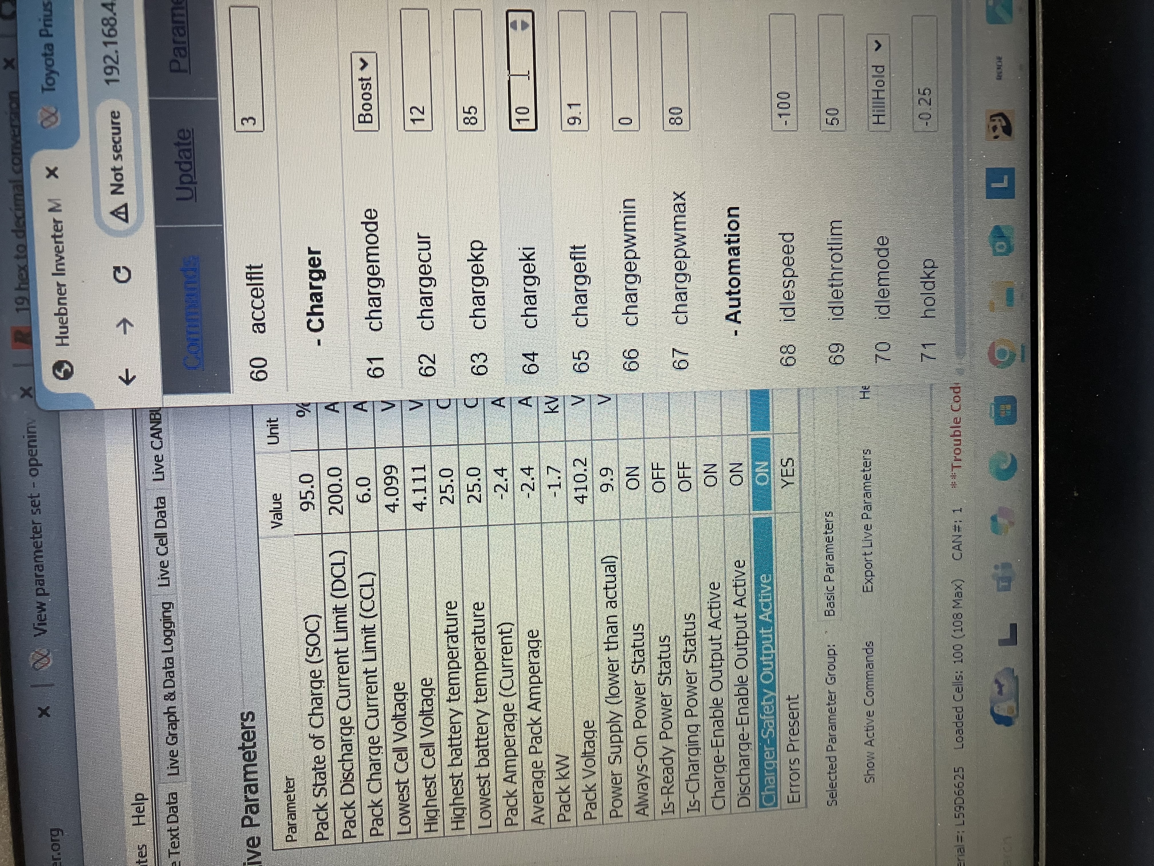

I'm inching closer to doing the charging side of this on my build (once I get my BMS actually working...) and I naturally have a ton of questions. I'm planning on documenting it all in video form and can take a stab at writing it up for wiki if i manage to figure it all out.
I'll stick to one question for now- looking and poking at my "spare" (water damaged) inverter, I'm wondering if the AC inverter board is doing anything important for the rectification side of things, or if I can just stick a bridge rectifier next to it and just hook up the +/- from the rectifier to the terminals on the board to connect to the wires that go to the top side of the inverter?

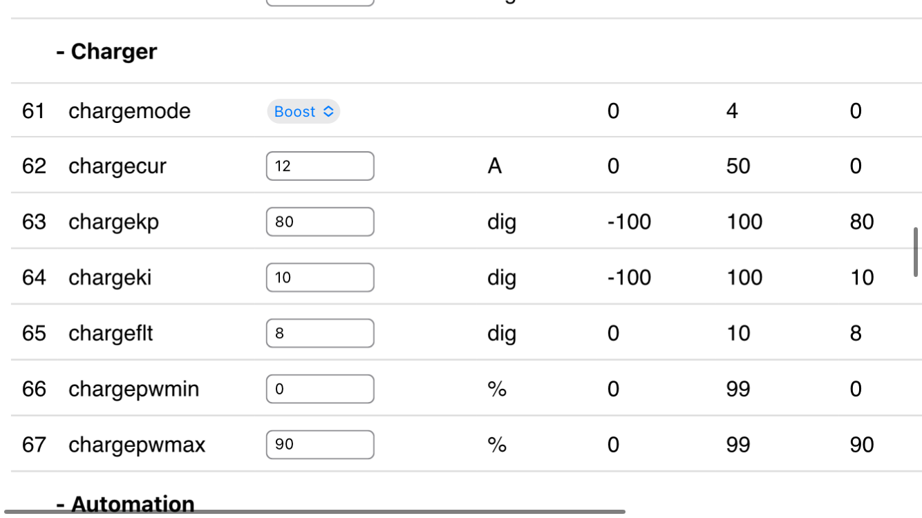

I finally got my BMS back from Ewert, got everything hooked up and drove around the woods a little bit yesterday, so I’m back to thinking about adding a charging system. I had a couple more questions, but in sitting here writing them, I realized I was misunderstanding where the current sensor goes. I was thinking it was on the line going to the battery, but now I realize it goes between the rectifier and the buck-boost converter.
So now my questions are:
1) If I run a separate cable from the buck-boost to my rectifier (rather than going though the ac inverter), would I still need a relay to switch the current sensor, or can I just let it hang out when it’s not charging? I guess I should do some testing with the current sensor I have to figure it out.
2) Before I understood where the current sensor lived, I was wondering if it would be possible to feed the controller a value for idc via CAN to control the charge current. So now I’m wondering if that would theoretically work, and how much coding it would take?

1) in that case it shouldn't disturb motor operation
2) no. Current is sampled at 8.8 kHz to get a somewhat tolerable power factor. So it decreases PWM at rectified peak and increases around 0 crossing
