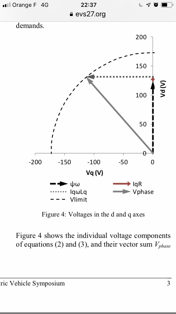

But when i check all the graph attached i don’t realy understand what is the d and q axes, and so What is the Iq.

Assume that the motor phase currents (a,b,c) are three vectors that are 120 degree apart from each other. After you apply the Clarke transformation on the three phase currents (a,b,c), you get Ialpha and Ibeta currents. Ialpha and Ibeta are two orthogonal vectors and their resultant is the same as the actual motor current vectors' resultant. But the Ialpha and Ibeta are rotating with the rotor flux speed, so you apply the Park transformation on Ialpha and Ibeta, and the output is Id and Iq. In the Park transformation, the reference frame is rotated with the rotor flux speed so that the vectors can be seen standstill w.r.t. the reference frame. In other words, Id and Iq are constant values in steady state. Id and Iq can be simply thought as the flux component (reactive power) and torque component (active power) of the motor, respectively.
In the field oriented control method, one sets the Id to the motors rated flux value. Id is there in order to create a magnetic field. The Id is (almost) linearly reduced to a value near zero beyond the base speed, that's what the field weakening is. The weaker the field is, the less back-emf motor produces, the more current your inverter can send to the motor.
Iq is simply the real power, it's the torque that the motor produces.
The slip control algorithm Johannes uses doesn't utilize the Id and Iq values in order to achieve the field weakening. He simply increases the phase voltage linearly up to 100% until the frequency hits fweak, then continues increasing the frequency by commanding slip, while keeping the full voltage. As you increase the frequency, the V/Hz ratio is reduced, so the field is weakened.

Field weakening is made when you are spinning the motor higher than the base speed. It looks like you have a 8 pole 50 Hz motor so your base synchronous speed is 750 rpm. Normally, field weakening is achieved by increasing the frequency over omega C for your graph, not B. But on some particular applications, one might start weakening the field earlier, so it looks like this is the case for your graph.
Beyond the base speed, you reach the constant power region of the motor. Power is the product of torque and speed, so as your speed increases, the torque decreases since you are in the constant power region. So you cannot have the same torque at 1200 rpm with the one at 600 rpm (for this particular motor, of course). That's why the Iq curve starts declining after 750 rpm.
