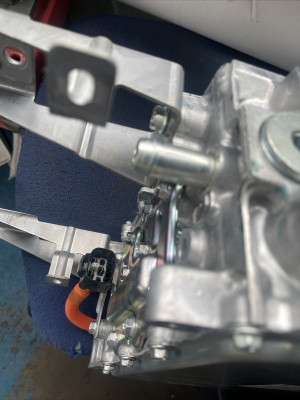

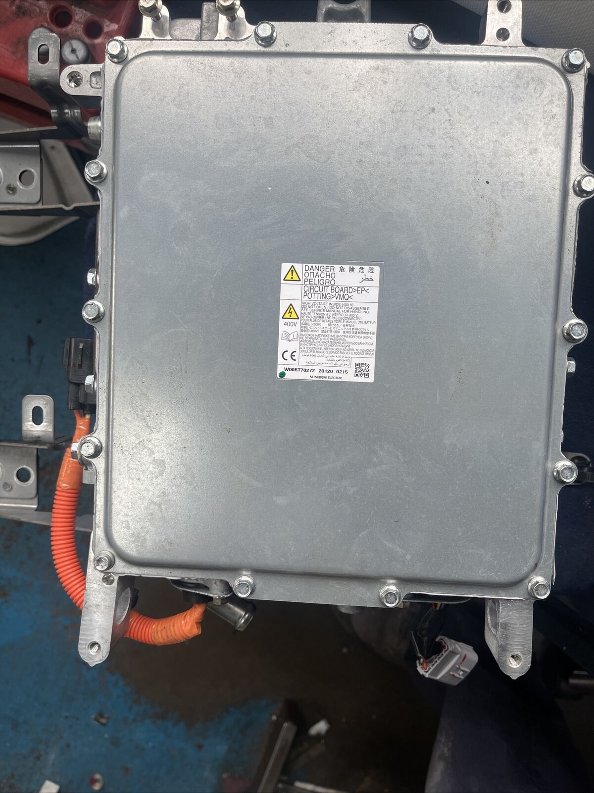

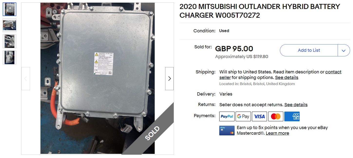

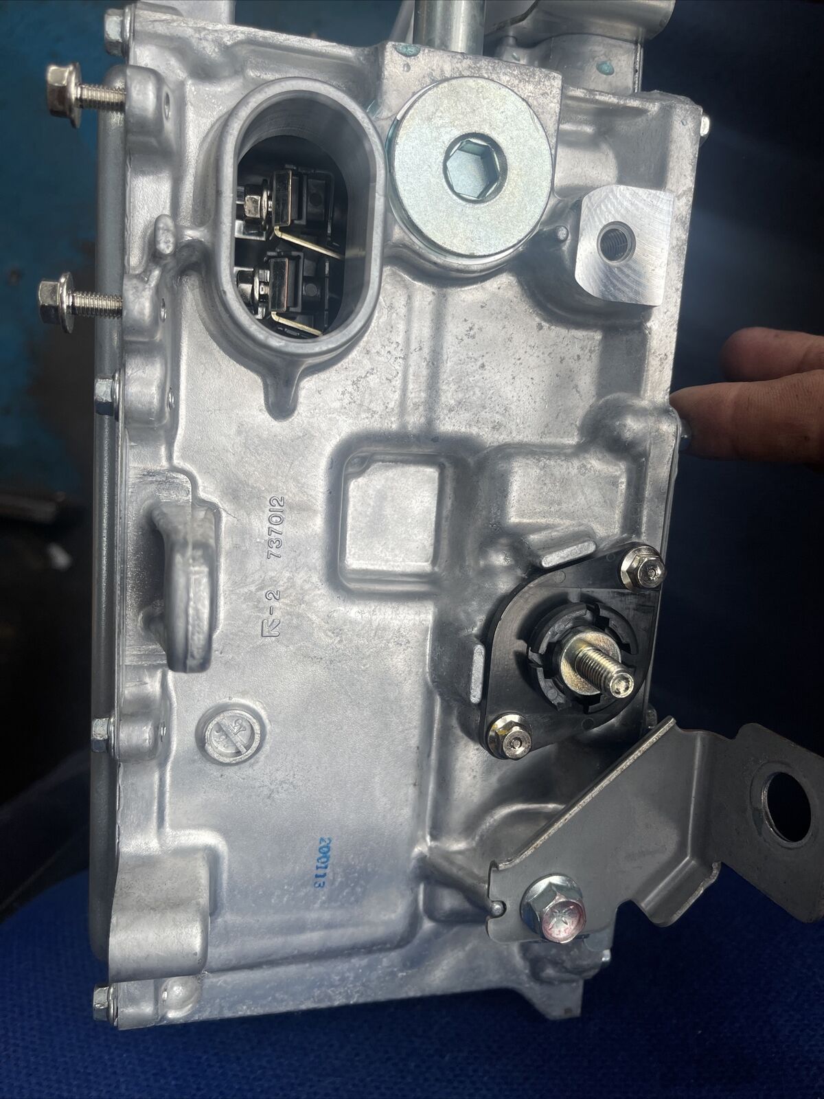

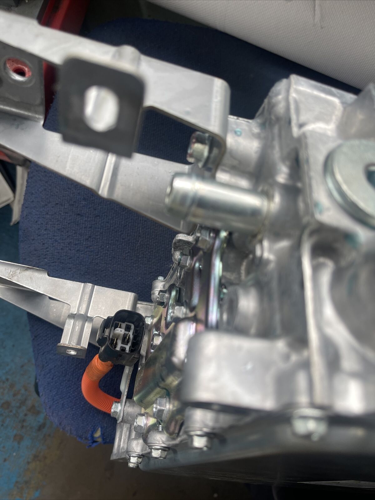

You would be hard pressed to find a Mitsubishi Outlander EV in the states, but having heard many a good things about their components I decided to buy one from the UK and have it shipped to America, especially after the eBay seller offered one up for 95 foot pounds, or newton meters or something?
So here is my story from the Colonies perspective, by a non electrical engineer for non electrical engineers, (but hopefully with the help of electrical engineers).
Part Number: W005T70272

This is timely as I e recently acquired a mitsubishi charger mostly because it was dirt cheap.... So now what?

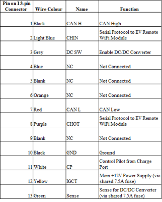

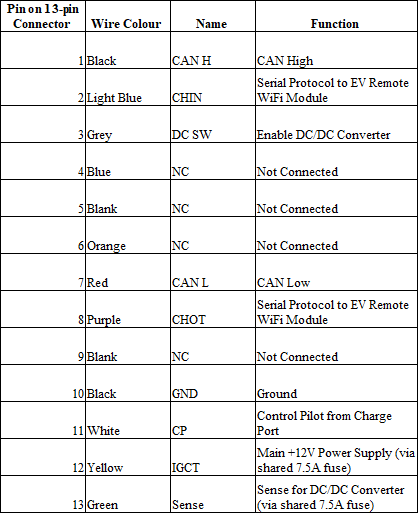

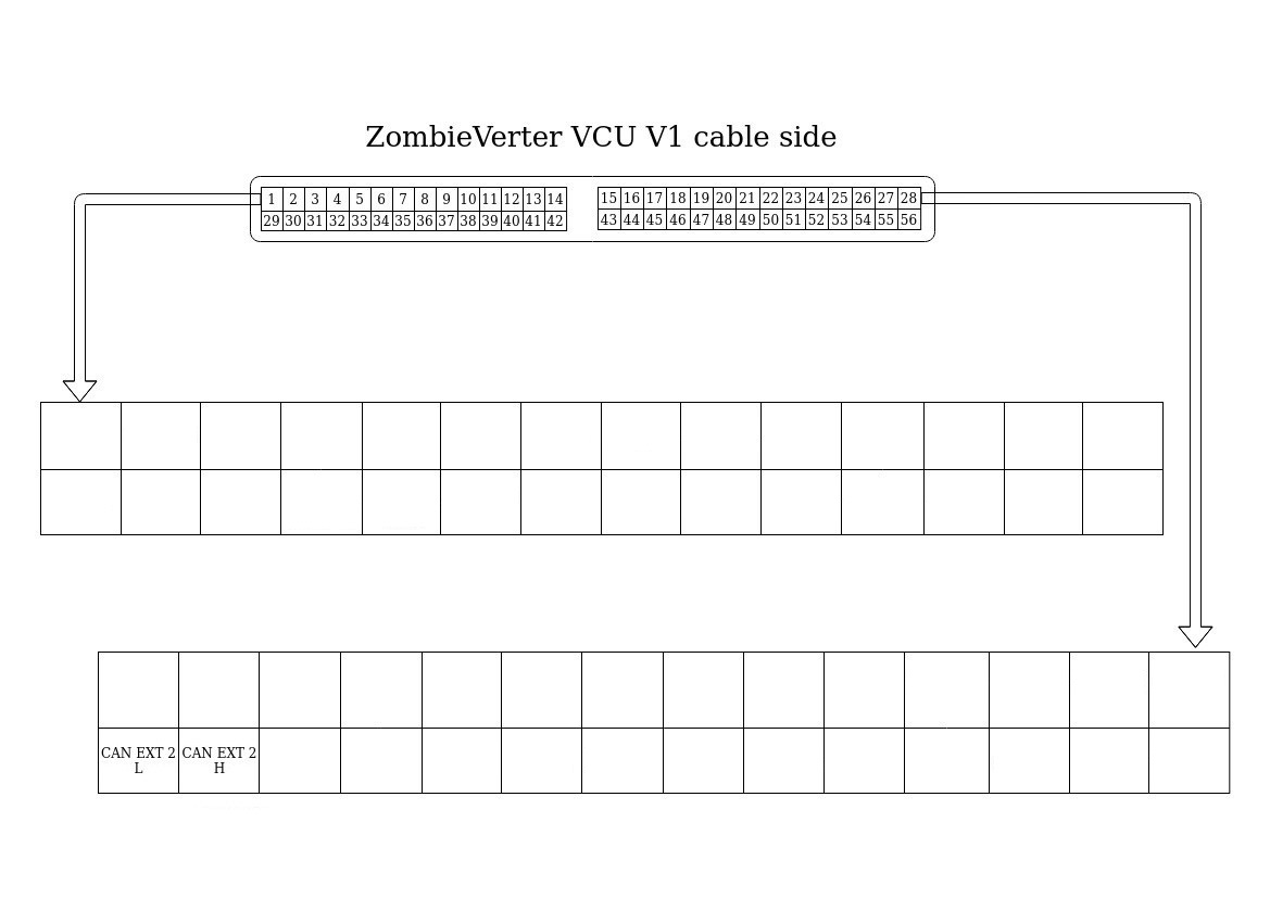

The connector is also used on the GS450H transmission ( ECT solenoid ) Toyota 90980-12326 .
The wiki page pin out table is a bit confusing as the pin numbers from the schematic do not match the numbers on the connector.
I first made up the connector with the pinout back to front, so I have taken the data from the wiki and simplified it as below. This is the pin numbers as marked on the connector.

For ease of use i cut my chargers DC cables and put MC4 connectors on them. This view is of inverter side. Charger side is mirrored...
download/file.php?id=27358&mode=view
I find charger polarity according to this procedure...
viewtopic.php?p=8215#p8215
Yes there needs to be a system as i need to connect all my chargers to DC lines in the same way.
EDIT: There is one other consideration for MC4 connectors. I can now use normal solar Y parallel connectors and connect 2x chargers to inverter for 2 phase charging :).

Gregski wrote: Tue Feb 27, 2024 1:29 am and forth only to realize you do not show a pic of the "high voltage port gland" for the charger, but only for the inverter
Well yes, the High Voltage gland is identical for charger and inverter.

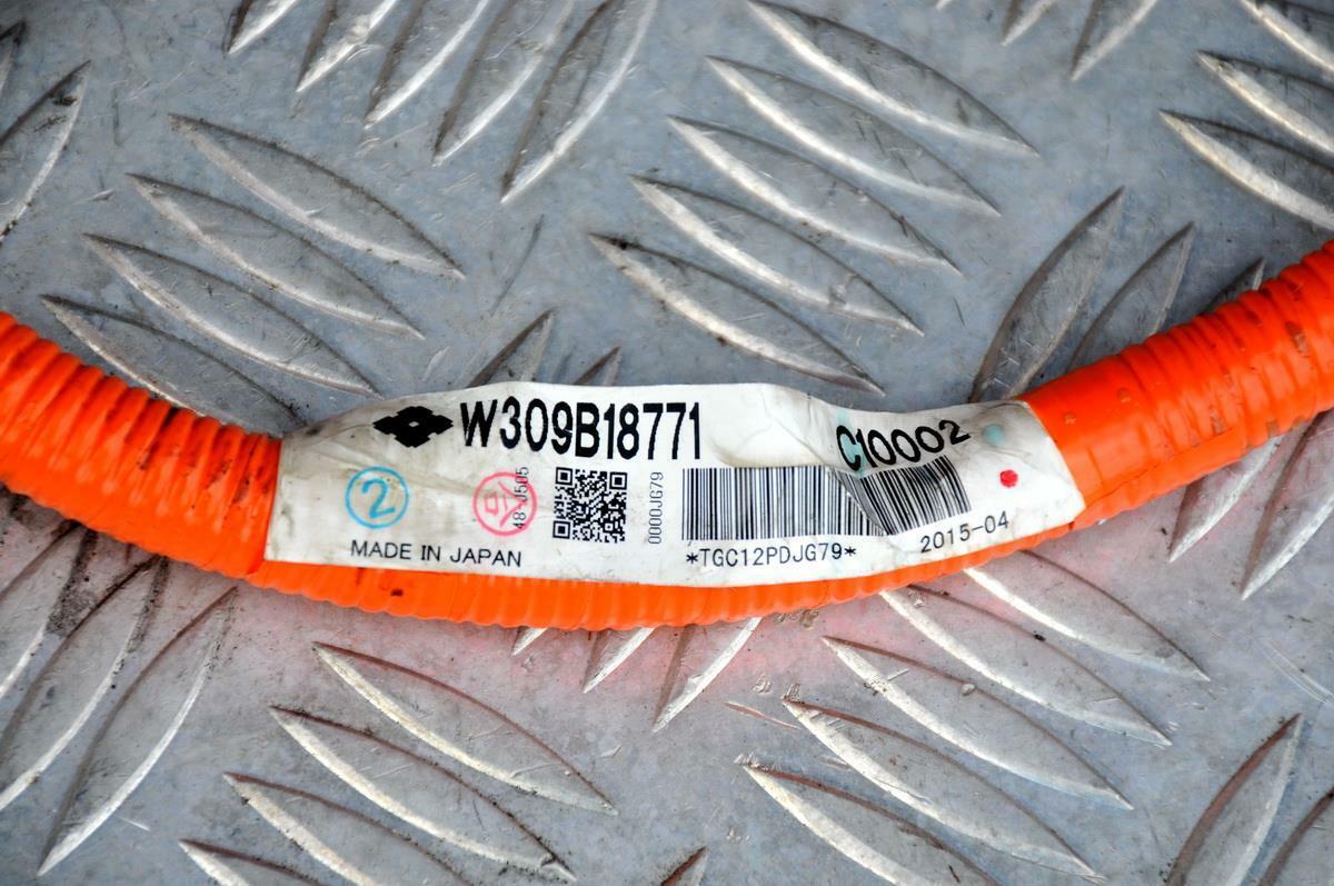

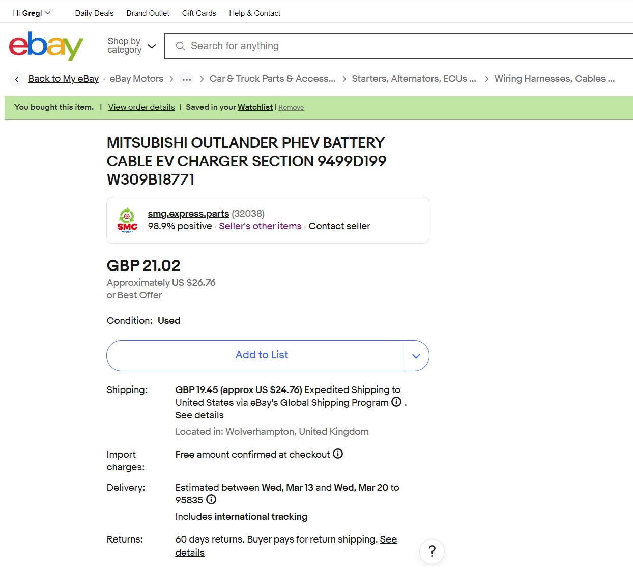

I write this I plan on purchasing the OEM Battery Charger cable W309B18771 unless I hear otherwise, obviously I suffer from OEMicitis

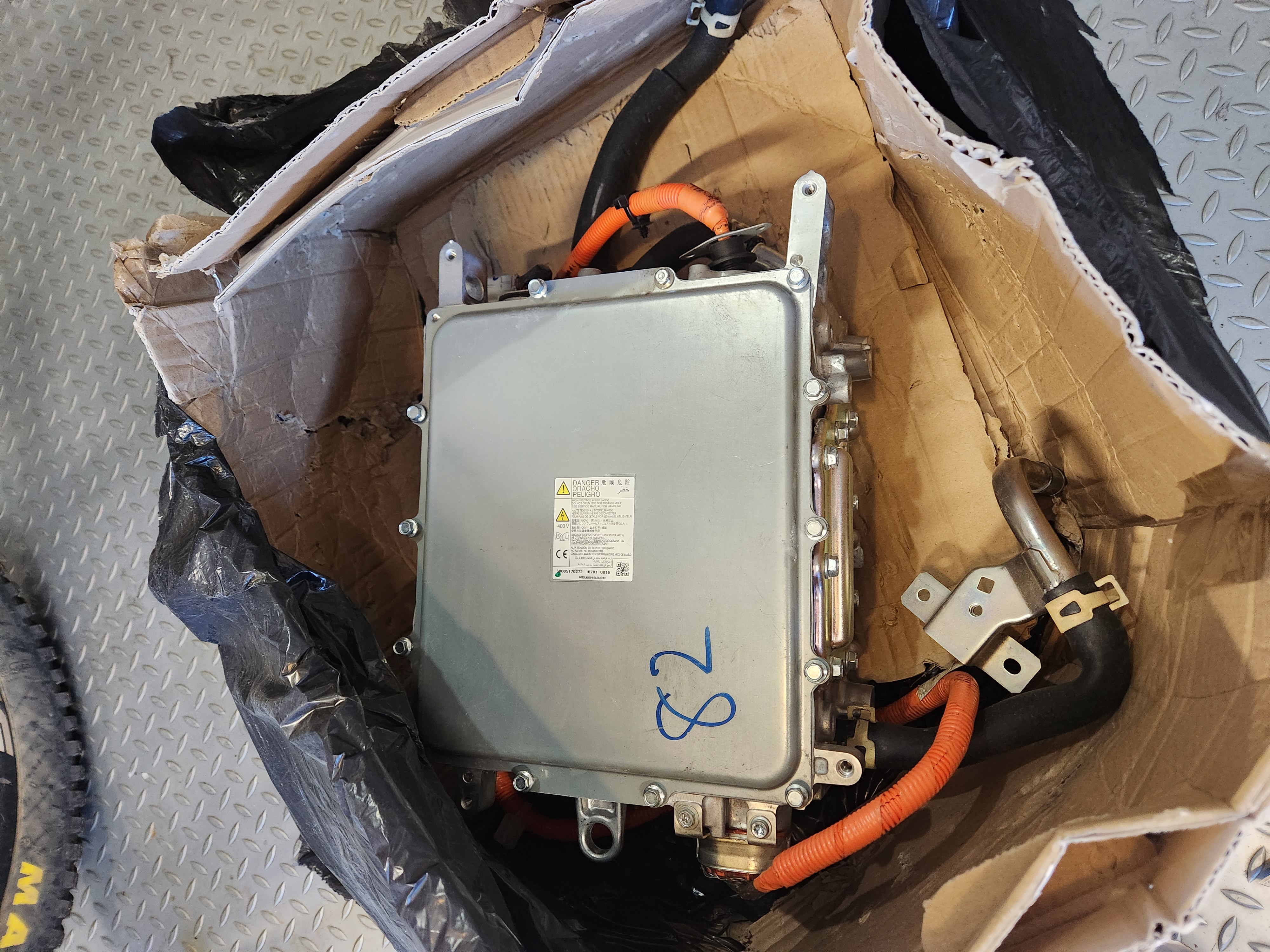

Gregski wrote: Mon Feb 26, 2024 4:22 pm Is proper packaging illegal in the UK? asking for a friend

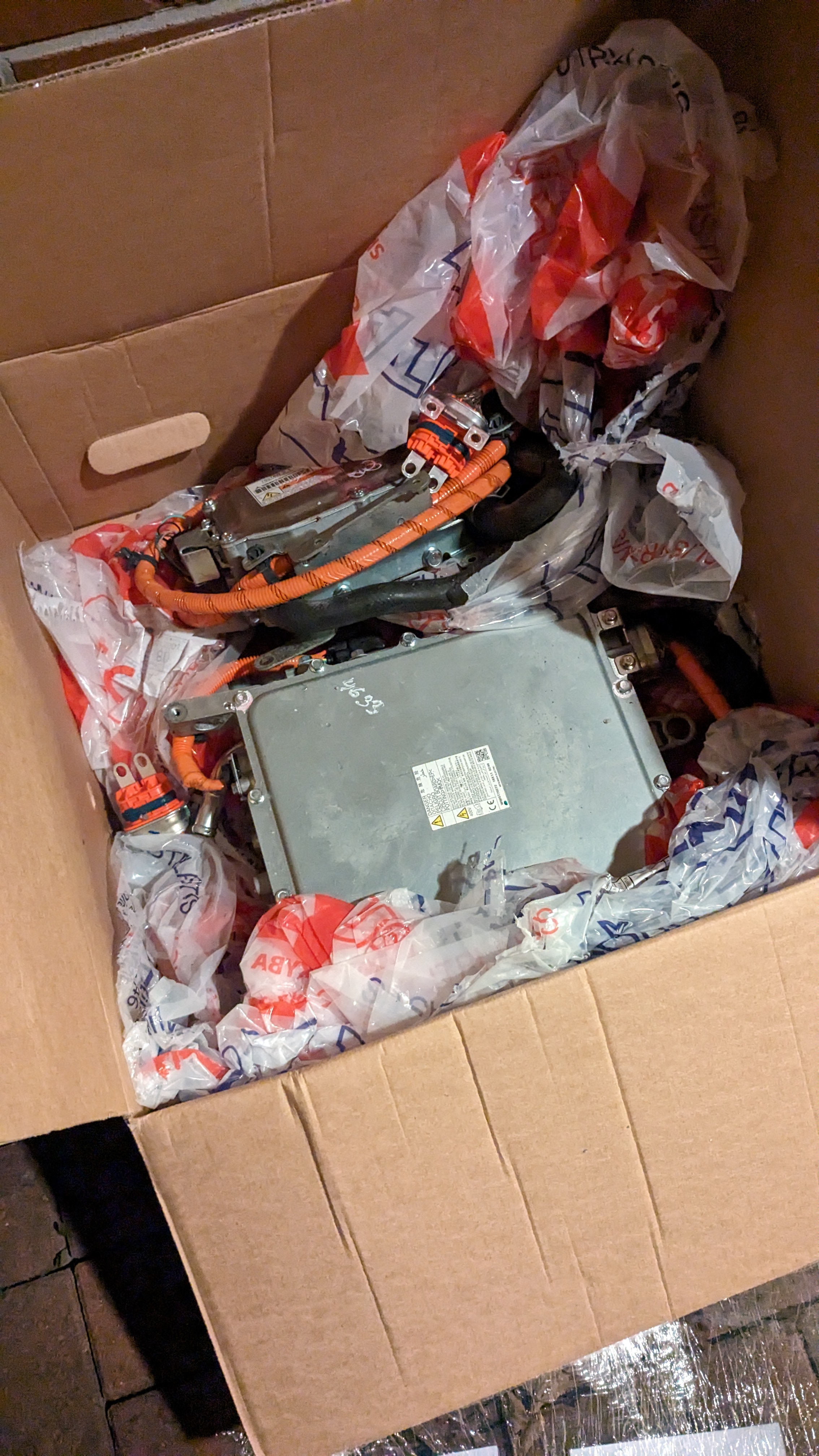

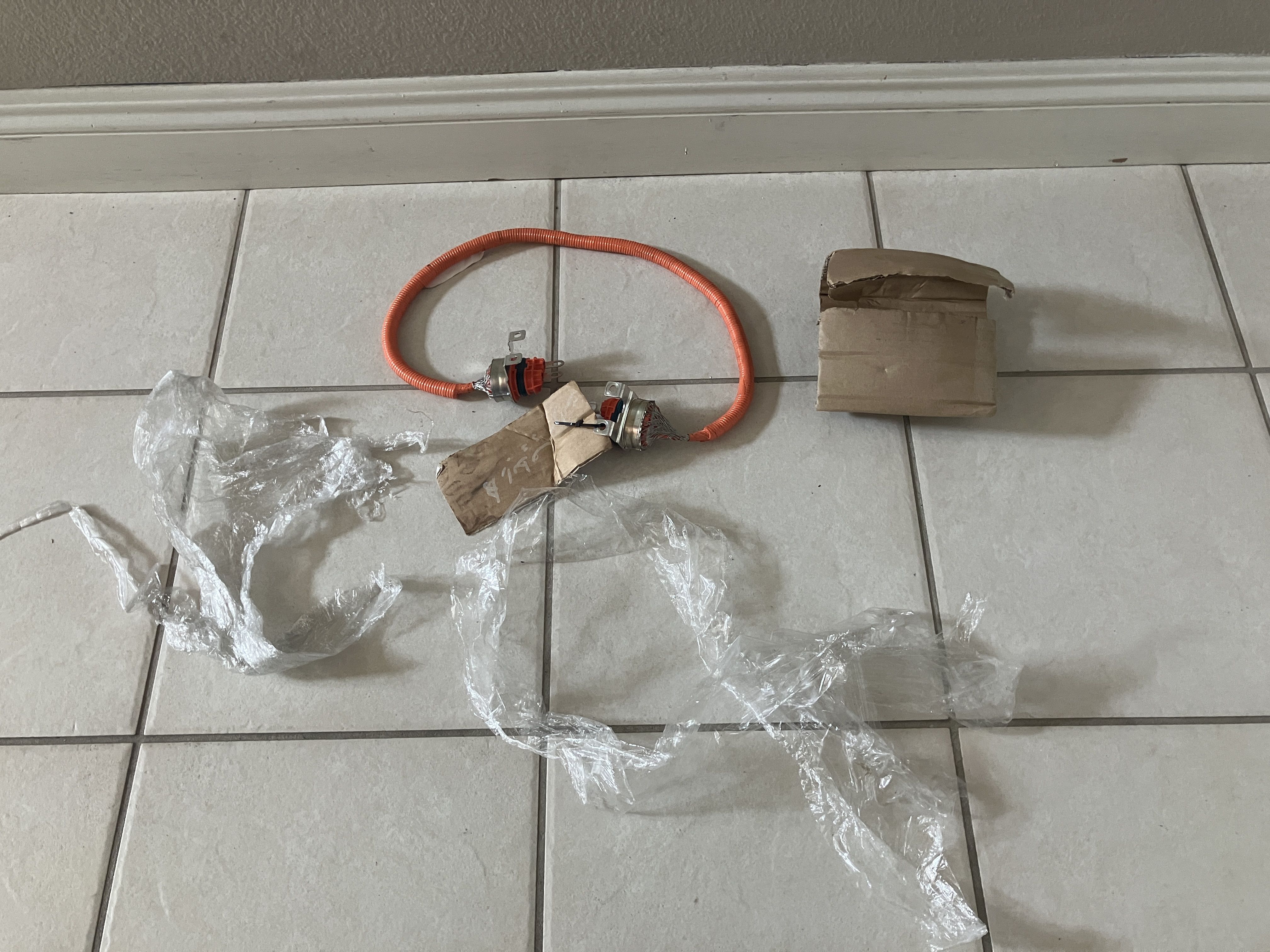

I see a pattern :o Also ordered same charger from UK ebay seller. This is how mine arrived. Post lady seemed most concerned handing this to me.

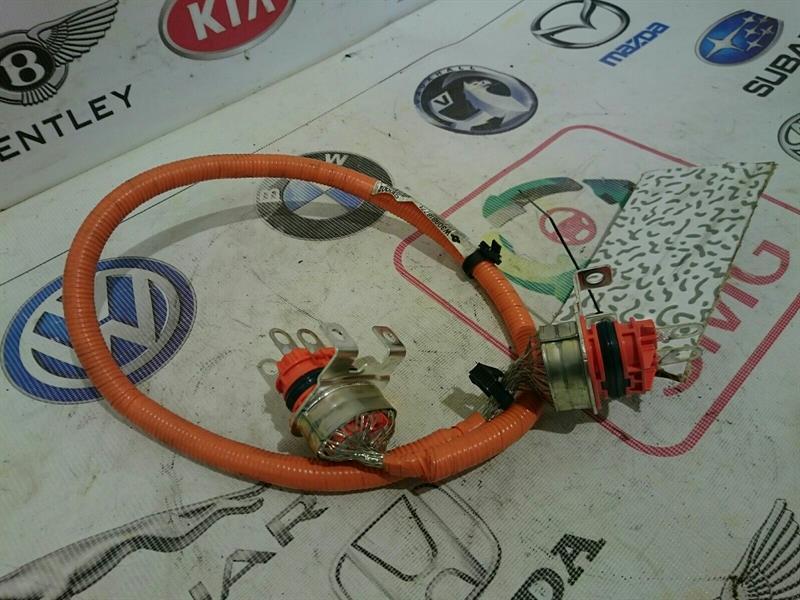

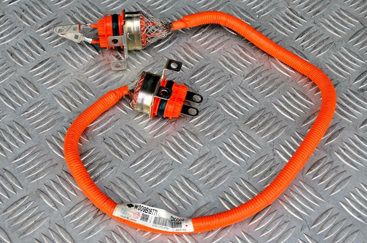

time to accessorize

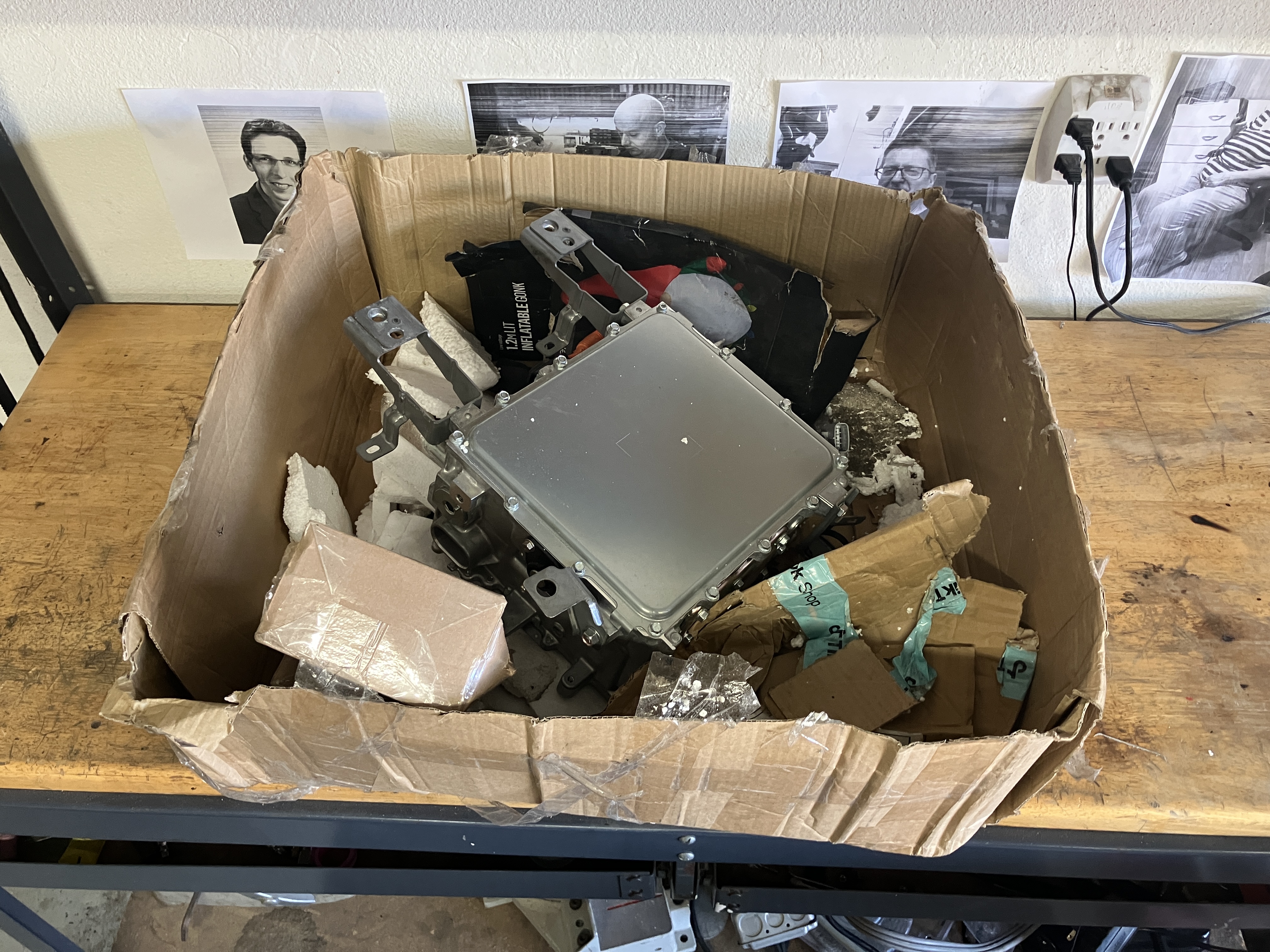

Look at what arrived here today. Well packed actually :D
And they even threw in a heater to make up for the free space! How nice of them!

crasbe wrote: Wed Mar 06, 2024 9:04 pm Look at what arrived here today. Well packed actually :D

I just received another heater myself. Its good to have spares. With Outlander parts its simple replacement if something goes wrong.
I used to write Aircraft Maintenance Programs for a living. I will simply add new component page to Mazda manual :).

it appears my charger battery cable is on tour opening up for Ed Sheeran

Looked bigger in the pictures!
Posts: 3796
Been thanked: 413 times
Re: I just bought a Mitsubishi Outlander charger. - Now What?
This one is shorter. There is another which is a bit larger. Both the same way internally.
