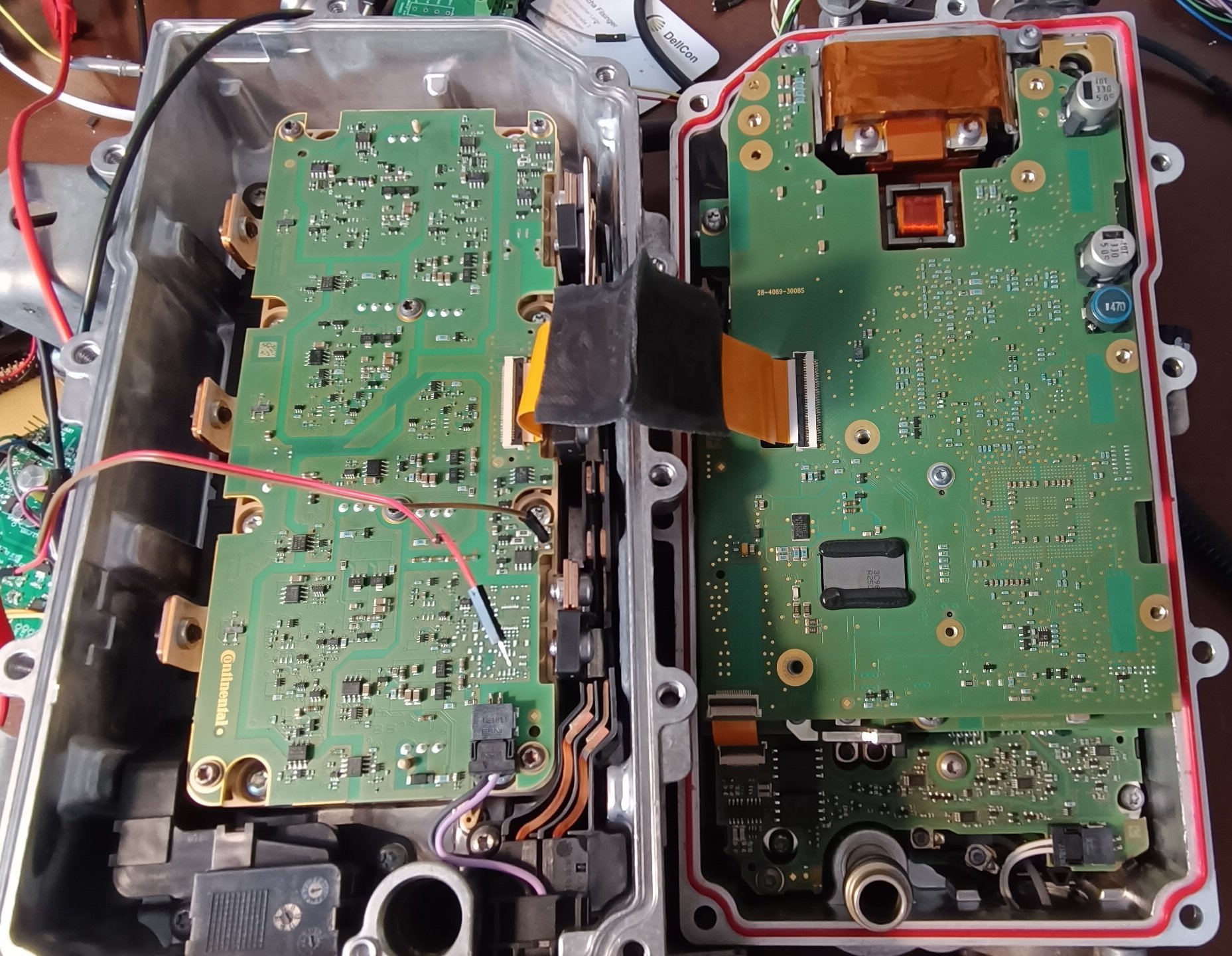

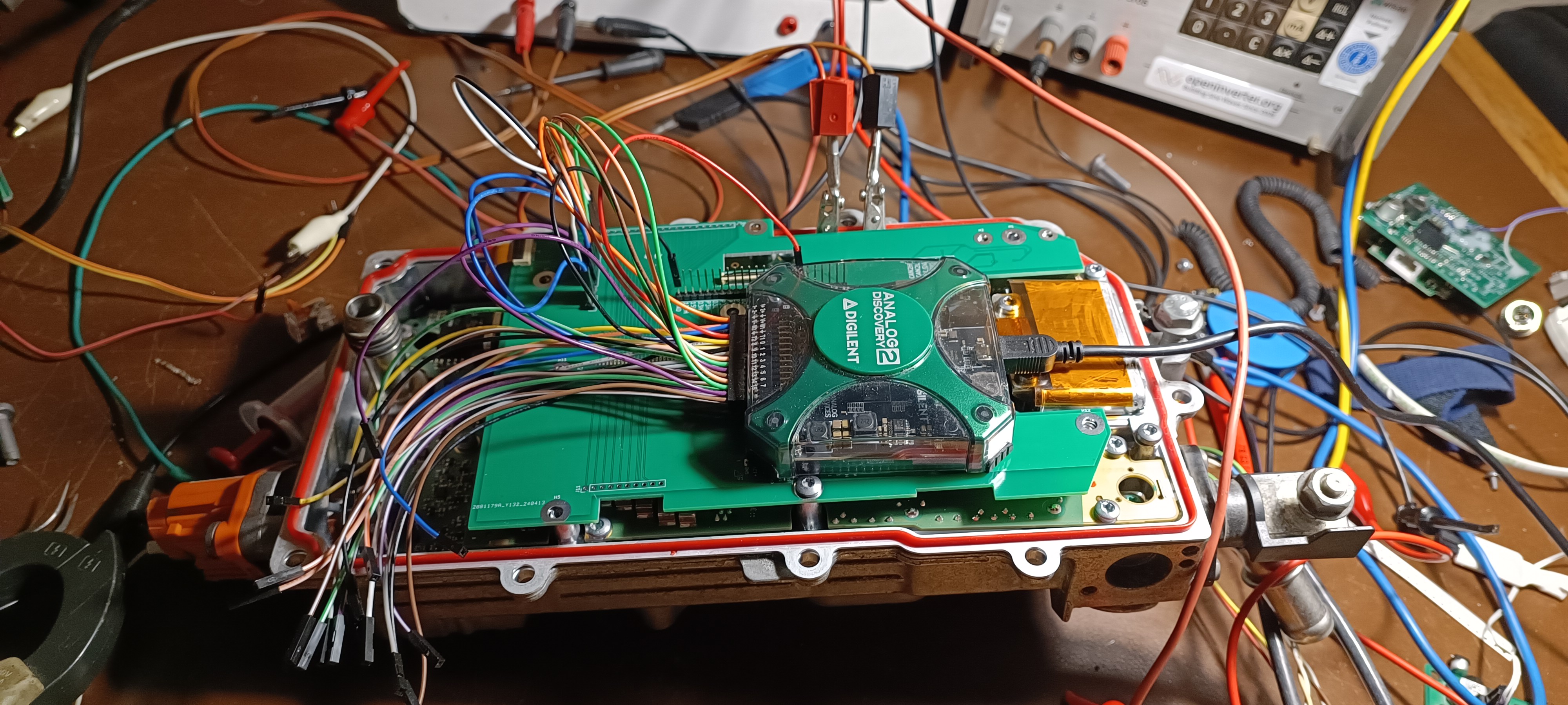

This morning I ran the Zoe motor with the i3 inverter. I found 12V on the excitation results in 1.3A of current. Did get up to 15 Hz then it desychronizes and just rattles. I supplied excitation from a battery. When supplied from a power supply it jumps around a lot when running.
Anyway, it's about the inverter, not the motor. Got it on the table here and trying to get some life out of it. Connected chassis to GND and the yellow wire to 12V. Then results in 5 mA of current. The red wire doesn't really do anything. Also monitored the CAN channels but they don't produce anything either. Put one of the CAN messages from here on the bus but that doesn't wake it up either.
The colours in the wiring diagrams seem to be all in French and abbreviated. Also supplied 12V directly to the large elcap bu that also yielded nothing.
Ok, onto the gate driver board. I did ring out a few signals, like pins of the bidirectional isolator that send the PWM across the galvanic barrier. And the current sensors.
Weirdly all 5V supplies are split up. The low side isolators share common 5V, the high side another common 5V (I assume it's 5V) and another 5V goes to the current sensors. All not interconnected. Weird.
Tried to fire up the gate drive power supplies but also with no luck. Fed 12V to the larger film caps next to something that looks like a driver IC but that resulted in no current draw at all.
Not the best start, hints appreciated

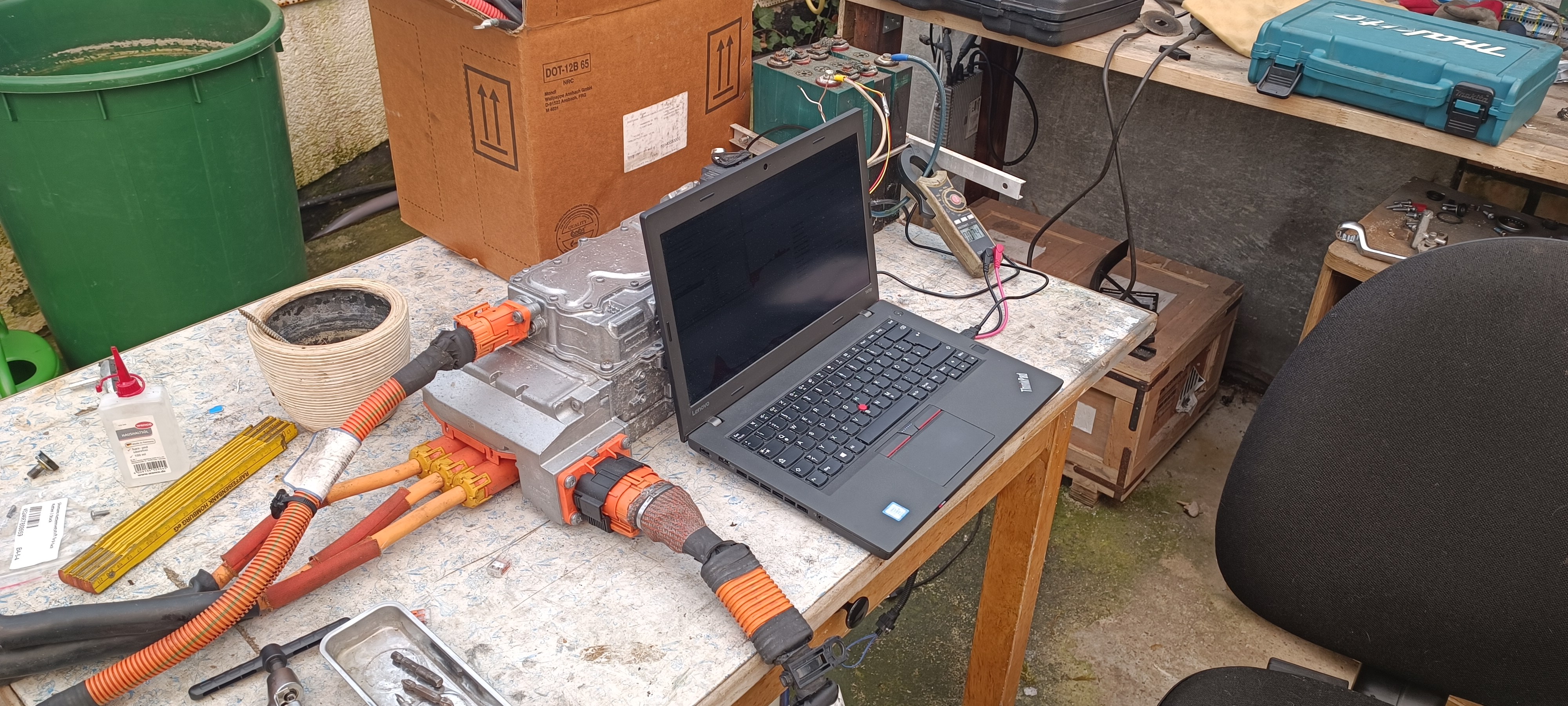

Got some CAN logs and just played some back into the sleepy inverter and suddenly it wakes up and draws roughly 900 mA
The inverter itself responds with 0x196, 19F, 1A1, 422, 42C and 511 most of which are not in the table above.
EDIT: it's sufficient to keep sending message 0x423 to keep the inverter awake and sending CAN.
Still not sure if I can make it run that way but at least no I can take measurements

Taking baby steps. I'm trying to figure out the position sensor which I expected to be a resolver. But it isn't.
I have the wiring diagrams and there the pins are called
- Ground
- Supply (measures as permanent 5V)
- Position Signal 1
- Position Signal 2
So I though ok, it must be some sort of position sensor IC that outputs a sin and a cos signal. So had the Analog Discovery supply 5V and then measured Signal 1 and 2. Hmm Signal 2 jumps to 5V, Signal 1 stays at 0. Moving the motor yields no change.
So I thought maybe it's some data protocol, one of them is clock an the other an encoded position. So clocked one signal with 500 kHz while monitoring the other. Nothing. Hints appreciated
For reverse engineering the inverter I'll need to make a brakeout board first because of all the flatflex
- Ground
- Position Signal 1
- Position Signal 2

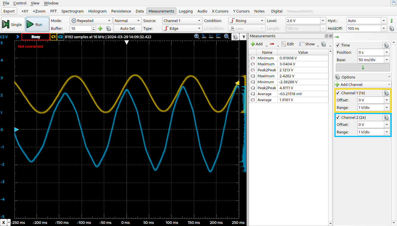

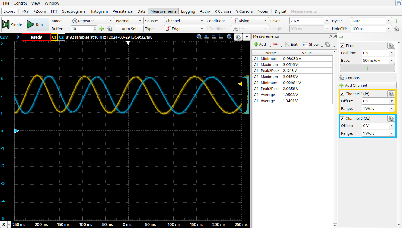

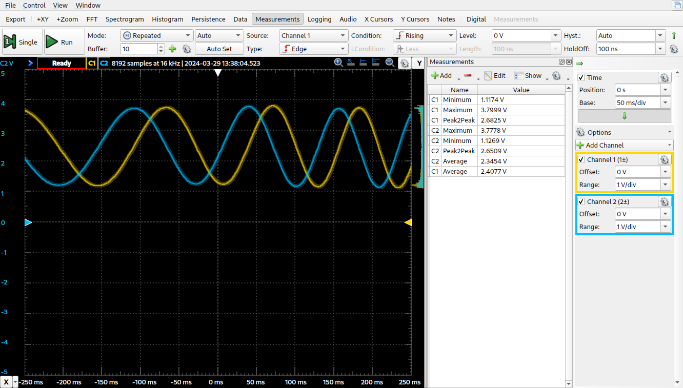

I tried to do so today and that led to the answer
The position sensor sits in the front, et voila: EDIT
Next I tried supplying with 4V instead of 5V: That shifts the signal into the input range of our ADC
Then I connected channel 2 to phases 1 and 2 and supplied the excitation winding with 12V: So respolepairs=polepairs
The ratio is more important then the absolute value.

Now continuing with some more gate driver research. The isolators are ISO7421 from TI. https://www.ti.com/product/de-de/ISO7421
They have one forward one reverse channel. Traced the 6 forward channels that gives me the 6 gate drive signals and the 6 reverse channels give me the 6 desat signals. The forward channels have a 200 Ohm series resistor
Then there are separate logic supplies for high and lowside, and separate supplies for the current sensors.
With all that and the many, many GNDs 43 out of 50 pins of the gate drive ribbon are now traced.
The excitation ribbon is just 20 pins, 6 GNDs, 2 15V and various 5V supplies. I think I'll just trial and error that as it's hard to measure

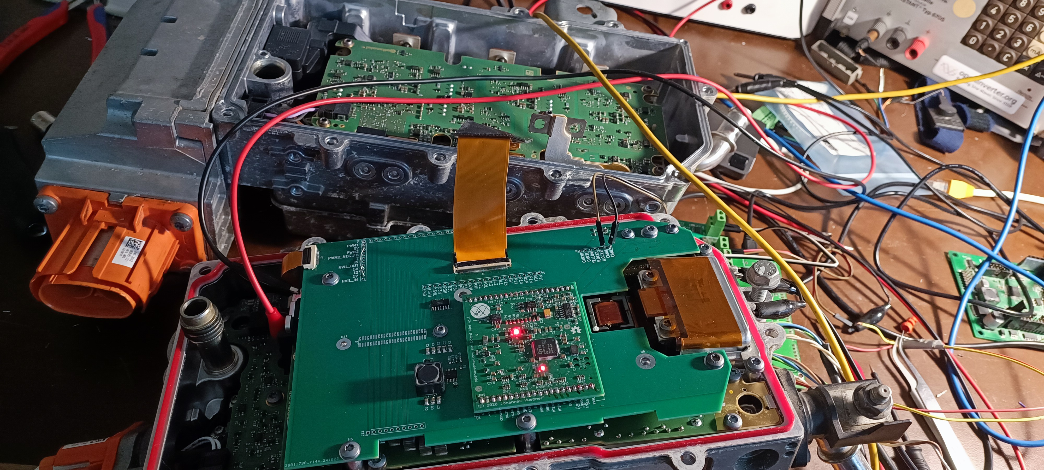

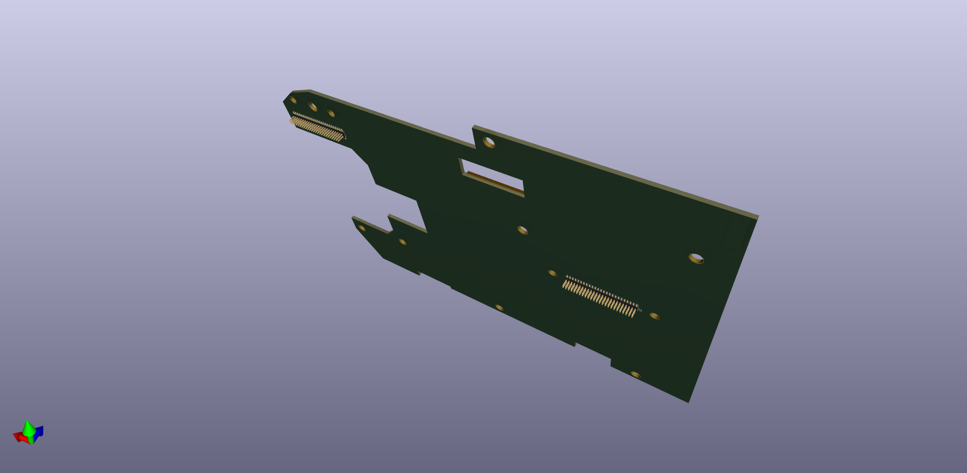

First cut of a breakout board with mini mainboard for first tests

Good testing day today. Got the main inverter and the exciter inverter going.
All runs fine from 3V3 control signals.
I haven't found temperature and bus voltage signals so maybe that is on SPI comms again. But I also found that I forgot to break out two pins so will check these next.
Latest pin map is attached
pins.ods- (18.38 KiB) Downloaded 923 times

And we have liftoff
Applied about 2A excitation current and then did the syncofs calibration. Then used idlespeed to spin at 1000 rpm. Works a treat. Emits some alien sounds, not sure if that is mechanical or electrical. Video coming soon.
Remaining question: how do we determine inverter temperature and bus voltage?
And for another experiment: how do we enable the DC/DC converter?

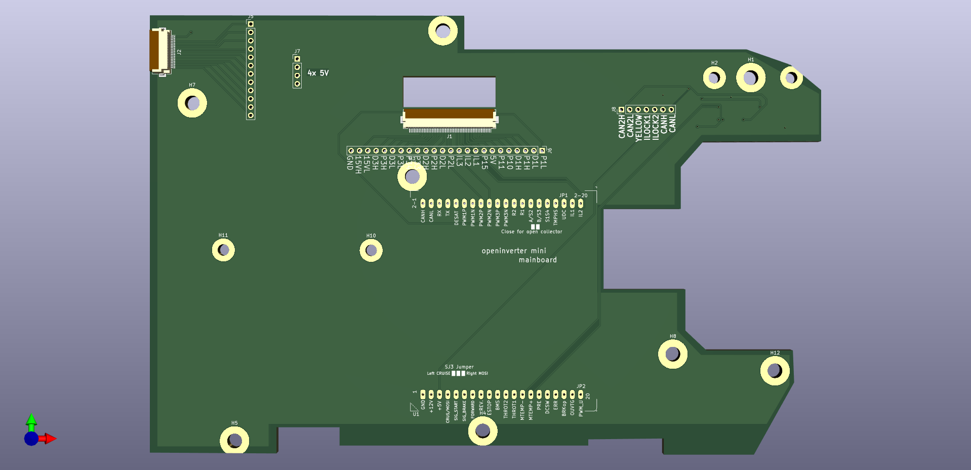

Testing the next iteration.
- Exciter PWM now connected to mini mb user PWM
- Exciter current connected to udc input
- 15V boost converter for supplying exciter and inverter
- Hooked up 6 desat signals to and-tree
- LDO for variable voltage to sin/cos encoder (currently set to 3.9V) - shifts the output signals into the ADCs dynamic range
- Mini MB can be soldered directly to adapter board for lower profile so it doesn't collide with the gate driver PCB
- Bolt holes revised but still not perfect
There are some shortcomings still
- No measurement of inverter heatsink temperature - I hope it just throws a "desat" signal when overheating
- No measurement of udc - not really needed since the board won't perform contactor control
- No operation of DC/DC converter
Will now extend the software to detect the adapter board and allow closed loop exciter current control
Using an offset of 3195 for exciter current sense and a gain of -50 digits/A

The only other important signal is the twisted pair beige/white which is CANL/CANH
You can supply via the wire or the DC/DC outlet

I can give you pinout of PEB connectors)
If it PEB from ZOE, there one EV CAN and one CAN between PEB and BCB (charger).
