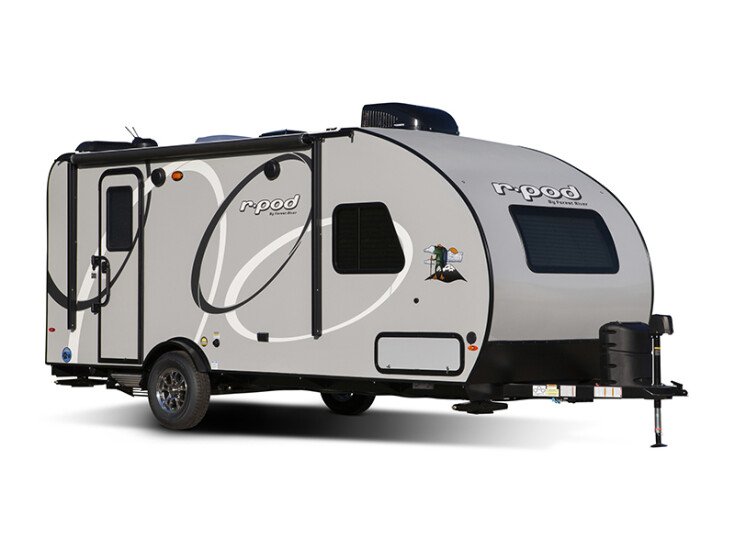

Base Travel Trailer:
- 20-25ft typical 3000-5000lb dry weight (logically I will need a dual axle that is at the lower end of weight spectrum to handle the added mass, but I have a single axle now that I could convert)[/list]
