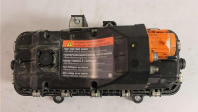

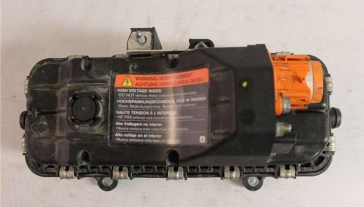

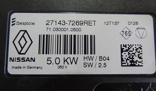

I had asked a question about PC heaters in arber333's Hardware thread but decided to bring it out here so as not to clutter up the broader discussion over there. I was asking if anyone had used the 5kW heater from the Gen 1 Leaf (27143-7269RET) and plumbed it into their existing heater matrix like I have in the Audi 80.

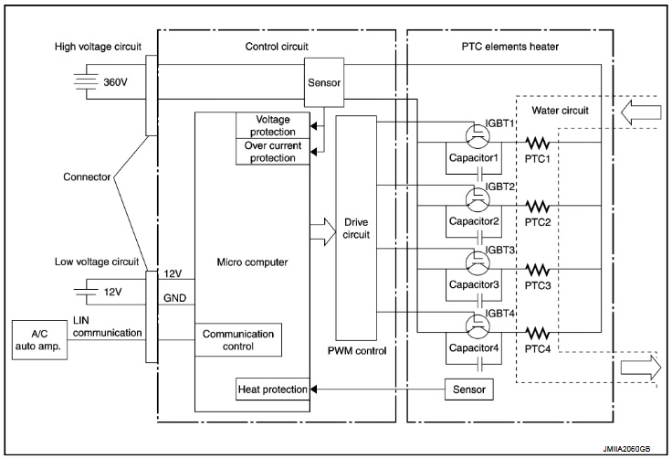

There is a schematic from damian.lo below and I found a bit of info at http://www.nissantechnicianinfo.mobi/ht ... ntrol.html about the control. There is LIN bus comms from the A/C auto amplifier but it's PWM. It's not my area of expertise but, does this make any sense as to the control element and if this is a usable PTC?
The PTC heater provides an internal control circuit and performs LIN communication with A/C auto amplifier. Based on the signals from A/C auto amplifier, the microcomputer inside PTC heater controls the heater output by PWM. When current is applied, it heats up. Upon reaching a certain temperature (Curie temperature) the resistance suddenly increases, limiting the current, and maintaining a constant amount of heating.
Any ideas on how you would work giving it PWM signal from an early 90's VAG heater system?

I discussed this with one DIY EV owner from Switzerland. He posted details on his blog.
However his control was over CAN SW bus which i dont know if it is the same as LIN bus.
http://s80ev.blogspot.com/2016/12/the-heat-is-on.html
Maybe it would be best to open the thing and insert a PWM generator that would be controlled by a pot in cabin. That way we could control it by its original interface.
EDIT: Sorry that eberspracher is found on Volt car and it works with SW CAN Which is not the same as LIN.

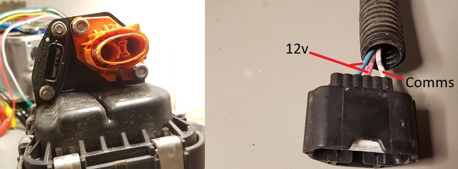

I have one Volt heater at home and i will also try to open it and see if controls can run on internal 1kHz PWM.Cookie6000 wrote: ↑Fri Jan 17, 2020 10:04 am Thanks arber333

Hello,
Yesterday I found similar docs about our heater. It looks, that it's the same like Titronic CH-HV60, but with other interface - in our situation LIN.
I found on another thread some docs about:
https://www.diyelectriccar.com/forums/s ... 87931.html
I don't know exactly what I can with LIN, but maybe Eberspacher have interface boards for sell? I have to ask them. In meantime, maybe we will look inside to bypass LIN and go directly to PWM (also explained well in manula for Titronic.
