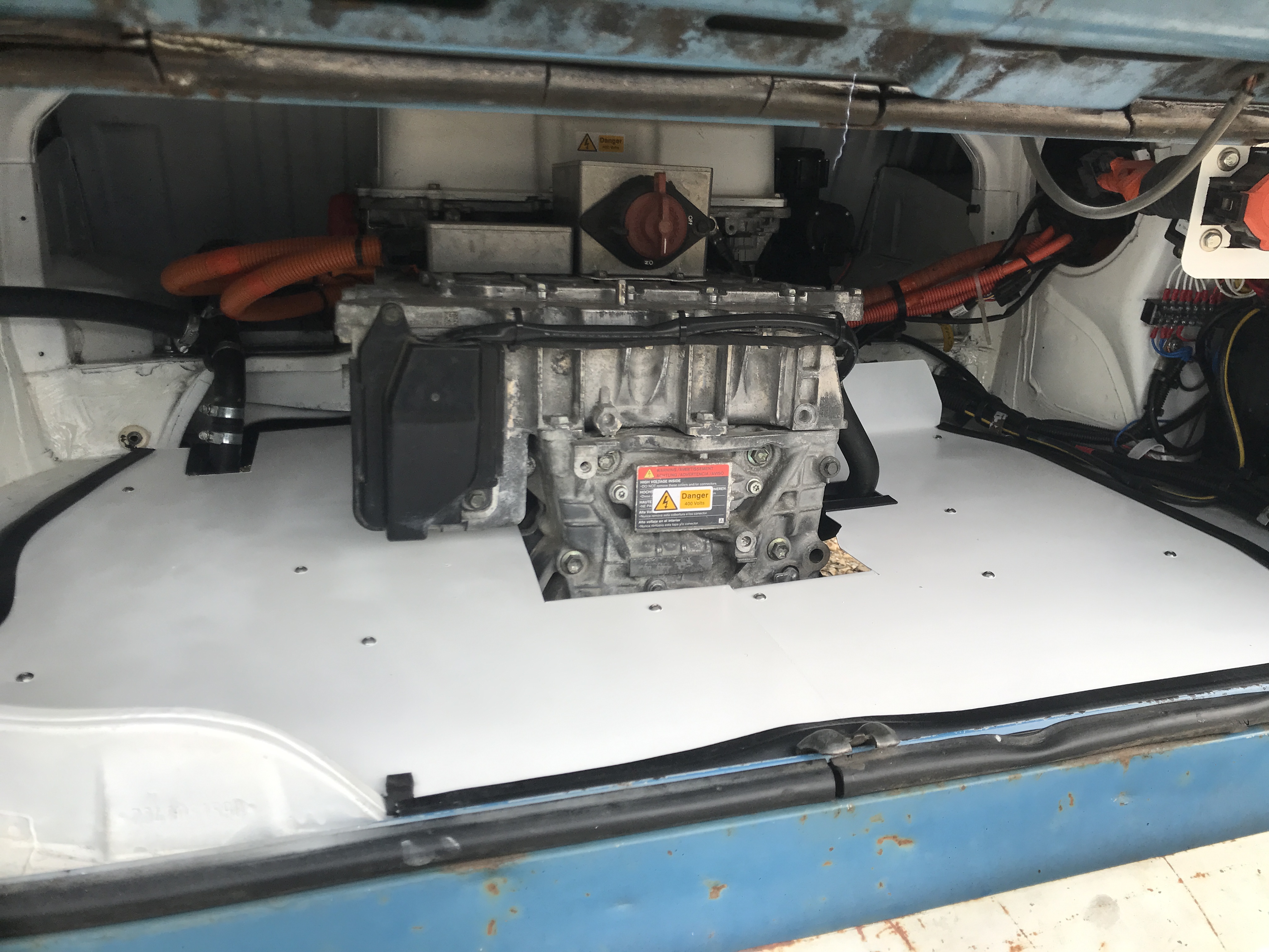

Next stage - received Resolve EV controller, plus I went for supplied wiring looms. Nicely packaged and went together well.
It’s been so long since I pulled the main battery disconnect out that I completely forgot to return when I was ready to test. That took a while to sort out. Idiot!
Anyway, it seems to be alive, but frustratingly I can’t get it to switch from neutral to drive or reverse.
I have tested 350v is getting into the PDM and down into the inverter. My 12v is good and Resolve display starts up after ‘ignition’. But nothing from my D or R buttons (switches and 12v is good there).
More tea may fix it.
EDIT: actually, a gentle nudge in the right direction from Isak at Resolve-EV, all working now.
Just need to deal with an odd accelerator behaviour now. I could not find the recommended pedal, so this may be the cause.
Picture of the place we used to put cars in before this craziness started.

By my calcs, Leaf motor stack is 100kg (not incl battery) vs 160kg for VW incl 50% full fuel tank, plus all the other gubbins I don’t need.
Then battery on top which is still to be defined but you can see roughly where I’m at if battery is say 300kg -TBC
If I could wave my arms and it just happened, yes underfloor would be great. But in my real world I’m happy with placing under bench seat and behind front seat bulkheads. Should be good horizontal position if a little higher than ideal.
This is a T2, so handling and performance are not the goal here!
