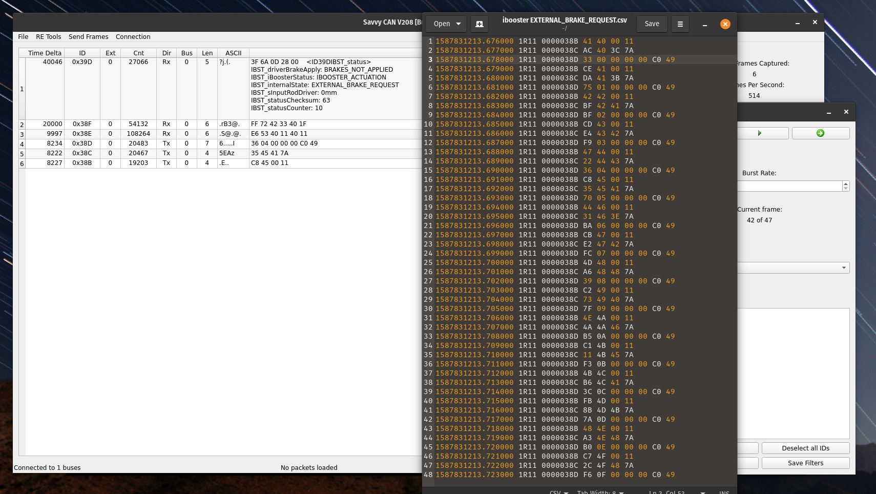

I decided to create a topic about reverse engineering ibooster gen2 which is on the Tesla M3 and Y. Personally, I have from a 2022 M3. Today I was playing with Party CAN and discovered that ibooster reacts to three messages (0x38B, 0x38C, 0x38D) and goes into EXTERNAL_BRAKE_REQUEST status by moving the rod a little.
There is no DBC file for these messages anywhere and therefore I am asking for help in decrypting them. Let's figure it out together!

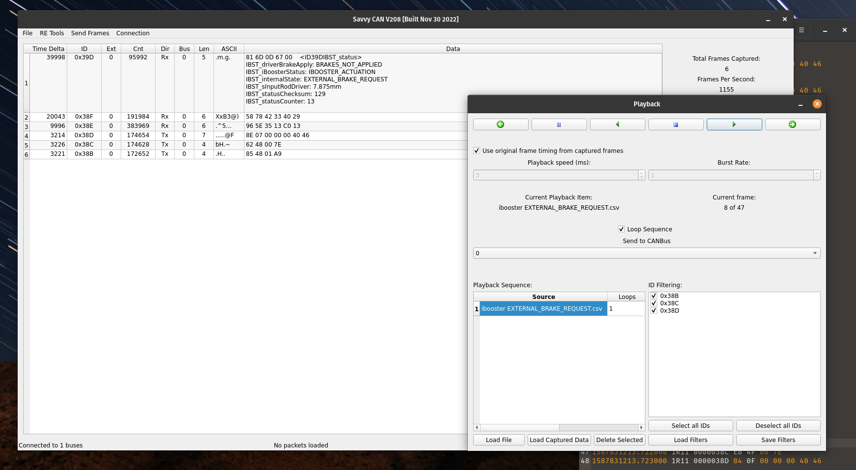

I don’t know how to calculate the checksum for messages, so I manually wrote a short log that puts the ibooster in the EXTERNAL_BRAKE_REQUEST state, but the push rod stays still.
I think all these 3 messages are related. Having changed at least one payload byte in any of them, ibooster remains silent.
ibooster EXTERNAL_BRAKE_REQUEST.csv
(2.21 KiB) Downloaded 318 times

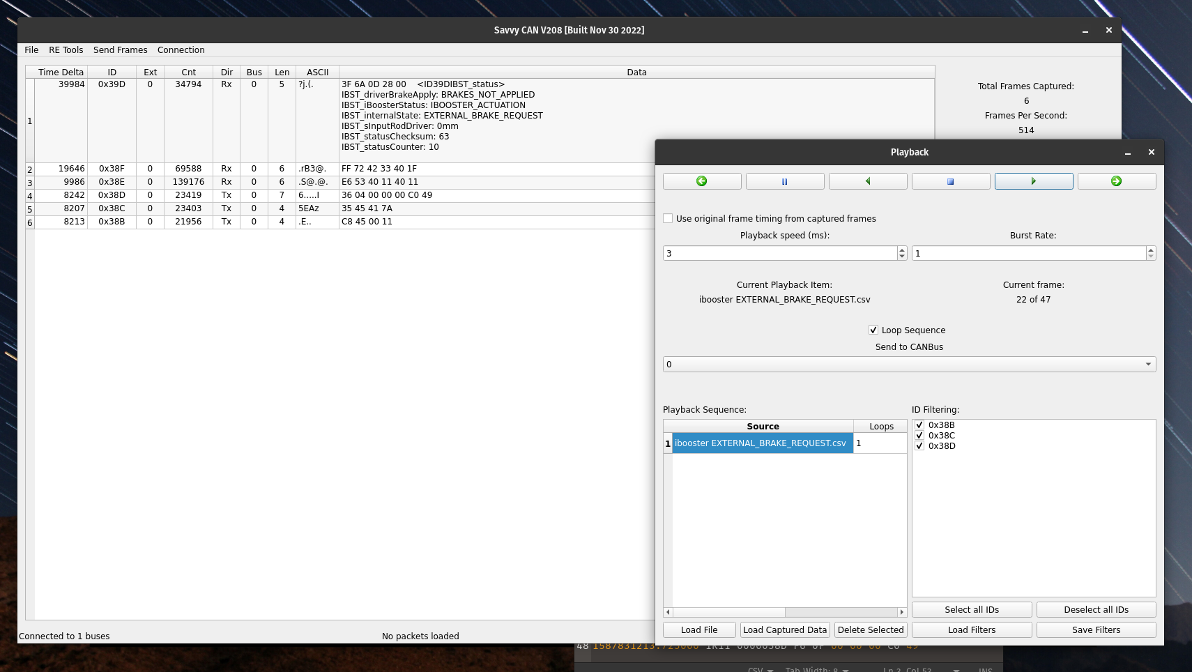

I just googled and found out that the checksum algorithm is CRC_SAE_J1850.
I threw several messages from the log into the calculator and the checksum converged. I think now you can create any messages of your own and play with ibooster.

Played around with ibooster a little more and noticed one interesting thing. If you send message 0x38B (tried different data in bytes 2 and 3), and at the same time press the push rod, it held by the motor and returns to its original state only if you stop sending messages.
Perhaps this is some kind of firmware glitch. No idea. In short, I need can-bus logs from the car while driving in ACC mode.

Sorry, there was a little mistake. Play with a speed of this trace. All the messages should be around 10 ms.
(2.21 KiB) Downloaded 192 times
