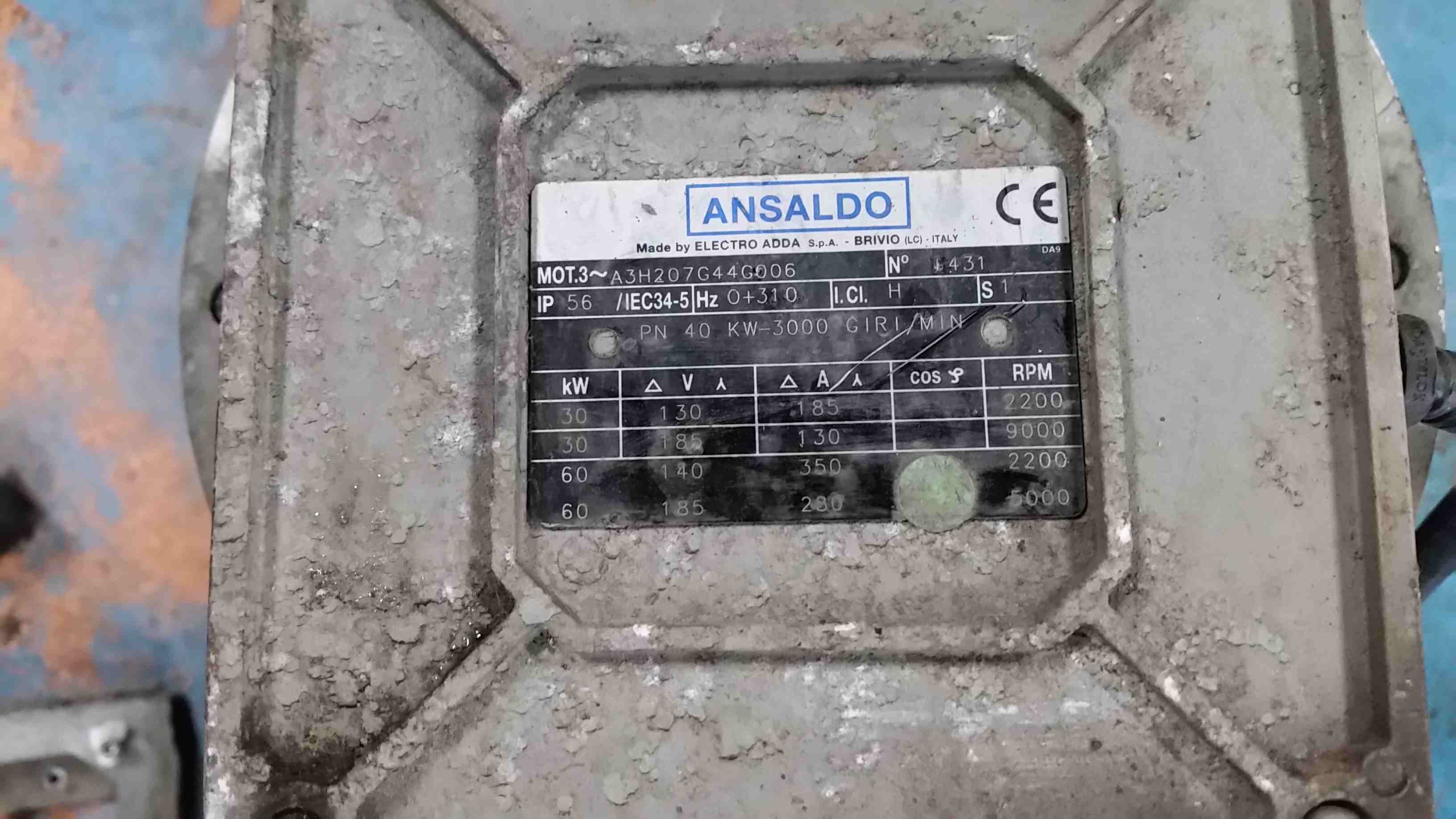

My new Ansaldo motor in the E39 hates me. Finally got the cooling done today and decided to go try some tuning. Not very successfully. Can't get more than about 30 amps of battery current into the inverter but motor current very high. Speed signal is clean and current sensors are reading correctly. From what I can tell by the rating plate and looking in the terminal box, this is a delta wound motor. I picked it as it was available and seems to be rated for a low voltage as the Landyacht used to be DC. Any ideas much appreciated:)

So its a 2-pole pair motor (9000 rpm @ 310Hz)
It is also a bit of a give-away for the slip frequency: sync frequency at 9000rpm would be 300Hz. But they specify 310Hz -> 10Hz slip frequency! wow. Maybe try a range 3-10Hz or so.
Concerning V/Hz: fweak=73Hz (2200/30) at udcnom=183V (sqrt(2)*130V)
Is that about what you configured?

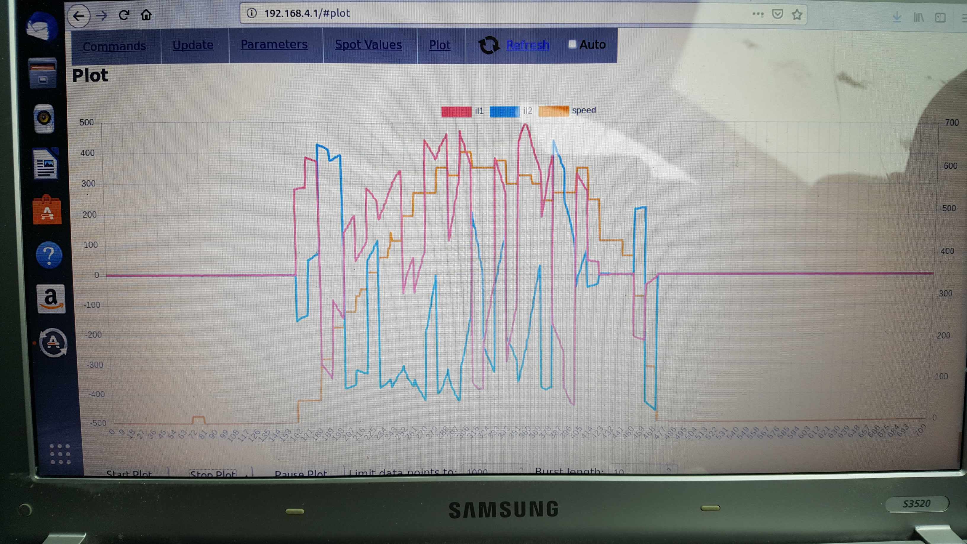

I went down to the car today and changed to the correct 80 ppr setting for the encoder. Sadly however this didn't fix the problem although the motor does run much smoother. The main problem seems to be very high motor amps from the start. With the second parameter set, basically changed fslipmin to 2 and flipmax to 10 and slipstart to 10%, I get a very good response for the first few mm of throttle travel. But as soon as I push the pedal the motor amps max out , current limit kicks in and the car creeps.
I have attached a graph of IL1 and IL2 vs Speed for first gear and gradual full throttle pedal travel. In neutral I can rev the motor to 6000rpm no problems and regen it to a stop. If I try and start in a higher gear the motor amps max out and the car does not move. I'm going to trailer the car back home in the next few days as it will be easier to do tests when it's here. Any help much appreciated:)

Only thing that jumps out is the high fweak. Which I calculated to be more like 80Hz. Maybe try the ppr part of the tuning script (only works with over uart)

I had set fweak high to try and reduce motor current. Almost like the motor is not making any back emf.
