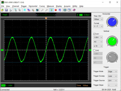

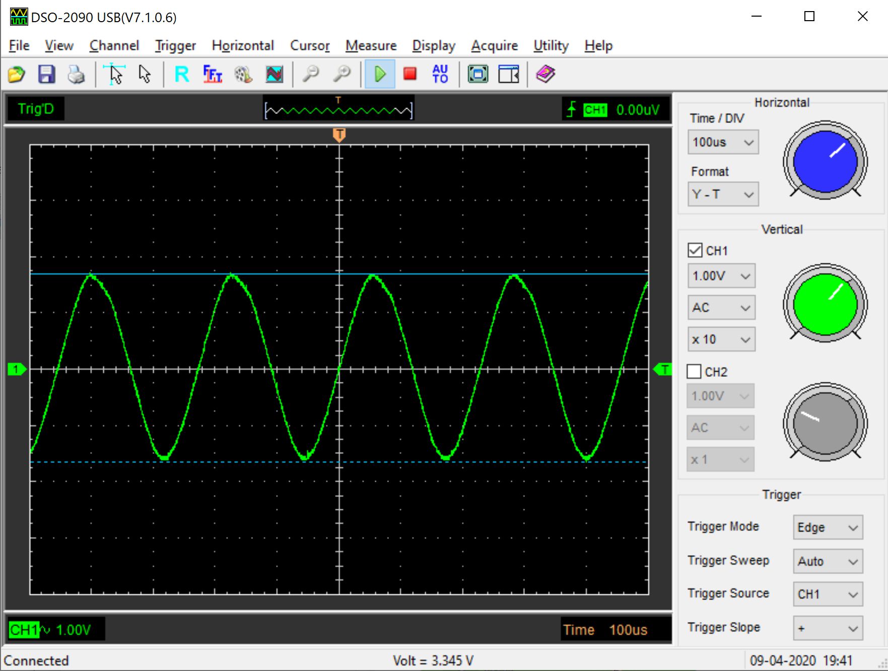

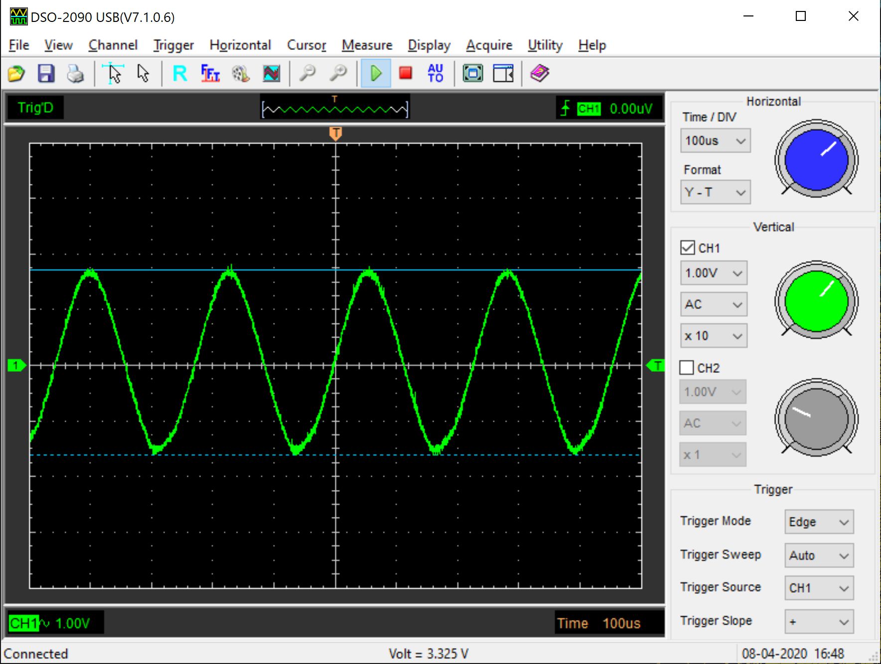

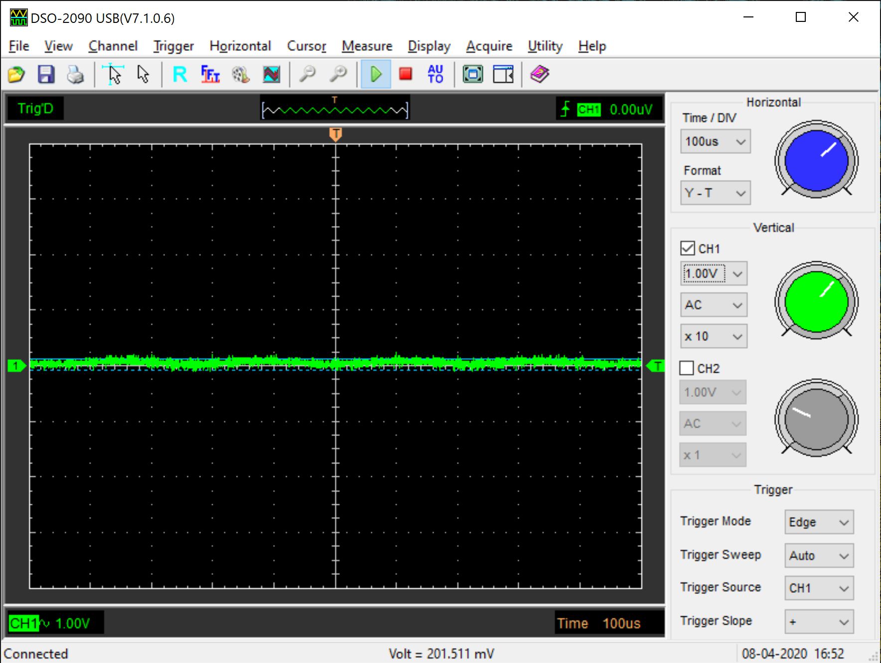

Here are the plots for sin. I rotated the the rotor and tonight when O powered up the inverter, and manually started the inverter via WiFi, I got no errors.
So connected the scope and watched as I rotated the rotor. I captured the high and low.
BTW, because of the Magnets, the rotor has positions it comes to rest at. of those positions, one has a sin voltage of almost nil.
HIGH - 3.325V
LOW - 201.5mV
COS HiGH (Didn't do low. But watched it as I suun the rotor. Goes close to nil like the Sine.

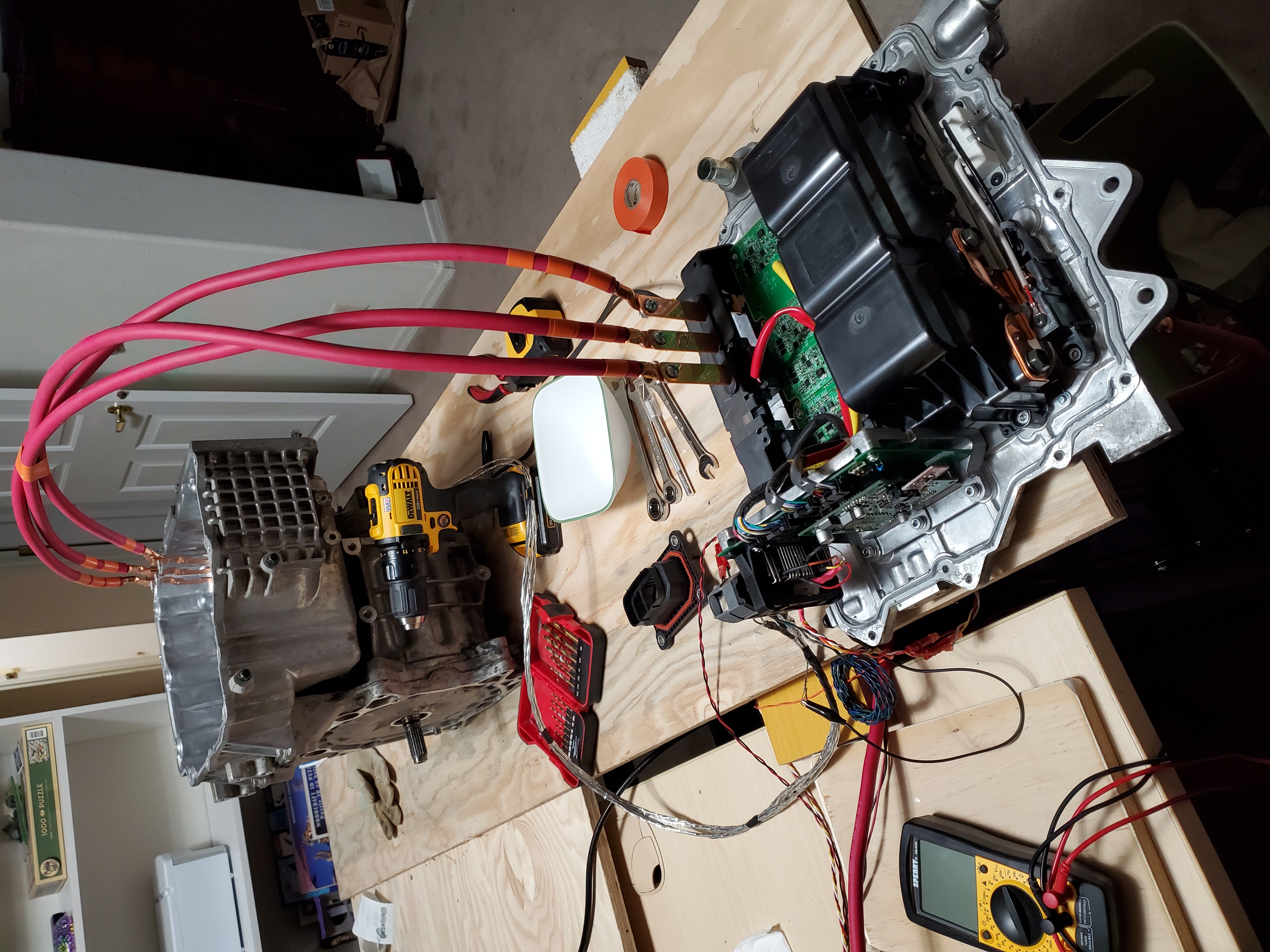

Watched your movie, mine is currently on the bench too and when I finally got all the connections right and followed the instructions and hints, I was able to spin it up. Started slow but then it rocked once when the motor torqued up and it went to 10,000 RPM on the bench as I scrambled to cut power.... Scared the crap out of me.
Because I had the Inverter laying on the bench, upside down and sideways, I had to label the 3 phase connections between the Inverter and the Motor.
I also triple checked the Resolver connections. And had to by some shielded twisted pair wires for those connections.
