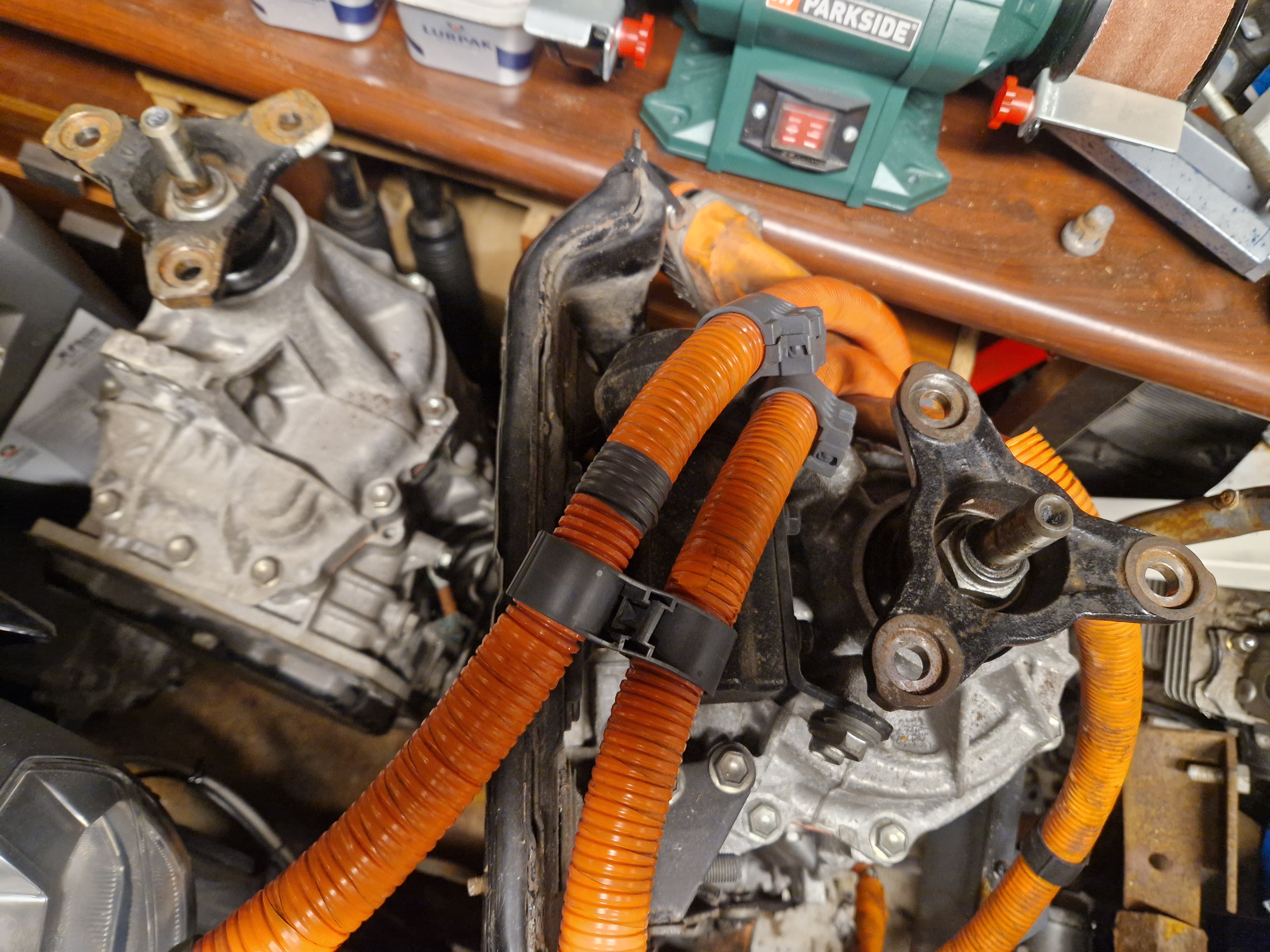

Hello, Has anyone successfully installed the rear yoke of a 450h transmission onto a 300h transmission and can give me instructions? Thank.

Yes, I've just done that today. They're a straight fit; just undo the 29mm staked nut and lift off the yokes and they can be swapped either way.javiersnyder wrote: ↑Wed May 29, 2024 10:11 am Hello, Has anyone successfully installed the rear yoke of a 450h transmission onto a 300h transmission and can give me instructions? Thank.
Here are my IS300h and GS450h with the yokes swapped around.
