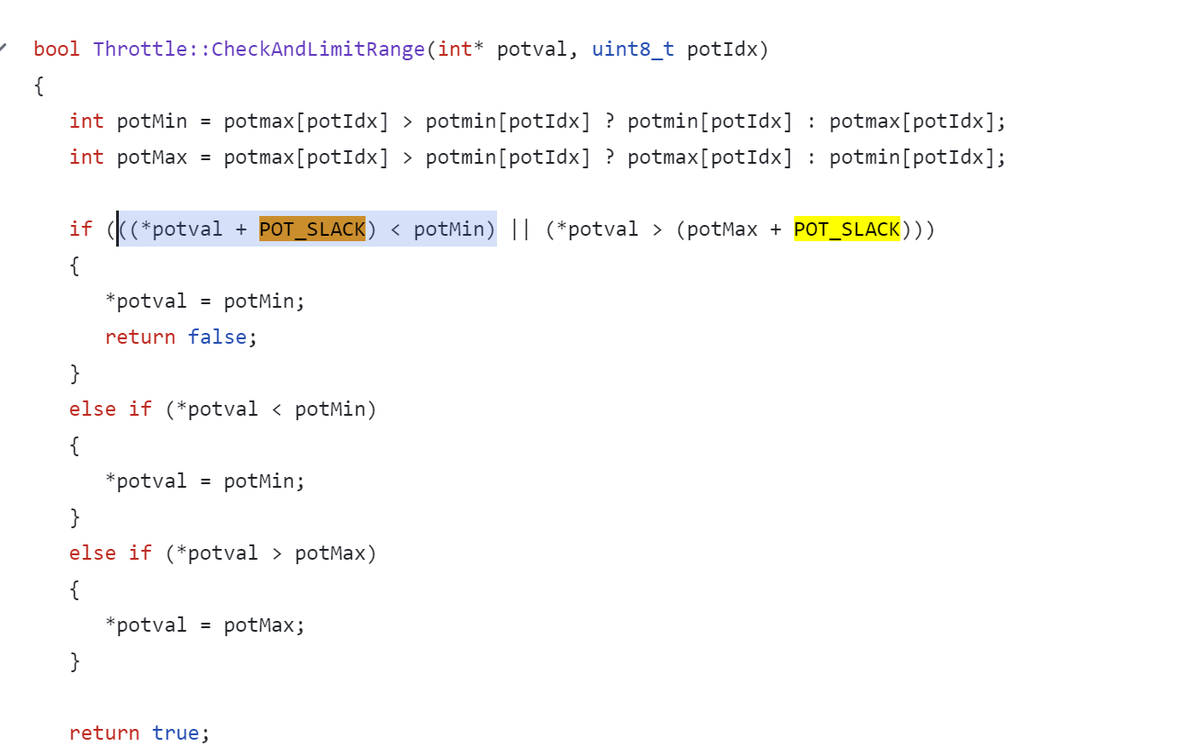

There is a 200 digit headroom above potmax. So anything above potmax will be interpreted as potmax. Once you cross potmax+200 throttle immediately returns to 0 because we assume that there is a wire break and the throttle value does not reflect the drivers command anymore.
That sort of points to "why 3500?". We need to be at least 200 digits away from 4095 which would be 3895. Now a loss of ground doesn't necessarily mean it jumps to 4095 because of the 10k pull-down. So lets move further away. 3500. Slightly arbitrary but spent some thought on it.
If the fault happens to be intermittent it will bounce around, yes. If it somehow fixes itself at least you gain control of your vehicle again. Hence why I don't just fully shut down on out of range errors. If you decide the vehicle is not drivable anymore you put it in neutral and coast onto the shoulder.

johu wrote: Wed Jun 05, 2024 8:59 pmThere is a 200 digit headroom above potmax. So anything above potmax will be interpreted as potmax. Once you cross potmax+200 throttle immediately returns to 0 because we assume that there is a wire break and the throttle value does not reflect the drivers command anymore.
Ahh. This is the piece I was missing. I thought it just immediately errored out and cut throttle. Okay, that makes sense.

johu wrote: Wed Jun 05, 2024 8:59 pm ...
Just checked the release. So the potmin should also be at least +200 points from the value when fully released?
