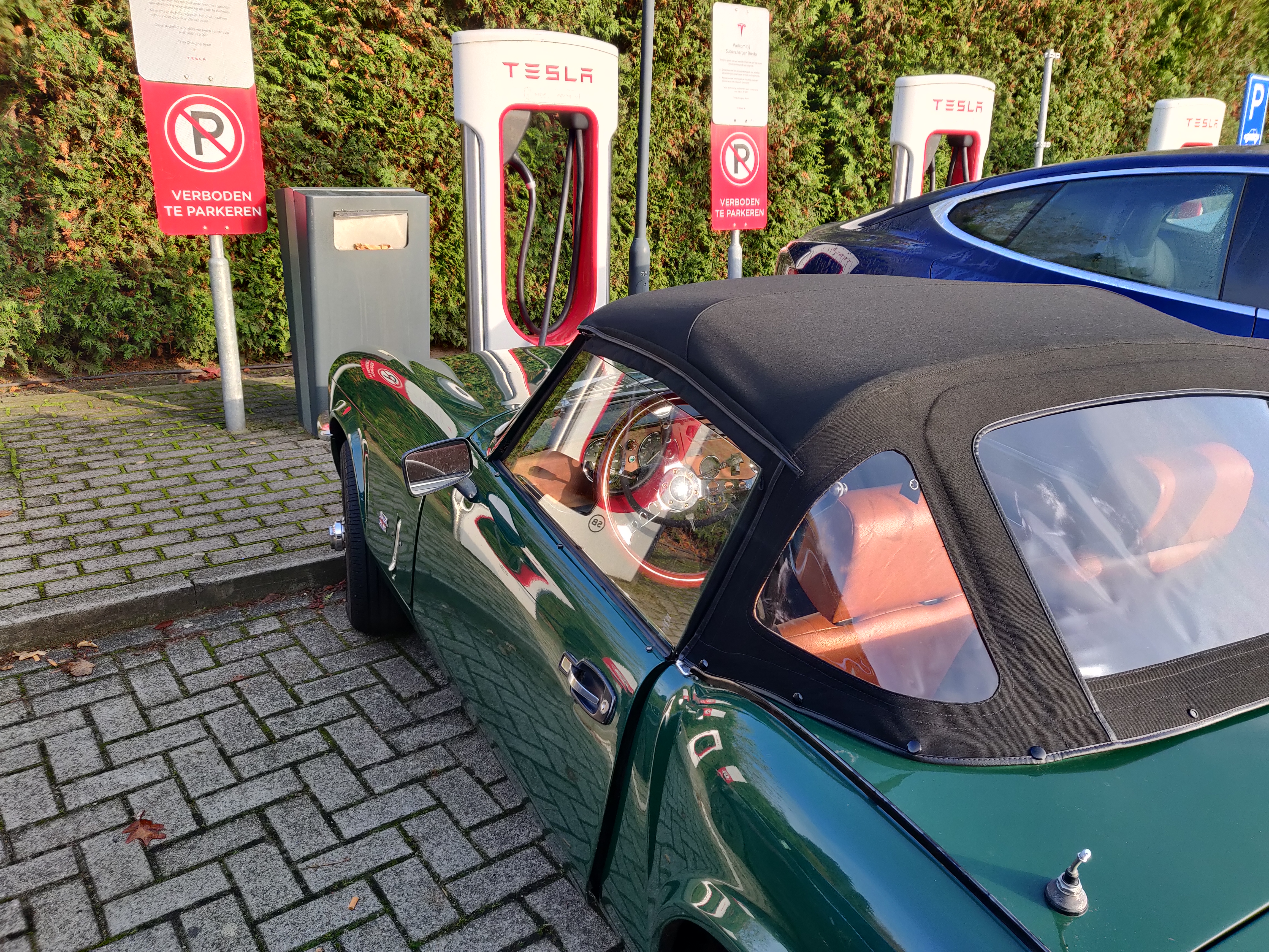

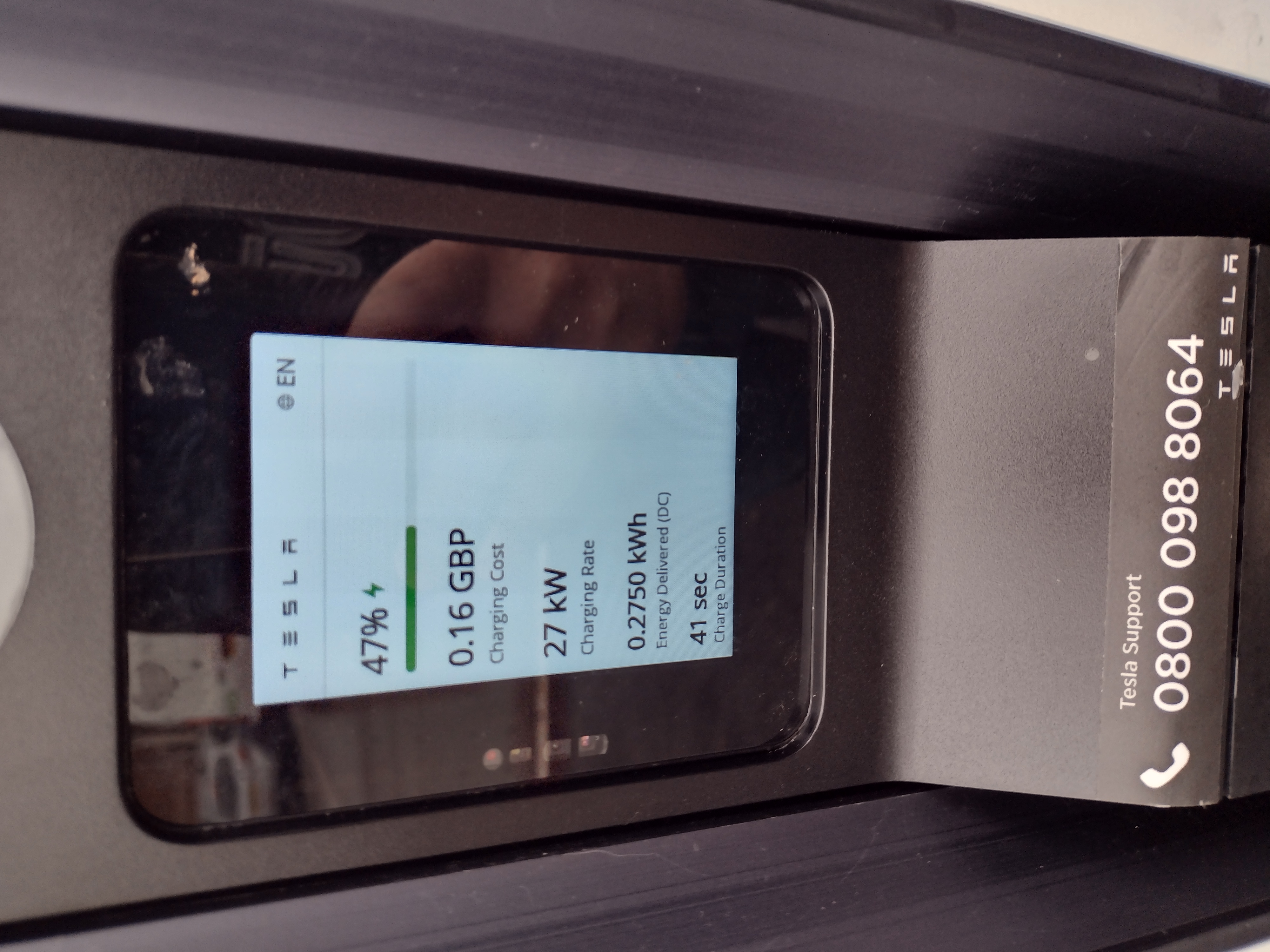

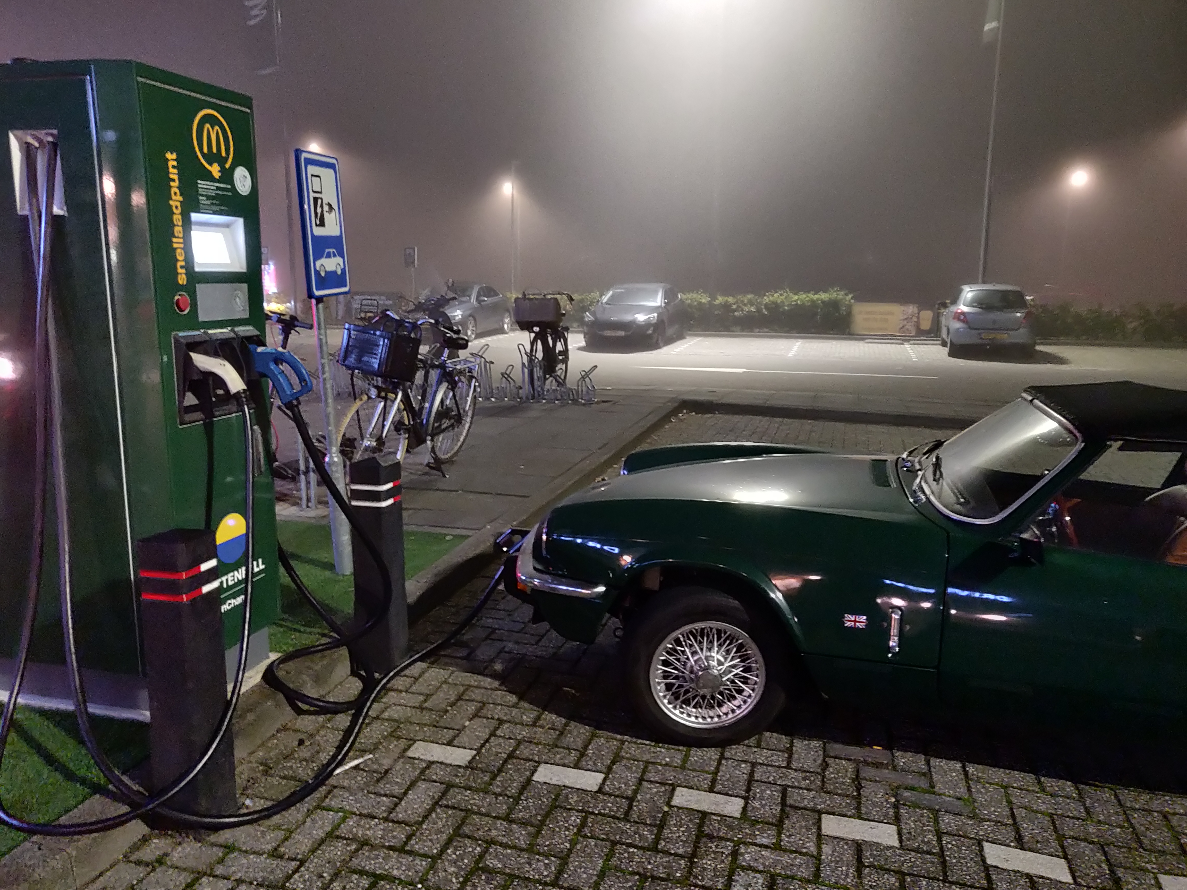

Thought I'd open up a "build thread" for all Foccci success stories (please no usage questions here)

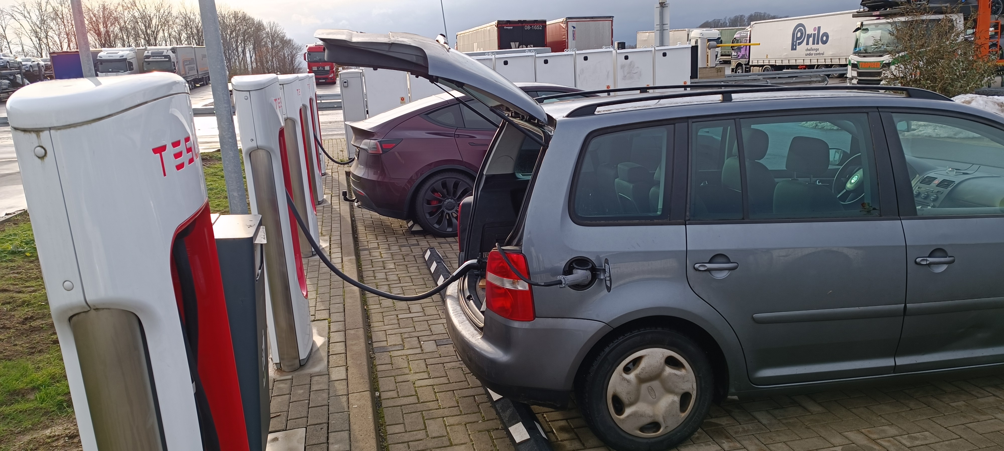

Touran
Picture still shows CHAdeMO adapter, now it is fully integrated. Charge limits calculated by stm32-car MEB BMS module. Max charging power 85 kW

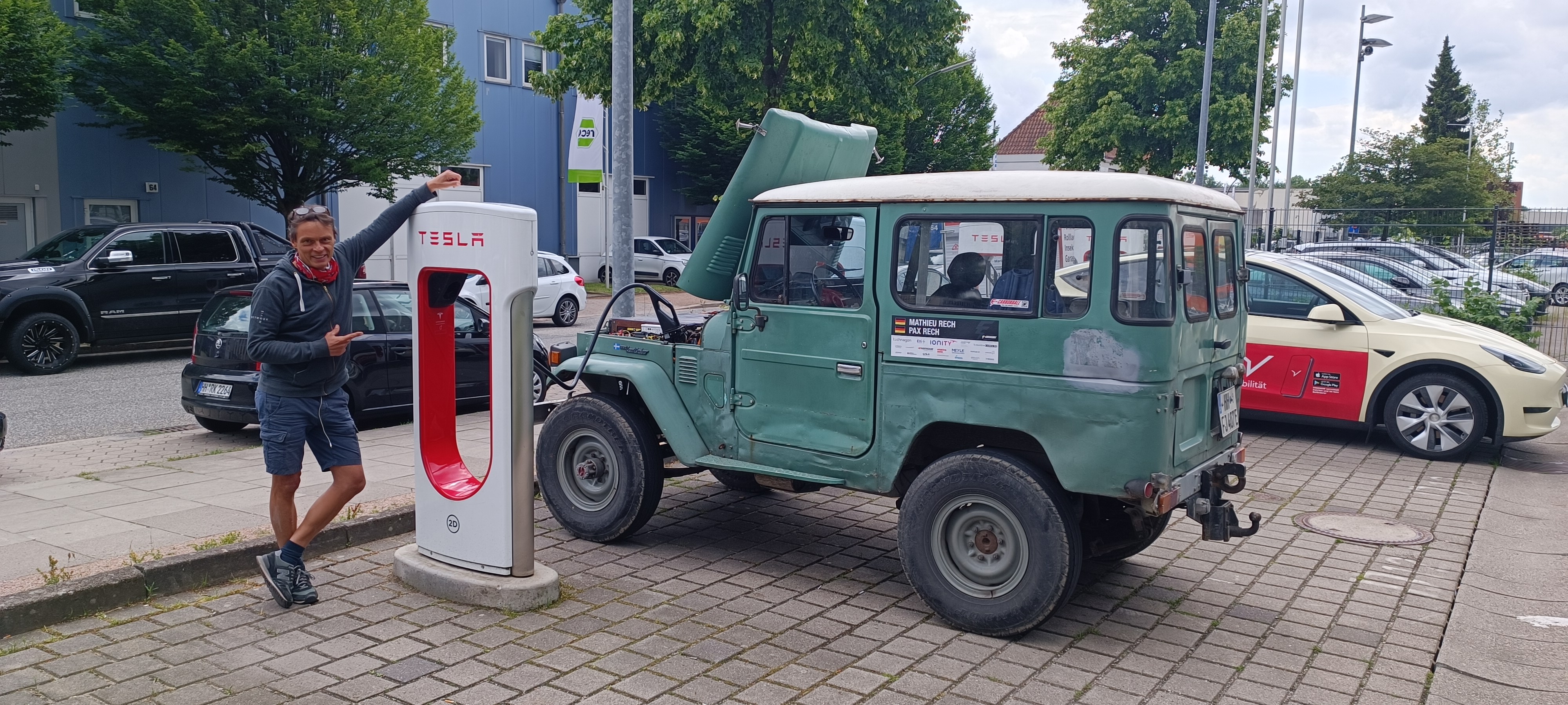

Mathieus Land Cruiser
Charge limits calculated by Orion BMS. Max power 90 kW

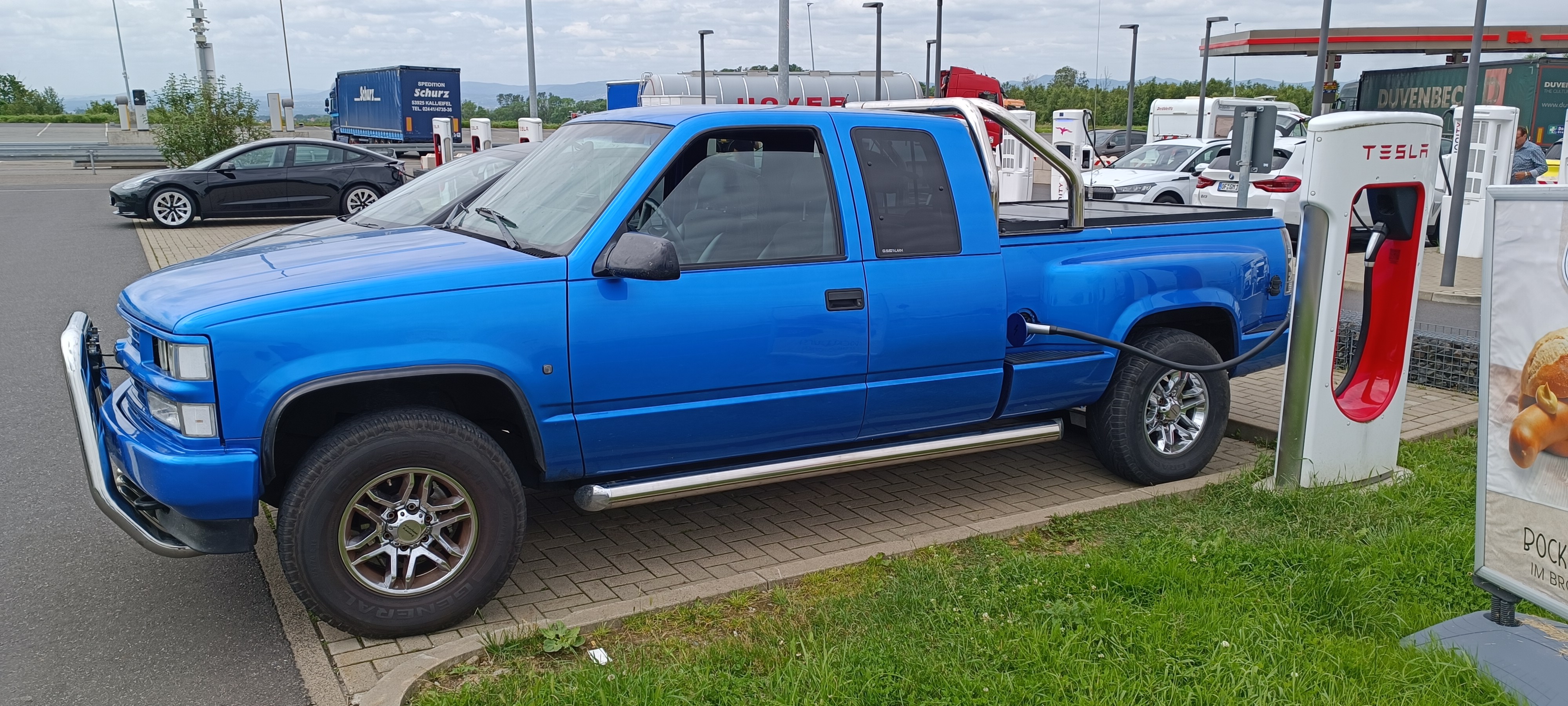

Svens Chevy Pickup https://ev-conversions.info/electrified ... et-pickup/
Orion BMS. Max power 82 kW.

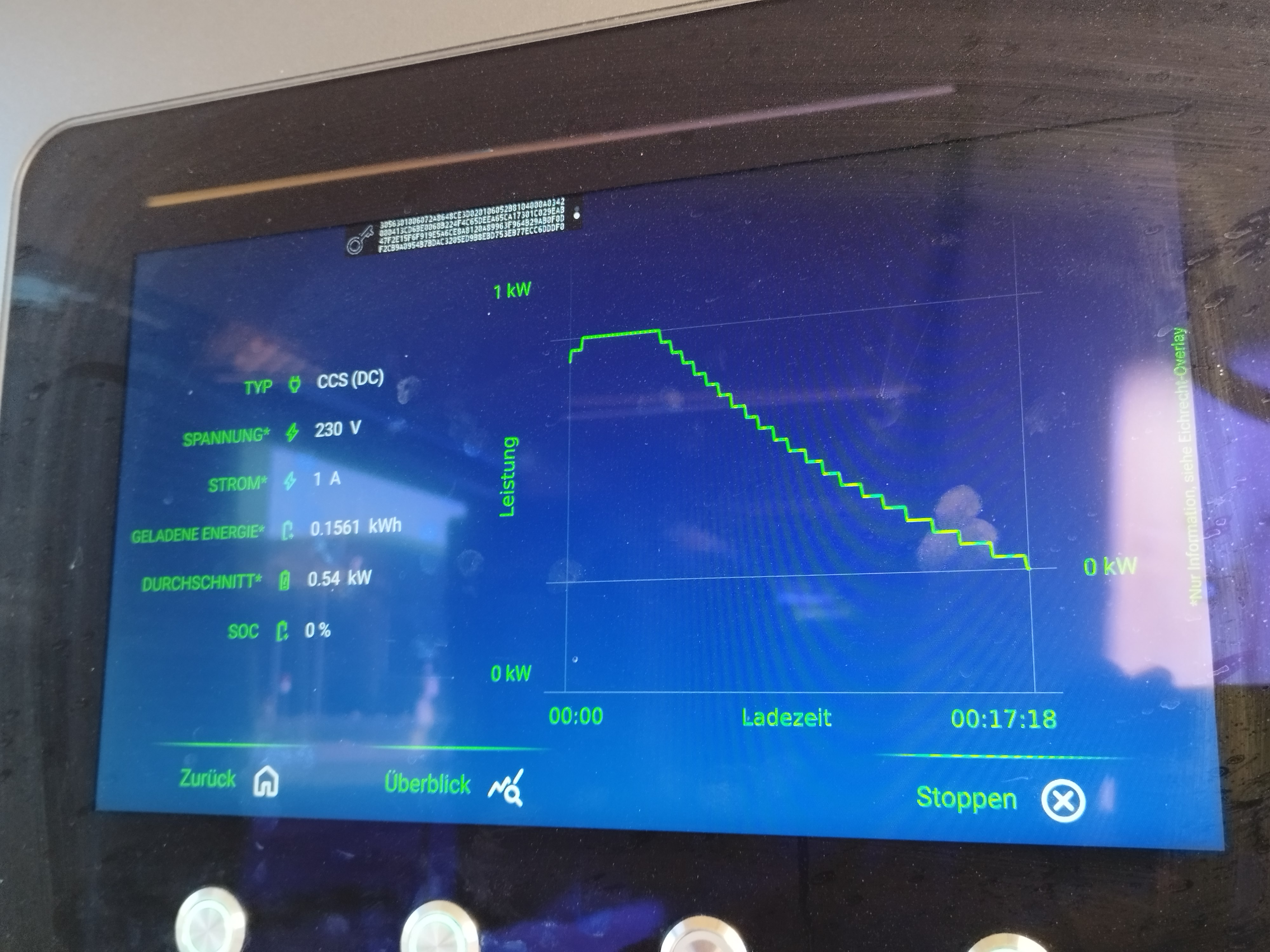

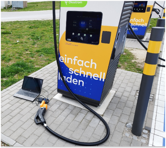

Uwe is charging the laptop with Foccci. The label on the alpitronic charger says "Einfach Schnell Laden", this is "Simply Fast Charging". Fits quite well :-)

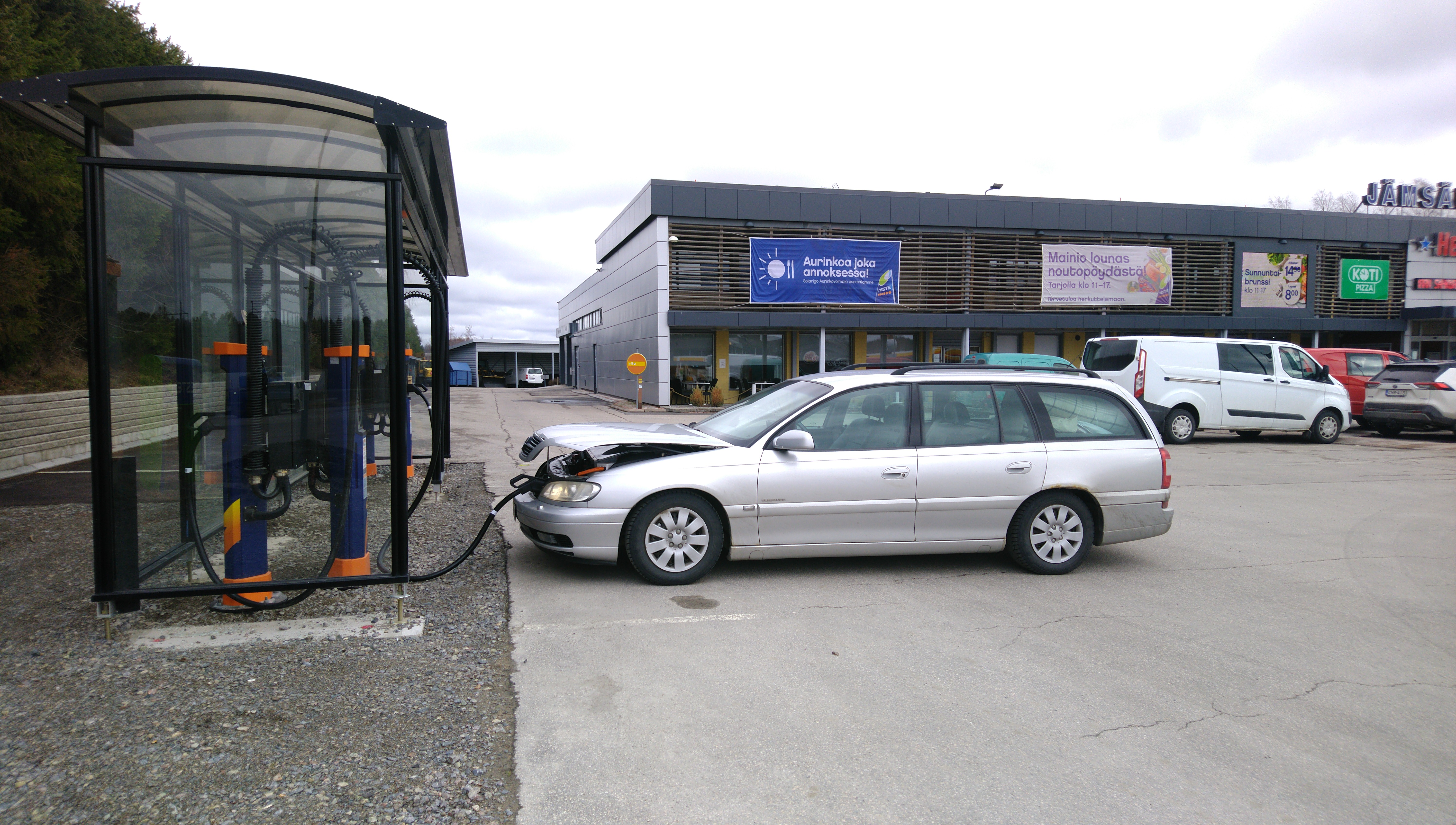

The Omega. 250A (70-80kW) is the most I dare to try with the 13 old 2015 Tesla Model S modules. Only once they've warmed up but not too warm.

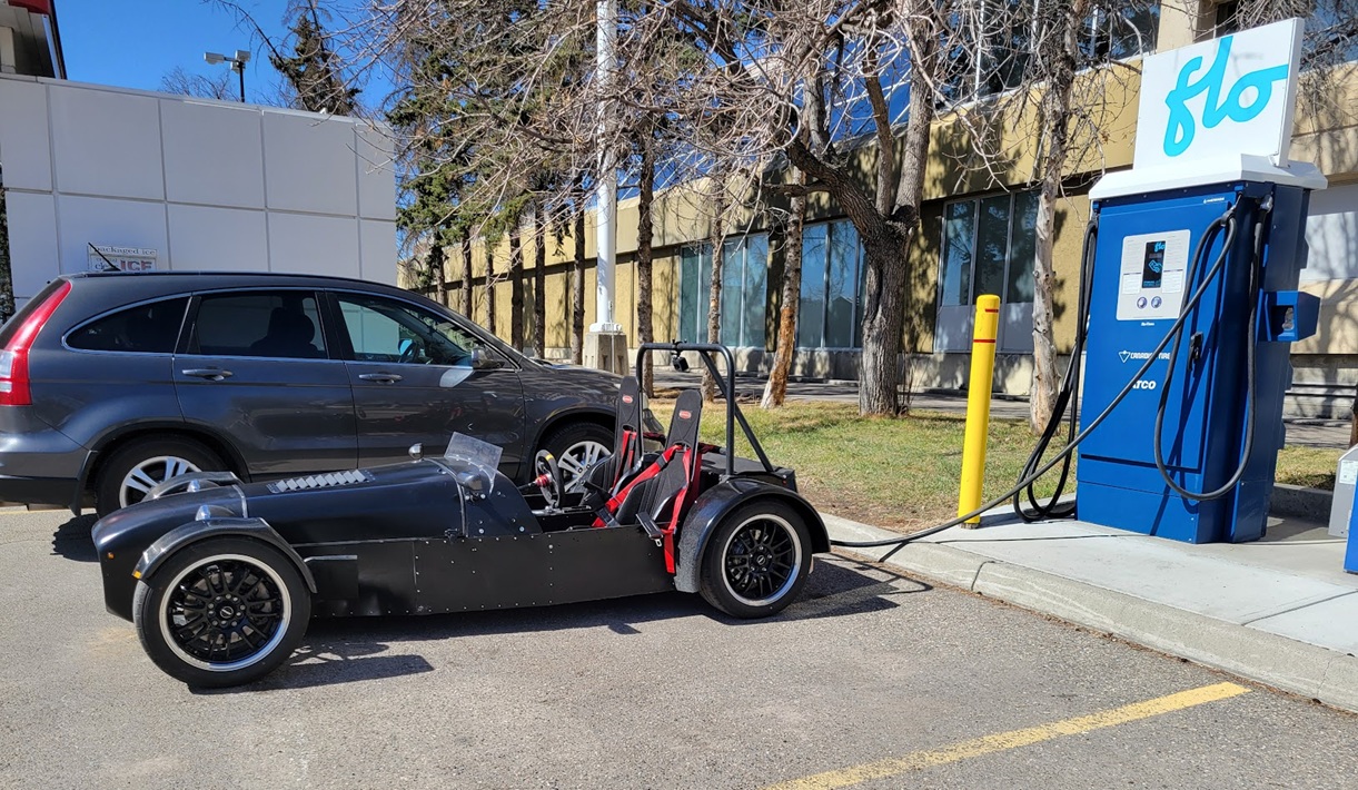

Post by dougyip »

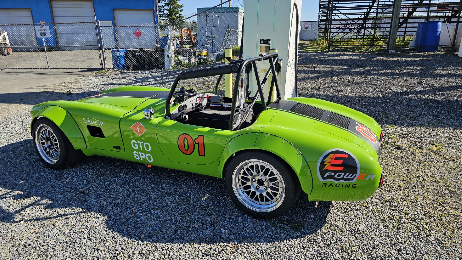

Charging at 120kW - which is the maximum output of our station at Mission Raceway near Vancouver, BC. At some point, we will visit a commercial charge station and see if we can charge at 350kW. We're using water cooled Tesla Model 3 modules, so there are no issues with heat. Charge profile is managed by our own controller with an Orion2 BMS also watching in the background for safety.

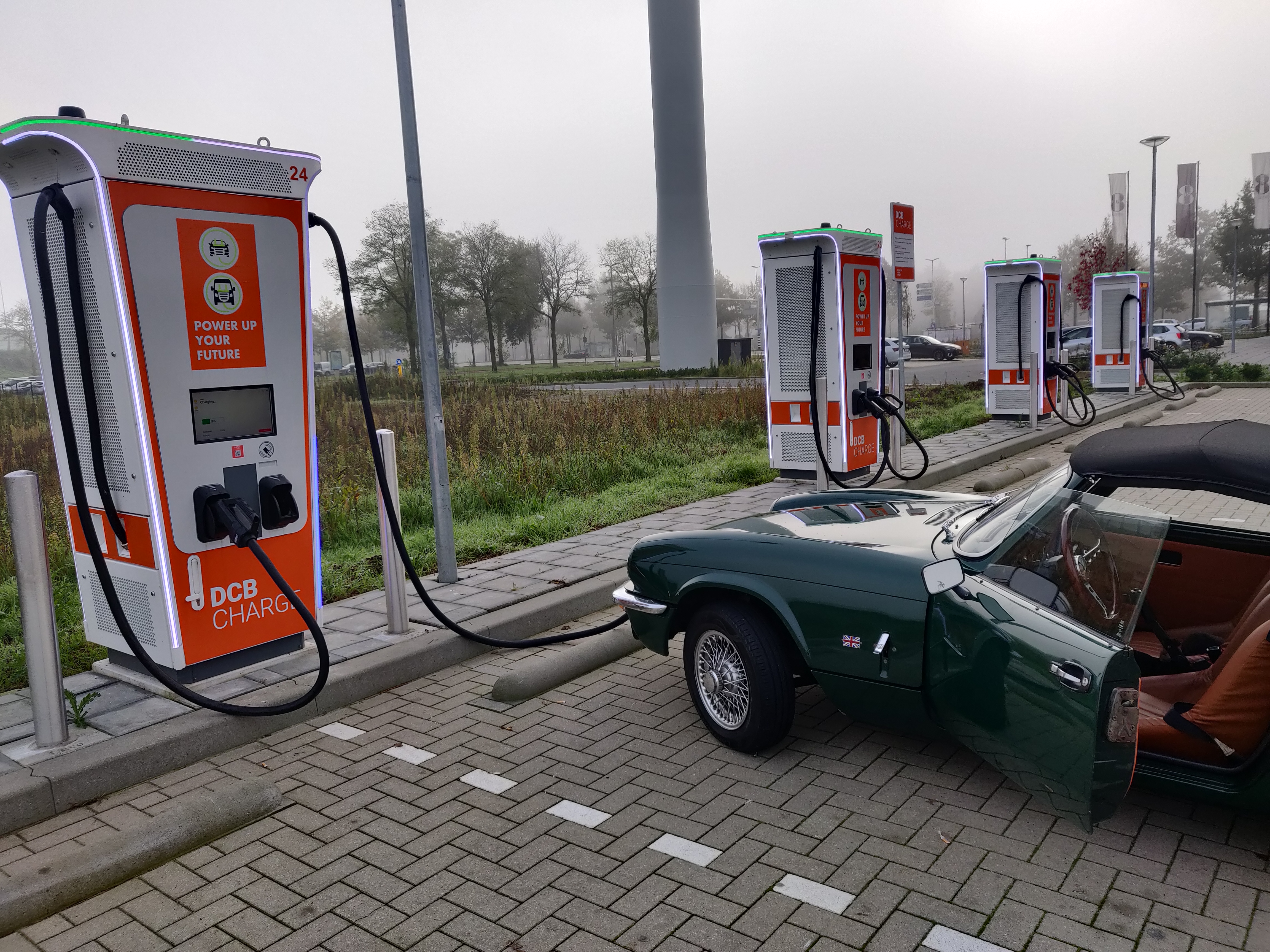

The Previa, now with Foccci. The pyPLC hardware has been ditched and the connector moved. I've been charging at 180A and under, which is about 50kW. I'll increase that a bit when being at the optimal temperature range (25...45°C), once I have some time.

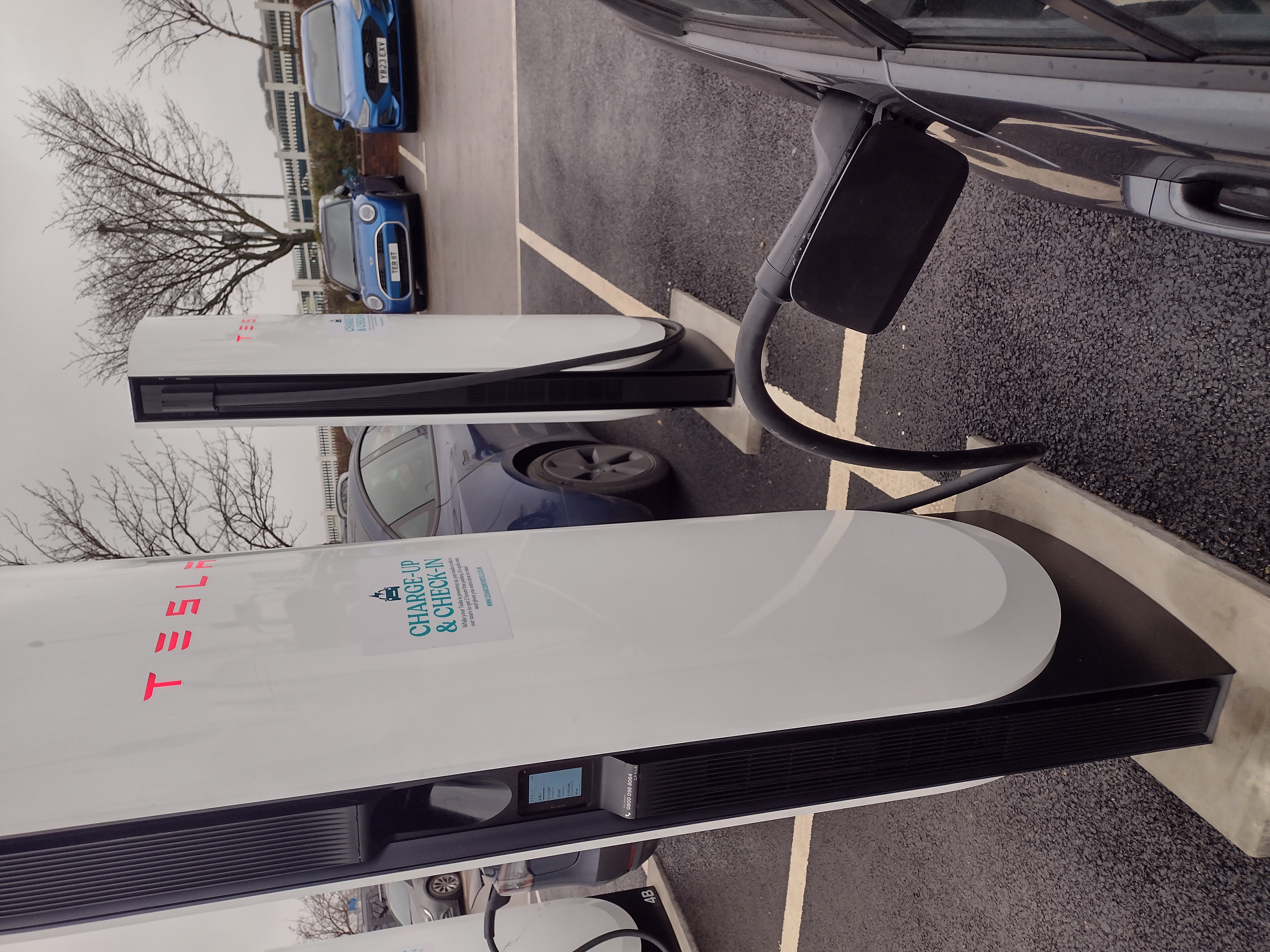

Re: The Foccci gallery

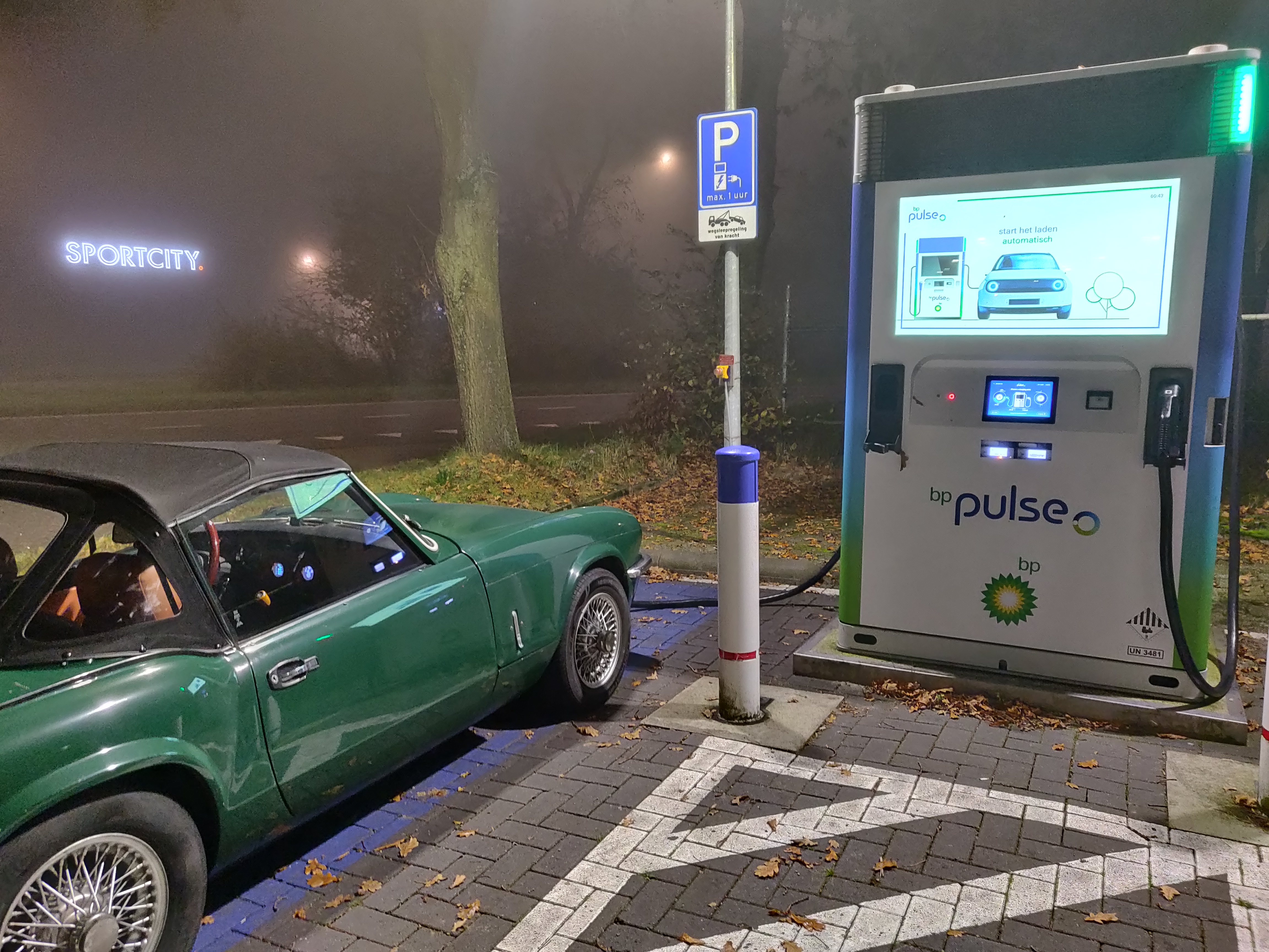

Zombie + FOCCCI is a go.

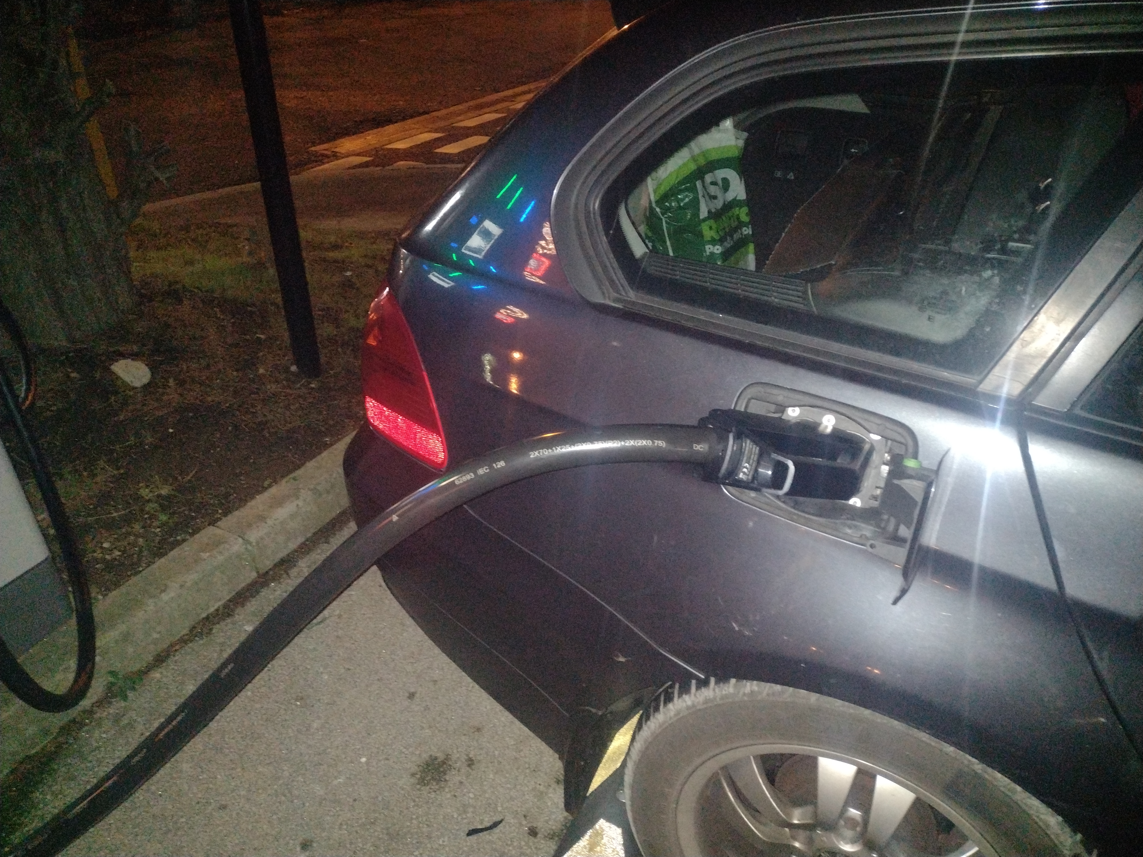

First test of Foccci. Works well :)

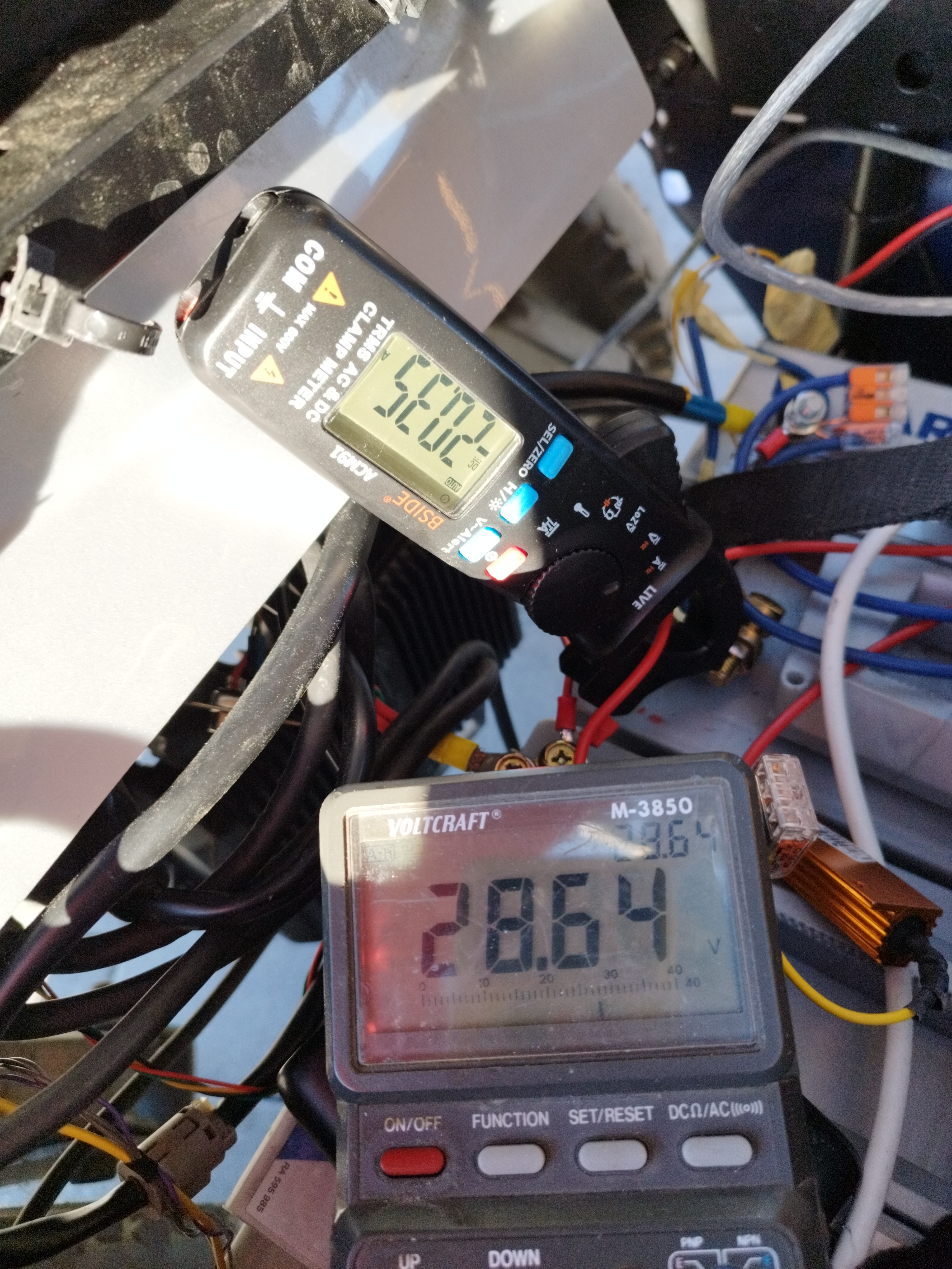

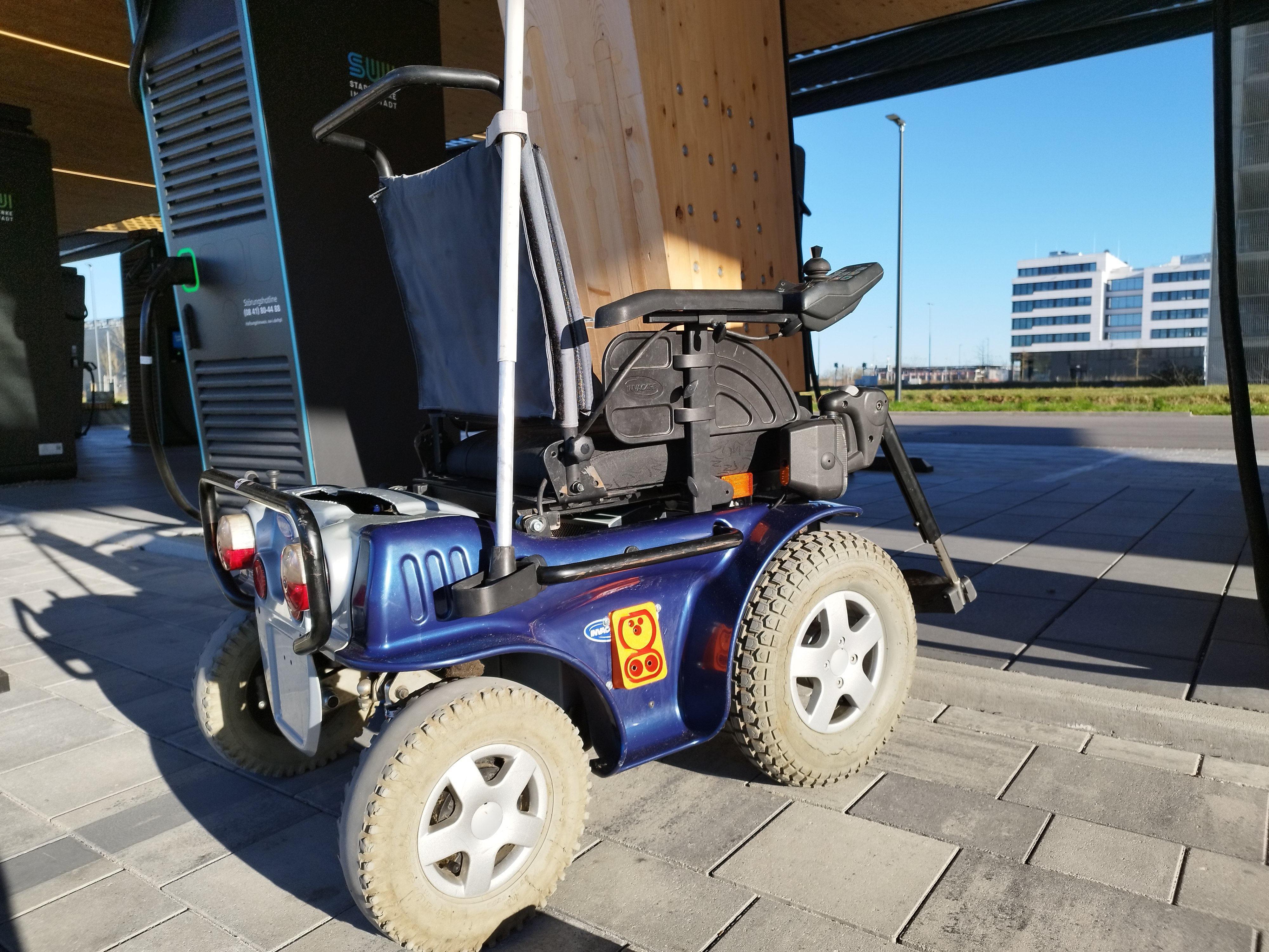

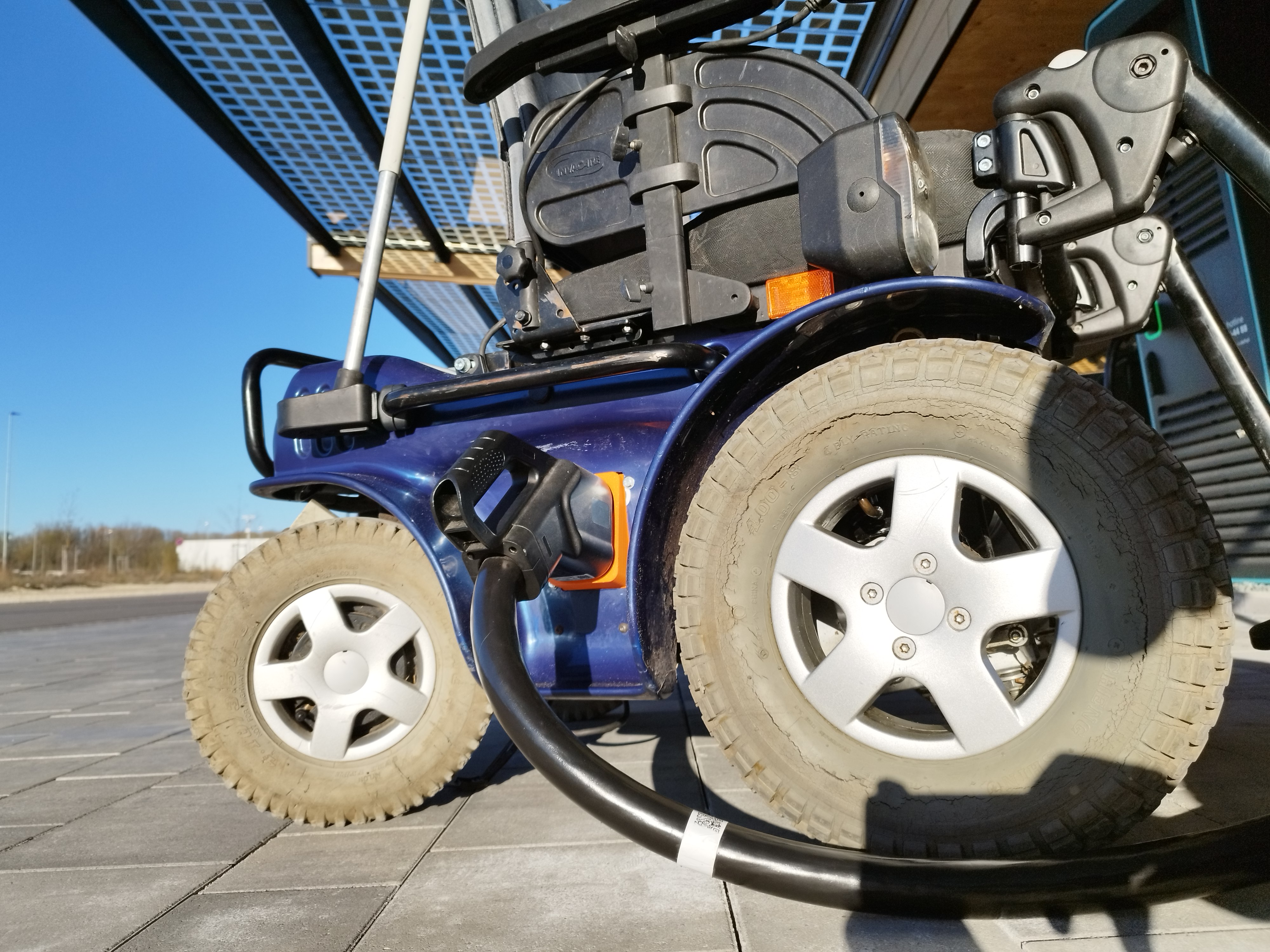

Charging the wheel chair, 24V lead acid, using industrial switch mode power supply to convert 230V DC to 28V DC. Foccci powered by USB power bank because I killed the planned 24V to USB by shortcut ;-)

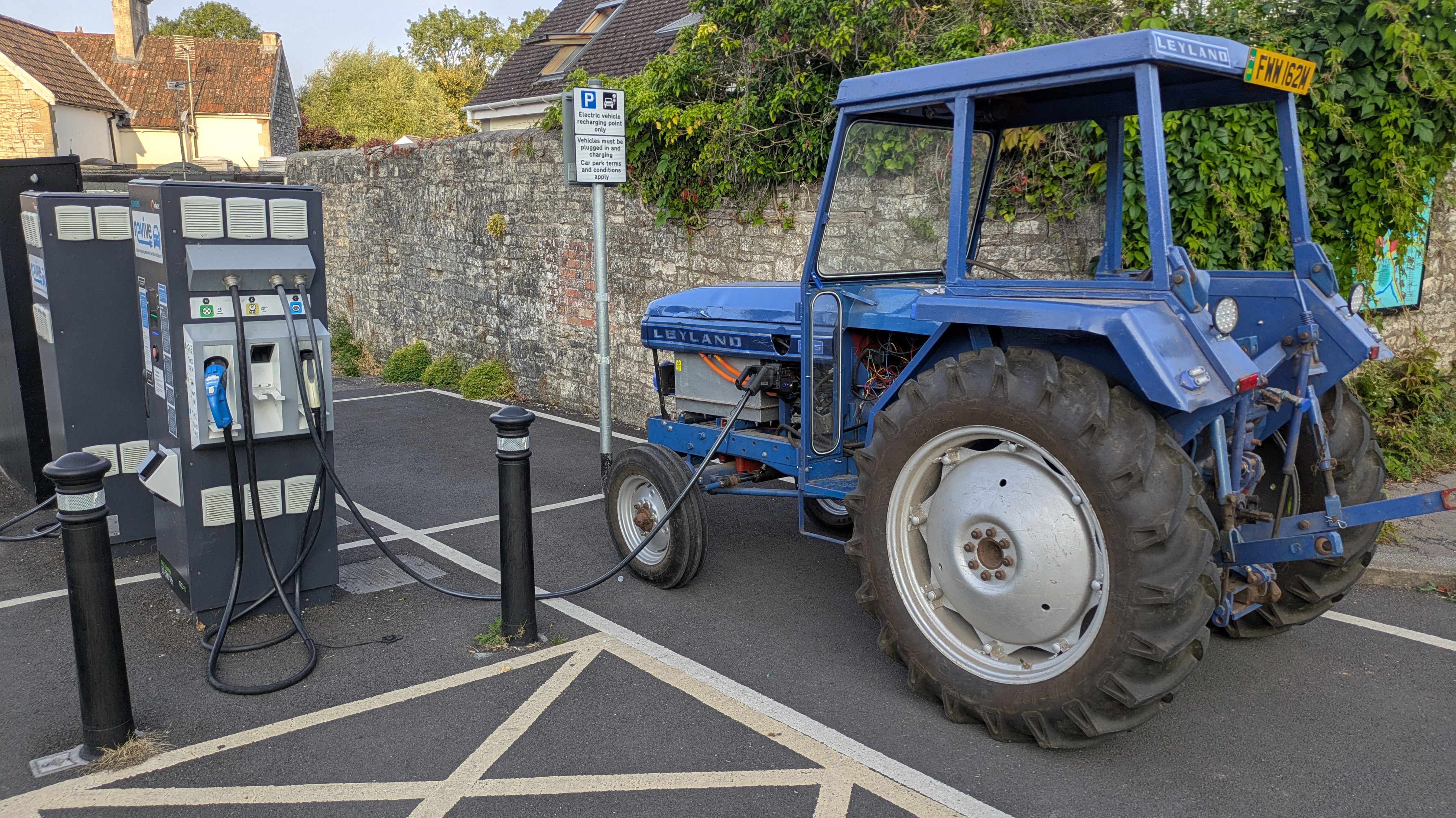

Post by LRBen »

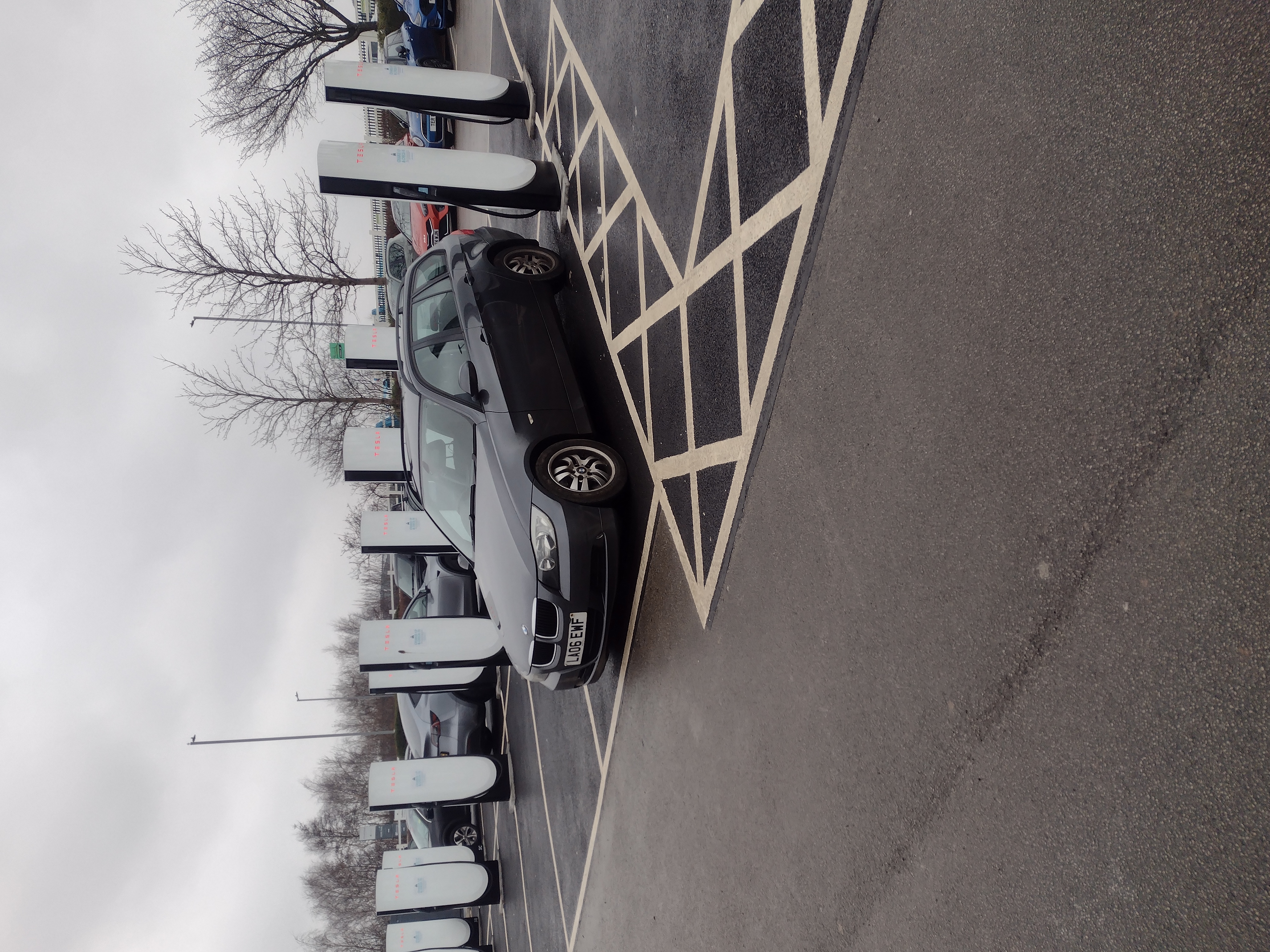

Finally drove past a fast charger today and gave it a go. Worked first time! Setup was through the auto config in zombie.

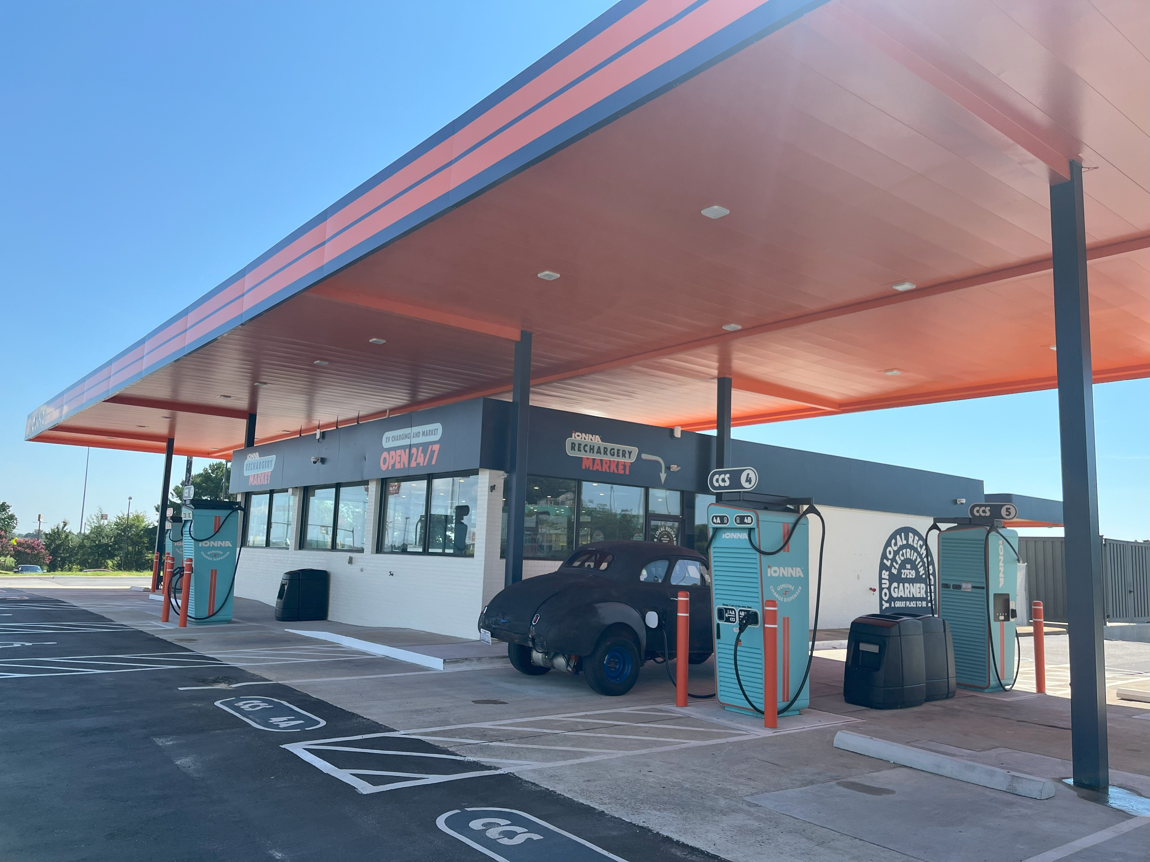

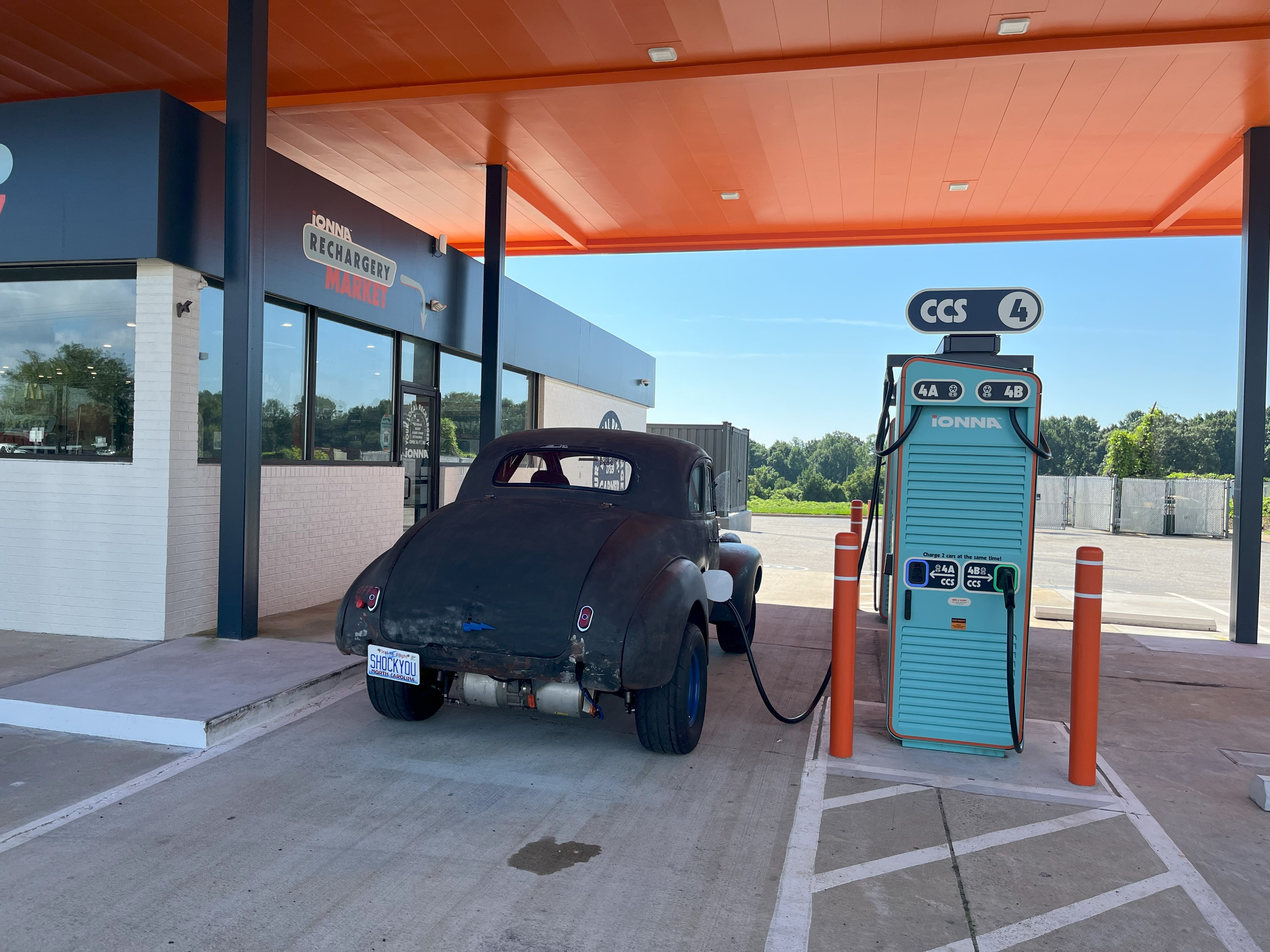

Post by P.S.Mangelsdorf »
I finally had a chance to take the '40 to a brand new charging station that's only a few miles from me. This is from the new "Ionna" network, which is funded by a bunch of the major OEMs. They have a FANTASTIC concept, which is building out the EV equivalent of a gas station, primarily by buying rundown gas stations and converting them. So the stations are covered, well lit, with a lounge, bathrooms, and snacks (all accessed via QR code). They have CCS stations on one side of the building, NACS on the other.
The '40 charged flawlessly using FOCCCI.
