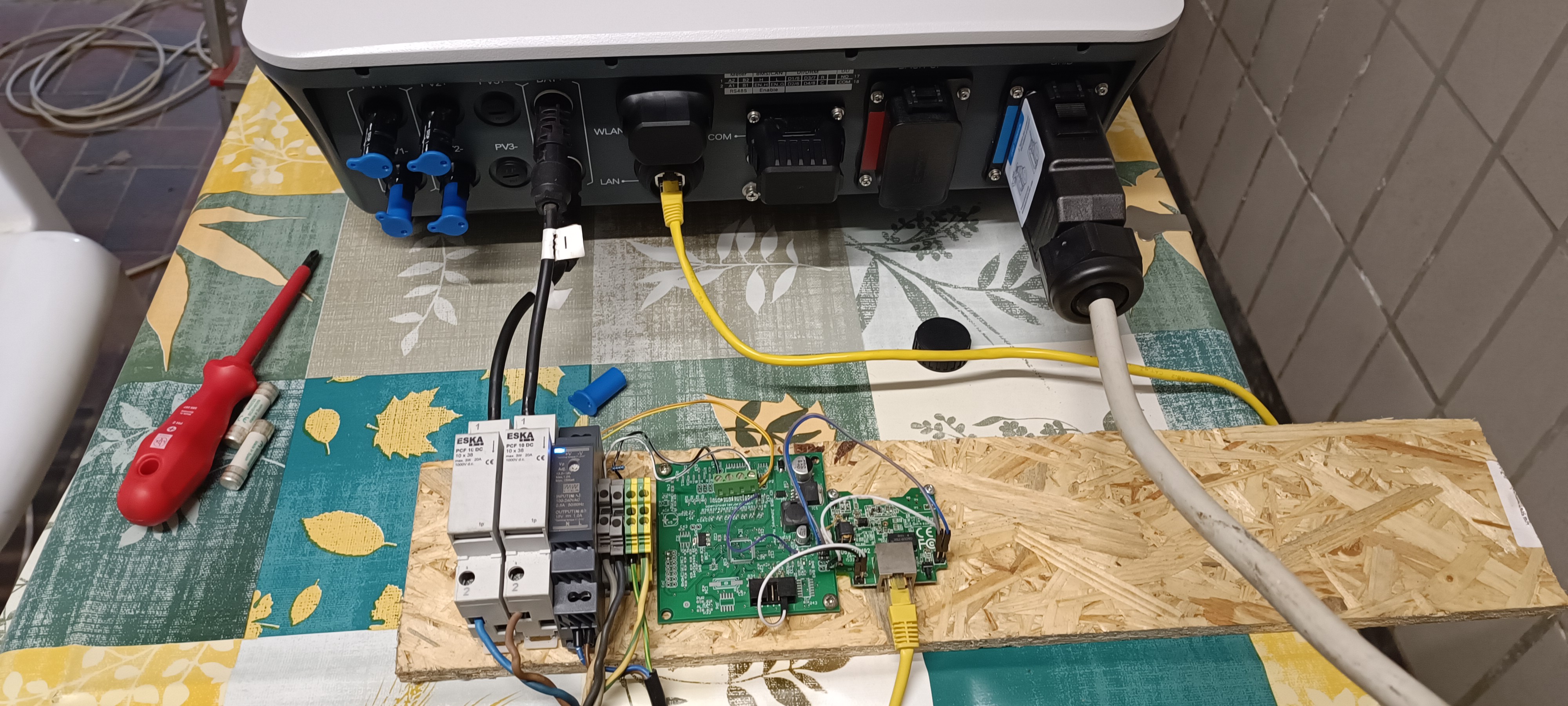

I think all the building blocks are there to create a (partially) open bidirectional DC EV charger.
Ingredients
- Commercial battery or hybrid inverter allowing 400V battery voltage (e.g. SMA, Growatt etc)
- Alternative 1: pure PV inverter with settable power limit and some hacked OBC for charging
- Alternative 2: use the cars OBC for charging, would require a true "Combo" CCS plug with AC pins
- BeagleBone or Raspberry running pyPLC in EVSE mode
- Powerline modem
- CCS cable
Whatever supplies DC power also needs to be able to precharge its output to the cars battery voltage. I think many OEM cars won't close their port relays otherwise.
Question: Can the powerline modem be used as-is only with patched PIB? Like capacitive coupling from L to CP?
Here is the datasheet of the Growatt
https://growatt.tech/wp-content/uploads ... 202201.pdf
I think the cars port relays would be permanently closed. Excess PV energy is dumped into the car until it can take no more (denoted by current limit or some upper SoC limit, both communicated by CCS). And when energy is needed it can be drawn from the car until a lower SoC or voltage limit is reached. It's probably most versatile to run this in parallel to the grid but of course an offgrid scenario works as well if you have a small secondary battery to supply your home while the car is gone.

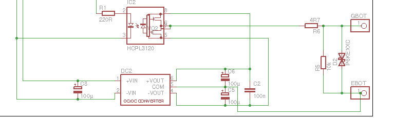

The prove-of-concept of a separate software-controllable precharge-supply is available here: https://github.com/uhi22/stepup-test#le ... ut-voltage

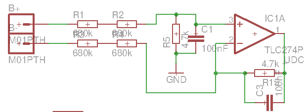

You've got everything :) Could also replace the bespoke voltage sense board with the input voltage report of the PV inverter

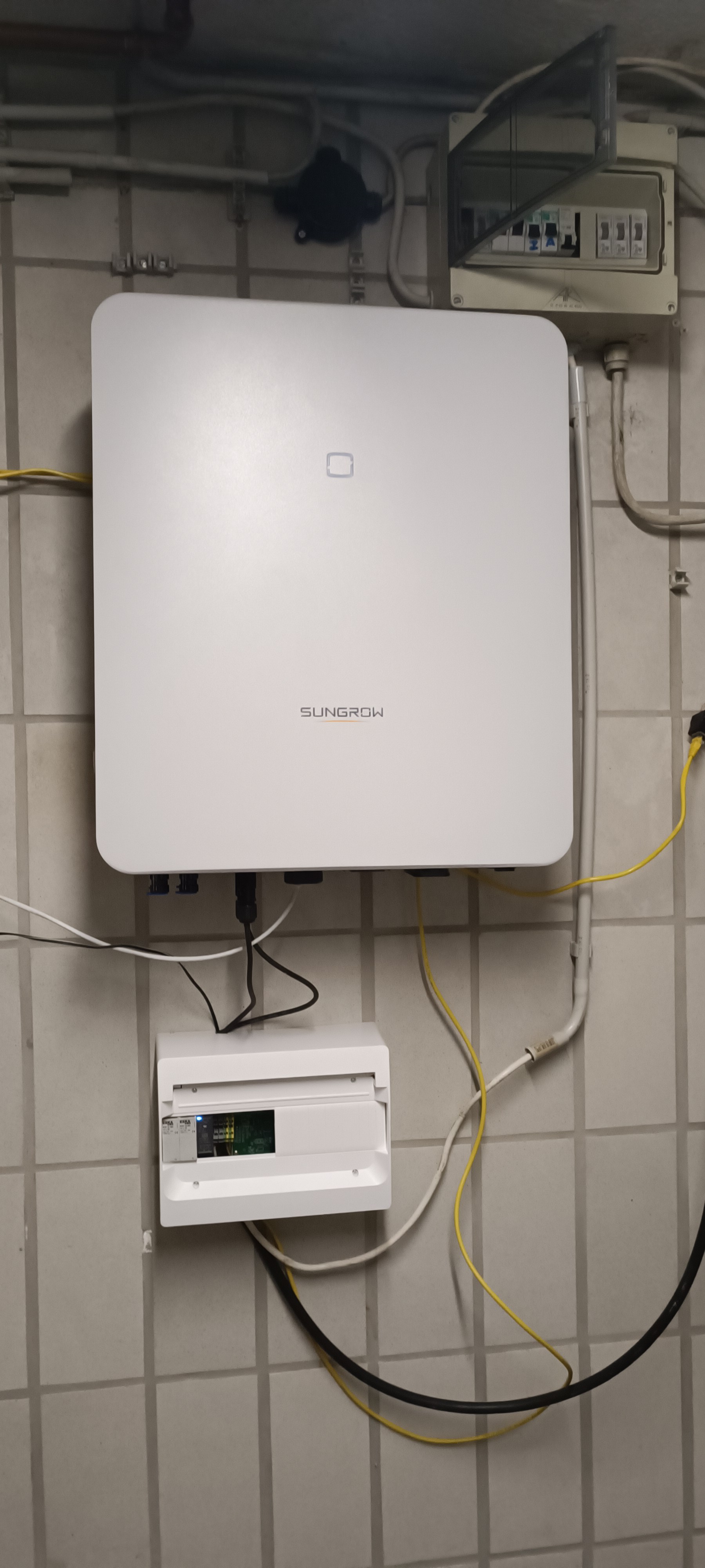

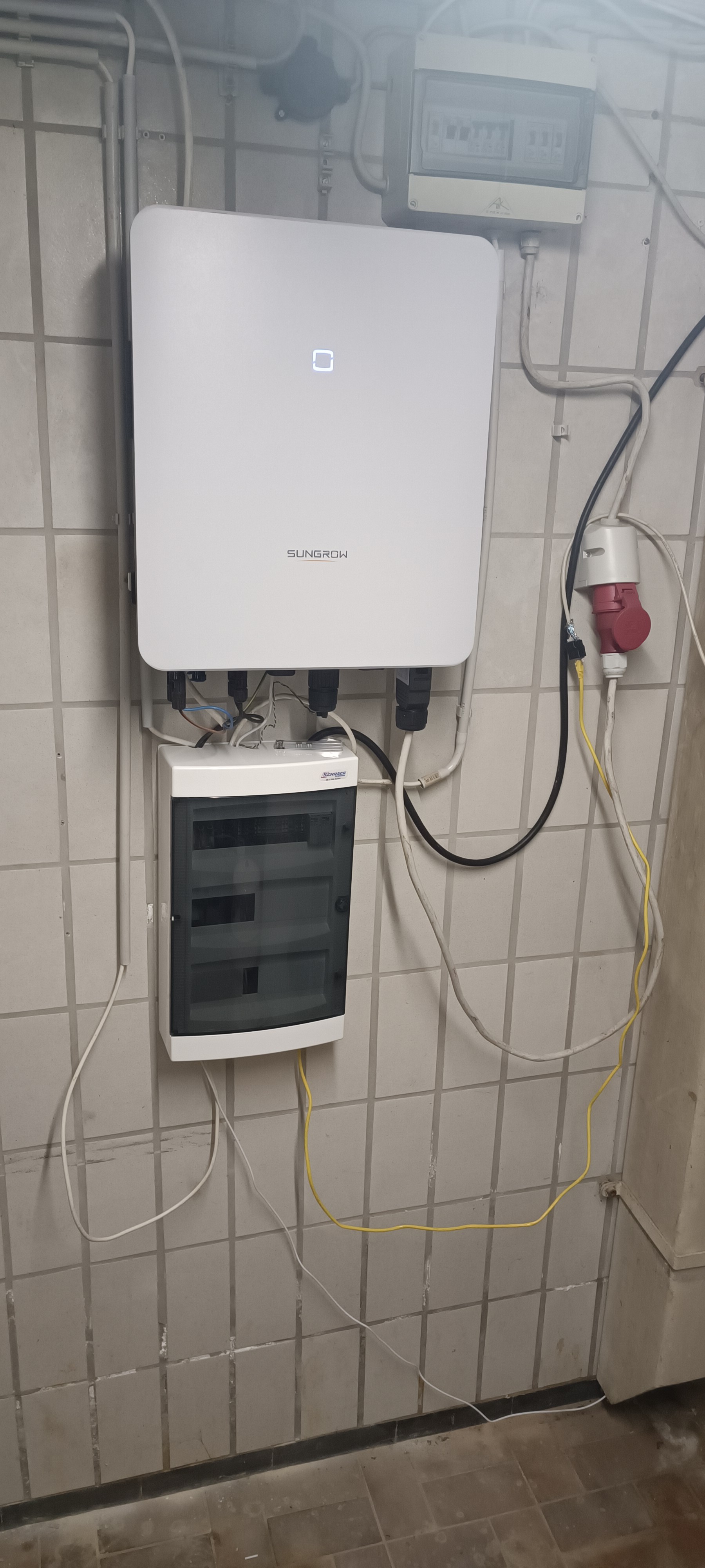

Picked up a 5 kW hybrid PV inverter today (SunGrow SH5.0). Now all the building blocks are complete and I "just" need to combine them.
Now keep in mind this project isn't about power electronics at all. All power is handled by a commercial PV inverter. It's just the control logic that is being brewed here.

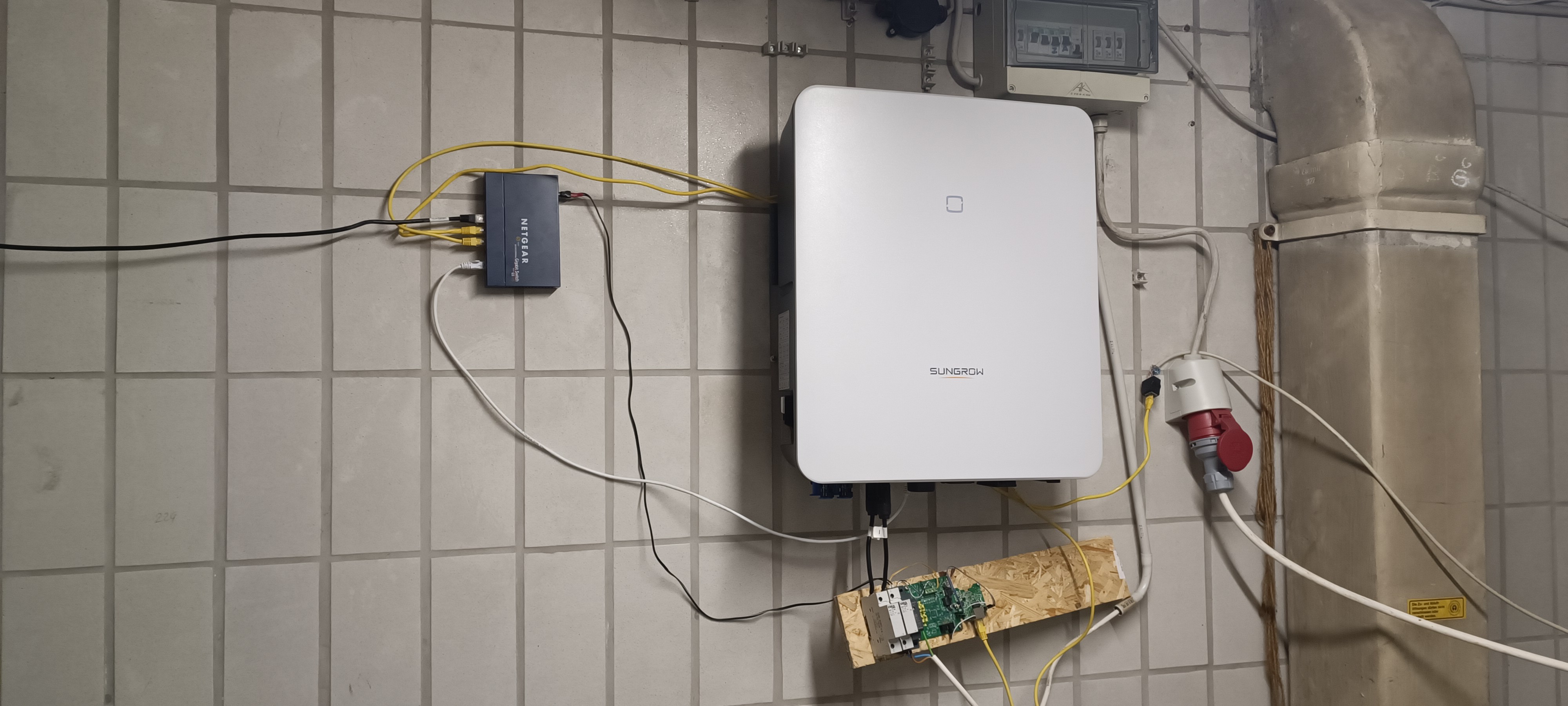

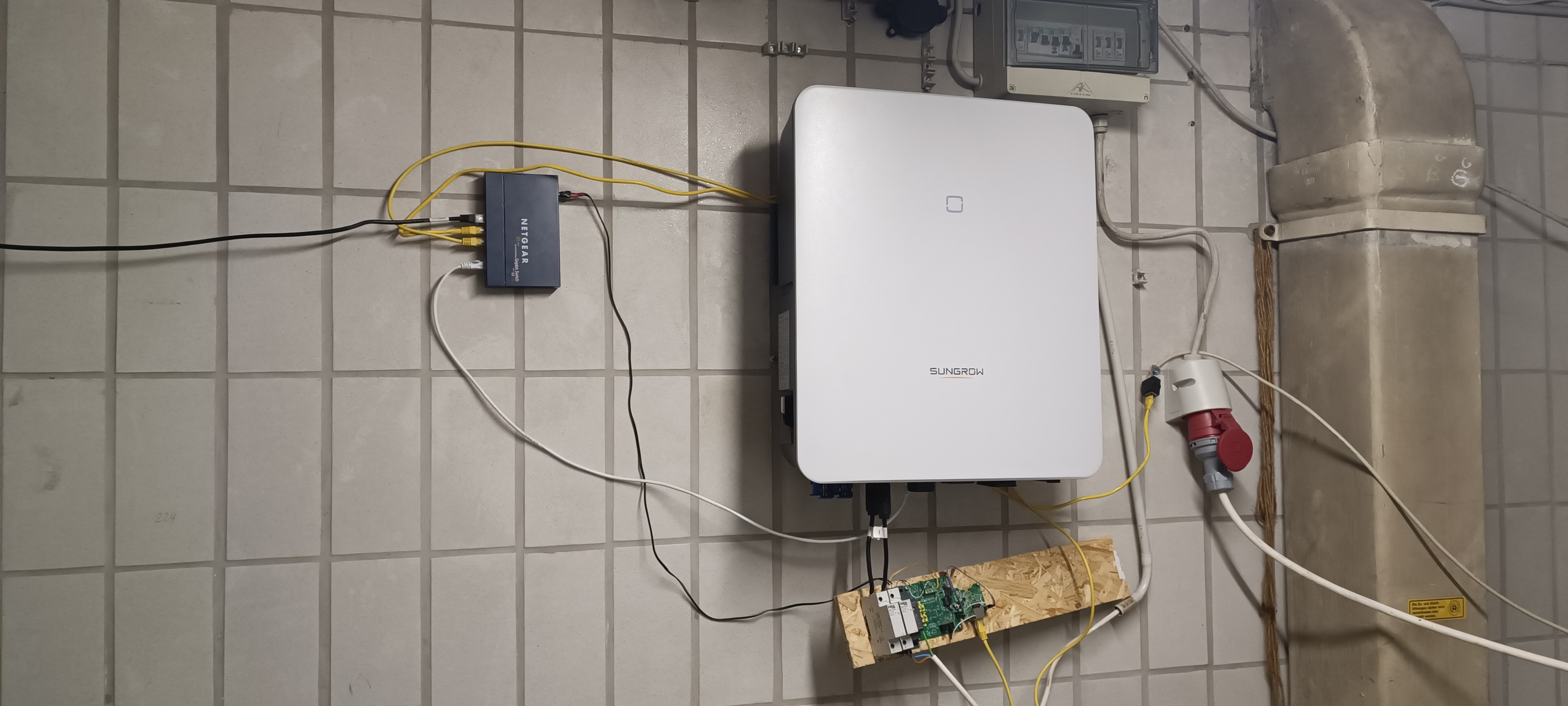

Every legit prototype starts out on wood :)
Dual fuse for the battery connection. pyPLC works as expected on the BeagleBone that already runs my ESS. The little dog will be very busy.
Still figuring out the details of the SunGrow inverter. It looks much like its input doesn't need precharging, there is just 0.5 uF and no visible power electronics. So I think there is an internal relay.
Also trying to figure out whether I actually need to emulate a BMS or if I can just set the inverter to lead acid mode.
UPDATE: no, lead acid mode is not available on this model
I have found libraries and documents here: https://github.com/bohdan-s

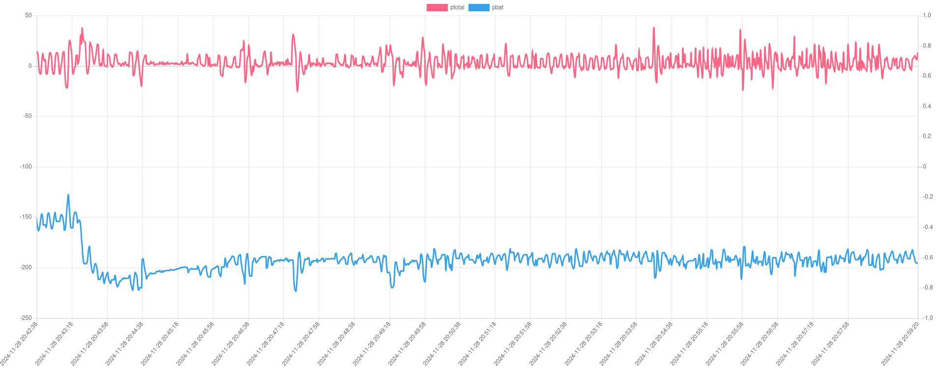

More experiments today. I did not manage to tell the inverter to precharge its output. It's ok for Touran as it doesn't care but I want it to work with OEM cars, too.
The voltage that is reported as bus_voltage is measured behind the internal boost converter and pretty much fixed at 600V. When feeding voltage into one of the PV inputs though this can also be seen on bus_voltage.
So far the voltage isn't really needed, again because Touran doesn't care. But I think OEM cars will hickup when CCS reported voltage does not match actual battery voltage.
I think a non-isolated differential voltage sensor with some mega-ohm resistors will do the trick. The LV side is earth referenced anyway.
Could then just hook up a little boost converter IC to a 1:20 transformer and connect it's feedback pin to the voltage sensor.

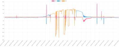

I set the output power to 5 kW. That consumed 4969 W from the grid and 4750 W came out the DC side - 95.5% efficient and thus better than the Mitsu charger. Also since the load is distributed between the 3 phases (7.6A each) the voltage drop between the meter and the inverter is much lower compared to charging 14.5A single phase. So an additional efficiency gain there.

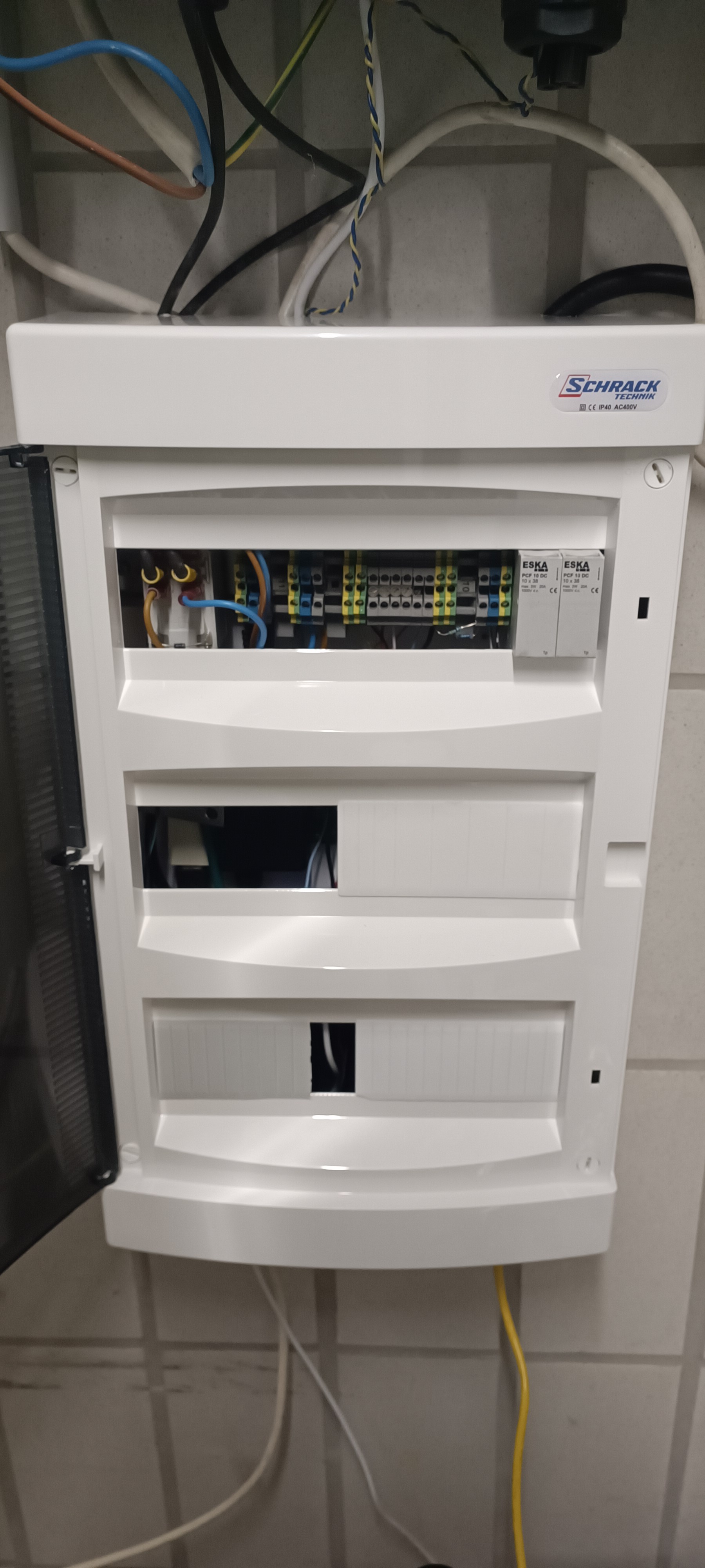

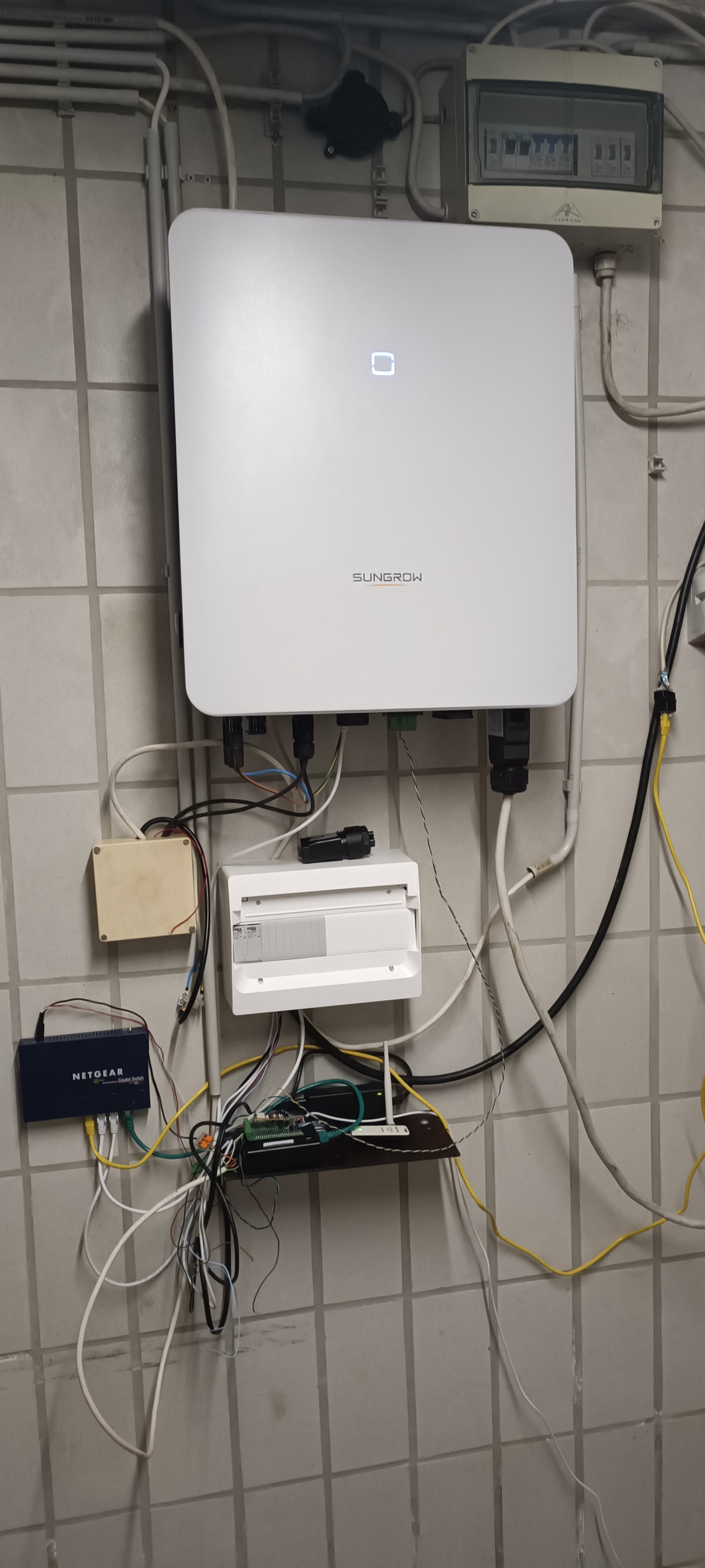

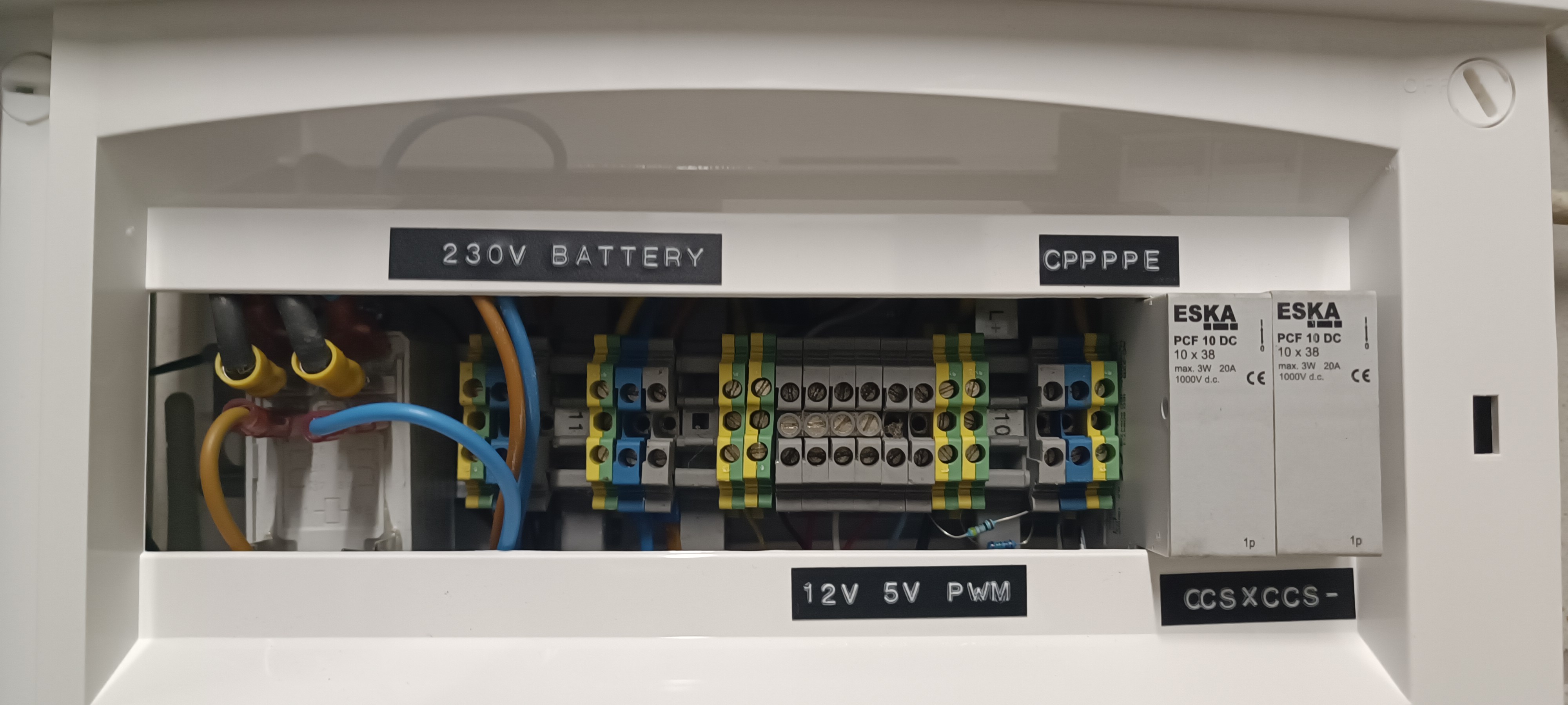

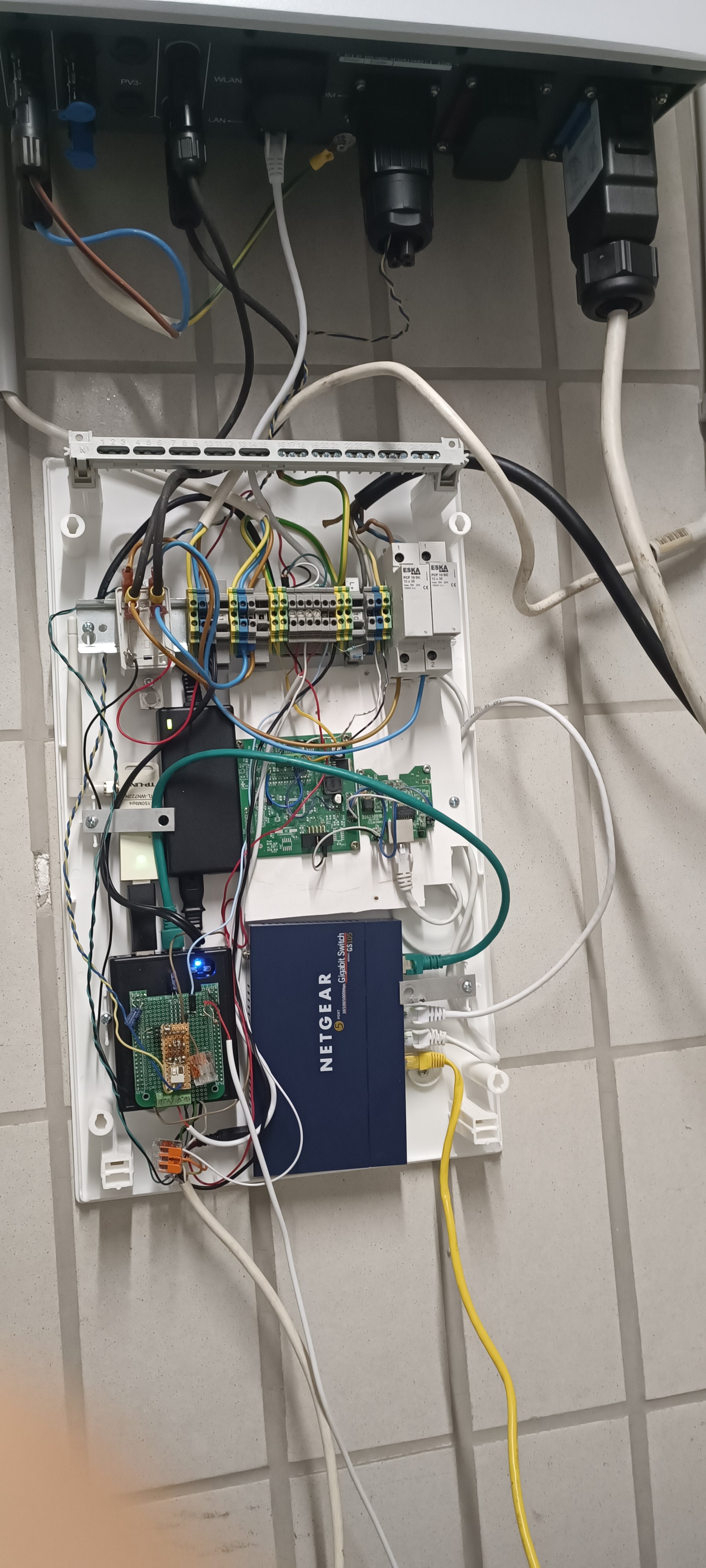

Finally tidied stuff up and hooked up the switch to the existing DIN rail supply in place of its lossy 50 Hz transformer

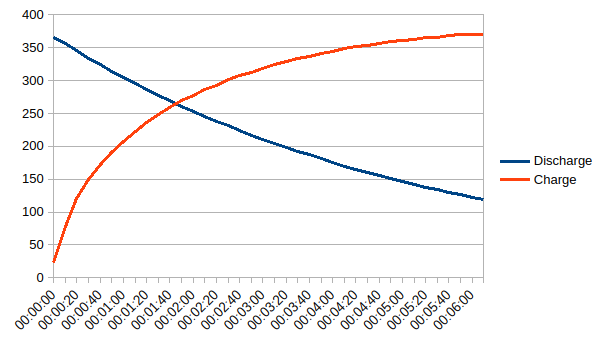

Currently running some experiments about a voltage source. Must say I'm not too fond of home-brew transformer solutions, they seem to require a lot of tuning and seem hard to come by off-the-shelve.
So now I'm thinking of using the standard gate drive circuit
with a HV FET or small IGBT and like 100uH inductor. Instead of the DC/DC converter I'd just use a 24V DIN rail supply to supply gate drive power and actual HV power.
And this driver is cheaper: https://jlcpcb.com/partdetail/TexasInst ... R/C2864438
Did some tests with 50 kHz and 10k || 0.5 uF and 20V input voltage. It basically does what you'd expect. Reached 150V@50% duty cycle and had a smoking 10k resistor :)
For voltage sensing I'd recycle this one:
Maybe some optional host micro? ESP module or something. Doesn't need to do much, closed loop voltage control and comms of some kind
uhi22
Posts: 1244
Location: Ingolstadt/Germany
Has thanked: 245 times
Been thanked: 684 times
Re: Bidirectional charger with PV Hybrid inverter and pyPLC
Post by uhi22 »
Puuh, non-isolated high voltage sensing sounds quite ugly. Could interfere if the inverter would do isolation monitoring. I think I have seen somewhere simple and cheap isolated solutions, consisting of opamp and optocouplers, and a small DC/DC.
Edit: Found something here: https://www.mikrocontroller.net/attachm ... tV1zu1.png and here: https://www.mikrocontroller.net/topic/431858 and here: https://www.electroschematics.com/linea ... -isolator/
