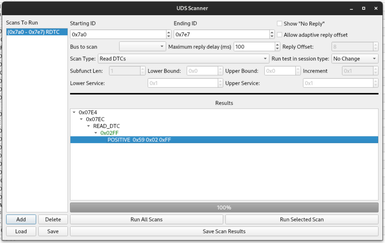

I have a spreadsheet with the BECM connector pinouts mapped (from service manual and existing work online):
Still have some work to do with the pinout, but for now it is functional.
So currently I have just the BECM connected on the desk, with simply:
- 12V from bench power supply connected to BECM_PWR & CONTACTOR_PWR
- CAN connected to SavvyCAN through V_CAN (120R termination resistor)
I've attached a screenshot from SavvyCAN showing the UDS ID present on this board.
I scanned the following services & read the data from that ID:
caringcaribou dcm services 0x7e4 0x7ec
Supported service 0x10: DIAGNOSTIC_SESSION_CONTROL
Supported service 0x11: ECU_RESET
Supported service 0x14: CLEAR_DIAGNOSTIC_INFORMATION
Supported service 0x19: READ_DTC_INFORMATION
Supported service 0x22: READ_DATA_BY_IDENTIFIER
Supported service 0x37: REQUEST_TRANSFER_EXIT
Supported service 0x3e: TESTER_PRESENT
Supported service 0x85: CONTROL_DTC_SETTING
and also the following DIDs (of course data is with nothing else connected....)

P0A0A-13 High voltage interlock loop circuit open circuit
P0A9B-12 Positive&negative contactor temperature sensor circuit short circuit to power
P0ABF-64    Battery energy control module software is not at latest version    Seems OK to ignore.
P0AE1-14    Hybrid/EV Battery Precharge Contactor Circuit - Circuit short to ground or open
P0B0E-14    Hybrid/EV Battery Pack Current Sensor "B" Circuit - Circuit short to ground or open
P0C42-12    Hybrid/EV Battery Pack Coolant Temperature Sensor "A" Circuit - Circuit short to battery
P0CD5-12    Hybrid/EV Battery Pack Coolant Temperature Sensor "B" Circuit - Circuit short to battery
P3043-13    Hybrid/EV Battery Cell Supervisory Circuit "A" Circuit open
P3044-13    Hybrid/EV Battery Cell Supervisory Circuit "B" Circuit open
P3045-13    Hybrid/EV Battery Cell Supervisory Circuit "C" Circuit open
P3046-13    Hybrid/EV Battery Cell Supervisory Circuit "D" Circuit open
P3047-13    Hybrid/EV Battery Cell Supervisory Circuit "E" Circuit open
P3048-13    Hybrid/EV Battery Cell Supervisory Circuit "F" Circuit open
U0064-87    Vehicle Communication Bus E - Missing message
P0A1F-93    Main current sensor failure
U3001-00    Control Module Improper Shutdown
So I will try to narrow it down to which CAN message from caringcaribou caused it to go into this "working-ish" mode....

So seems like sending specific UDS data to 0x012 `cansend can0 012#0210010000000000` then I get all of the above errors logged....

Those errors seem like something is unplugged?
I have 2 of those batteries here so I am keen to see how this goes.
Phil
obbardc
Posts: 14
Joined: Sun Jun 23, 2024 1:07 am
Re: iPace battery BECM hacking...
Post by obbardc »
Yeah, this is with the BECM connected on the desk (with just canbus & 12V), so lots unplugged. I am trying to reconnect bits one at a time ! :-)
