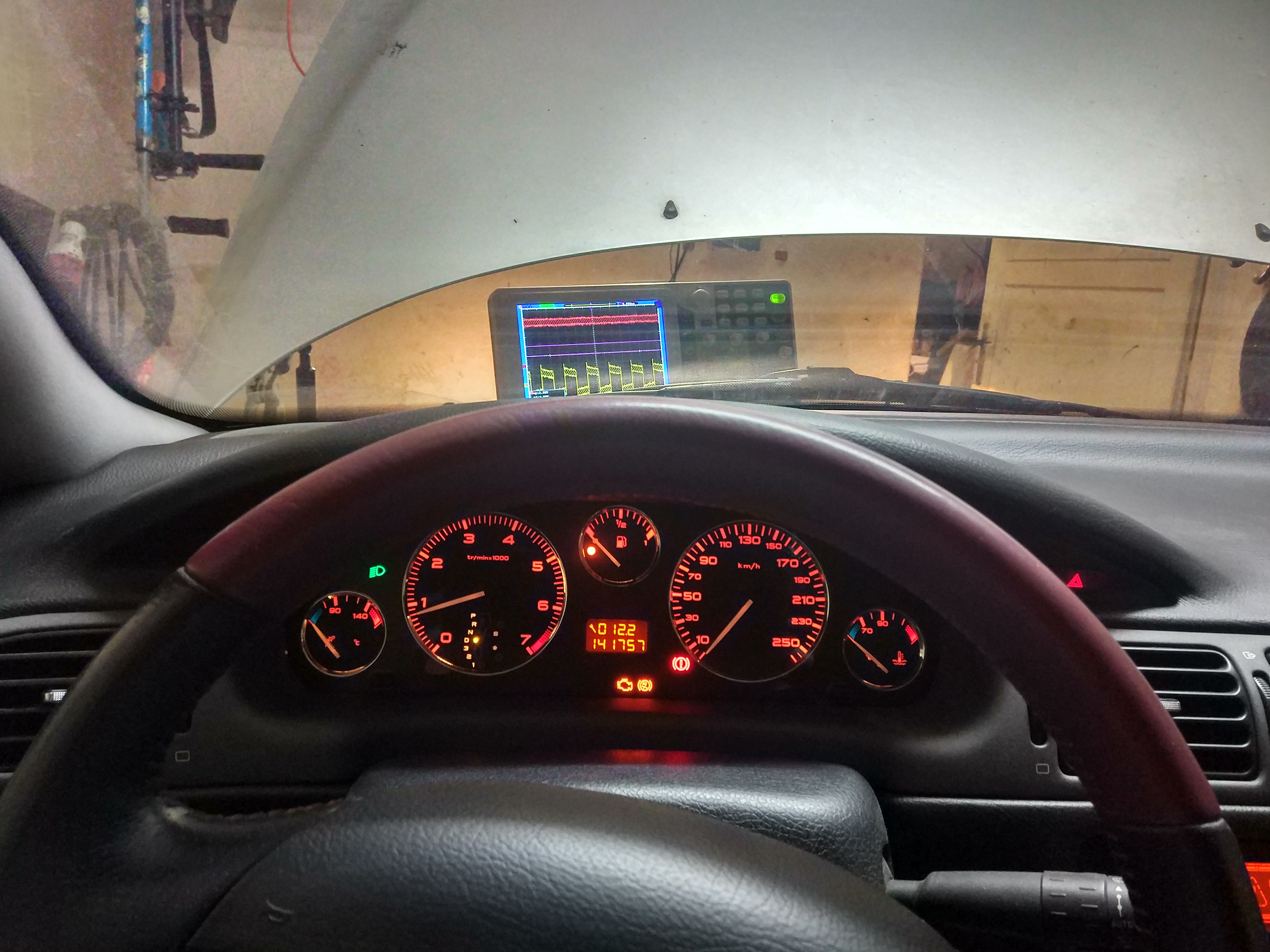

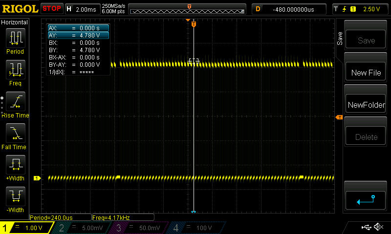

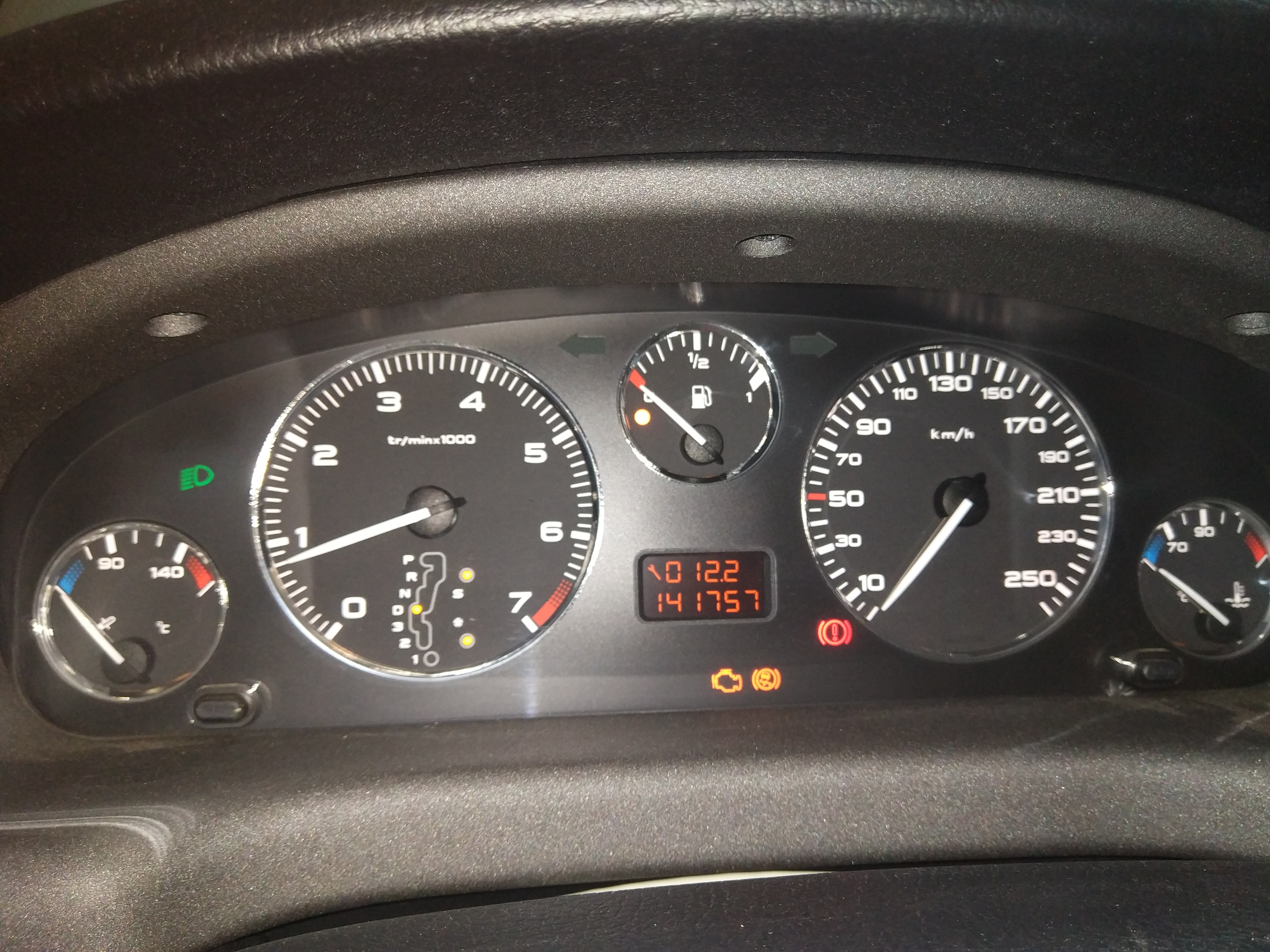

I am getting the Panzer back next week and have a problem with the speedometer. In the 8 series the speedo is fed by pulses from a reed switch and magnet mounted in the differential. As the diff is no longer there due to the Tesla drive unit swap I needed another way to feed the speedometer signal. So I mounted a hall sensor to the Tesla drive unit and pointed it at the heads of the 8 driveshaft bolts on one side. So now I get 8 pulses per turn of the wheel. Problem is the speedo expects 11 pulses per rev so naturally it reads low. So I want to use an arduino or similar to take in the 8 pulses and make them 11 if that makes sense? I am kind of confused though as to how to go about it in a way that will not create false speed signals. Any thoughts?
I'm guessing the car is using the frequency and number of pulses but for some reason I can't get my head around how to do this

Use an interrupt to count pulses in and the time it takes to get 8, then send 11 pulses out evenly spaced in the time it took to get the last 8 in. You'll get some inaccuracies at very low speed, but I doubt that matters too much. You could either bit bang them or use a timer and pwm adjusting the period to suit.

Hi Damien. Maybe a crude method to try just to get you going before you work on doobedoobedos superior method
.... do an initial power on reset of counter then send 2 pulses each for the 2nd, 5th and 8th pulse input from the sensor, reset counter after 8th pulse input and start again. Might work ? Peter

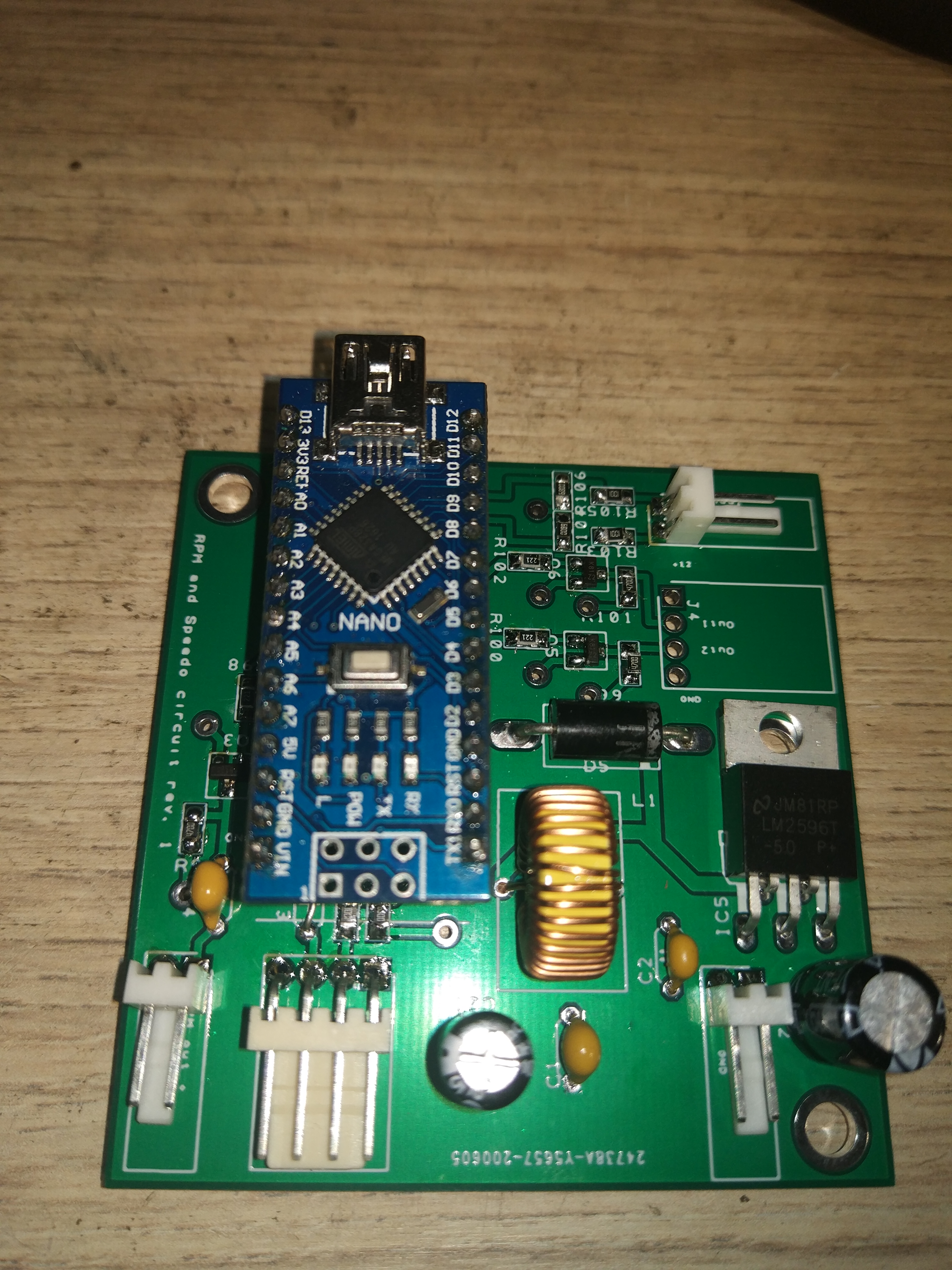

1. I would recommend putting a toothed wheel (11 teeth) to a driveshaft and one sensor to read that. Just have the wheel made and then saw it in two. A halfh flange for the driveshaft and mount the wheel to a flange. Two allen bolts on each side crosswise will clamp both sides to driveshaft securely. Select a good place to mount a fitting and mount a sensor to read pulses... https://www.aliexpress.com/item/Free-Sh ... 68401.htmlJack Bauer wrote: ↑Wed Feb 20, 2019 7:18 pm I am getting the Panzer back next week and have a problem with the speedometer. In the 8 series the speedo is fed by pulses from a reed switch and magnet mounted in the differential. As the diff is no longer there due to the Tesla drive unit swap I needed another way to feed the speedometer signal. So I mounted a hall sensor to the Tesla drive unit and pointed it at the heads of the 8 driveshaft bolts on one side. So now I get 8 pulses per turn of the wheel. Problem is the speedo expects 11 pulses per rev so naturally it reads low. So I want to use an arduino or similar to take in the 8 pulses and make them 11 if that makes sense? I am kind of confused though as to how to go about it in a way that will not create false speed signals. Any thoughts?
I'm guessing the car is using the frequency and number of pulses but for some reason I can't get my head around how to do this![]()
I would use a magnetic pickup sensor since those sensors are durable and ferrous wheel would be fairly easy to get. You could also use optical sensor since those wheels are even easier to make. Its just that optical sensors have to be IP67!!! No water or dirt there and that is not easy to reach.
2. Another way you could do it is inverter CAN bus msg from motor speed and then have another CAN controller change the msg to multiples of 11.
I intend to do this for my peugeot 406 since i am still not sure what the diff sensor count is.
Maybe i will even use this to display motor RPM, but i expect motor to turn over 10000rpm and Pugs RPM dial goes to 7500rpm only...
EDIT:
3. There is another option i was lately considering. How about DC halfh bridge with small 12V DC motor with notched wheel and optical sensor? Whole assembly would be protected in a box. DC stage would be run by a pwm signal from mainboard. I am considering this due to a fact that my car needs to have at least 800rpm for interior systems to work. That way i could cheat a little by offsetting pwm a bit.

The Arduino sketch below will (should) do what you need. Input pulses go to pin2 output is pin9.
It does FP maths but that's OK for the speed it needs to run at. If anyone else wants to use it for a different reason and a different ratio just change SOURCE_PULSES and TARGET_PULSES.
You won't get anything until one full revolution of the wheel, then it adjusts itself on every incoming pulse. I've tested it with another arduino running as a signal generator using a pot to vary the incoming frequency. It matches up pretty well on a scope.
Output pulses are 50% duty cycle, it's triggered on the rising edge of input pulses.

Wow that's fantastic. Thank you so much:)

Well I thought I'd do something a bit more comprehensive. At the top of the file are a set of defines followed by a matching set of ifdefs. Pick one mode, by uncommenting one of the define statements at the top then set the values in the matching ifdef block. There's a comment at the top which hopefully explains everything.
In MODE_PULSE_IN I've set a cutoff for acting on incoming pulses at 1Hz although this could go lower, but it's a tradeoff for detecting when something has actually stopped (see line 123 if you want to change it).
This was a fun exercise
. If anything's not clear, let me know. Frequencies are always set at the highest possible resolution limited by the hardware.

Wow! That was comprehensive.
Thanks doobedoobedo i will use this code definitely. If at least to supply correct pulses for engine ready state.
In best case i will be able to receive Leaf motor RPM and send the transmission speed sensor correct speedo data.
I would like to ask you another question. How would you go about simulating missing tooth pulse? I mean RPM sensor reads pulses from wheel with teeth and there is one teeth missing from the count on mine. Car uses it to count the turns obviously.
Would it be best to define absolute No. of pulses per rotation on input and then remove last pulse from output? Or use the timer to reset count, wait for one pulse duration and then continue outpout. Or how would you go about it?
tnx
Arber
tnx
Arber

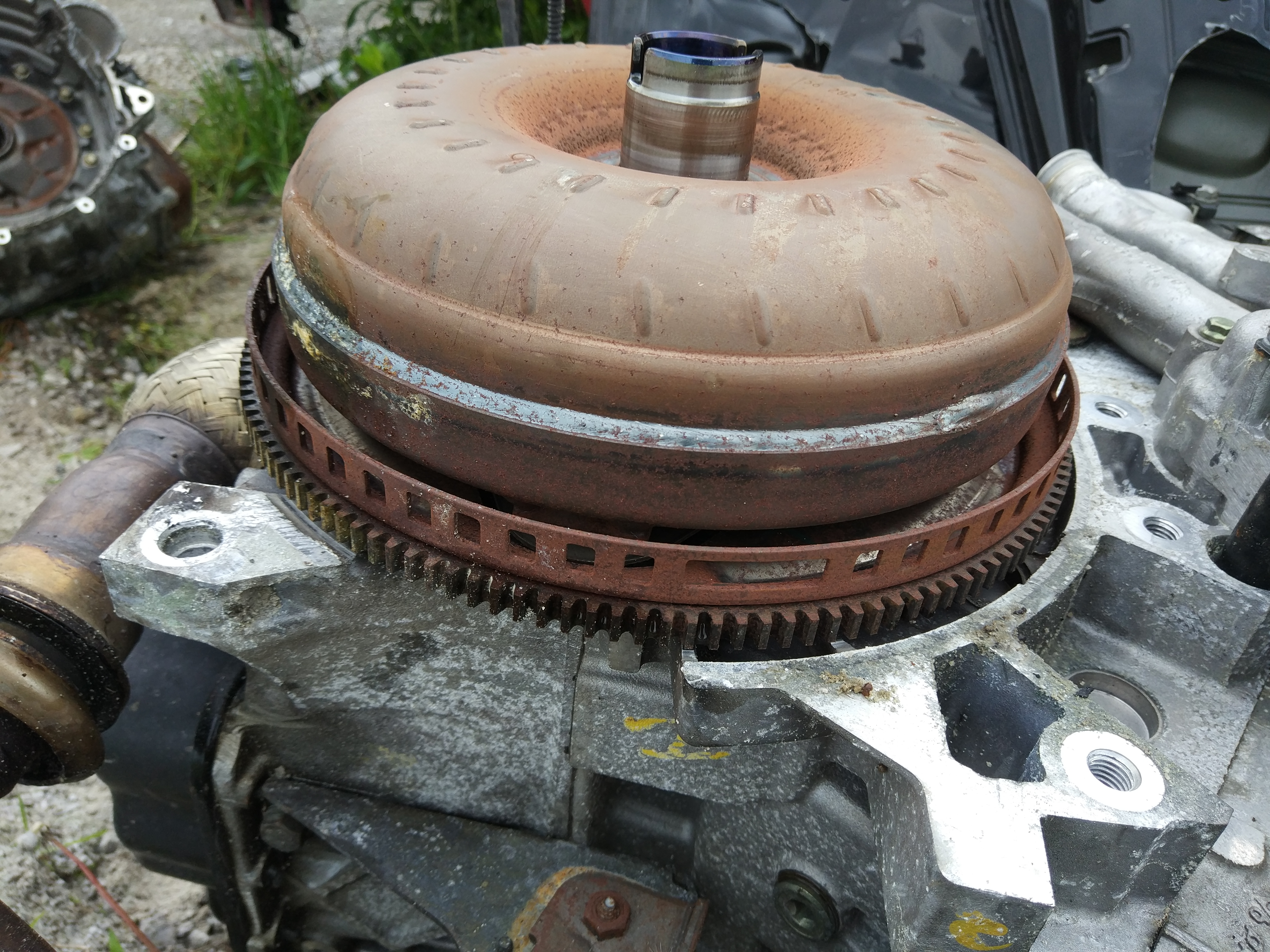

Well i took apart V6 engine and trannsmission in my Pug 406C and i see the main RPM sensor ring has holes arranged to 60 per turn. The last 3 holes are cut out and therefore there is actually 58 holes, the last one spanning across 3/60s periods. Would that be programmable?
Also there is a setback. Speedo uses a spindle in the gearbox and not ABS like i first thought. I will have to experiment with this to get the ratio.
A
A

Another possible thought is motor speed should be directly proportional to ground speed. If you could take a canbus input of motor speed, wouldnt it then become a simple a/b = c output pulses equation?
- Posts: 3795
- Has thanked: 166 times
- Been thanked: 411 times
Re: Weird Speedometer Question
Hidoobedoobedo wrote: ↑Wed May 08, 2019 6:37 pm 58 holes = 58 pulses per revolution for the input parameter
Wouldnt i need to time those last three holes as single pulse that is three times as long?
I can imagine at 10000rpm this would make quite an error.
So for speedo i can use RPMx8 calculation for final drive speed but i still dont know the ratio of spindle sensor.
Hm... i can use my drill and turn it at known RPM and check what my speedo says

No, it calculates the time for one complete revolution on the rising edge of each pulse, it doesn't matter how long the pulse is as it calculates the current rpm on each one.
- Posts: 3795
Then what is the use for the large hole? Why wouldnt they just use 60 holes. It would even be symetrical, as in 60*X/min(60s) = X....doobedoobedo wrote: ↑Thu May 09, 2019 10:01 pmNo, it calculates the time for one complete revolution on the rising edge of each pulse, it doesn't matter how long the pulse is as it calculates the current rpm on each one.
kiwifiat
- Posts: 101
- Location: Vancouver, Canada
- Been thanked: 12 times
The missing holes are detected by the ECU and that allows the ECU to know where TDC is which is a requirement for correct ignition timing and injection timing. Whether or not the ECU throws a fault if the missing teeth are not detected will be interesting. 60-2 timing wheels are pretty common and standard on most BMW's too.

Pushing my luck here but would it be possible to have another output pin to drive the tachometer?
doobedoobedo
- Posts: 264
- Location: UK
No harm in asking
. Would you want the same frequency output on a different pin, or a different frequency on the other pin?
- Posts: 4000
- Been thanked: 1116 times
A different frequency on a different pin would be great. Basically I'd like to drive the tachometer as well as the speedometer.
