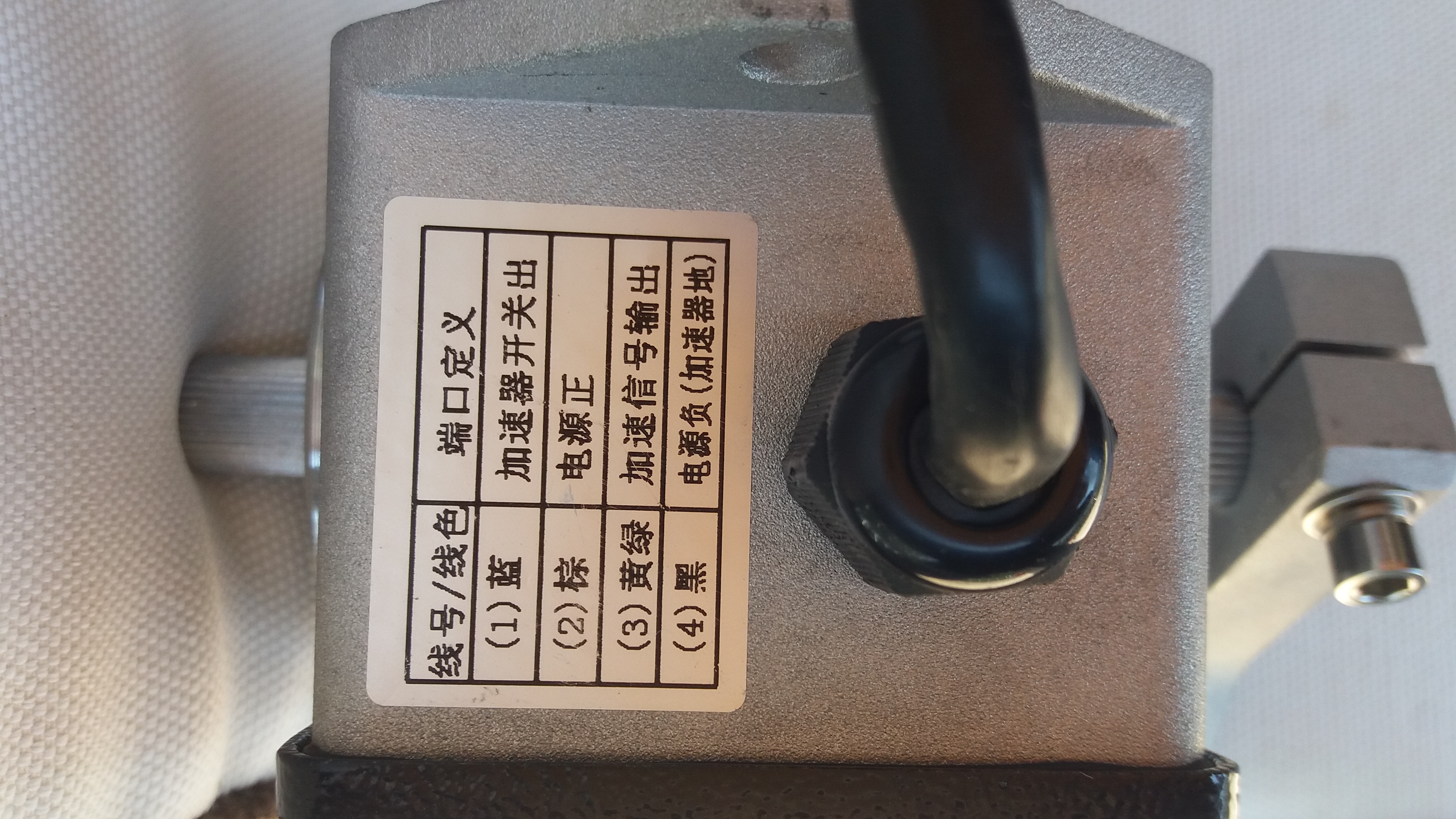

Re: POT-Pedal has rough slide motion
Posted: Mon Jul 29, 2024 7:25 pm
by DIETZENBACH
The pot do not shows any OHM readings.
Picture of it attached.
Posted: Mon Jul 29, 2024 8:05 pm
by manny
Think this is a hall effect pedal. So no resistors but electronics that putout 0 -5 V
The 24v input is a bit odd.
Google translate:
So when with power applied to brown and black.
You should measure a voltage between 0 and 5V between yellow and black.

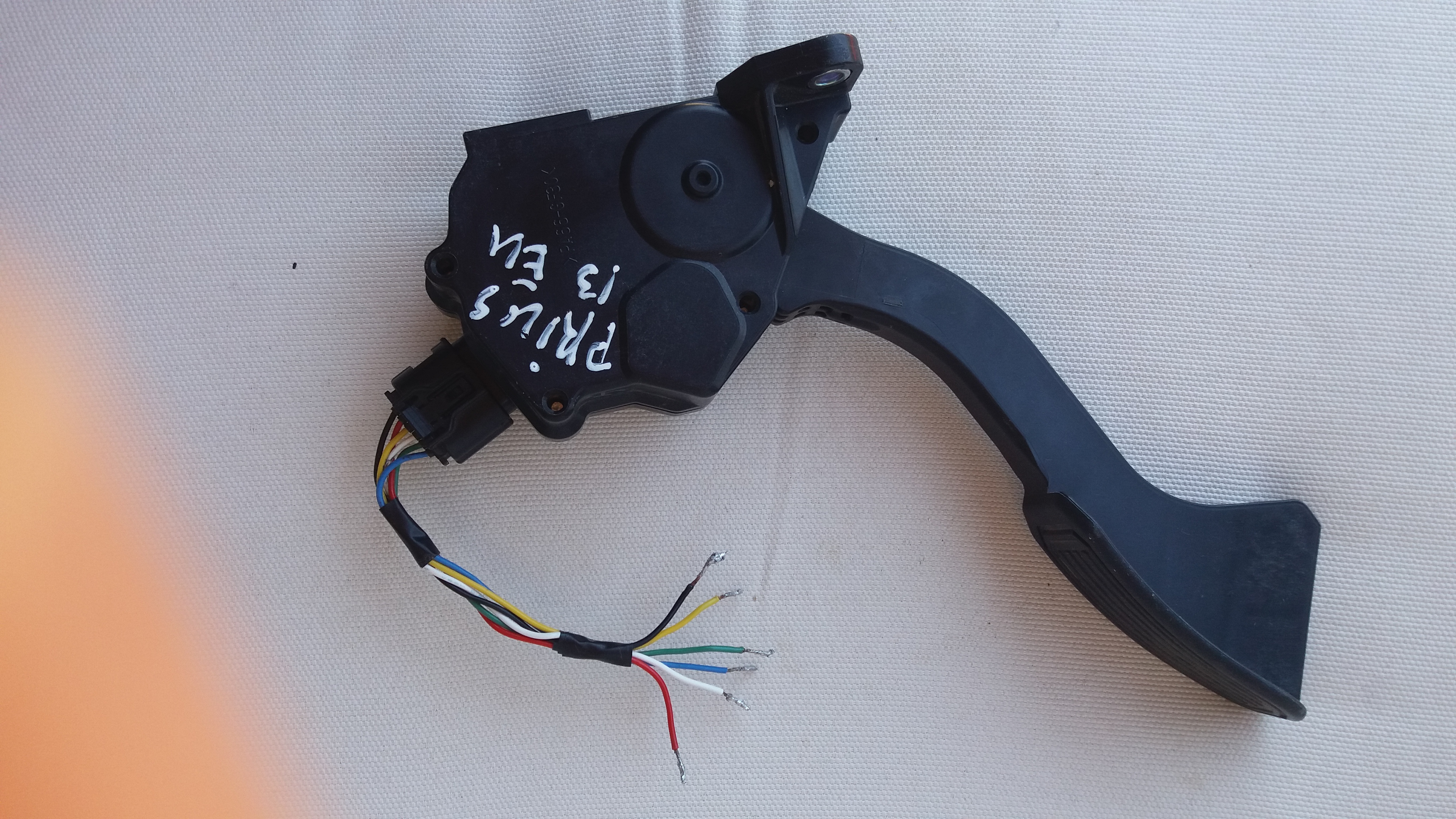

Posted: Wed Jul 31, 2024 7:23 pm
by DIETZENBACH
I decided to use the Prius pot- pedal,because it has some connections to Prius Gen 2 Inverter.It should be more suitable to make it run.I got a scheme of it for the 3 wires,but they are 6 togheter,suppose for some other functions.
I watched a videoclip ,where they soldered a ca.4.7kohm resistor to one of the pot wires and this resulted in ca.775 digits of the pot MIN. in the plot window.
Any suggestions how to get the pot move smoothly and run the motor ?.
The rele/contactors of the brake & start should be open or close ?.I keep them both closed,and may be this has some effect on the pot-pedal function ?
PRIUS

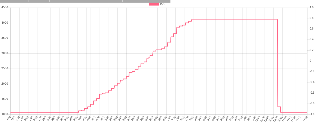

Posted: Fri Aug 02, 2024 8:06 pm
by DIETZENBACH
I managed the run of pot-pedal smoothly with low point of 1067.
B ut in the plot window stay the warning POT PRESSED,where as the pot is still and not pressed.
Is a setting wrong or there is some thing other incorrect.
Posted: Sun Aug 04, 2024 8:01 am
by manny
The POT PRESSED warning is because the potmin is set to 0. If you set this to 1070 this will be fixed.
the max in the graf is 4095. which is the absolute max value. This means that the signal is too high for the VCU.
please read this topic carefully maxing out the input is dangerous.
viewtopic.php?t=5075
also use the DualChannel option in the potmode setting if you can.
