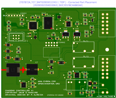

Decided to make a subforum for all fast charge related development and here to kick things off is a design in progress for a Chademo controller :
https://github.com/damienmaguire/Chadem ... Controller
Based on the JLD505 design by EVTV , further developed by New Electric and now passed on to me.
I have removed a lot of the (imho unnecessary) isolation stages and features to give a basic and simple box to control fast charge.
Uses the Modice MX150 32 enclosure. The 10 way plug goes to the chademo port and the 20 way to the vehicle.
I've used versions of this in both the E39 Landyacht back about 5 years ago and currently in the E31 Panzer.
More details to follow.

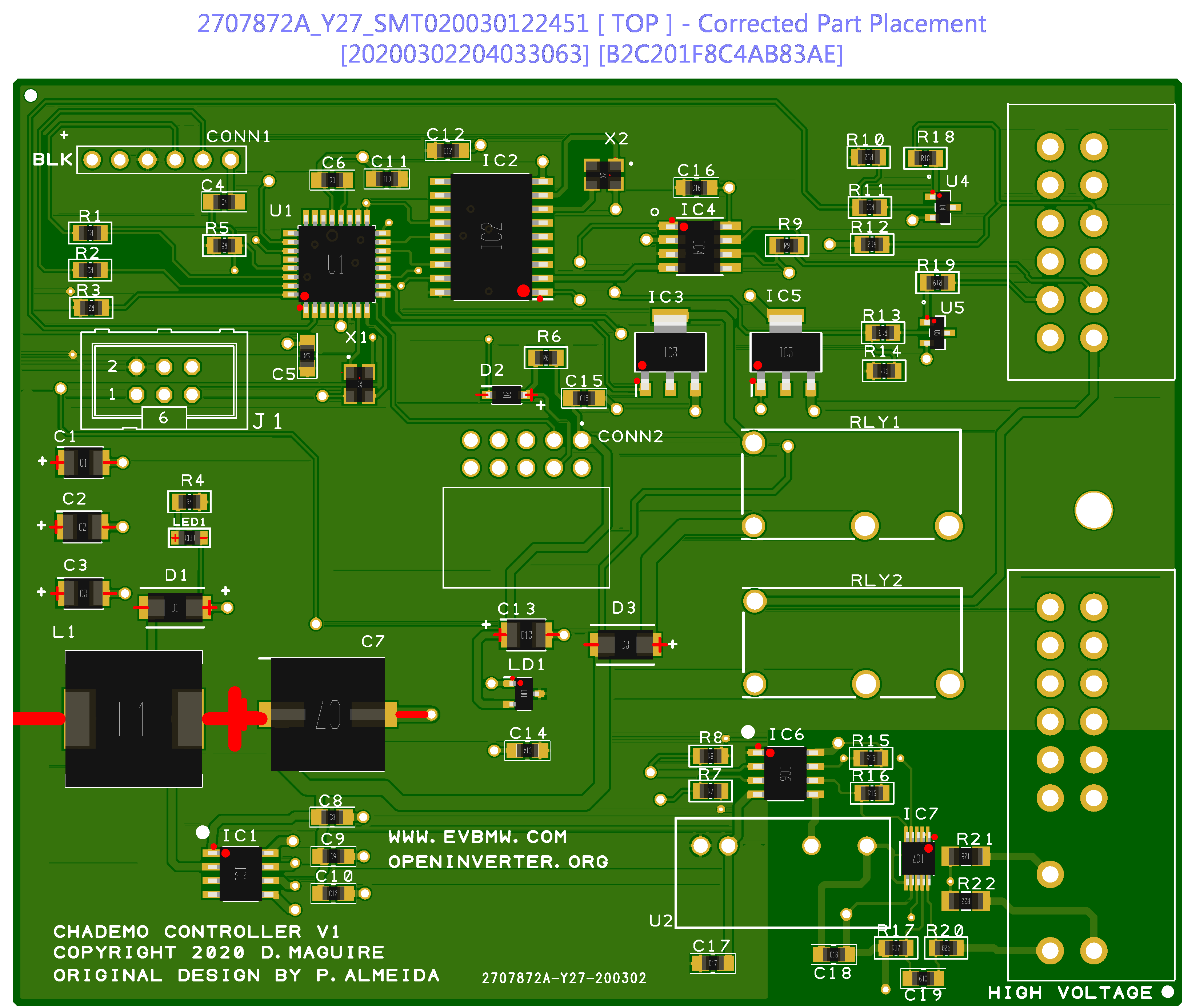

Now that JLCPCB are back to normal I've ordered some chademo controllers. Design files and those all important JLC bom and cpl uploaded for those adventurous souls among you.
https://github.com/damienmaguire/Chadem ... r/Hardware
- Posts: 4000
- Been thanked: 1115 times
Chademo controller boards in production.

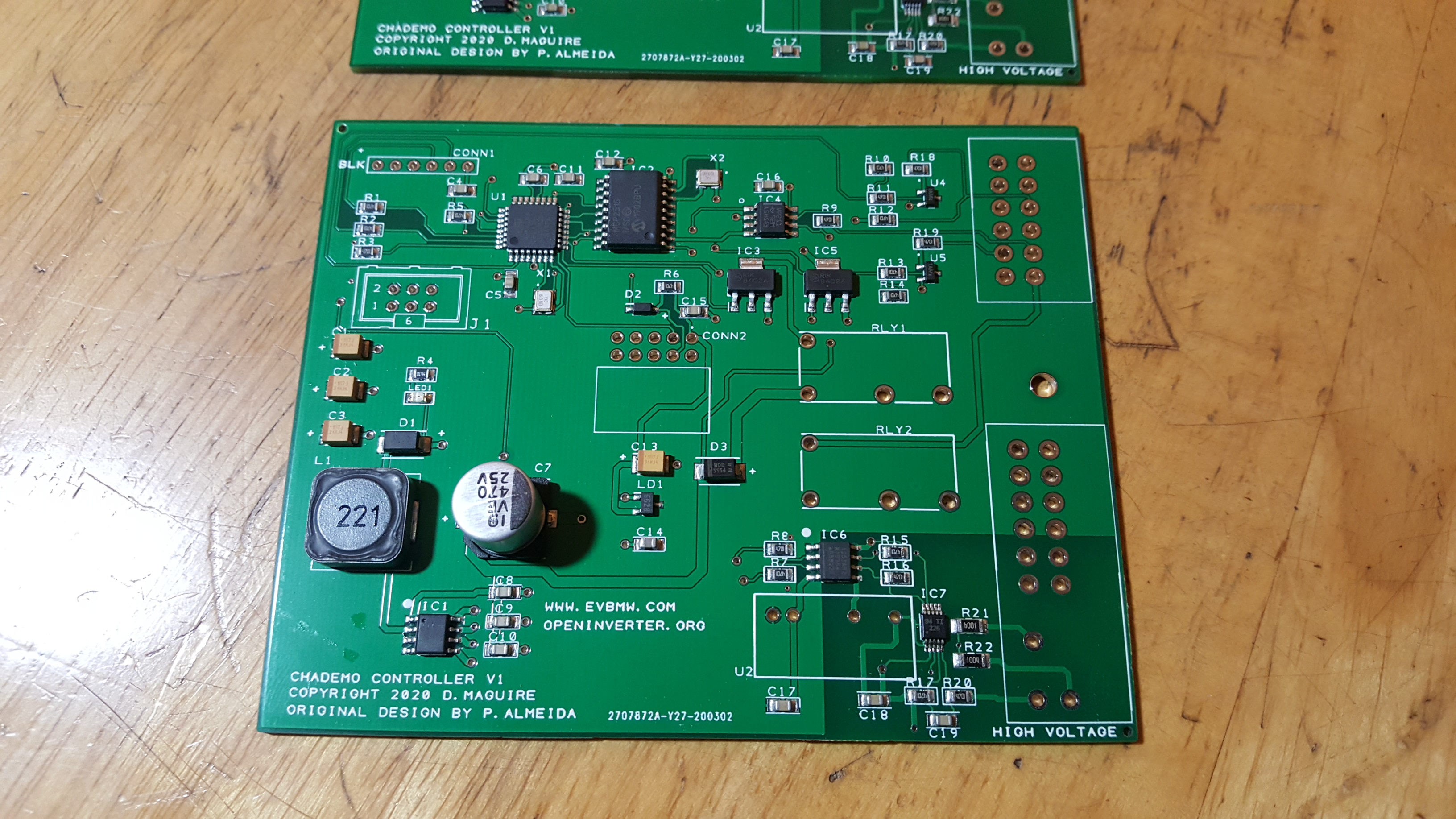

- Posts: 4000
Chademo controller boards have arrived from JLCPCB:)
- larsrengersen
- Posts: 171
- Has thanked: 16 times
- Been thanked: 36 times
Very nice!
Is there a changelog compared to your starting point?
What improvements / changes have you implemented?
I am currently using the board from New Electric but migrating to yours might be a good idea (in the future).
Therefore I'd like to be able to assess whether it is a drop in replacement.
Then I might even consider wiring yours in in the first place to we can test from the same version.

- Posts: 4000
Design files on github : https://github.com/damienmaguire/Chadem ... Controller
