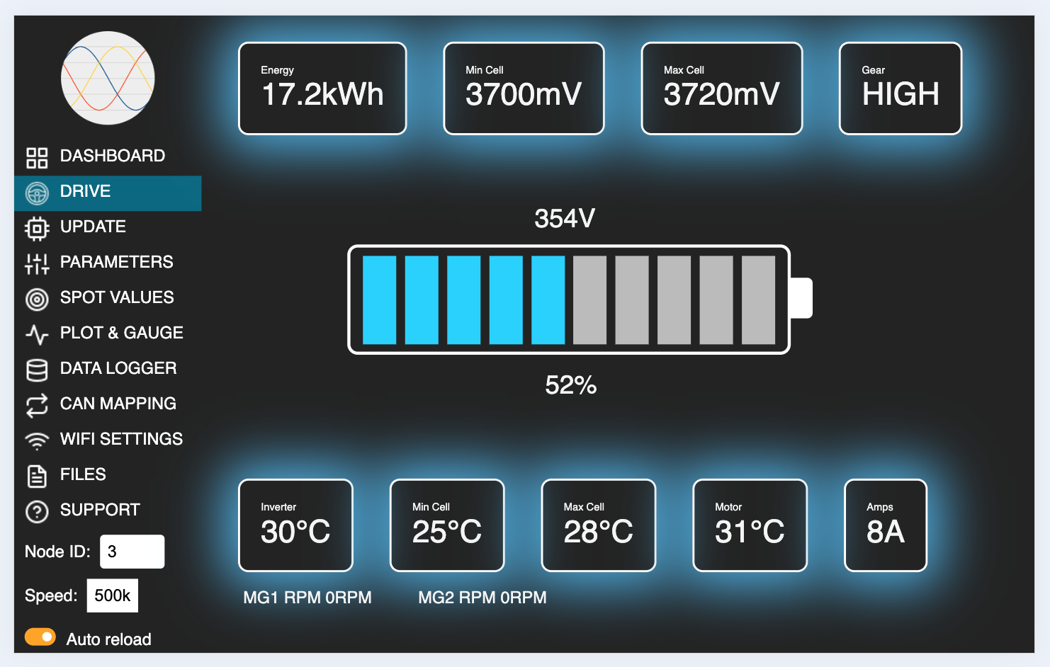

I'm using a Lilygo T-Can board available from Aliexpress for ~£14 for the can backend web interface. The pin mappings are different and it requires an output setting to enable CAN. Lilygo says max input of 12V but the voltage regulator IC has an absolute max of 18V, it's running fine when my DCDC is active at 14.5V
I'll get round to doing a PR for being able to select the board, but for now the code is here: https://github.com/jamiejones85/esp32-w ... ilygo_tcan
I've implemented a dark mode theme, and also a drive mode page.
Still todo, I want to log all the spot params to the SD card next automatically when driving.

That looks great!
One thing to consider for dark mode, blue is the least friendly color for eye strain. It can also mess with circadian rhythm (can mess with your sleep cycle after dusk.)
I know, lots of dark modes use blue as their main color after black / dark. I'm guessing they aren't aware of these 2 things when choosing or using blue.

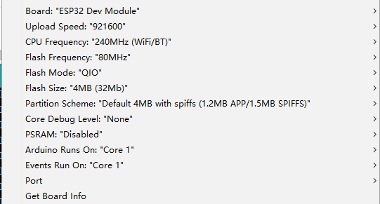

I am using Arduino IDE 1.8.19. The attached is a picture of the suggested settings for the tcan from lilygo for programming the board also the board I have selected is ESP32 dev Module. The repo is from Jamies github.
When I try to compile i get this output,

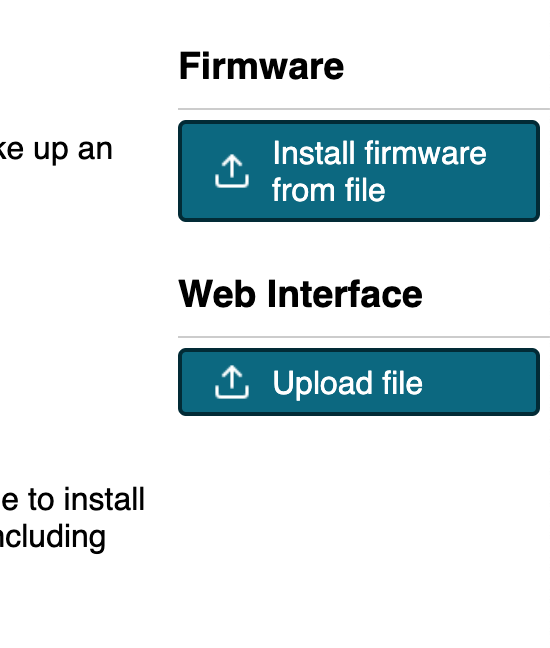

Thanks bigpie. BUT, sorry to be a pain i have 3 options boxes, Flash app, flash partition and flash boot loader. I flashed both bins to flash app and had a firmware update page when connecting to the board wifi with 192.168.4.1 but thats all i got . I think I may need to erase and start again but the programme says I must flash all 3 files and I only have to.
As you can guess I am a bit of a numpty in this field

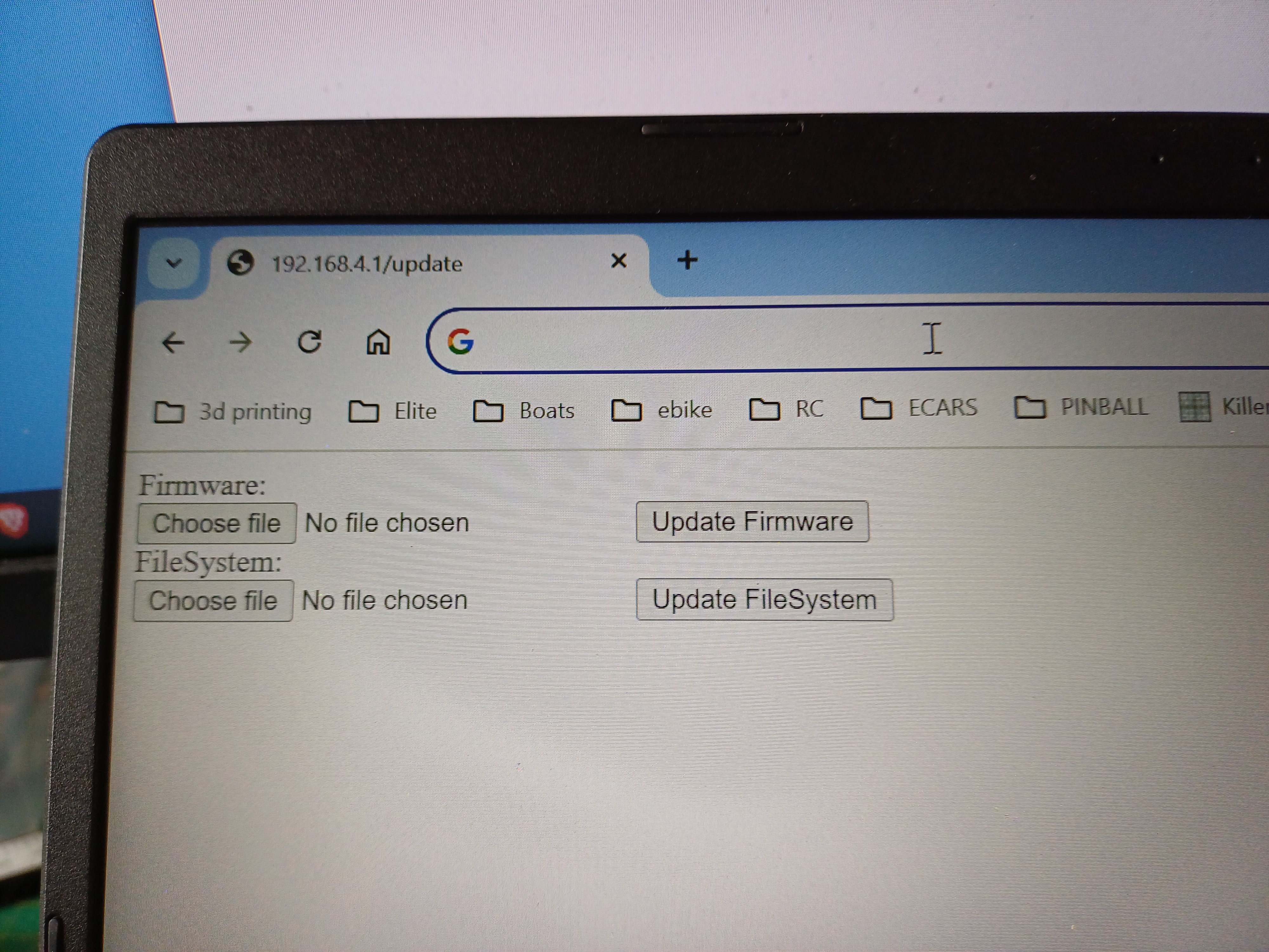

firmware.bin goes to app, spiffs to partition, bootloader doesn't need changing. I don't use windows, so not familiar with apps on it.

so /update is for updating the ESP32, the firmware is the firmware.bin, the FileSystem is the spiffs.bin.
If you're getting can communications, and you want to update the STM32 you need to use the update on the main interface page.

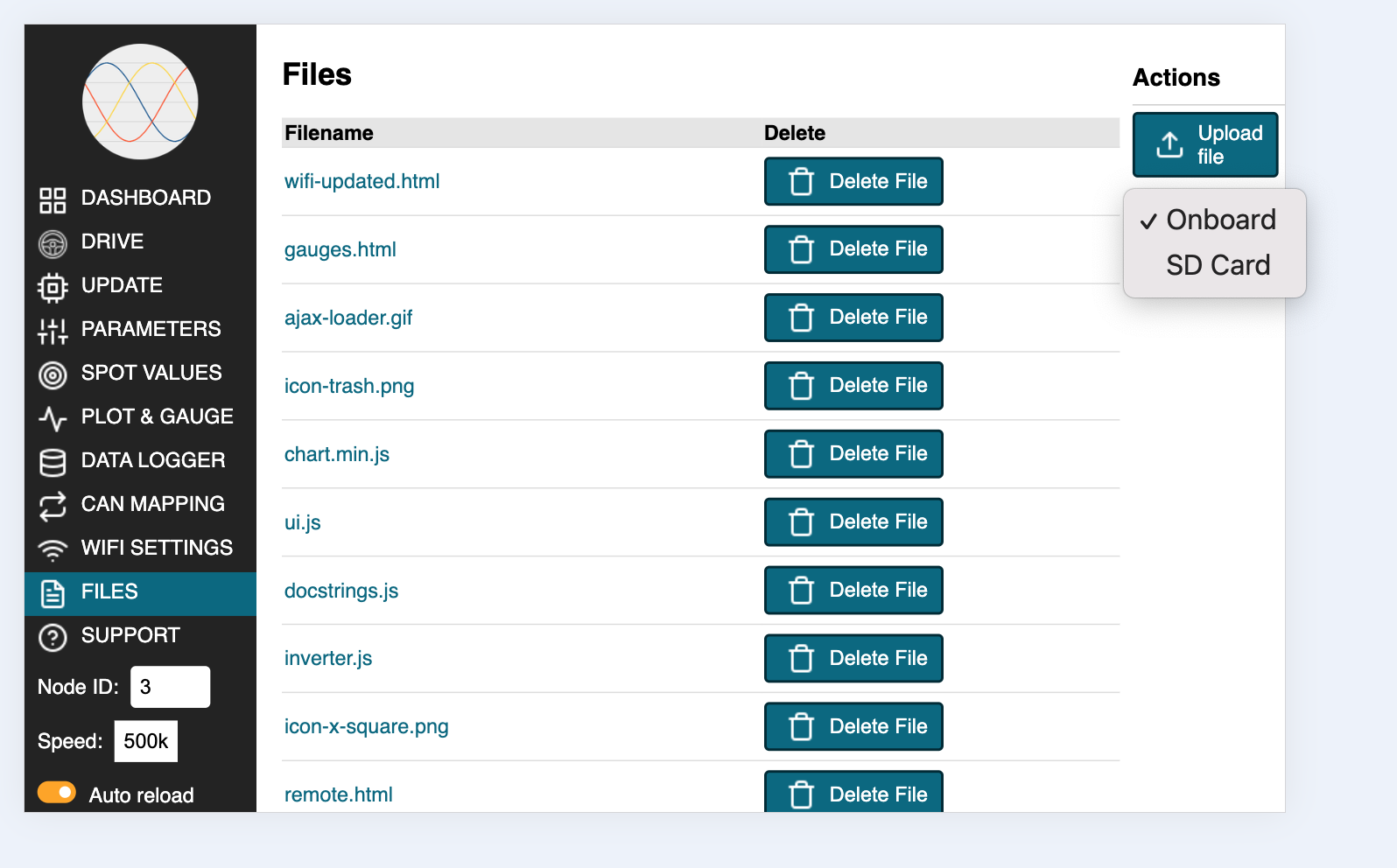

Tried using upload.sh 192.168.4.1, it does not complain anything but still no pages other than /update and some "buildin" pages like /sdcard/list and /version which do respond.
Trying using browser 192.168.4.1/edit which upload.sh uses, gives FileNotFound output. So something to do with spiffs?
Changed Partition Scheme to "No OTA (2MB APP/2MB SPIFFS)" with no difference. Like "Erase All Flash Before Sketch Upload: Enabled" to erase everything.
Something is wrong but I don't understand what..

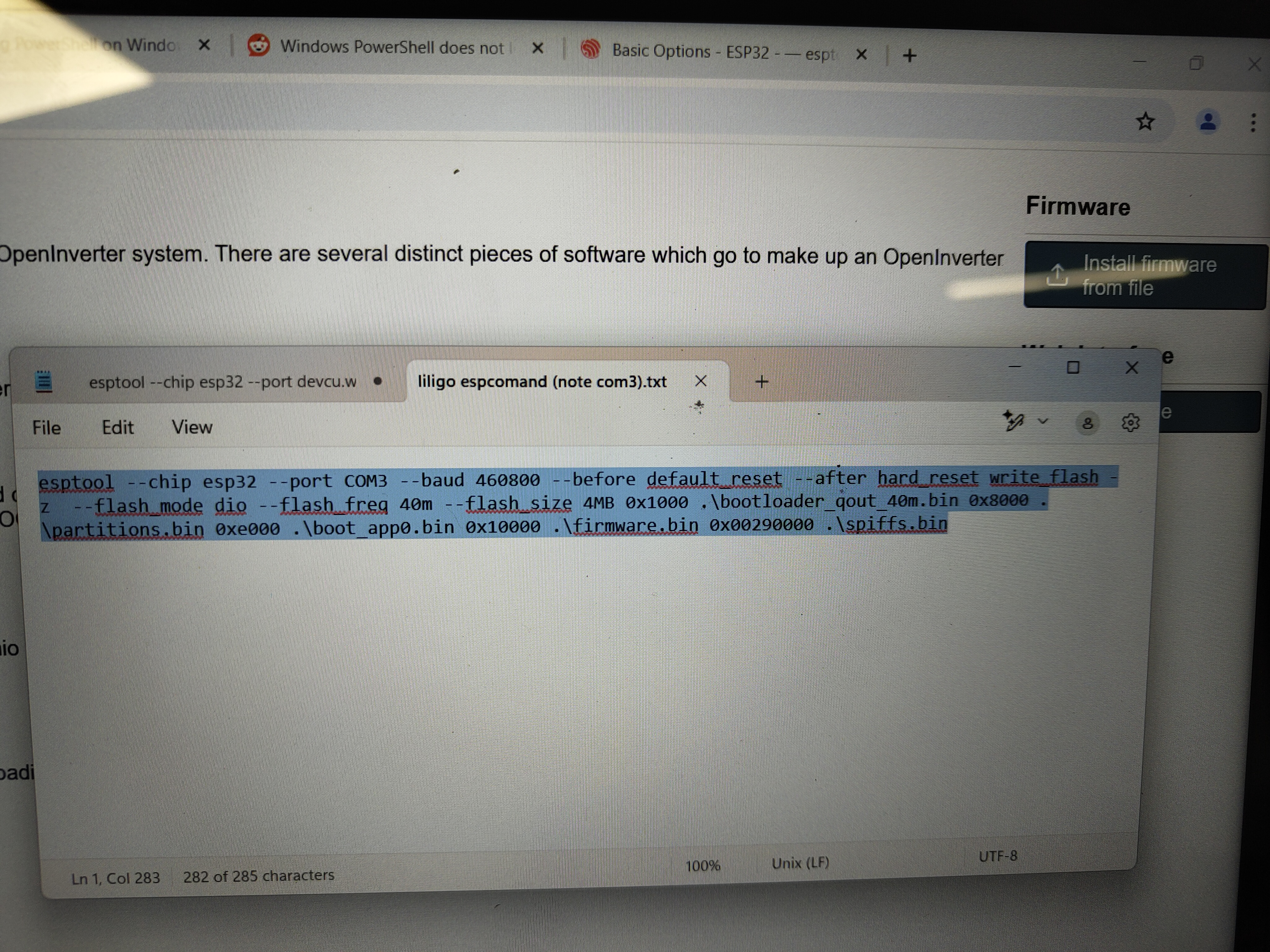

So, just had a couple of box fresh Lilygos delivered to do this.
Here's the esptool command, all binaries in the attached zip.
I'll next switch to windows and find a GUI tool for the other.
esptool.py --chip esp32 --port "/dev/cu.wchusbserial58CE0145831" --baud 460800 --before default_reset --after hard_reset write_flash -z --flash_mode dio --flash_freq 40m --flash_size 4MB 0x1000 bootloader_qout_40m.bin 0x8000 partitions.bin 0xe000 boot_app0.bin 0x10000 firmware.bin 0x00290000 spiffs.bin

Spent a while getting to this stage but have something loaded and can connect to the web server......but all I get is the update page as above....I used a fresh install of platformio (that already has Arduino 2.x and 1.8) on a windows laptop and the platformio.ini.
There was an RTC lib issue it appears that the library has been condensed but finally got it compiled and loaded but no Bueno.....
As I have a similar issue as above I was wondering if anyone has a direction of travel that might help with this.....thanks in advance
Not my picture but getting same

Re: Lilygo T-Can boards for web UI
easiest way is to use the command line I provided above to flash the binaries.
From your /update you can use the precompile spiffs.bin from the lilygo-ui.zip above and upload that to the file system. The firmware.bin is also in there you can flash the firmware too.
So I got it to work! Using esptool. The syntax took some adjustments for windows. And was a bit of a learning curve.
First install python and pip (was prompted if I wanted to install pip at the time of installation) from python.org
So to install esptool that is done from a windows command prompt. NOT in python. (Followed this video(
pip install esptool
Then after downloading the zip files (can't remember where I put them at the moment will post back) and working out which port I was connected to......windows version of esptool syntax used COM port.
Then adapted your command line and bam.....it worked.
Took a pic at the time..... shown below......will try and supply a more in depth instructions.
Thanks Jamie!
pip install esptool
Thanks Jamie!
Could you explain where and how this happening, please? I managed to make this ui work in my setup but I'm using different BMS boards so my spot values are named differently (I guess) and I'm wondering if I could modify some files to get the correct values to display.
