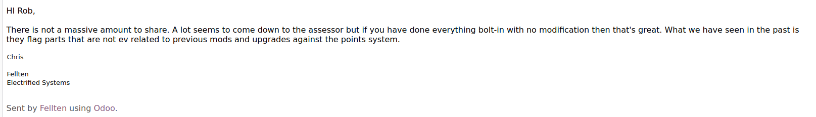

What is the procedure right now? Is it still a case of getting an MOT, a letter from a garage, and sending those off with an updated fuel type on the V5?
