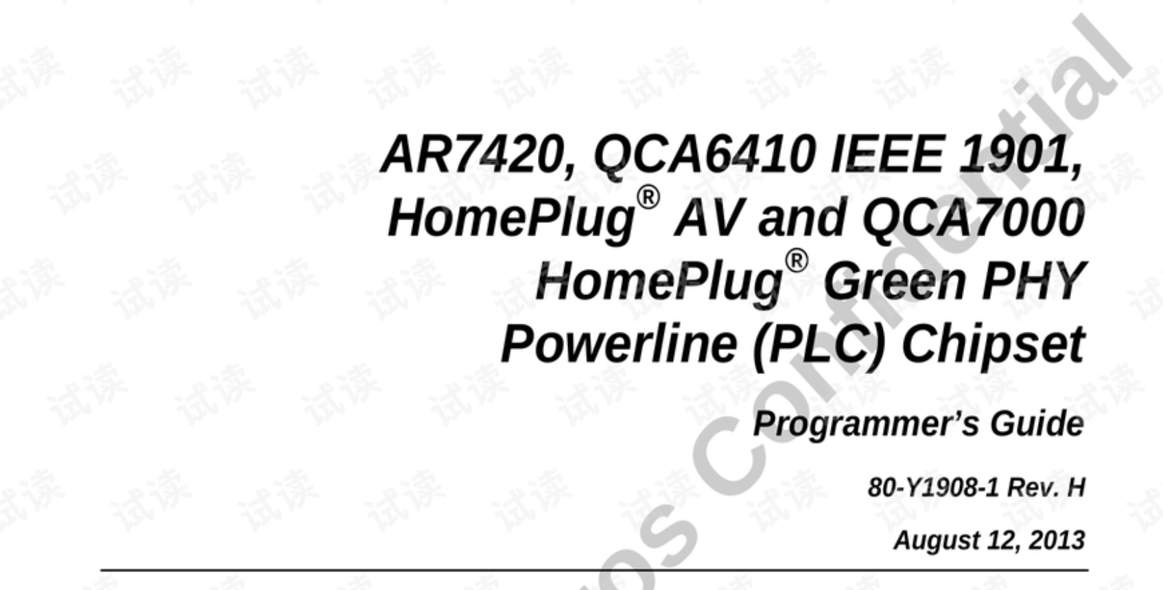

Have you ever read "AR7420 HomePlug Green PHY Programmer's Guide document" I don't know if it will be useful or not. it may explain how to enable promiscuous mode of homeplug chipset.

A link to this document could be very helpful.
Re: Development of V2G sniffer
https://download.csdn.net/download/baid ... 001.6616.2
You can download it in the link above but it need to pay first before download a full document (I haven't bought it yet either).
If anyone has it, please share it with us.

Still hoping that someone was able to get this document and could share it.
An other interesting discussion regarding sniffing is ongoing on GitHub: https://github.com/uhi22/pyPLC/issues/39
I highly recommend checking out the very earliest commits on open plc utils, specifically https://github.com/qca/open-plc-utils/t ... ca2f592076uhi22 wrote: ↑Thu Jan 23, 2025 8:55 pm Still hoping that someone was able to get this document and could share it.
plcsnif.c and "nda" directory are still missing, but they are VERY well documented! You can reproduce all the files at this point in time from the docbook html.
See:
https://github.com/qca/open-plc-utils/b ... fer.c.html
https://github.com/qca/open-plc-utils/b ... nif.7.html
https://github.com/qca/open-plc-utils/b ... nif.c.html
https://github.com/qca/open-plc-utils/b ... nda.h.html
While I haven't yet had a chance to build and test, it looks promising?
