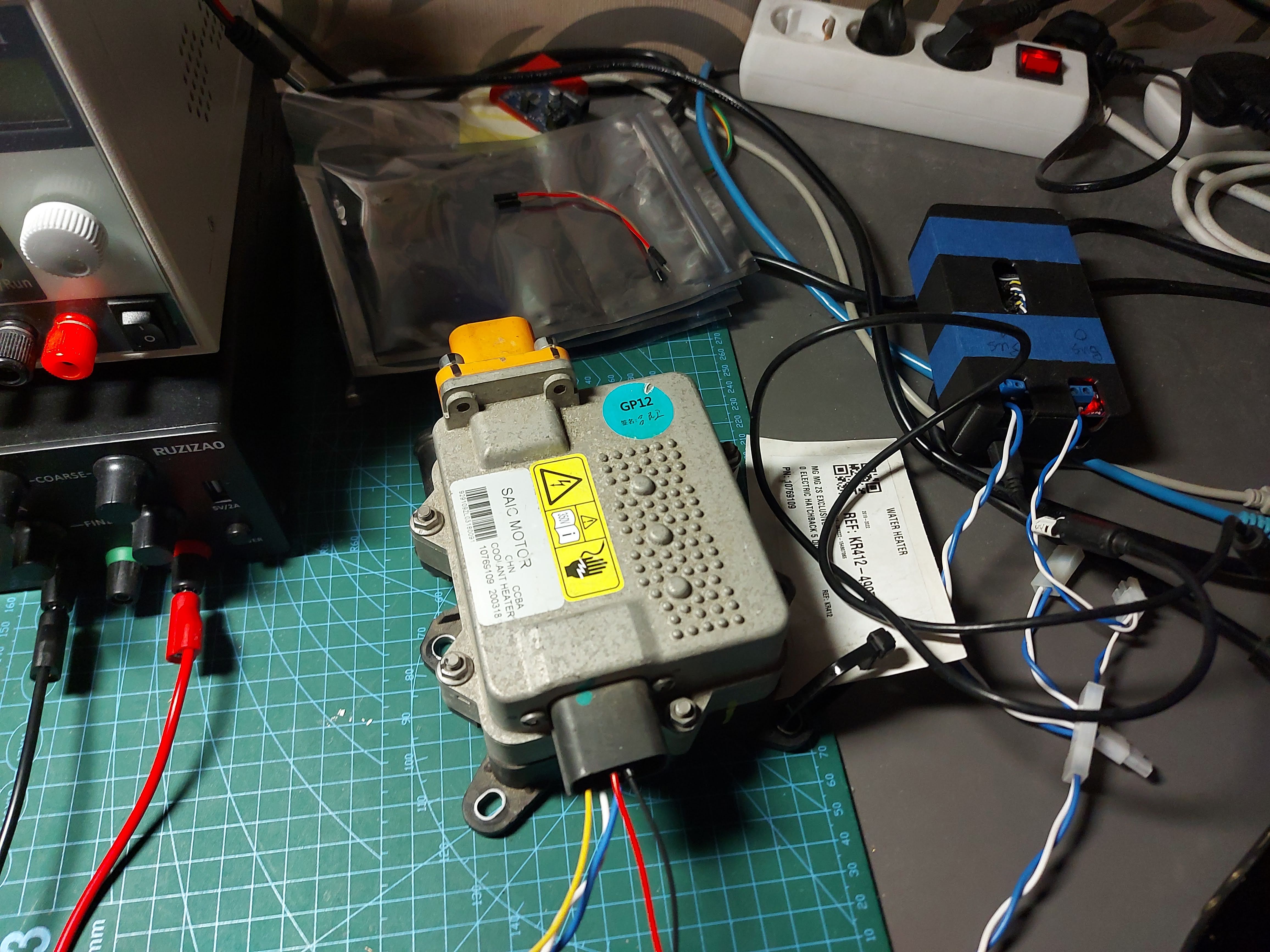

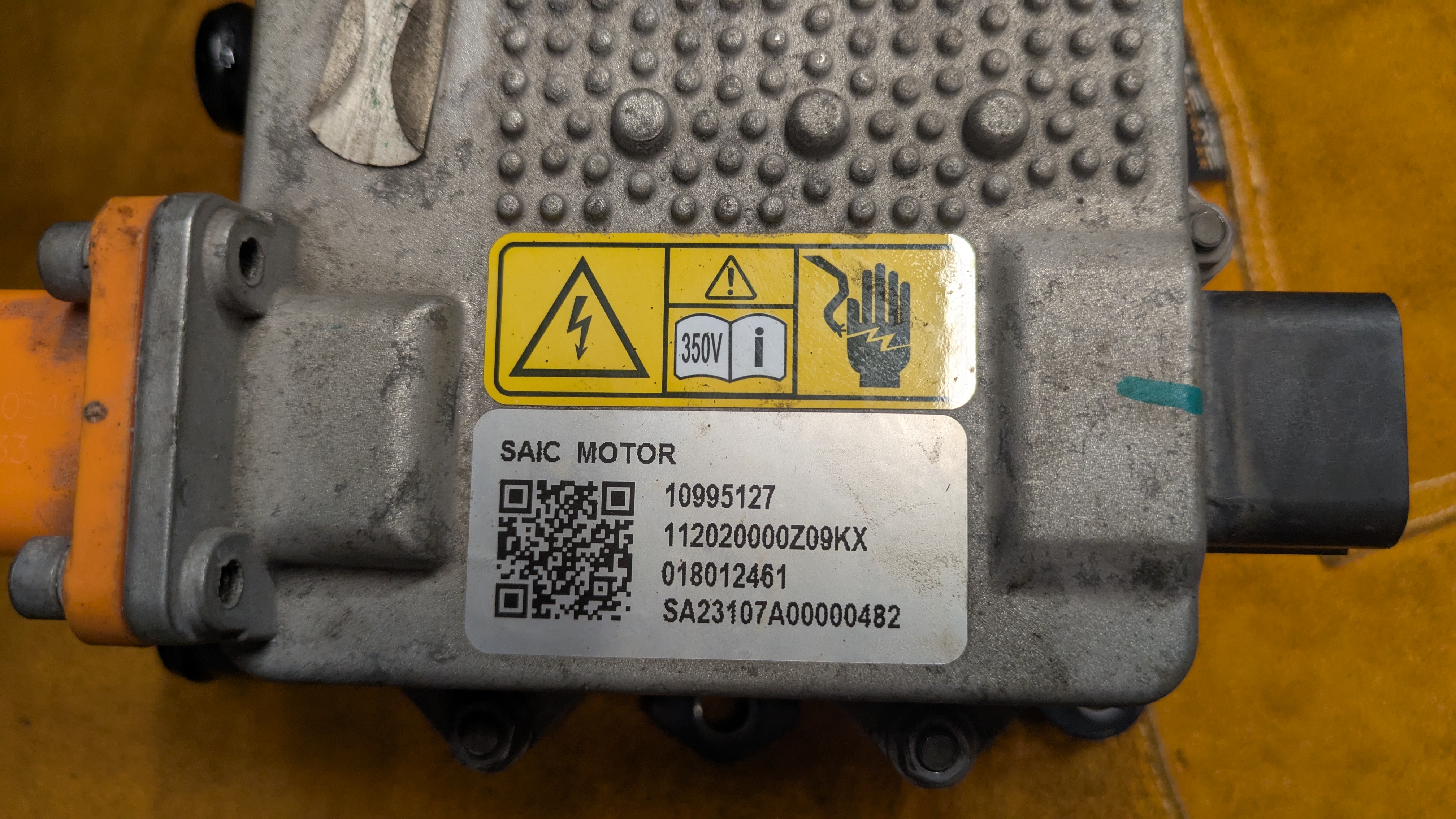

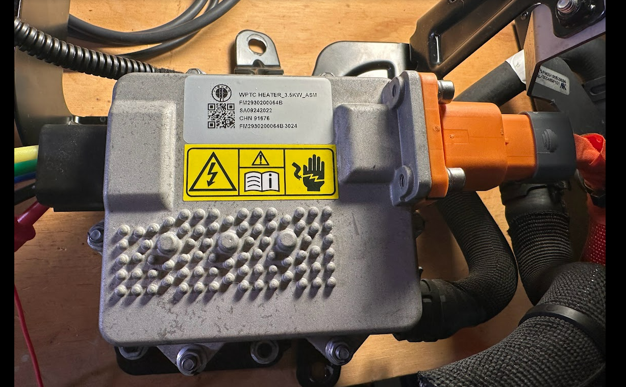

This thread is to discuss anything around the MG Coolant Heaters, such as found in the MG ZS
I have started work on reverse engineering the Coolant heaters https://openinverter.org/wiki/MG_Coolant_Heater
Currently I can get it to draw HV power, however without a battery I am a bit stuck. Luckily Damien also obtained one so we can make progress.

Mine is installed in the L200 now and we have observed around 6kw so far. Simple one can message for control. Must get it into Zombie soon so can prove it out.

Jack Bauer wrote: Fri Dec 13, 2024 6:24 pm Mine is installed in the L200 now and we have observed around 6kw so far. Simple one can message for control. Must get it into Zombie soon so can prove it out.

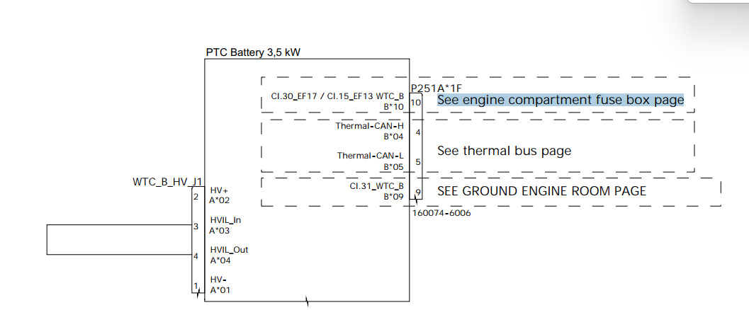

Care to share 0x2A0 CAN command range?
Anyone has LV connector wiring schematic? I can only see CAN pins position on wiki. Does this mean heater doesnt use 12V power?
Never mind, i managed to actually read the wiki :)...
Thank you...

arber333 wrote: Sun Dec 29, 2024 12:49 pm Care to share 0x2A0 CAN command range?
We have something that works, the logs are online. We do not know exactly what all the fields do so it is still classed as experimental.
https://github.com/Tom-evnut/MG-Coolant-Heater
Good thing is the heater self limits its operational temperature to we believe 60-70C.
