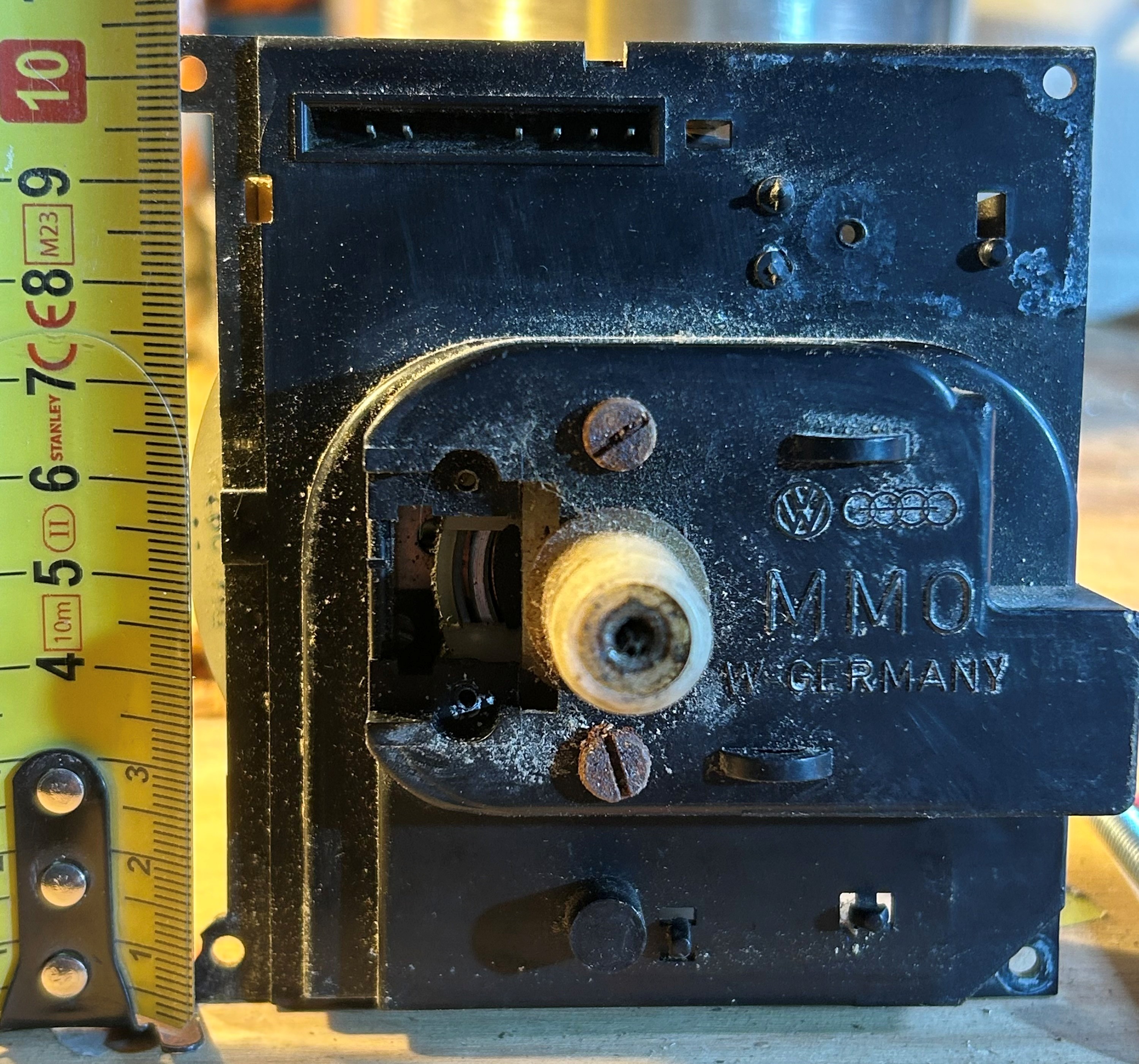

is there a place where i can find the dimenssion to check adaptability on golf mk2 cluster ?

D@F wrote: Fri Apr 18, 2025 9:35 am is there a place where i can find the dimenssion to check adaptability on golf mk2 cluster ?
Please provide the dimensions of the speedo mech in the cluster with pictures.

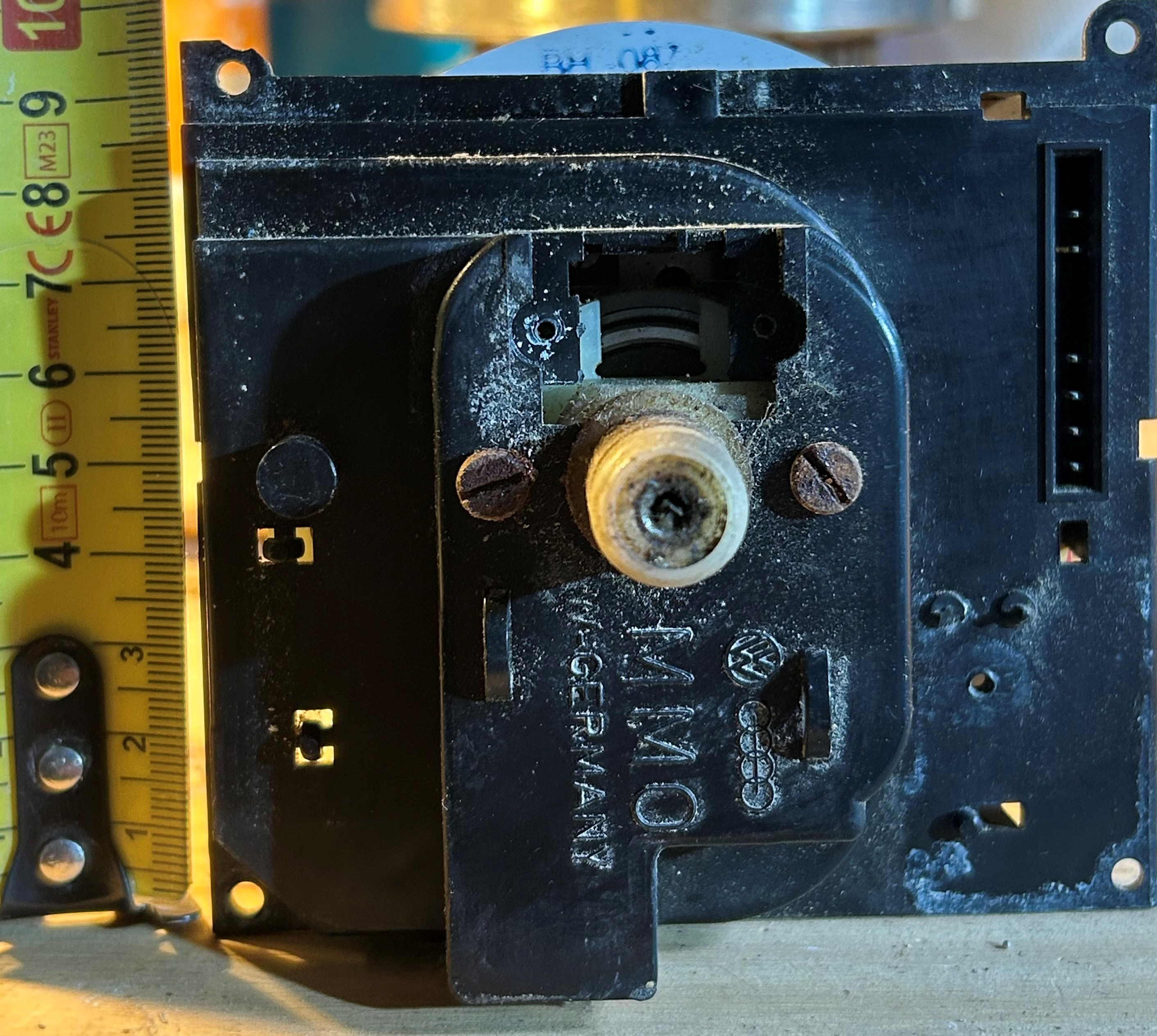

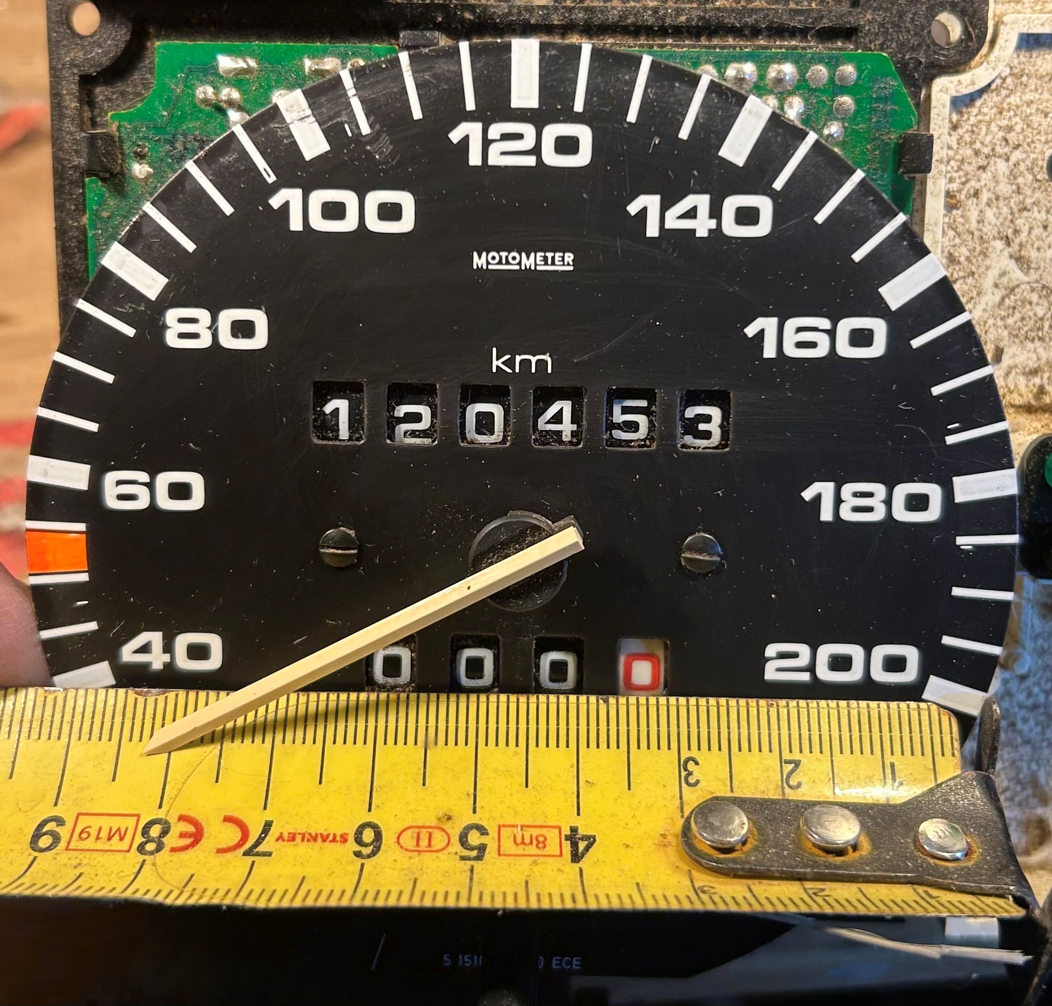

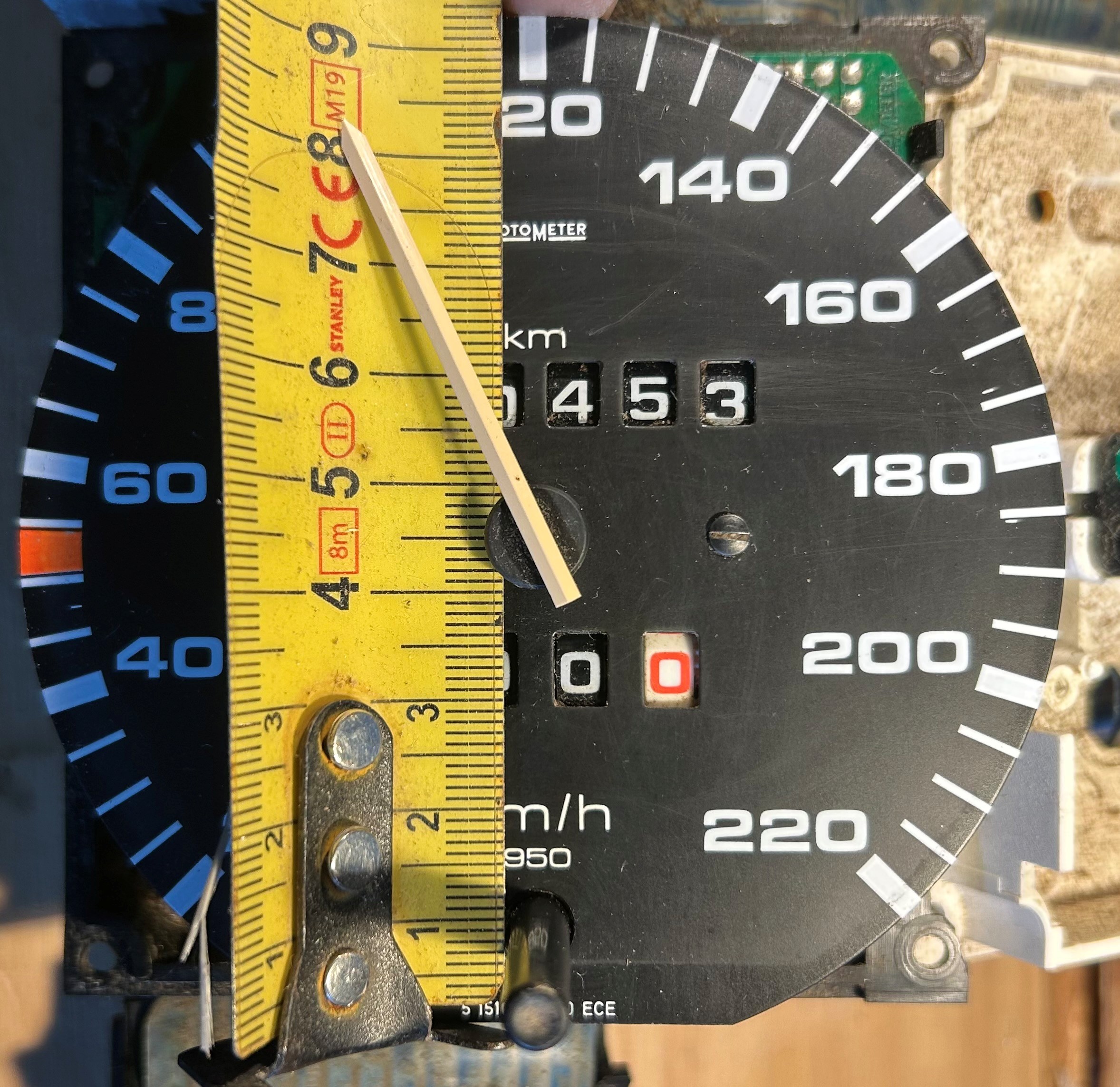

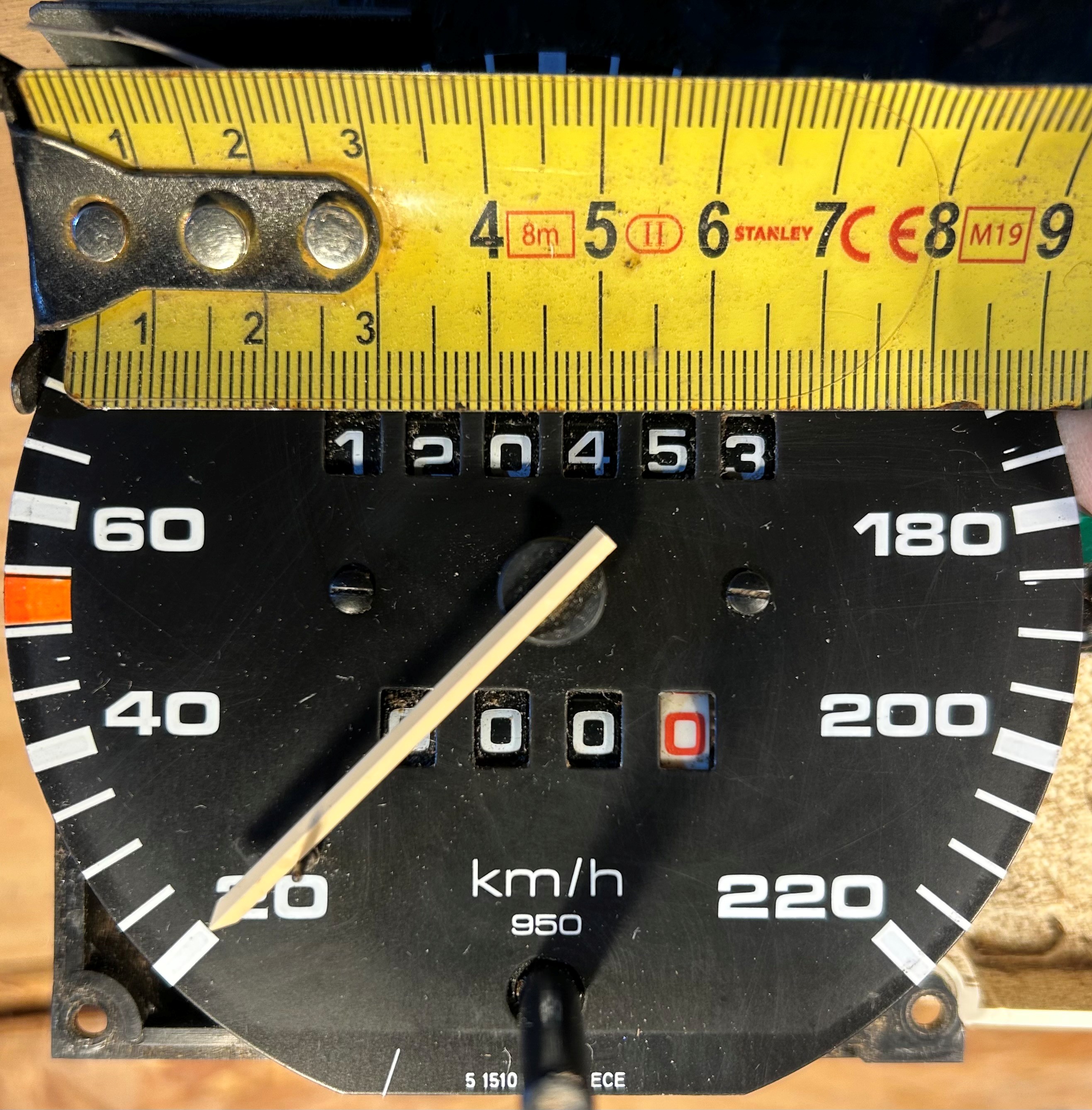

tom91 wrote: Fri Apr 18, 2025 9:40 am Please provide the dimensions of the speedo mech in the cluster with pictures.
i hope this may help :

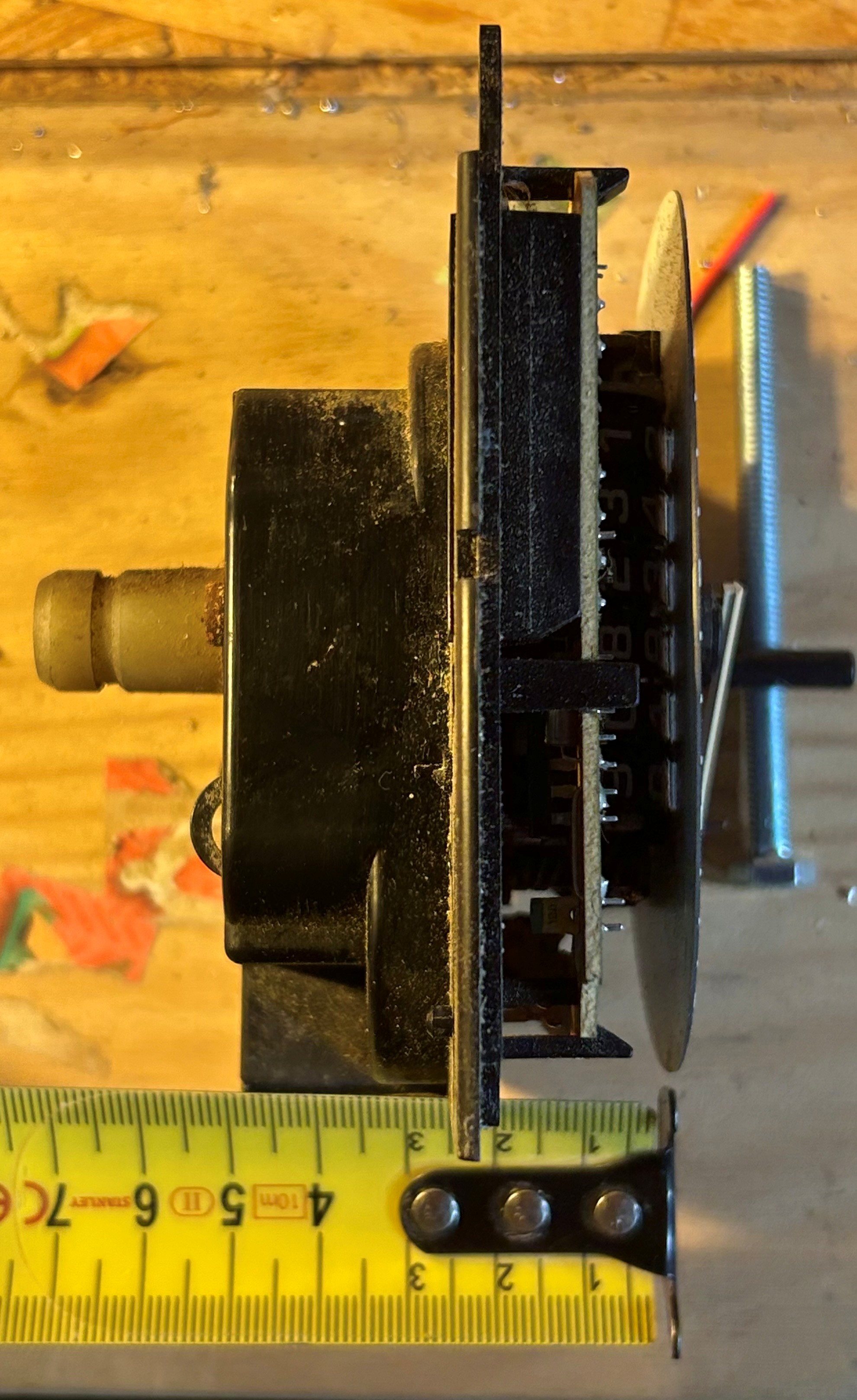

Re: Intrest and Feedback Request Classic EV gauges
Depth is also needed.

tom91 wrote: Sun May 04, 2025 7:26 pm Depth is also needed.
if it's needed i can cut, there is plenty of space behind the cluster.
