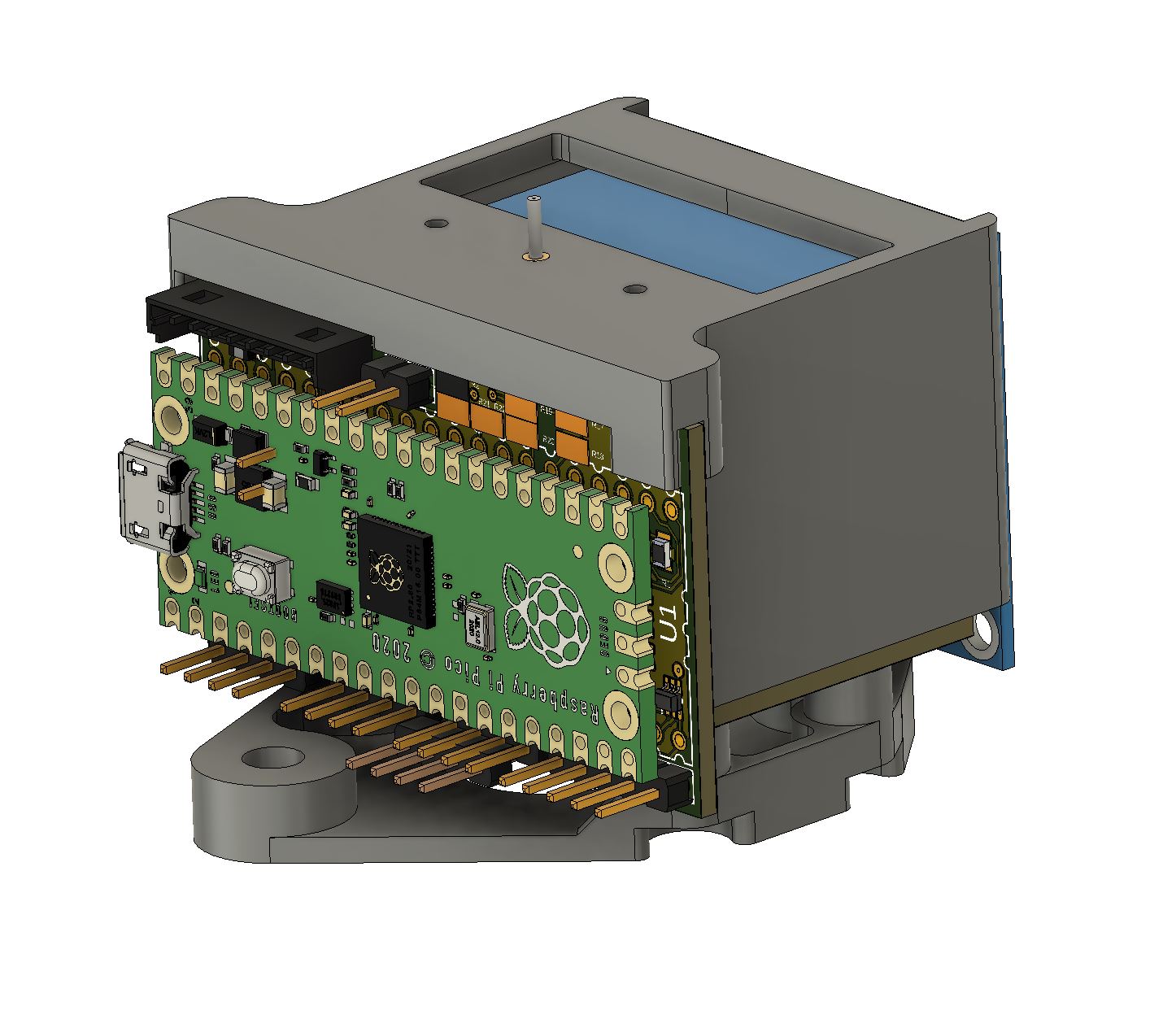

I have a few years back started work on a project to create some EV gauges based a replacement for a "classic Smiths" speedo drive unit.
Just trying to work out if there would be enough intrest to make this a product for purchase. It is designed to work for Mini gauges, Beetle gauges and most other classic Smiths gauges .
The base module would act as the brains and the main speedo and odometer mechanism. This unit can be added to with a "secondary" info screen and rotary encoder with a push button to toggle pages.
At the moment designs are finished for the Mini single big gauge and two smaller clocks.
Mini Centre Gauge during development
Mini twin gauge with final hardware
The classic beetle gauges are not as far along, the Speedo mech just drops in and works.

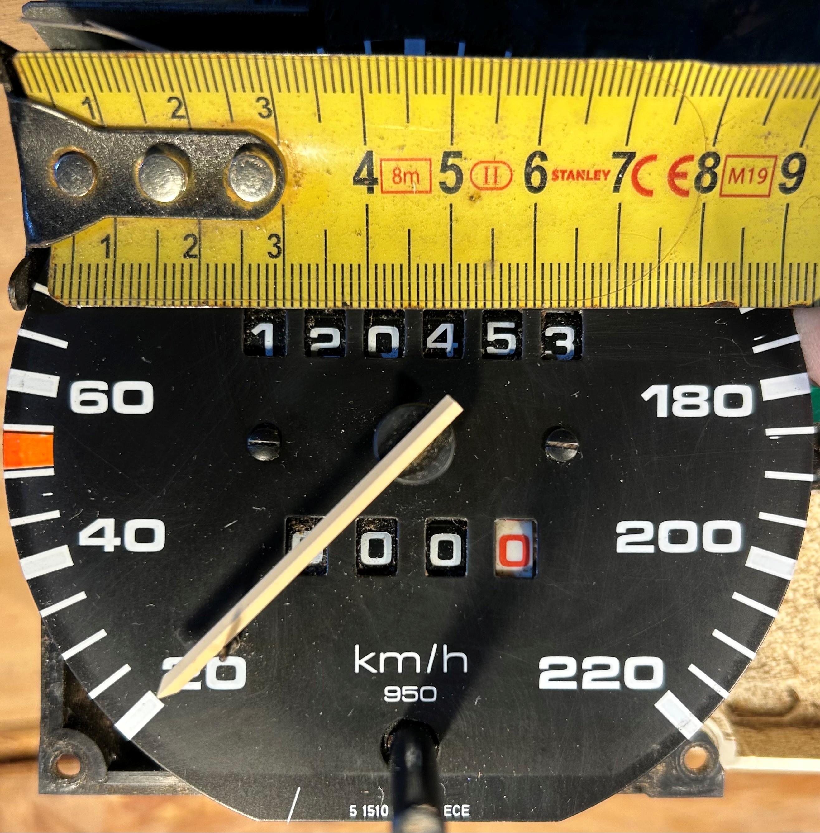

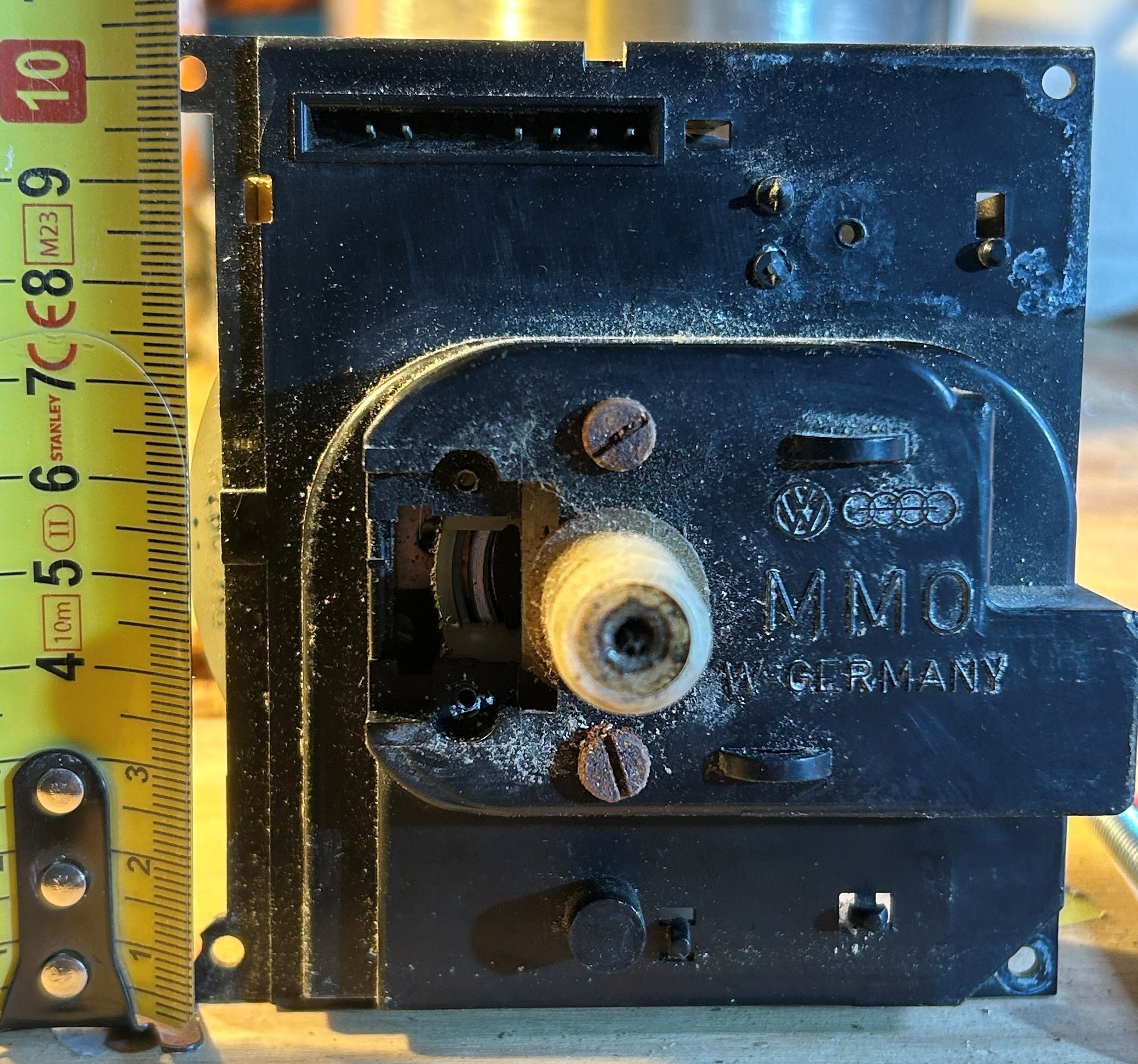

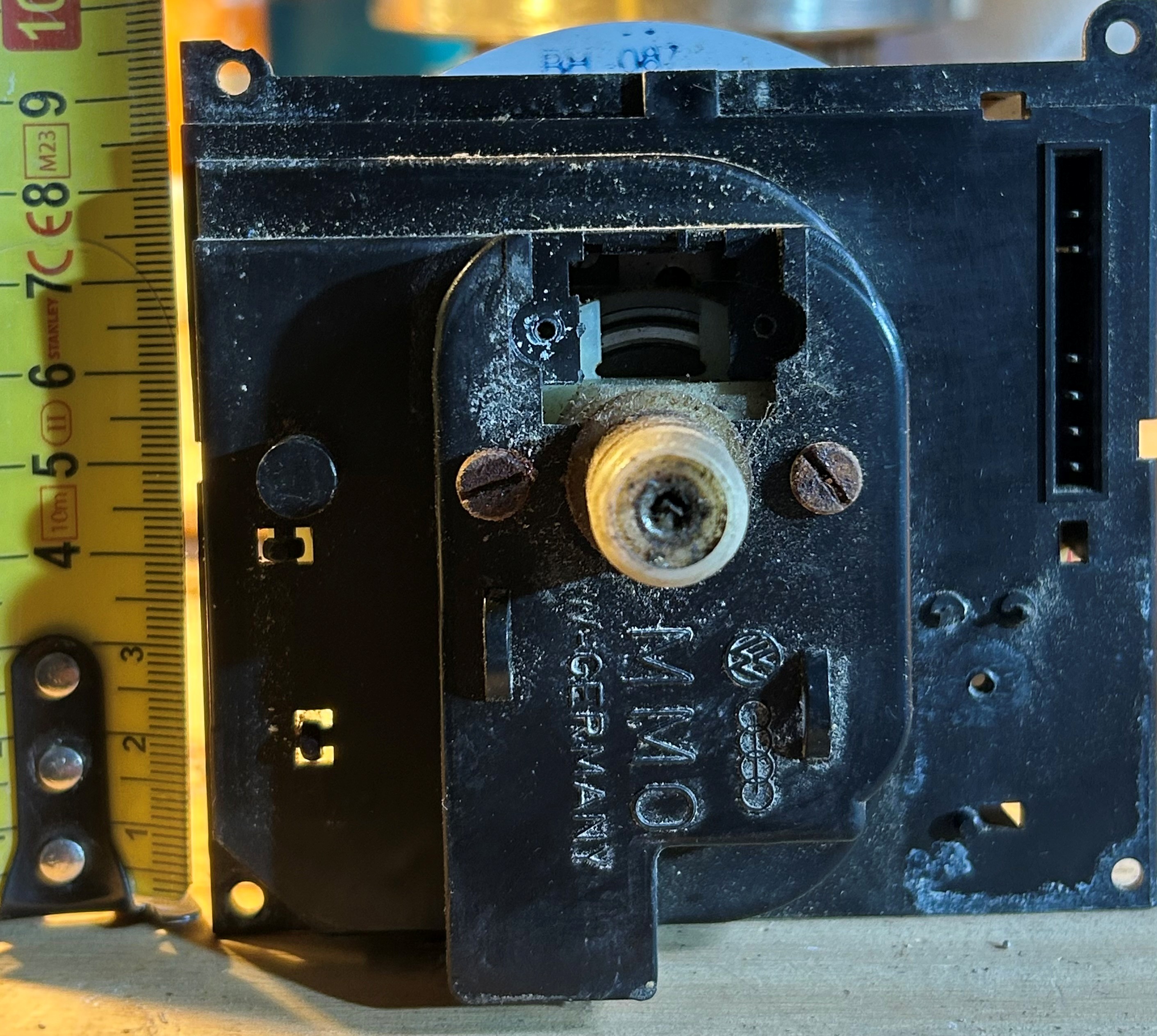

is there a place where i can find the dimenssion to check adaptability on golf mk2 cluster ?
Re: Intrest and Feedback Request Classic EV gauges
Posted: Fri Apr 18, 2025 9:40 am
by tom91
D@F wrote: Fri Apr 18, 2025 9:35 am is there a place where i can find the dimenssion to check adaptability on golf mk2 cluster ?
Please provide the dimensions of the speedo mech in the cluster with pictures.

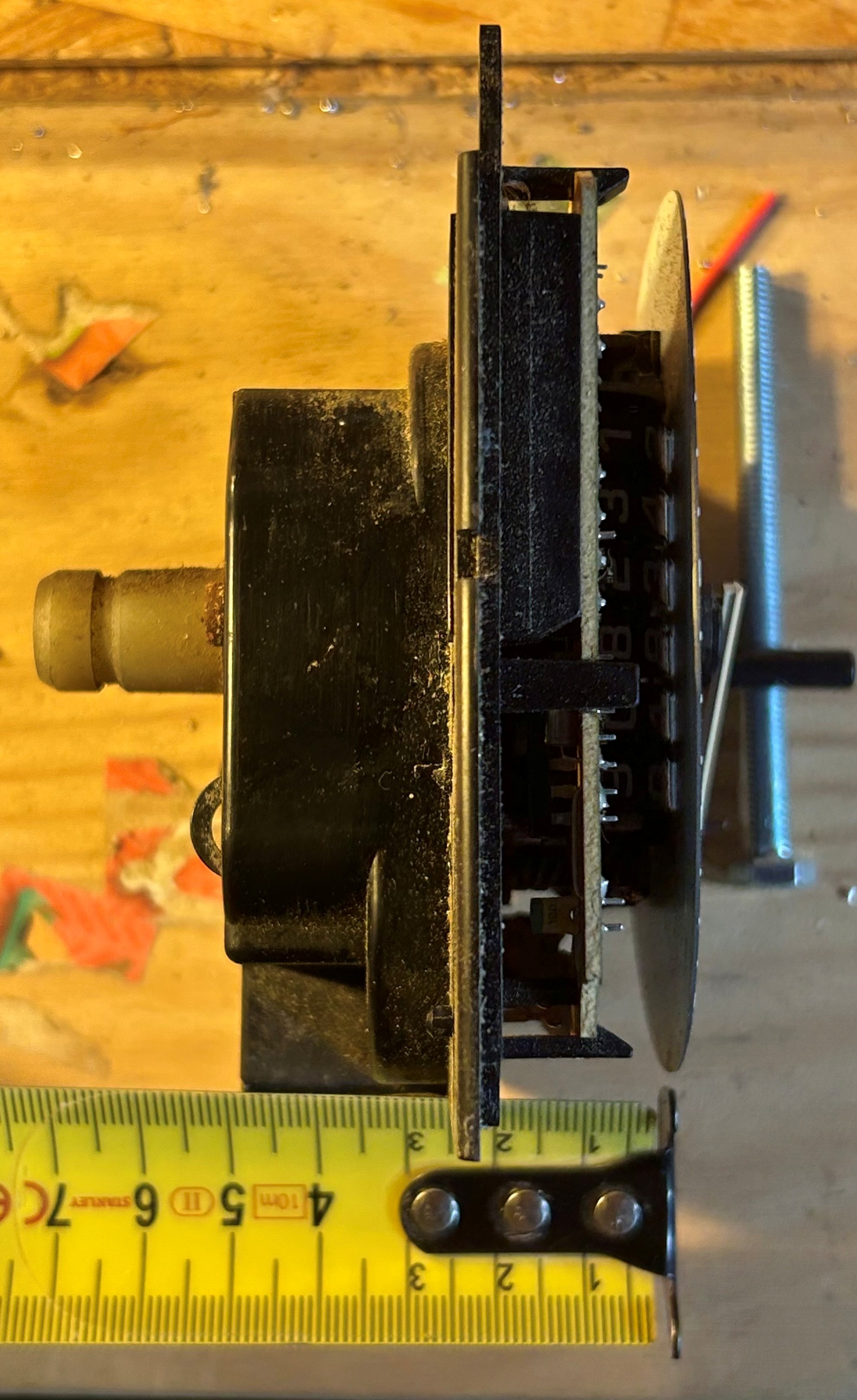

by D@F
tom91 wrote: Fri Apr 18, 2025 9:40 am Please provide the dimensions of the speedo mech in the cluster with pictures.
i hope this may help :
Posted: Sun May 04, 2025 7:26 pm
by tom91
Depth is also needed.
Posted: Wed May 07, 2025 2:19 pm
by D@F
tom91 wrote: Sun May 04, 2025 7:26 pm Depth is also needed.
if it's needed i can cut, there is plenty of space behind the cluster.
