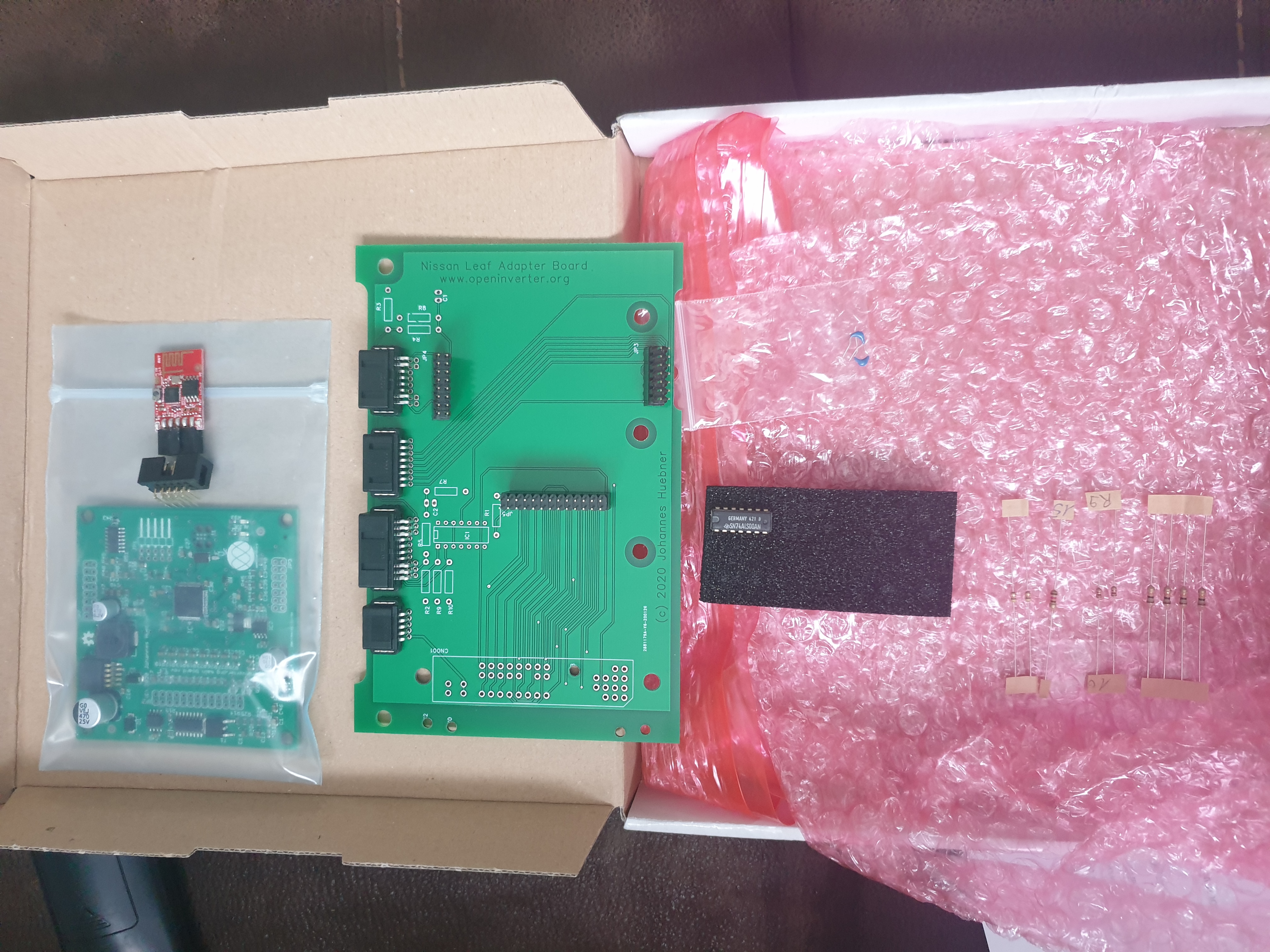

Hi all, I have to outsource a lot of the electrical work in my project so have to present exactly what is required while I do the mechanical side.
I have shared the board and instructions sheet + #20 video with a local phone/laptop shop but they have come back with a lot of questions etc. that I wasn't ready for.
The shop will not guarantee any of the work as they don't know about it etc so I need to make the instruction 100% foolproof
- Is there an instruction video for soldering? step by step - video #20 only shows changing out the board.
Are there any parts that are only one way? resistors /74F00 - does it make a difference which way. There is a U shape and a dot on the upper surface of the chip and on the board has a small box in the sketch.
Any special instructions for heat etc.
What needs to be tested before fitting back inbox not clear from the video. Was it just 12v power can checking WIFI signal?

Wow, just realized how far along the Leaf page has come, great work!
This is not a support thread, but hey... The "u" on the chip denotes pin 1 and must point upwards.
