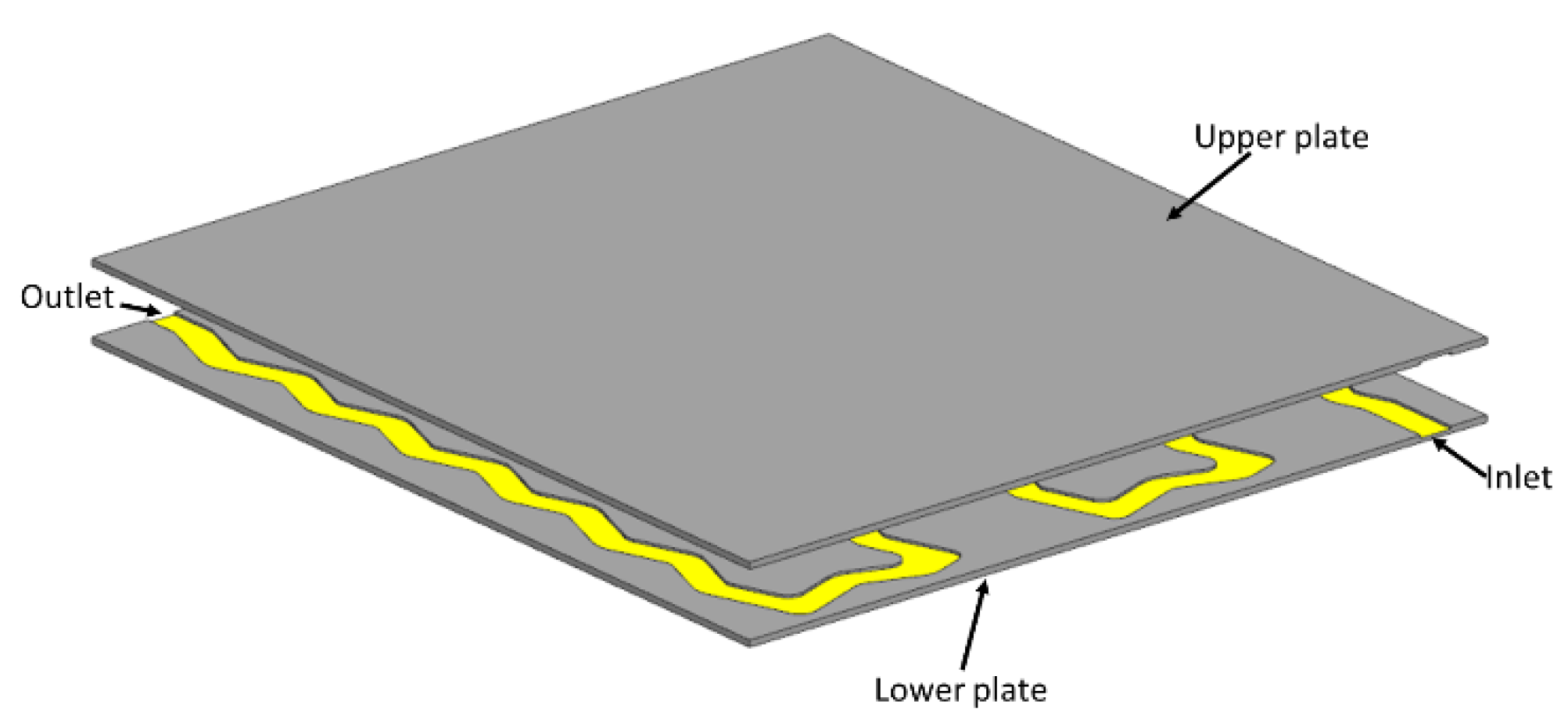

:arrow: 2. Glue 2/3 cooling plates. Weld?
:idea: In this forum i see two examples of plates glued with Loctite 5926 or some other kind of silicone.
2 plates would have a cnc channel in the middle and both plates would be joined, 3 plates could be laser cut and then glued together.
Leaks would have to be carefully tested.
:idea: Welding the thin plates would bring a lot of distortion, holes could be filled in the middle to add strengh and avoid separation of the plates.
:idea: Friction Stir Welding (FSW) looks perfect but how hard is it to find who does it?
:idea: Laser welding does work as long as the penetration to the lower layer allows a good bonding.

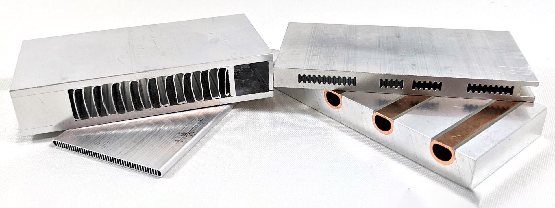

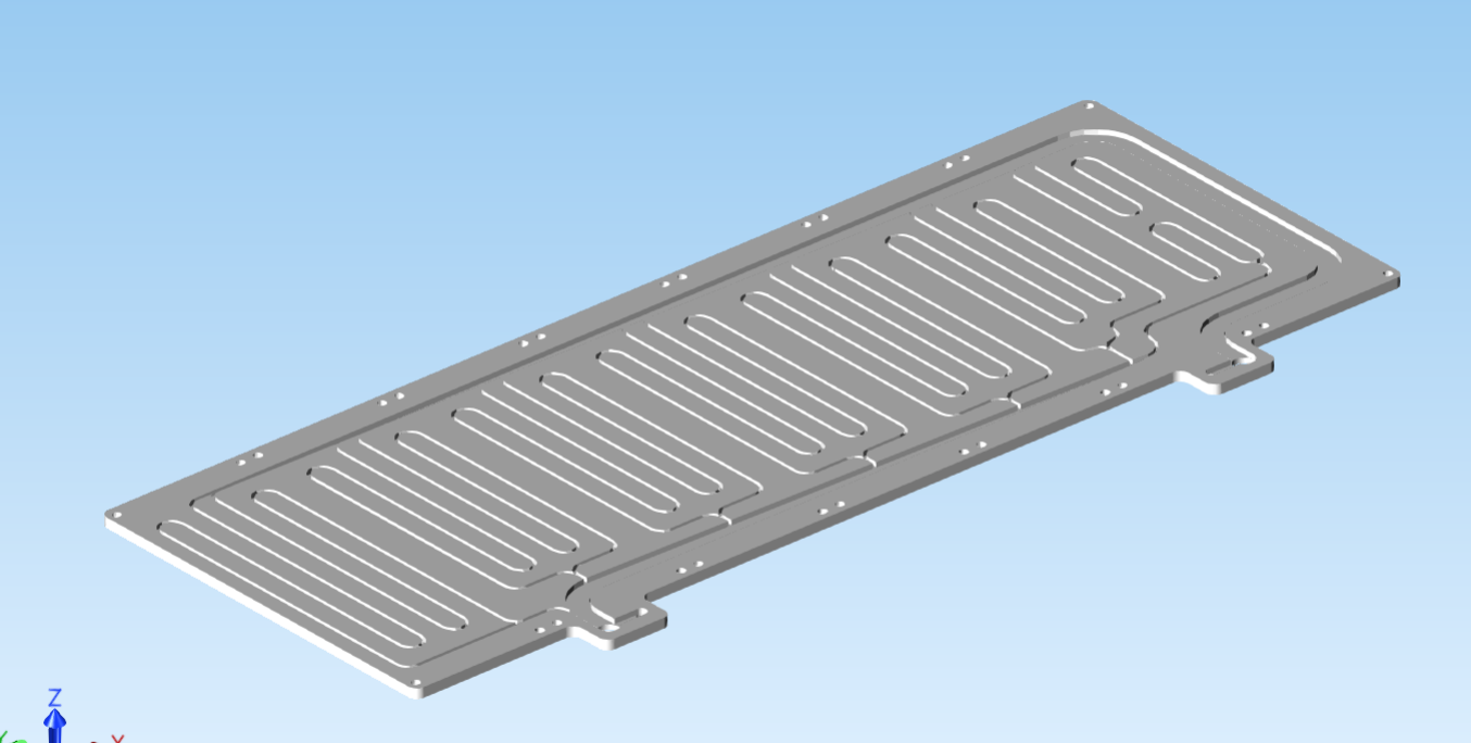

:arrow: 3. Extrusions
peugeot 208

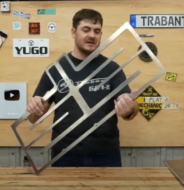

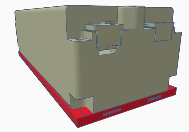

Extrusions are very interesting, unfortunately it's not easy to find the one you want but custom ones can be made.
I sent multiple emails to businesses around me asking if possible how much would it be to make the following design,
what do you think?

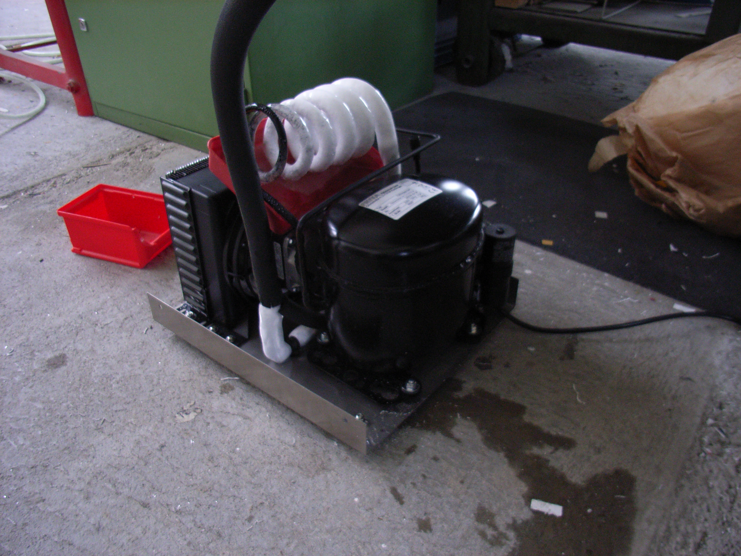

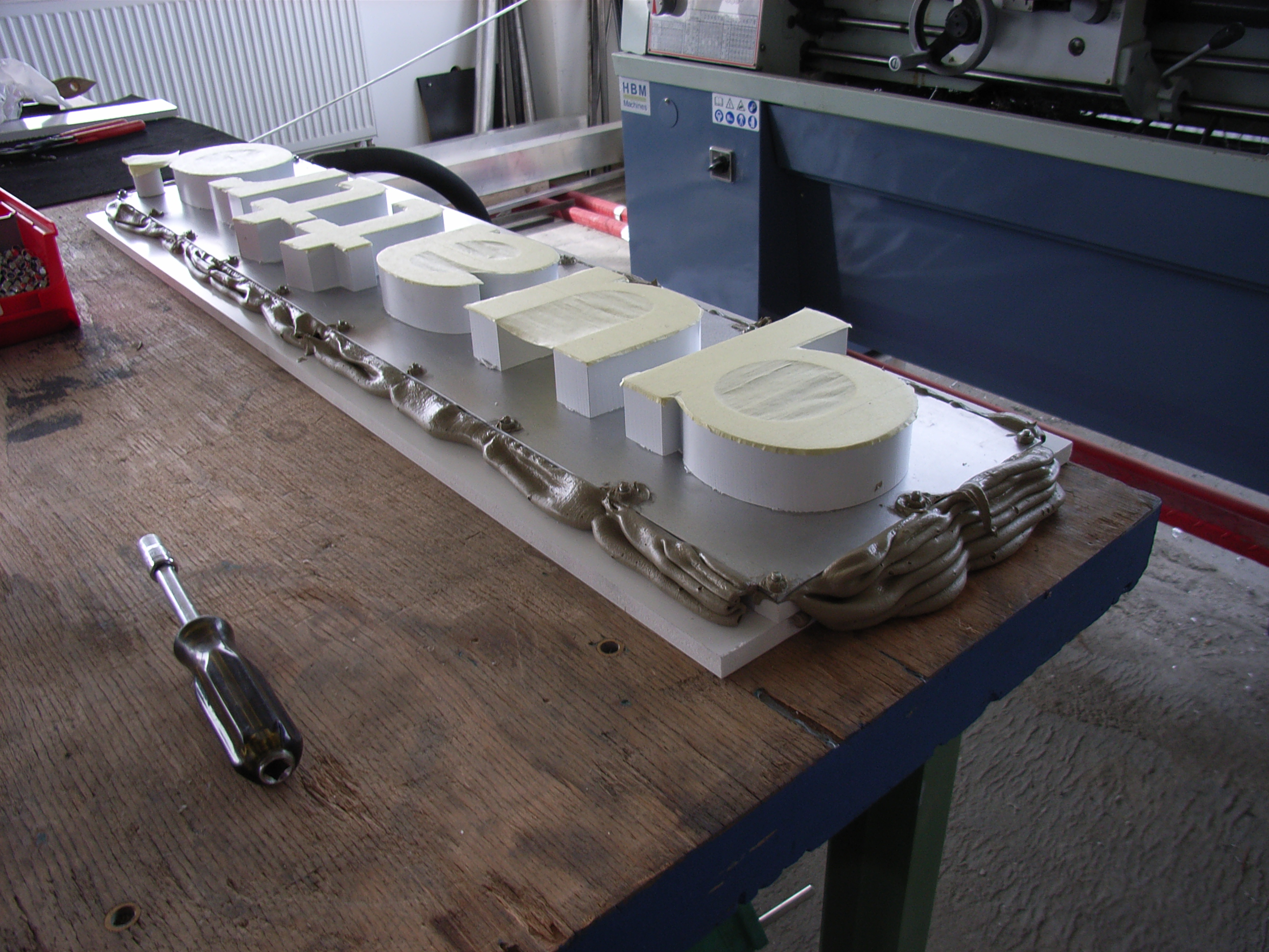

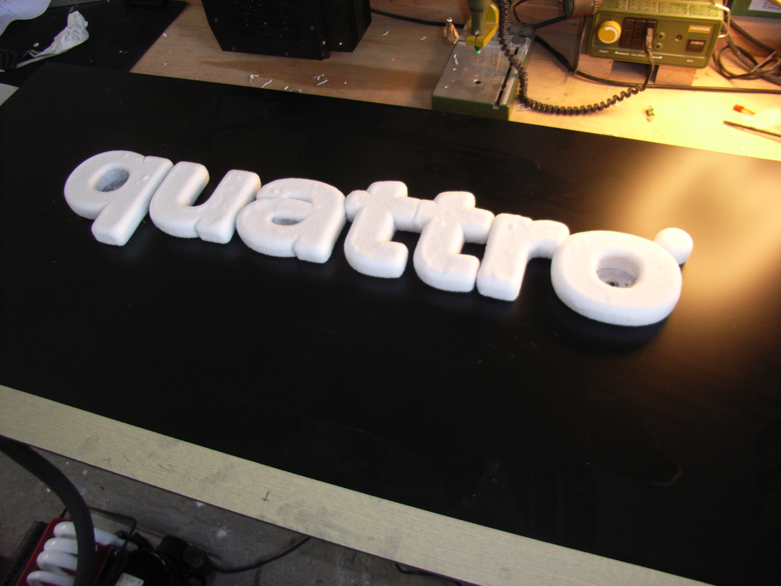

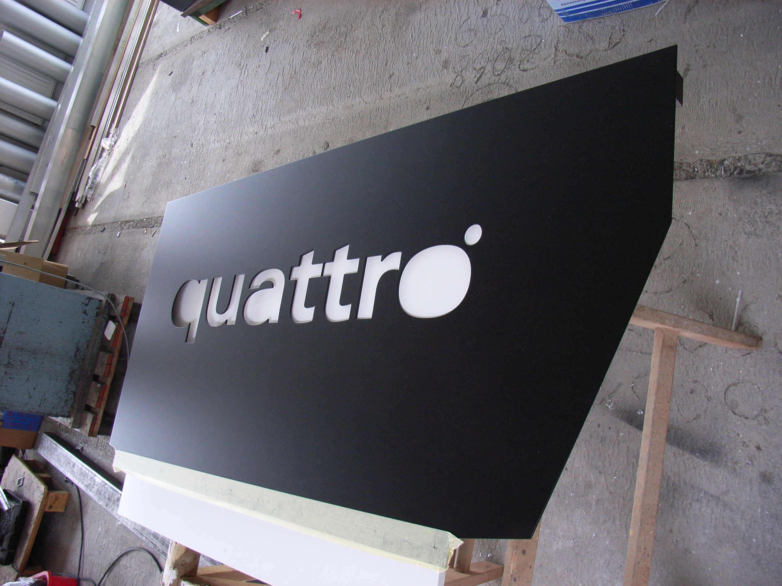

18 years ago I built an icy lettering for Audi. The cold was generated by a refrigerator compressor. I used an insulating rear panel, copper pipe and an aluminum front plate on which the letters were mounted to transfer the cold to the aluminum letters. The space around the copper pipes was filled with heat-conducting paste. It worked very well. I could imagine the same setup with battery modules instead of the letters and water in the copper tubes. It doesn't have to be done very precisely and is always tight.

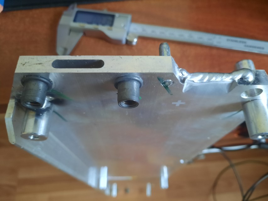

I actually made some cooling plates for chargers using a copper tube locked in aluminum. I had to mill the straight channels into a 12mm slab of alu. I made it 8mm deep and 10mm wide. I used 10mm tube for climate.
For DIYing It requires a lot of straight tubes, no curves... And when pushing copper tube in i had to tap aluminum on the sides to lock it in. Mostly it did the job as alu is such a good thermal conductor. However as car is vibration intensive enviroment i was afraid copper would rattle and jump out of the groove... Maybe 3 slab sandwich is not such a terrible idea after all...

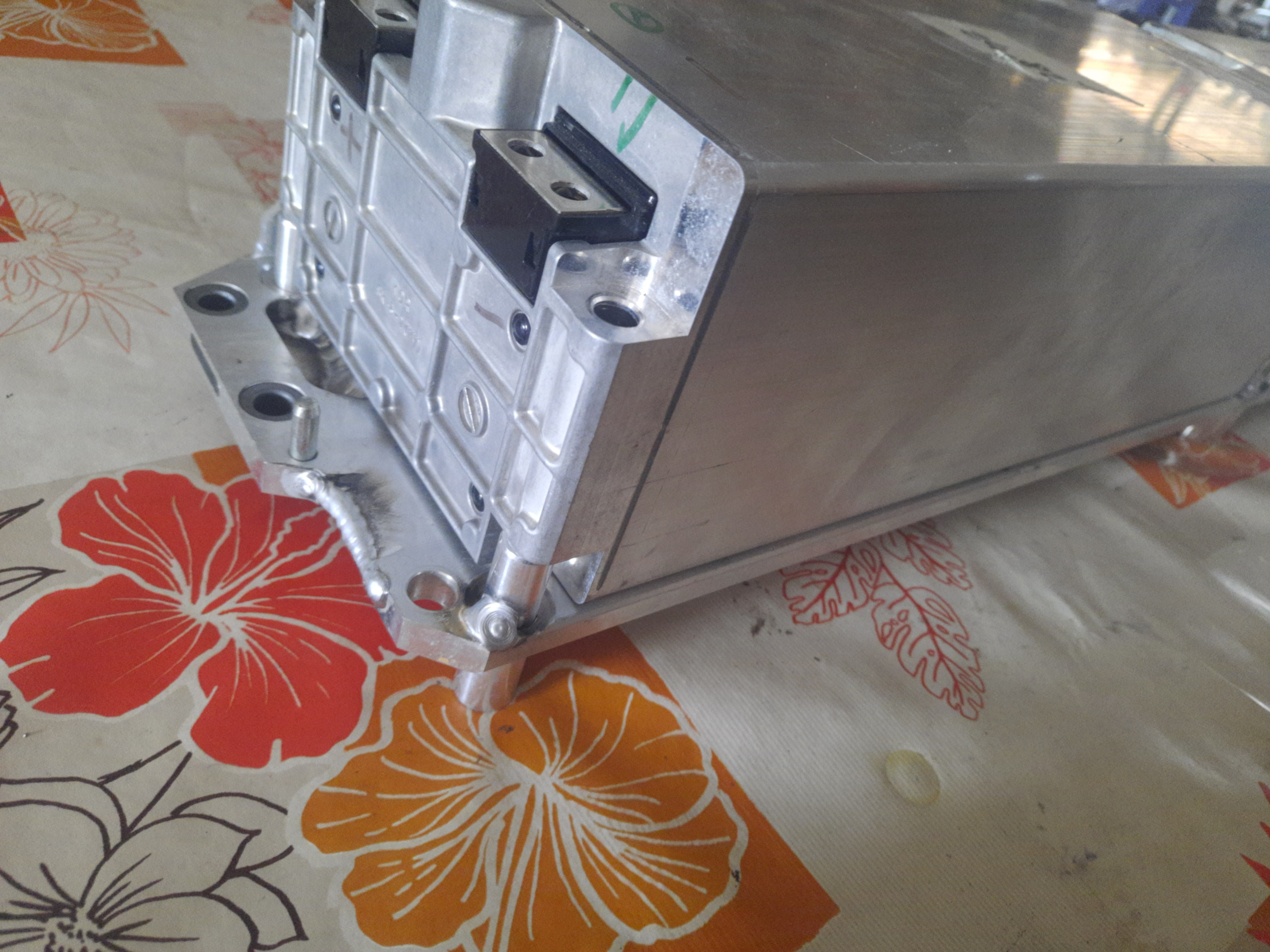

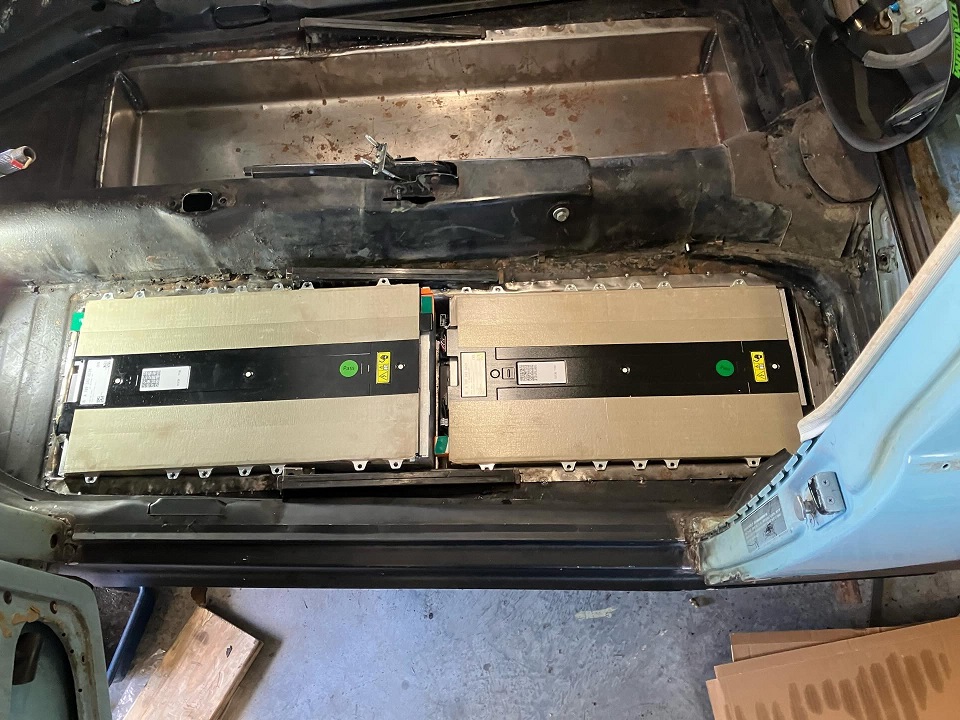

I have CATL prismatic cells, which are cooled conductively in the Mercedes EQ they came from with what, in my opinion, is a bit of overkill. Like it was said above they probably don't need MUCH cooling.
I built the battery boxes with an extra 1" of space under the cells with the modules bolted down:
Right now the plan is aluminum tubing bent into long runs and pressed into a conductive substrate. But until I get that done, I am pretty sure that just blowing air through the gap would be enough for testing?

more than 1 month later, i have been drawing and asking for quotes in china.
The extrusion guys in poortugal or spain are all "censored" and don't need the work(must be a socialist thing...).
The first quote in china is 360 bucks + 200 shipping + 23% tax in customs would put me back more than 700 bucks.
I am lost and will give up on cooling real soon...
Posts: 2963
Has thanked: 330 times
Been thanked: 848 times
Re: Battery cooling plate
CrAzY_DrIveR wrote: Wed Dec 04, 2024 10:21 am back more than 700 bucks
That is cheap for such a large custom one off piece from china. Most the money probably goes into setup costs.
You will not find a cheaper way to do such bespoke items unless you can do most the work yourself. Even the costs of all the aluminum required is very high.

i understand, got some quotes of 3500 and 1500 right now.
but it's a cnc plate that goes to an oven for brazing i don't know how much setup it needs.
Posts: 2963
CrAzY_DrIveR wrote: Wed Dec 04, 2024 2:25 pm but it's a cnc plate
Machine setup time, material setup and CAM. Plus Brazing analysis. All is time. Employees get paid. Its simple math.
Do more parts the fixed engineering cost gets split of multiple units.
Keep in mind if things are cheap they will be rushed and done incorrectly. Propper custom parts cost money.

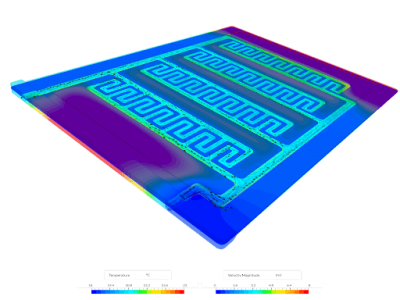

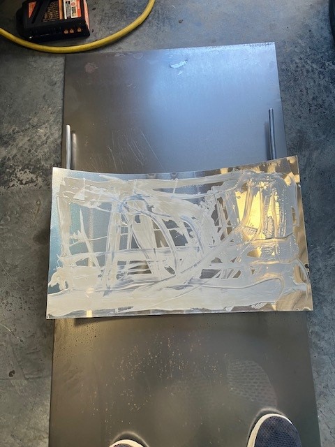

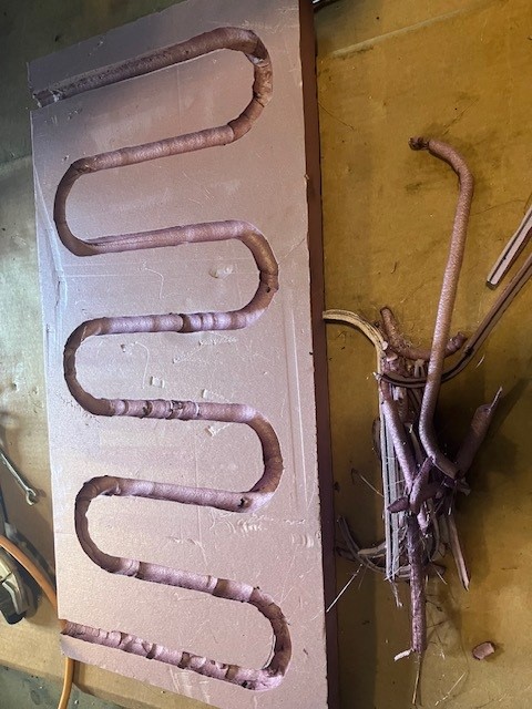

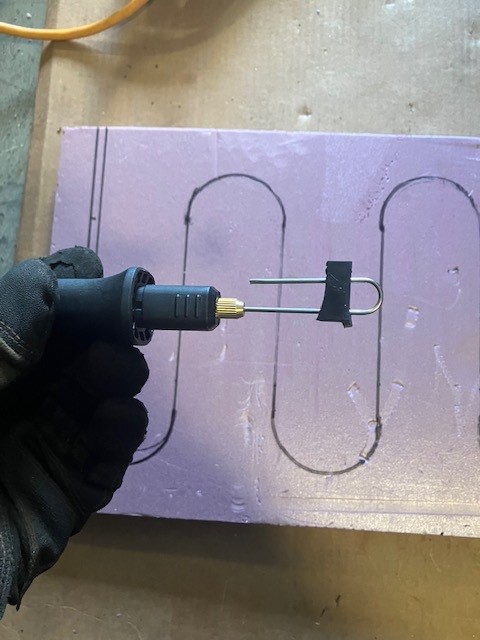

I have completed my front battery heat exchanger. Again caveat is that my main concern is balancing temperatures. I am not DC fast charging, but regardless I've done thermo calculations in Autodesk and I should be able to dissipate 2000 Watts of heat with the following design, even with the not-ideal connection between the tubes and sheet.

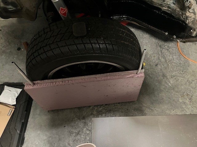

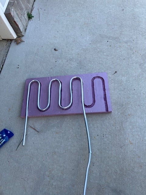

Basic design is 1" foam with 1/2" aluminum tubing, 3" bends, 20ga aluminum sheet to spread the load and heat. The front HX uses 7 bends because it needs to be in "landscape" orientation. The bottom HXs will be a simpler 3-bend design because they are portrait orientation. Here is the tool I used to cut the grooves in the foam:
And cut out. It was a little rough at first until I got the hang of it. But this is just to be able to recess the tubing.
Hand bending of the tubing (annealed refrigeration tubing) with a spring tool to prevent kinking. Still, doing this by hand was a pain.

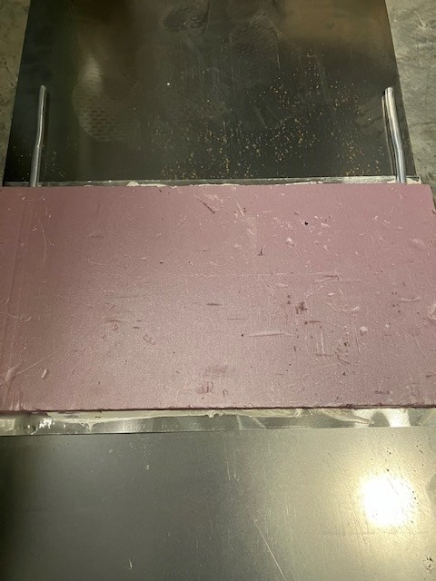

Once bent I used a plastic-to-metal epoxy to put the sheet on...
And placed the sandwich between pieces of steel and all the heavy things in my shop. The following day I took it out and the sheet is very tightly bonded:
And it is basically done just need to trim (or bend over the edges) and figure out how to terminate the pipes.
Theoretically you could get this down to 1/2" thick and cut the foam instead of grooving it. There is also a lot more that could be done with a mandrel tubing bender, brazing, etc. A double run design I ran in Autodesk with tighter bends appeared to be able to dissipate more than 6000 watts... Which I would think would be enough even for DC fast charging. (It would be 15% heat losses on a 200kW charge over 5 such HXs)
