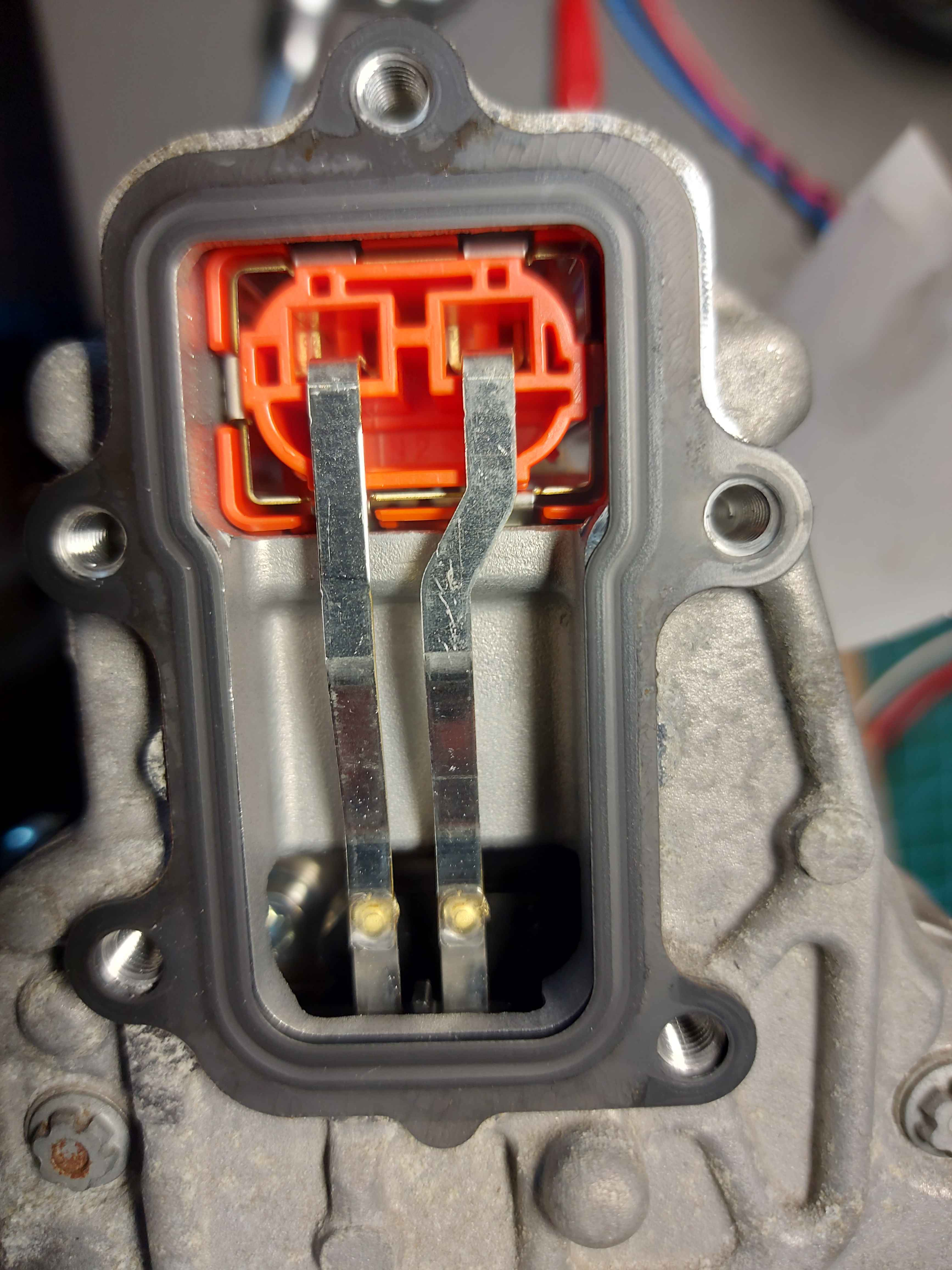

This topic is to track the reverse engineering of the Nissan Leaf ZE1 AC compressor. This is the one from vehicles with a Heatpump.
From Leaf model year 2017-2023
It is label Denso S1 ESB27C
The pinout is as follows:
Left most pin 12V ign, middle is ground, right is LIN
Lin Speed 19200kbps
HV, Red is positive Blue is negative
It will not communicate unless it has HV voltage going in, the logic must be HV powered.
So far I found it responds on ID 0x49, byte 2 is Voltage, scaled at 2V/bit.
Does anyone have the ability to log the LIN bus on a working ZE1 Leaf to assist me in finding the control ids?

NickoSynergy wrote: Sat Oct 26, 2024 8:28 am but out of the car
No wont work I need a working system with refrigerant so the compressor actually runs.

Turns out it has HVIL monitoring inside, got some workshop info that highlights this.
Re: Nissan Leaf ZE1 AC compressor LIN
Posted: Tue Oct 29, 2024 12:08 pm
by tom91
There is no HVIL, so the search for why it does not work continues.
Posted: Tue Oct 29, 2024 12:22 pm
by tom91
aot93 wrote: Sun Oct 27, 2024 8:27 pm Bit hard to get the pump to cycle on and off in these temps, but I did a max heating, Max Cooling and off.
Surprisingly I do see ID 0x07 (PID 0x47) which is indicated as the command from the info above.
However the response from the compressor, which should be ID 0x09 (PID 0x49) seems to be missing and very poor. How did you make the connection for logging? As I would not expect this on the bench it is very stable for me.
Posted: Tue Oct 29, 2024 2:52 pm
by tom91
aot93 wrote: Tue Oct 29, 2024 2:24 pm I can grab some more logs tonight to be sure.
That be super, I have no clue why ID 0x09 is so random and inconsistent in nature. It varies in length and even has times where it not responds, all of which is very much unlike LIN bus.
Okay so the compressor should still have been properly connected to the network.
