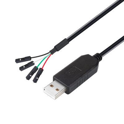

Have you got one of these?
Connect the black cable to GND, green and white to rx and tx (of course I don't know which way around).
Then open a terminal program on your computer with a speed of 115200 baud and at the prompt type
and enter.
What do you see?
jsonWhat do you see?

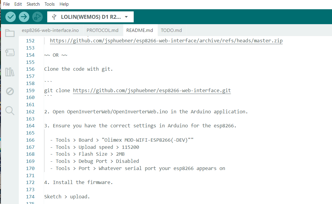

The new Wemos D1 Mini boards arrived. I uploaded the interface to one, soldered the pins on, and plugged it into the zombieverter. First try it connected and everything is up and running. Installed it into its enclosure and it's working great!
Solution: Buy and program a new wemos D1 mini because the original was being funky
Thank you very much for your help!
For anyone else having this issue as well or needs a full step by step guide on how to set up your pc and upload the code to a new wemos board, I'm making a video on how. There is a lot of information on this forum on how, but in a lot of different locations. So, I figured I'd make it really easy. I'll reply to this thread when it releases.

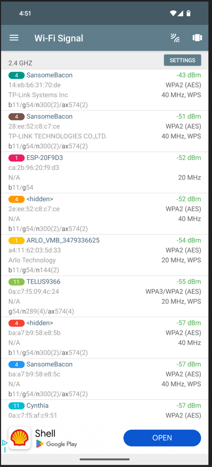

One of the biggest problem I have ever had with wifi on Zom and other OI boards is if there is another accesspoint or wifi source in the vicinity on the same channel. You can test this with a wifi scanner app.
Re: Connection problem between ESP and STM: Zombieverter
So I think the App is showing me its on channel 1 which is conflicting with a ARLO camera one of the neighbors must have?Jack Bauer wrote: ↑Wed Oct 22, 2025 2:29 pm One of the biggest problem I have ever had with wifi on Zom and other OI boards is if there is another accesspoint or wifi source in the vicinity on the same channel. You can test this with a wifi scanner app.
How do I force the ESP to run on another channel? I have been looking at the INO file don't see anything and I can't find the ESP8266Webserver.h file in my folders to look in it....
Mhs
I'm not too sure but you can try this:
In the esp8266-web-interface.ino file of the esp8266-web-interface channel can to be "declared"
The syntax is
So something like the below *should* work
WiFi.softAP(server.arg("apSSID").c_str(), server.arg("apPW").c_str());Code: Select all
SSID, Password, Channel, Hidden?Code: Select all
WiFi.softAP(ssid, password, 6, false)Zombieverter
Thank you. I will look at this when I get home.
Hmm So using Grok I was able to add to the code to get it to change channels. But I have tried channel 6 11 and 13 as well as 1 and nothing is working very good. IN fact its all very Unusable. I am not sure what to do. Is there another way to set up the VCU? Can I make a USB connection or use a TTYL adapter or something?
