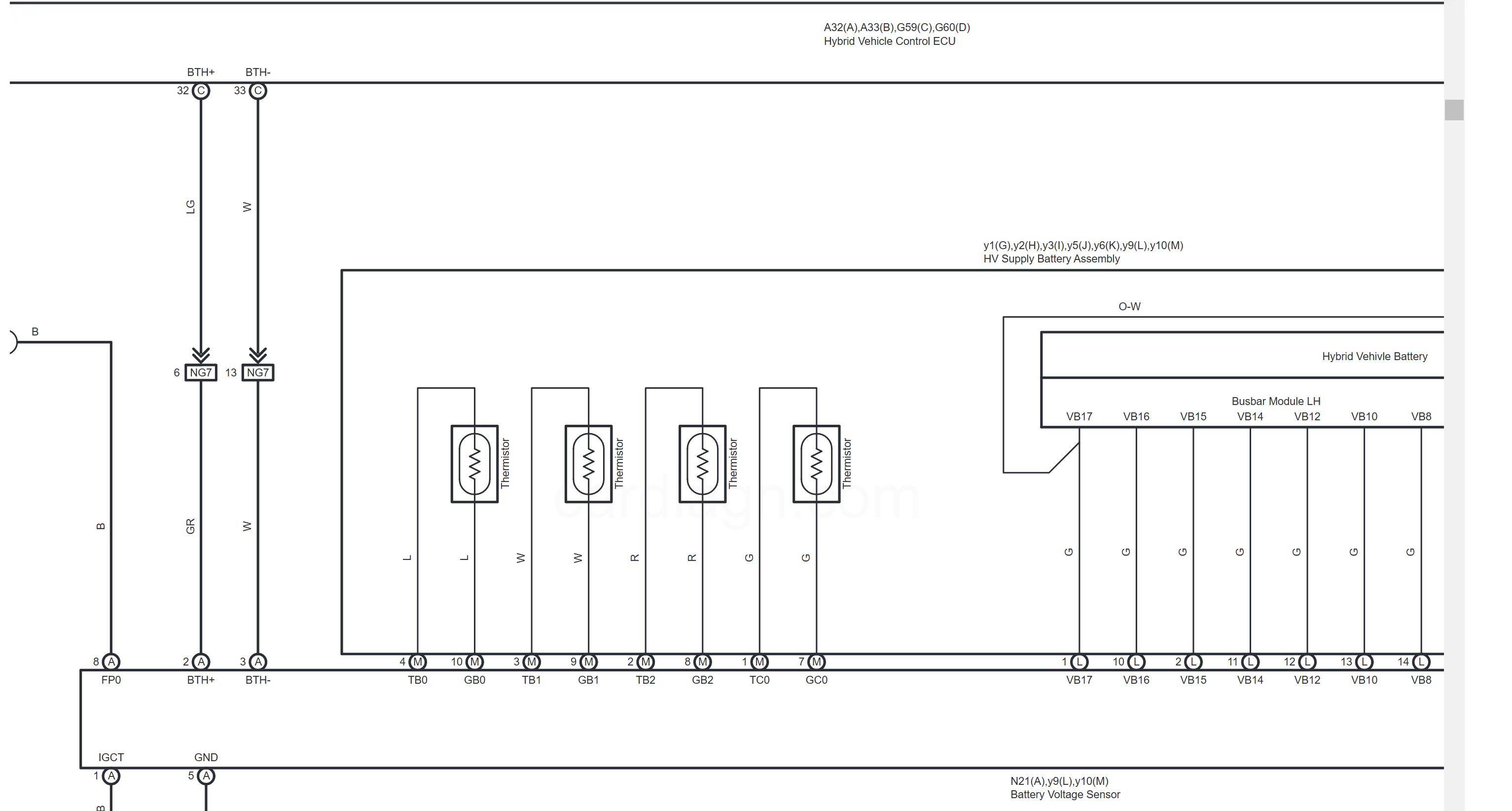

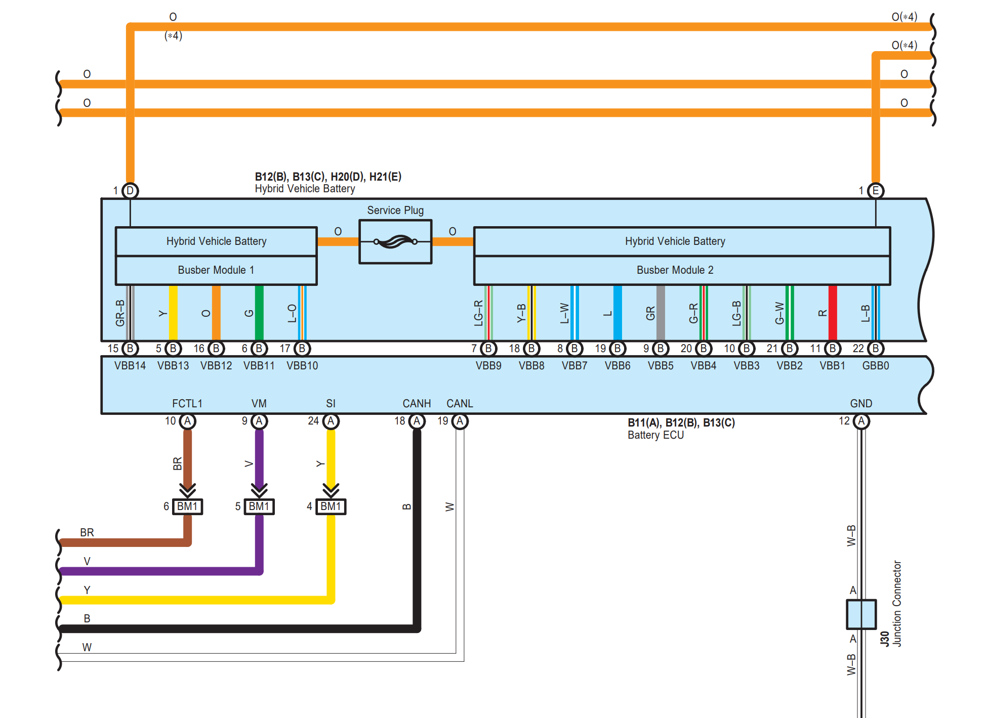

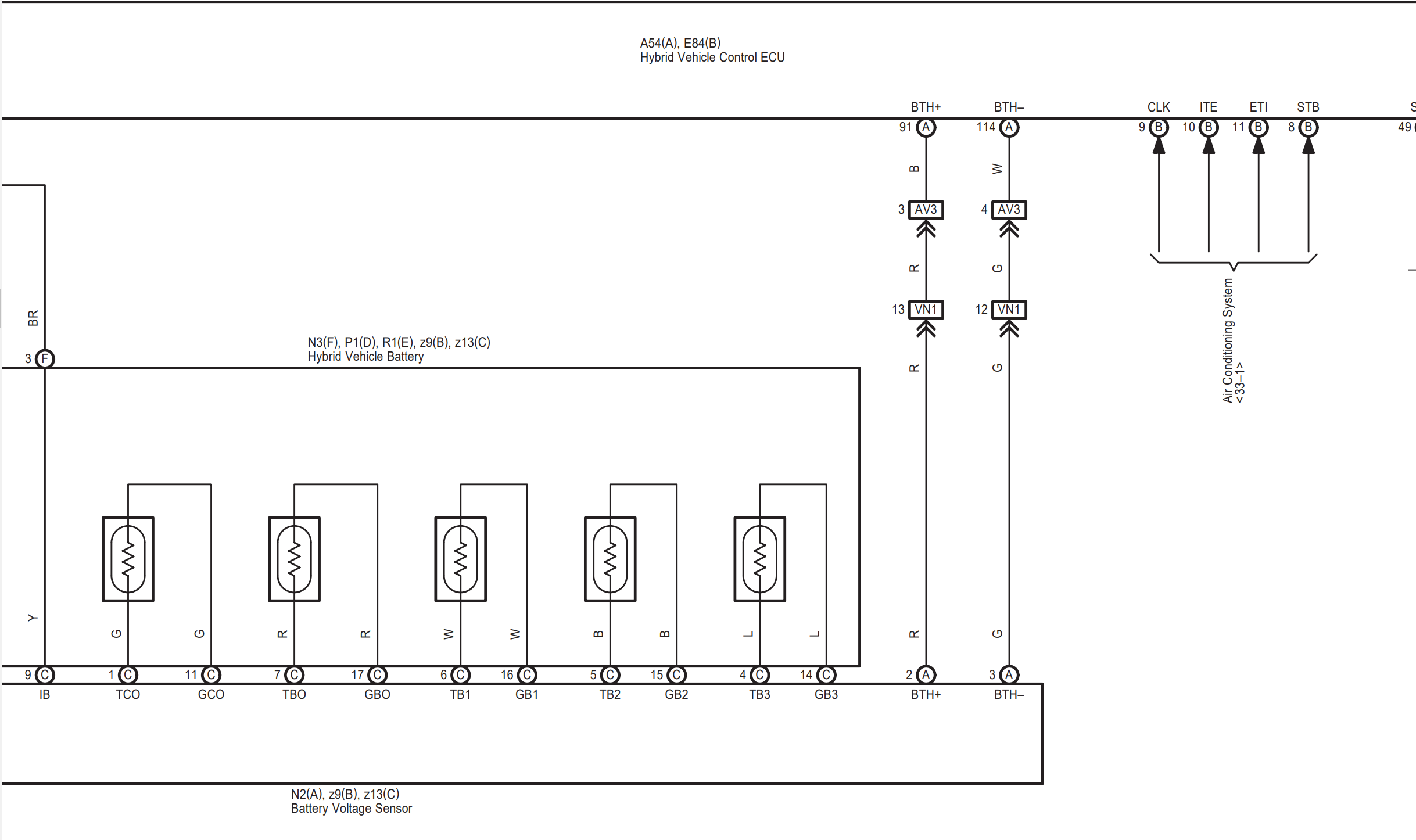

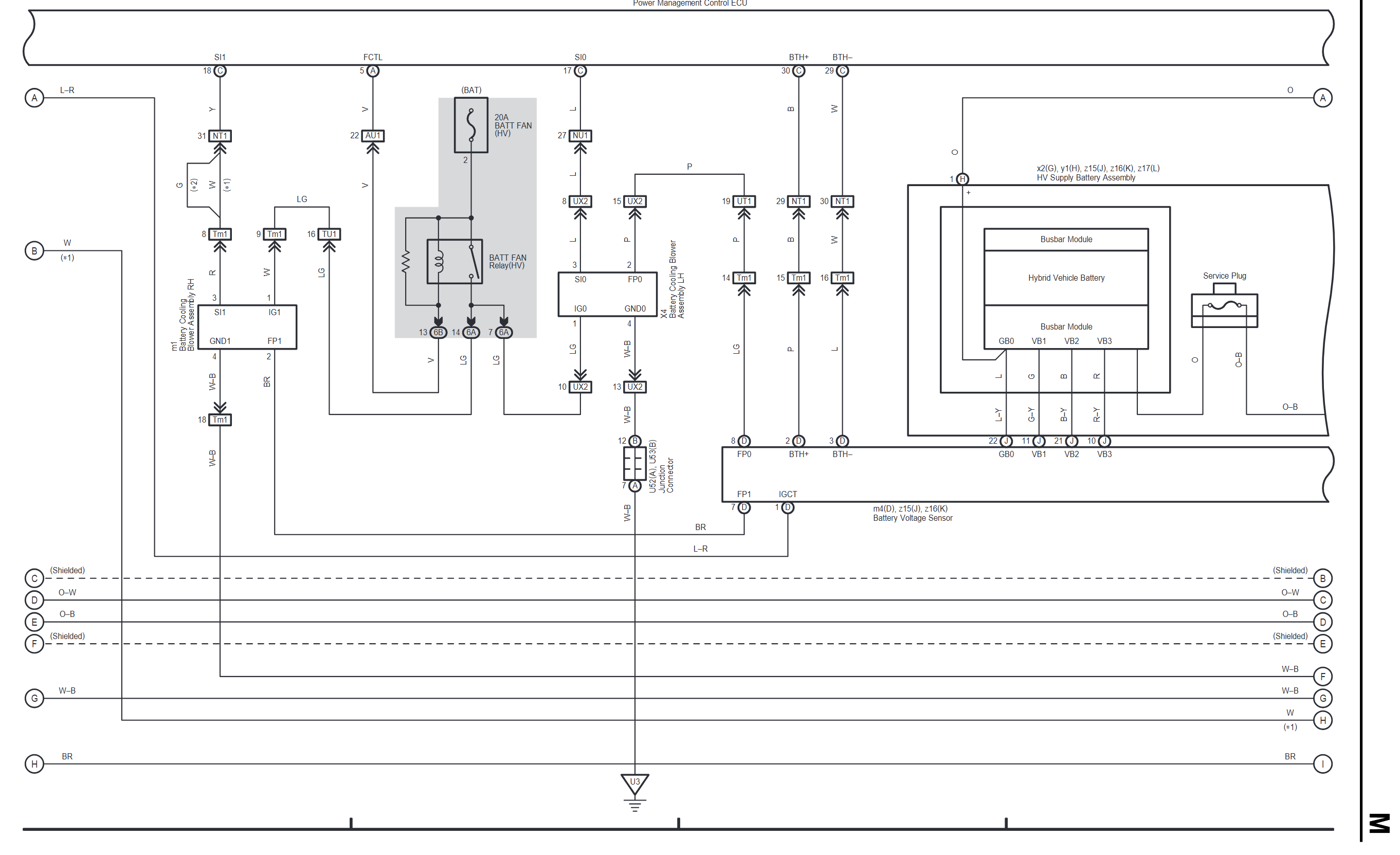

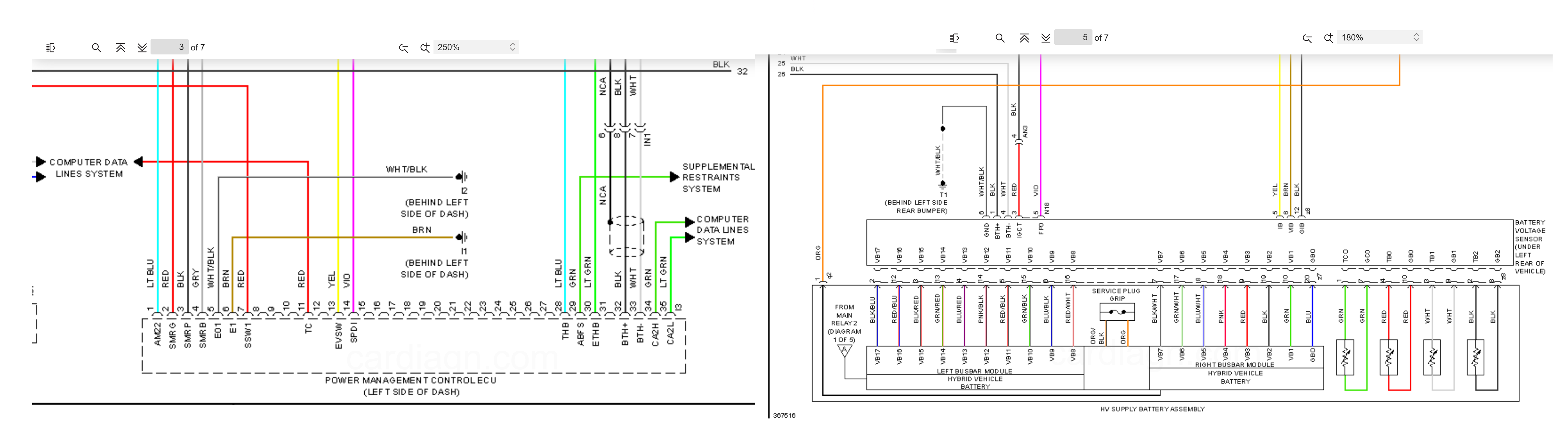

Abstract: The goal of this project is pretty clear, keeping the hybrid a hybrid, but swapping to bigger higher voltage batteries. 3 outcomes become possible:
1. upgrading existing toyota/lexus hybrids from NIMH to lithium and increasing the usage of the electric system for high MPG in mixed use mode.
2. enabling 30 to 50 miles( or more depending on the battery installed) of pure electric driving.
3. swap the hybrid motor and trans into other chassis, and keeping the hybrid system functional( this is the one i am most concerned with)
We know that the protocol is CSI and we can use a denso chip to communicate
if no one has the ability to setup logic sniffer on the bth line, i would like to know which logic sniffer will work best for this?
green x that Damien has seem to be the minimum?> but i only need 1 channel..
I have an stm bluebill, and a Arduino Due on the way... also i have a zombie inverter i purchased a month ago. my test bests are 07 Prius and 07 gs450h ( have both full cars, gs450h down for headgasket/studs. )
i have images of wiring diagrams but cant seem to upload yet. probably too fresh of a member :)
i plan to put the whole v6 and gs450h trans.... into my..... RV with a 116kwh lithium. we currently live in it on a 48v 15kwh battery and 3kw of solar on the rv and 3kw array on land next to it.
i could use 120 cells of lifepo4 6 cells per block would be 22v, so a step down or voltage clamp to bring the block voltages down to 18.5, and i may try this method on the prius... but this will keep the dc to dc and limit the electrical output to 30kw,,, from what i have read... will still be ok for increasing the overall MPG but doesnt allow for full electric travel....
the blue pill spitting data to the Hybrid CPU would possiblely over come these if the dc to dc converter is also by passed, but i dont think the toyota logic will like that? but it seems to work with zombie vcu that way?
Thoughts?
after I can upload imagines will make a separate thread.

So all you want to do is keep EV mode and replace the NMIH cells and corresponding monitoring circuit with Lithium cells and circuits to tell the Hybrid controller what to do?
Or are you proposing something else? As this will lock you into all the Lexus limits of the EV mode ect. Only difference being you have a stronger and larger battery to draw power from.
I would say the challenge then becomes keeping the Lexus ECU and Hybrid controller happy enough outside a Lexus GS450h

tom91 wrote: Fri Nov 08, 2024 5:08 pm So all you want to do is keep EV mode and replace the NMIH cells and corresponding monitoring circuit with Lithium cells and circuits to tell the Hybrid controller what to do?
that would suffice as a bare minimum giving us higher mpg until the battery depletes...
what i am hoping for is that within the data on bth there is information that will enable the highest kw possible, around 30kw. id like to use around 50kw max from the 116kwh lifepo4.
i could do this with 20 voltage dividers taking 22v down to 18.5v and that is the current path to victory... but skipping the deviders and having a logic board reading my battery then sending data on bth to the lexus ecu so that its happy.
in theory the zombie inverter with cuustom firmware would work, as it can talk csi

lastphaseofthis wrote: Fri Nov 08, 2024 6:42 pm data on bth
Literally what I said, replace the BMS (Battery Voltage Sensor is what Lexus call it) and spoof the BTH comms. You would need to figure out what sort of serial they are, it seems to be a one way datastream as there is only one pair. Best to scope it to see if it looks like MTH or HTM.
Getting more power might not be possible due to firmware limits in the Hybrid Controller or Limits in the Inverter. Where do you get the 50kW from or idea it would be possible?

50kw is just the desire. i guess the thought was if there was someway of running the toyota ecu without the buck converter. you have to by pass it for the zombie, but the zombie still talks to the regular firmware from toyota inside the hybird controller. so thats why i think by passing the dc dc to unlock more then 30kw is possible
the heart of my question is this
and i'll add can the zombie inverter be used as a sniffer? is there a way to see the data coming in on the lines? i could just wire mth pair to the bth pair and read it> or maybe just get the ciricut going from the original snifffing thread.

lastphaseofthis wrote: Fri Nov 08, 2024 7:03 pm but the zombie still talks to the regular firmware from toyota inside the hybird controller
No. It talks direct to the inverter. That is the key bit of info you are missing.

ah ha! that is what i am missing so behind the 30kw dc dc it will have to be.
Woodfie wrote: Thu Jun 13, 2024 3:50 am Hi, this may give some insight
operating a factory Gs450h, with 98 Lipo4, switched parallel to the Nimh 288v, judicially when voltages are acceptably matched.
The Boost converter limits the available power to 37kw.
This is a bit low for some driving circumstances , maybe 5%. . Stratagem was to avoid percieved problems like steep hill starts, etc.
Have operated in this mode for many months as a test program, when gathering some idea if how it all works, and it worked well for me. Have some ideas to increase the usability, on the project list..much to learn..
For simplicity follow the advice above.
i found this with some more digging around and seems like a back up idea if i cant get voltage converters i have coming to play nicely...

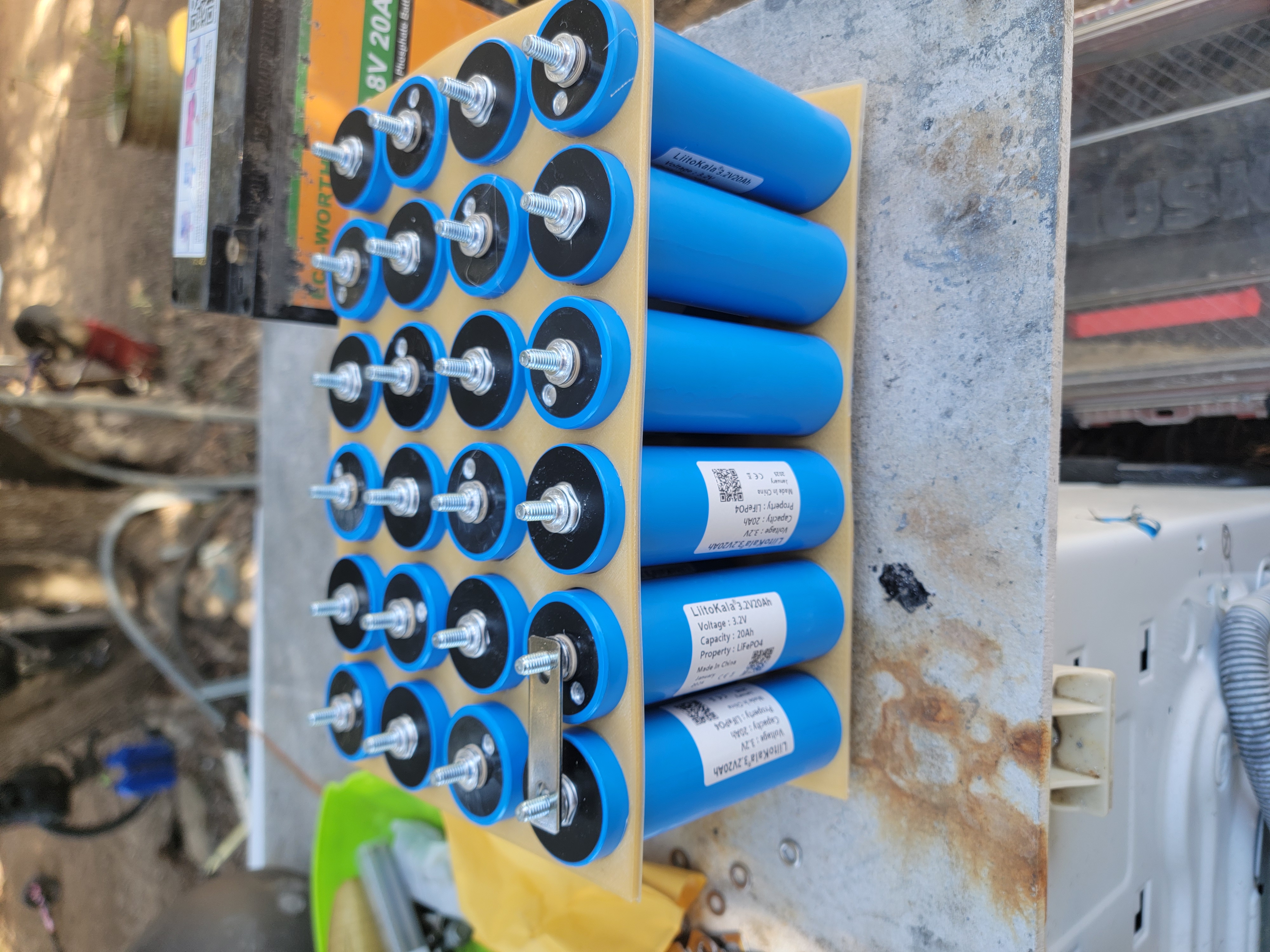

so 6 lifepo4 cells at 3.5v limited by the bms in to each voltage block starting at 21v and ending at 15v if cells taken down to 2.5v. likely only taken down to 3.0 and 18v pet block. and the ecu is still in used and working back at original voltages.

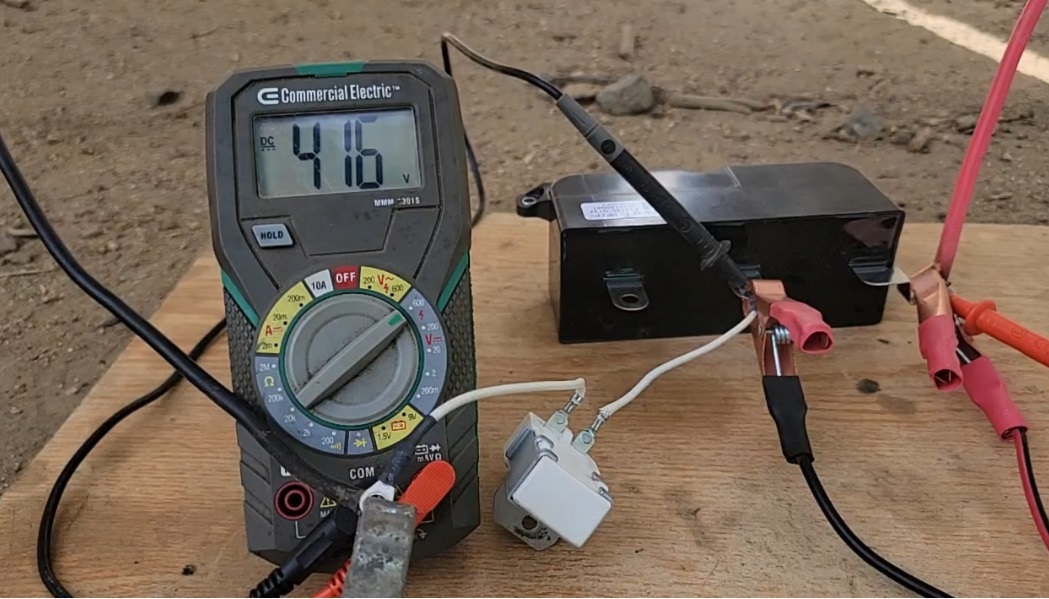

so i took my solar array and wired all 12 panels together and hooked them up, charged up the 288v cap that is part of the buck/ boost on top of the gs450h inverter.
it was 385v so i added another panel and reached:
so 120 lifepo4 sells will make 420v at 3.5v per cell, but i can charge to 3.49 per cell and it will be well within what i have tested here today.
the next test will be adding 60v to the factory battery and hitting the whole inverter assembly with 420v and seeing if the igbts can handle it, as well as the coils for the inverter. i bough a spare inverter to test the boost buck voltage handling ability, so this test cost me 200. but i didnt fry anything yet so i have a good spare still

my LiitoKala 20ah have arrived, now i will build maybe a 70s (5 cells per block) first, but may just shoot for the 84 pack with 6 cells per block.
this is 24s for my gokart that pulls 100a, exactly there rated max.
the ford fusion cells were my first experience with bolting cells together. heres me on a sailboat.
https://youtube.com/clip/UgkxDyPee2OgB_ ... Qbx98kzKfe

From memory the white and black pairs were the serial comms cables MTH - and +, HTM - and + etc.

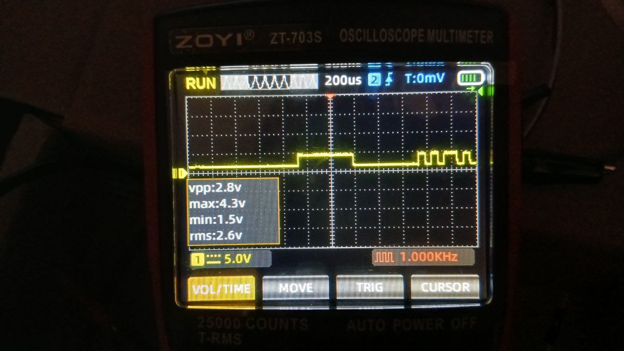

A slight bump on the road to success. bth- is stuck at low and doesn't move. Using pin 10 or 11 as GND. Pins 2 and 3 cause DTC and engine+fans turn on.

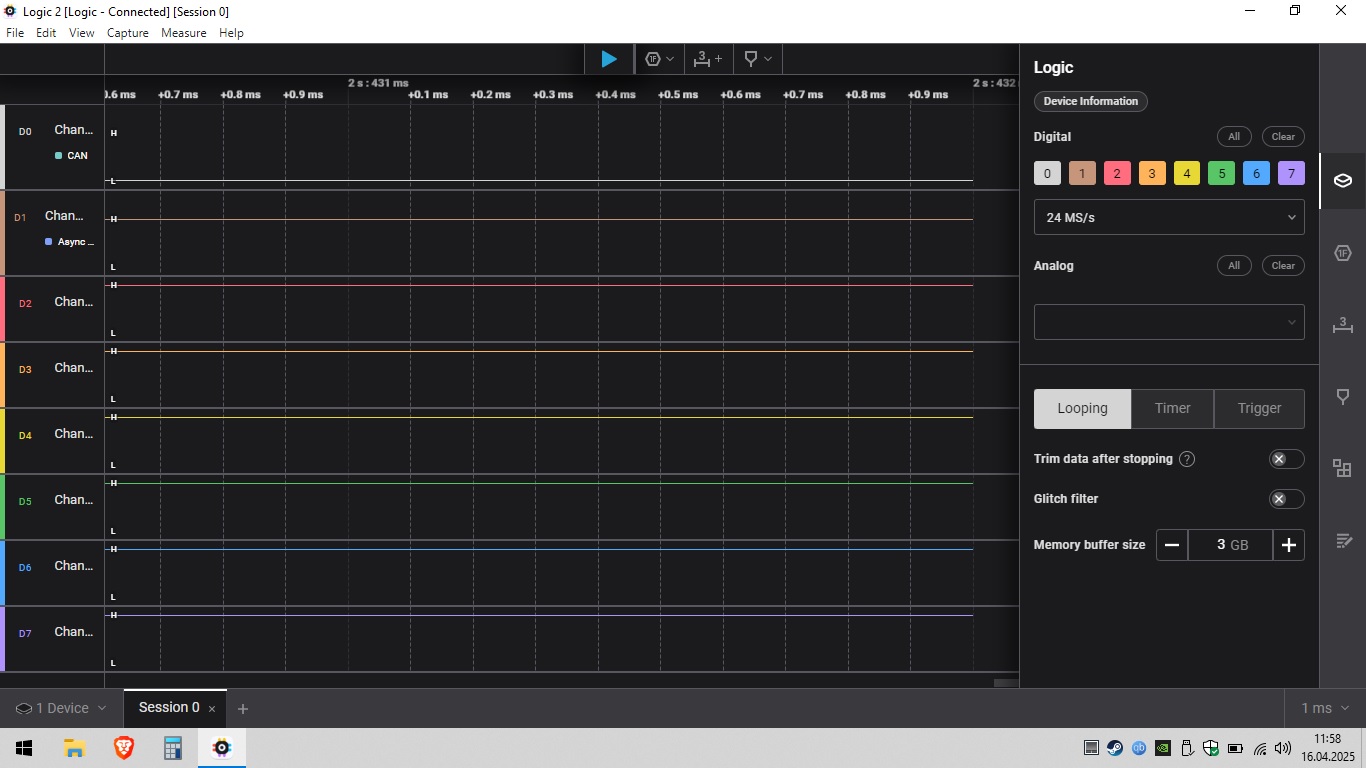

New logic analyzer arrived and worked! Here's the data again. captured by Saleae Logic 2.
Observations-
-when one side transmits, other one is silent.(with a slight overlap)
-Message time-length differs.
-message terminates at a same bit value on both channels - high state
-In an exported binary bit-stream file, when one side is "listening", amount of bit flips is always the same. Either even or odd. It depends if common high signal/1 bit value is taken into account. This would suggest a "Parity bit".
-It can't be a baud rate bound communication because I couldn't find a baud rate that would fit everywhere (in UART). There are always some messages out of sync.
-Found out that i2c works differently(without baud rate) but it gives NACK in all configurations. scl and sda switched and shifted/unshifted. SMBus in saeae logic 2 outputs NACK too.
Start Condition: The SDA line switches from a high voltage level to a low voltage level before the SCL line switches from high to low.
Stop Condition: The SDA line switches from a low voltage level to a high voltage level after the SCL line switches from low to high.
-This would be a point for an i2c protocol. But then when looking at google images of SCL, it doesn't make sense again, as SCL oscillates like a clock there but does not in the car.
-Turns out its RS-XXX. Differential signal. So i have to invert second signal to show the same data on both lines.
NEXT STEP: 1) Find out which protocols use RS standard. 2) Try again to record data without glitches because PulseView counts them as start bits. Ps. End of recording is glitch free. Can work with that. 3) unplug data lines and record inverter and battery side separately. Knowing if its uni or bidirectional transmission should help with finding out probable protocols. Figuring out how to remove pins will be difficult. 3) Figure out if it's even possible to get any true data out of such signal when one signal looks like a narrowed and reversed version of the other signal.
- Given differential signaling and 2 wire configuration, it must be RS-485 @ half-duplex. But why 150 ohm when car is off? Every picture online shows 120 ohm resistors at both ends of the wire. Have to check it when car is on... And then the other thing is that worrying about physical interface data-wise. Sure, It could be the cause of overlapping bytes but all it proves is that my data capturing device is flawed and therefore can't gather true/reliable data. I could wybebeszyć battery ecu and sample raw rx/tx lines, but only if i can't find a reliable way to sample RS-485 signal.
/alternatively buy rs-485 dongle for Arduino and check if gathered data reproduces overlapping byte state error. send data from arduino to rs485 i mean/
/maybe rs485 to uart/ttl dongle when connected to the signals could passively output signals viable for my crappy logic analyzers. Worth giving a try before gutting the car/
What bothers me is both channels aren't equally reversed in time. One signal is faster than the other. Gotta test it with an oscilloscope.
