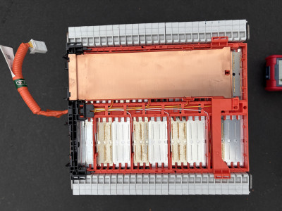

Hi everyone,
After some very frustrating BMS issues, I discovered that the terminal of one of my cells had been pulled off of the cell stack.
Here is the module with the cover off

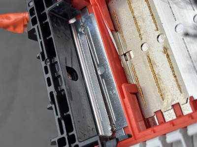

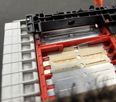

Here is the terminal in question
I have a traction wire attached to this terminal that's pulling away from the module. I assume this force, along with the vibration of the car broke off the weld. Although for factory welds these seem pretty bad, right? Anyways, I need a way to secure this terminal back in place. If I wanted to weld it, I'm not sure what material it is. Even if I had that information, I can't heat this area at all because it's making direct contact with a cell. By my reasoning, the problem is as stands:
I need to reattach and secure this terminal so its backside is making full contact with the cell stack. I need to find a way to do so without applying any heat. Does anyone have any ideas?

ekohn04 wrote: Fri Nov 22, 2024 8:32 pm Hi everyone,
How thick is the contact bracket material?
If it is thin enough you could try spot welding? And immediately after such weld you would need to cool the surface down...
I imagine the full width of the battery module is out of the size for laser chamber box?
Do you know someone which has access to friction stir welding machine?
uhi22

If the area where the red spacers are below would have sufficient space, a row of small screws (like 2mm diameter) could press the things together.

Welding thick to thin can be very challenging.
Time and effort involved it might be cheaper to find a new stack section.
Then silicone? some spots to help eliminate the vibration for the rest of the modules.

uhi22 wrote: Sat Nov 23, 2024 8:52 am If the area where the red spacers are below would have sufficient space, a row of small screws (like 2mm diameter) could press the things together.
This is a really good idea, something I didn't even notice. I'm worried about depth with this approach, the spacer might not go all the way in between the cells. I will have to find some way to test how deep I can go without risking puncturing the cell.
jrbe wrote: Sat Nov 23, 2024 11:27 am Time and effort involved it might be cheaper to find a new stack section.
Stack section isn't possible as these are laser welded together. A new module would be the best idea, but I can't find anyone selling individual leaf modules for anything other than outrageous prices. If anyone knows where to procure a module that would be fantastic.

Like i said... if you look closely you will notice there is aluminum material for last contact. Looks like + terminal as negative is usually copper.
In your case you could try to dissasemble the plastic under the contact and take it out with intent to put small alu plate under contact and another plate/angle above. You could then make 2 or 3 holes through alu plates and contact sheet. CAREFULLY!
Then use M5 bolts. Head from the underside which would fasten the upper alu angle so you can use the angled part as anchor to your terminal cable.
You will probably have to remove the red plastic to come underneath the terminal...
Another option would be using rivets and washers to fasten the termanal angle. Still you need to be really carefull when drilling. All debris needs to be vacuumed so not to cause damage later on...

Hm... i am thinking about this further...
Can you tell what kind of material is that contact made off? If it copper or nickel? You can check if it is nickel with a small magnet.
If it is nickel you can spot weld several nickel strips which you can use to anchor your main contact to.
Mind you you would need to spot weld a lot of nickel strips to get equivalent contact surface.
I recommend welding from 2 sides on the inside to make dual contacts and then spot weld that to a vertical copper sheet with appropriate holes for bolting....

arber333 wrote: Mon Dec 02, 2024 8:38 am You can check if it is nickel with a small magnet.
It looks like it's probably nickel plated copper, it's not magnetic. I was thinking it might be feasible to drill a series of divots in the part of the terminal that's pulled away from the cell stack to reduce the thickness in those areas, and then spot weld in those divots. That would hopefully give me the contact I'm looking for, and I can find other ways to secure the terminal to ensure the spot welds don't break. What do you think about this idea?
