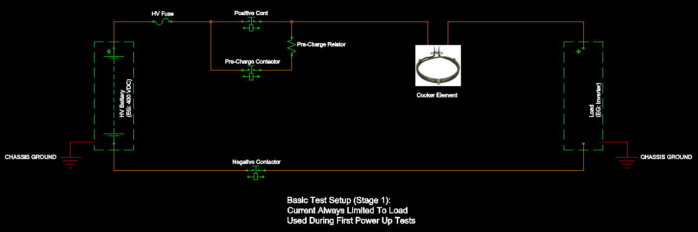

I have this setup right now and have tested at 40v. Next step I would like is to bench test with one of my 200v battery packs. Would I leave the cooker element in the circuit or would it be of no use at that voltage? Thanks!

The cooker element isn't going to do any current limiting like that, it needs to go inline.
Its purpose in testing is if there's some issue, reverse polarity, short circuit, etc, it'll limit the current that's able to flow. How you've got it wired the current will use the low resistance path through the fuse instead.
Is that fuse rated for 200v? A too low voltage rated fuse could blow and current continue to flow

Regarding the setup actually both ways don't make a lot of sense. Putting a 100A fuse in series with the cooker means it won't ever blow. Putting it in parallel means you can't manually interrupt plus the value is too large for testing. In his video Damien used an actual breaker I think rated 16 or 25A
So the plea: communicate friendly even when astonished

1. Limit the current draw when a fault occurs- this increases the likelihood of things surviving
2. Cause a drop in voltage when larger currents are draw - again this aids to the likelihood of things surviving
This is meant as a "did I not mess up" any wiring or settings step. You should always of course double/tripple check your wiring and settings before powering on any circuits. It is also strongly recommended to verify each step of the HV system being activated with actual measurements not just "I heard it click"
johu wrote: Thu Nov 28, 2024 12:15 pm Putting a 100A fuse in series with the cooker means it won't ever blow
Exactly, so making sure there is no catastrophic loss of voltage. Then again losing voltage when the motor is spinning underload would only be a catastrophic loss of voltage.

To maybe help the discussion, hoping a quick component layout might help. If this is incorrect or will only confuse things, let me know and I can edit or remove. If its helpful, I can add it to the wiki along with any suggested changes?

nkiernan wrote: Thu Nov 28, 2024 12:50 pm hoping a quick component layout might help
These are correct. I personally would not recommend the second layout for anything but development work, ensuring the inverter is not set to opening contactors under a fault condition is key in all setups.
Also after removing the element and "deploying" the setup for driving ensure the inverter is configured correctly for not fully dropping out contactors on a fault.
DC breakers expensive when sized right for the job.

Damien had the cooker element in parallel with the fuse so if the fuse blew there was still a path for the generator energy to go back into the battery. ..so it doesn't blow the inverter.
This leaves a potential short fed through the cooker element. It also leaves high voltage exposed and a potential high heat source as well. Just all things to be aware of and plan for.
You can use a cooker element in series at lower power levels to help "bring up" the system. If there's an issue the heater element will get hot instead of a dead short blowing a fuse or worse.
The high voltage and high heat sources will bring in their own potential dangers. Be aware of what can happen before you start. Not forgetting the high voltage can be tough if the element gets hot. Try not to panic, you have some time to resolve / shut it down.
These heater elements are .7k-5kw typically, so realize if you start putting a bunch of energy into the motor they may start to get hot even when things are ok.
