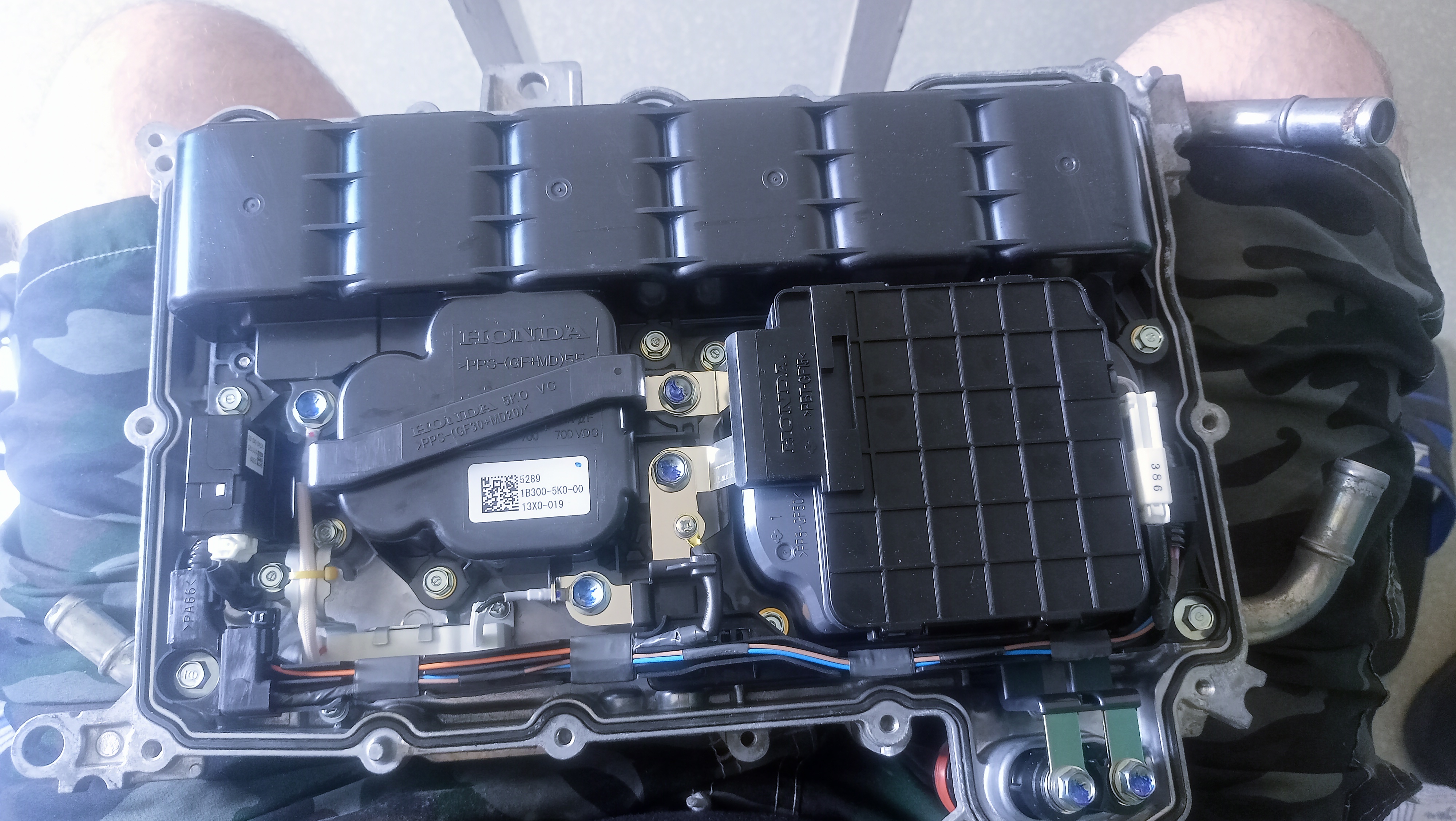

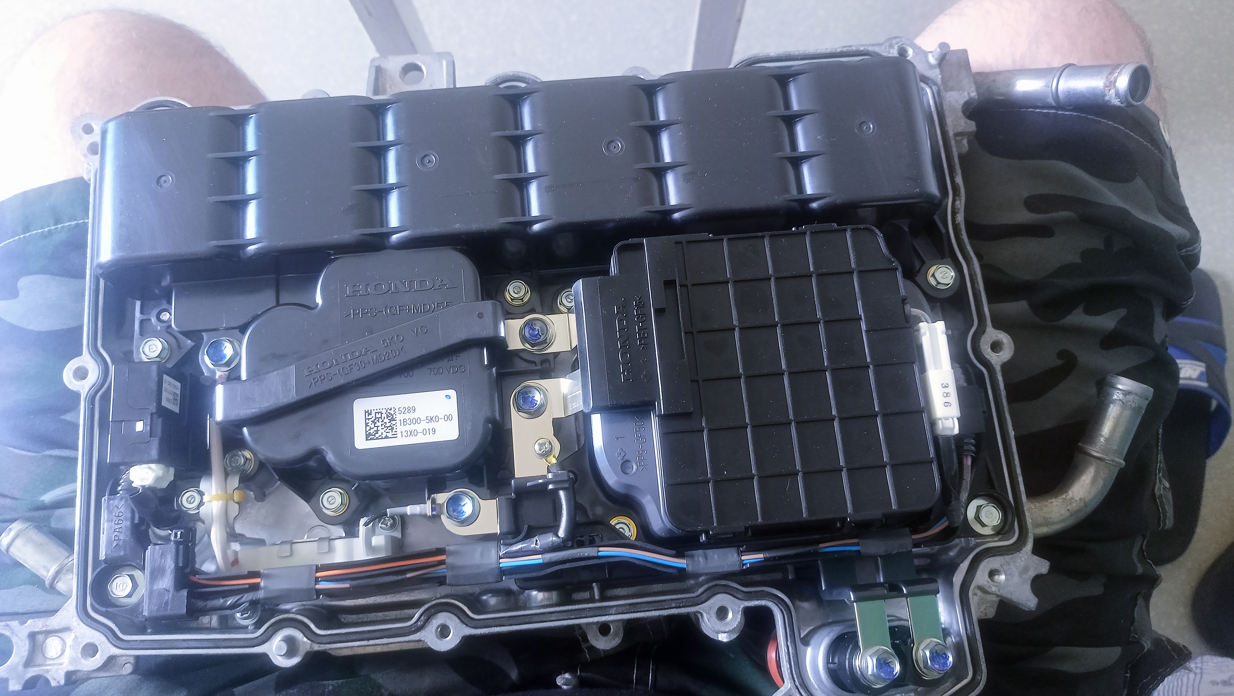

Good afternoon, I'm I'm a newbie here, maybe someone will find the information on the inverter useful Honda Accord and its disassembly

johu wrote: Mon Dec 02, 2024 7:03 pm Cool, another Honda, so not this one? viewtopic.php?t=3545

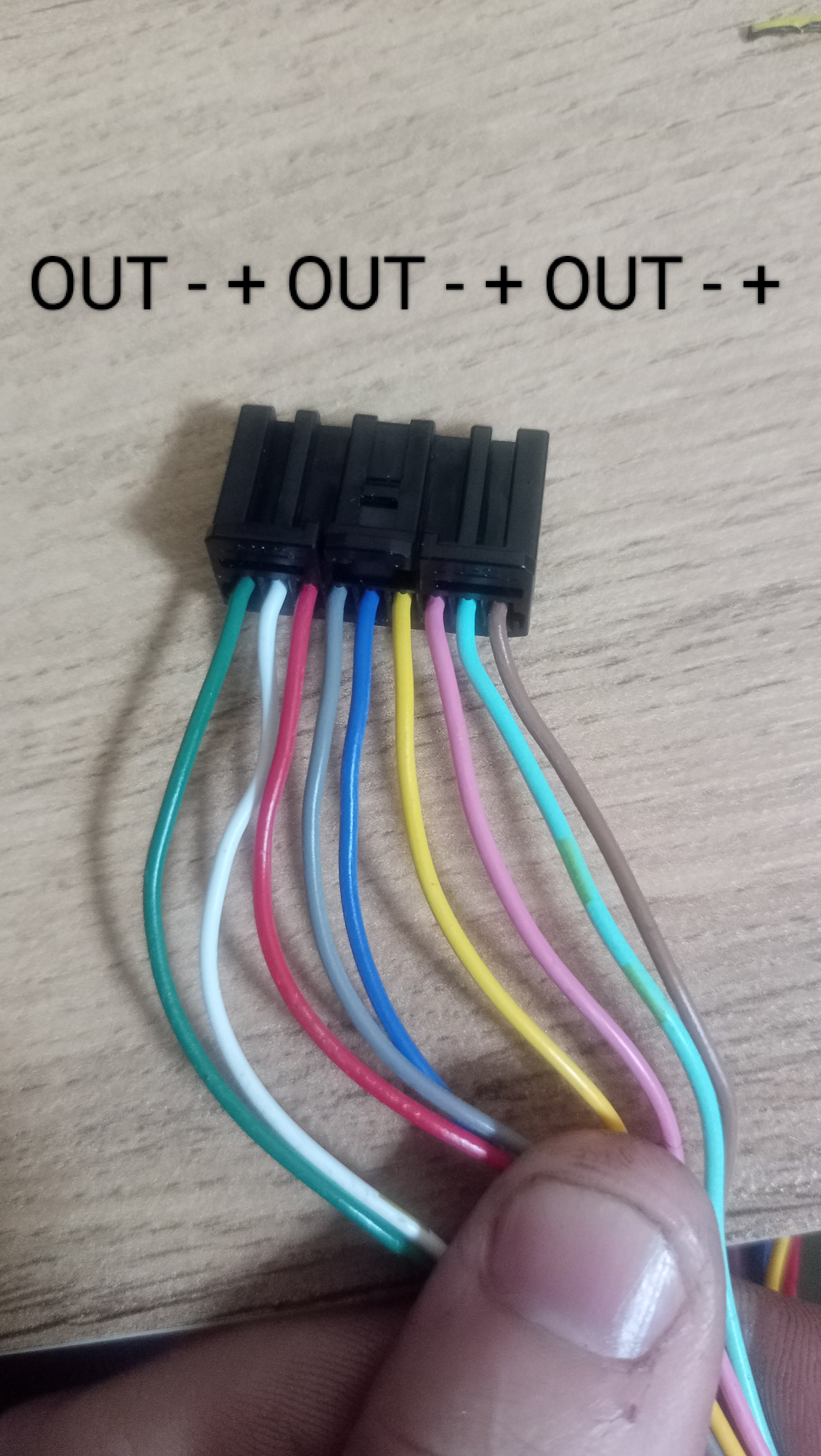

No, this is a Honda Accord inverter, another author has a Honda Civic inverter, But I have an inverter from a Honda Civic, Insight (Jazz and Fit), Honda Accord inverter current sensors have a power supply of 4.90Volt
Ryclanmoto
Posts: 29
Joined: Wed Mar 08, 2023 9:37 am
Has thanked: 9 times
Been thanked: 6 times
Re: Disassembling the inverter honda accord
Post by Ryclanmoto »

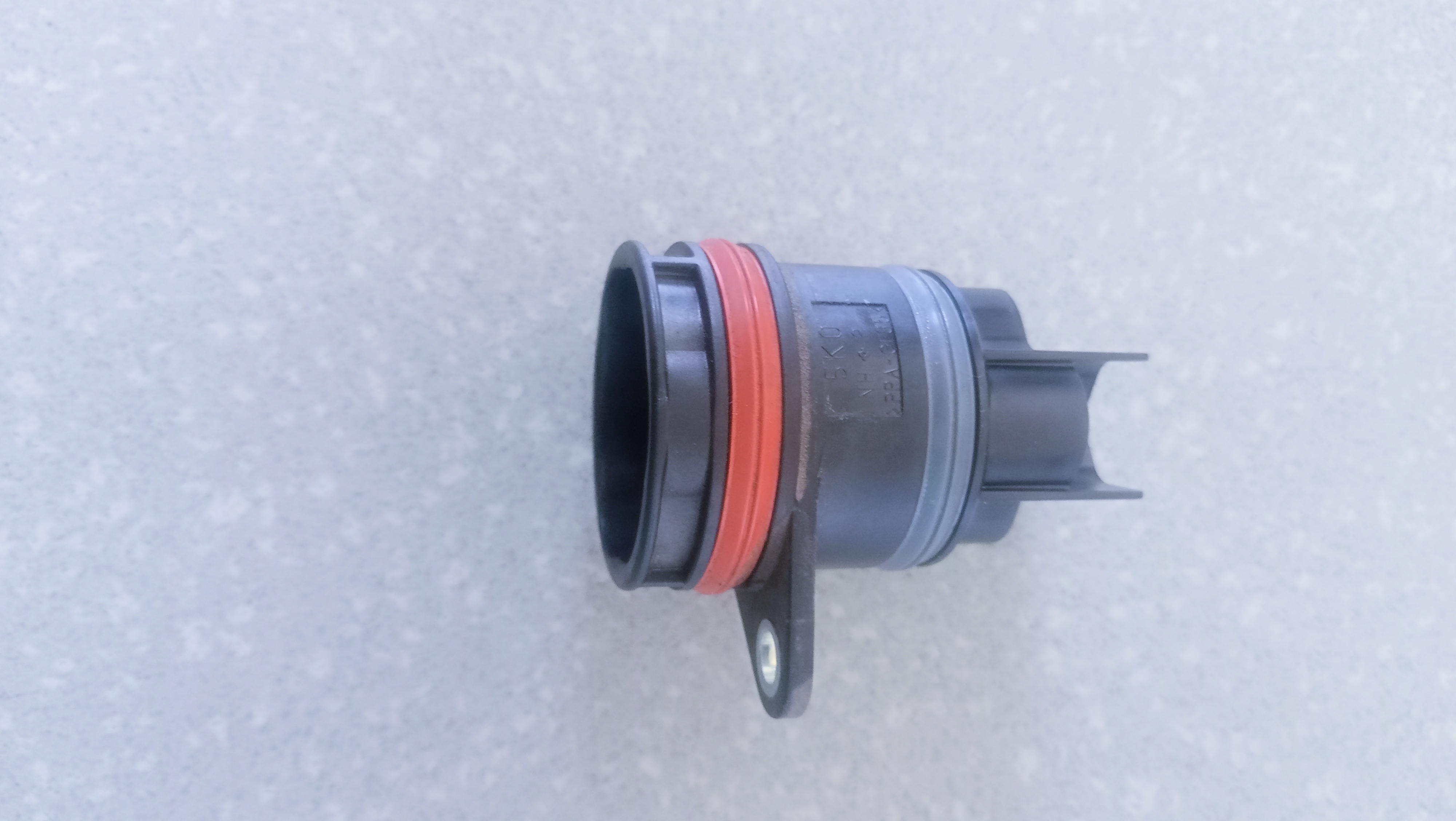

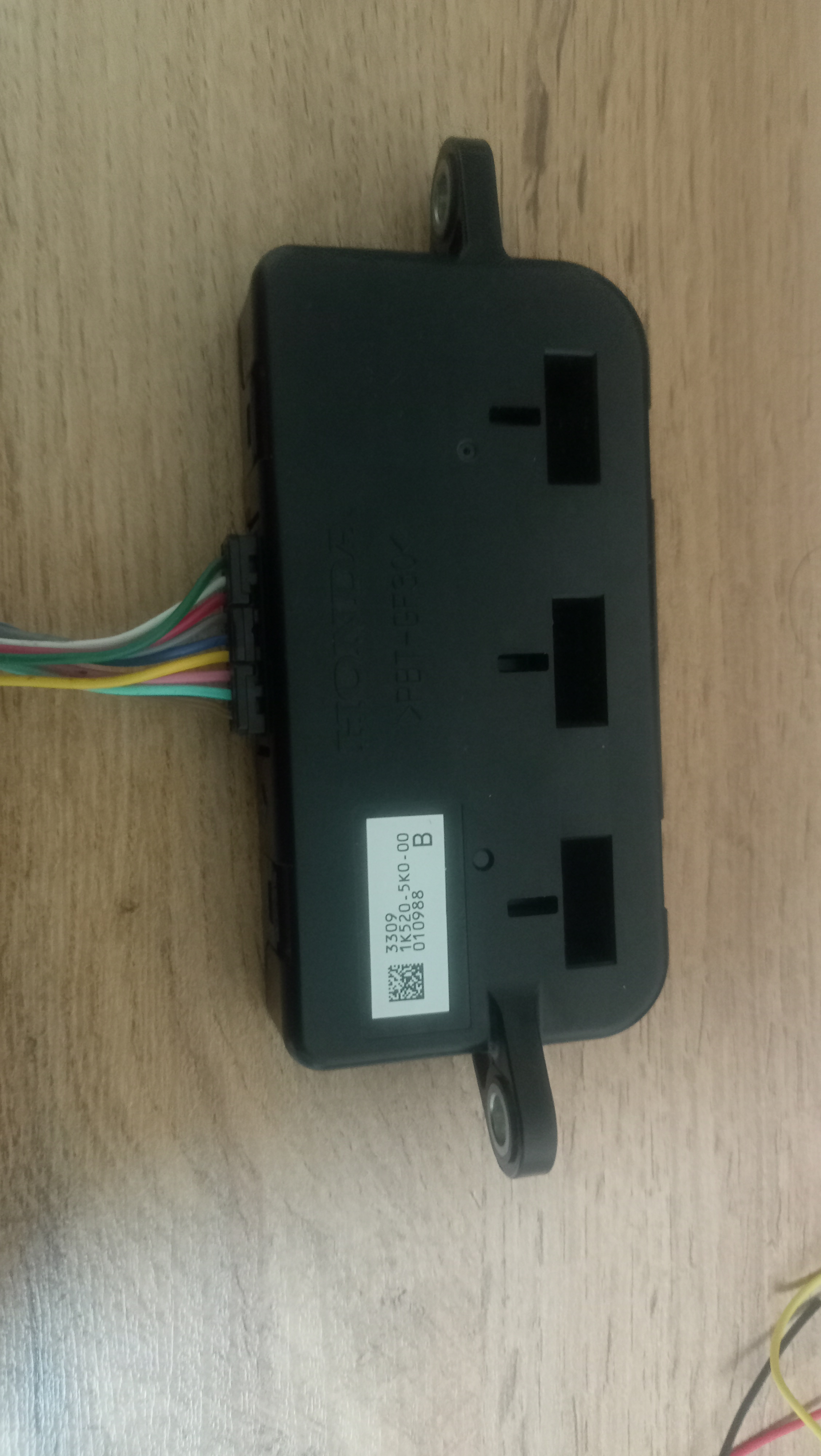

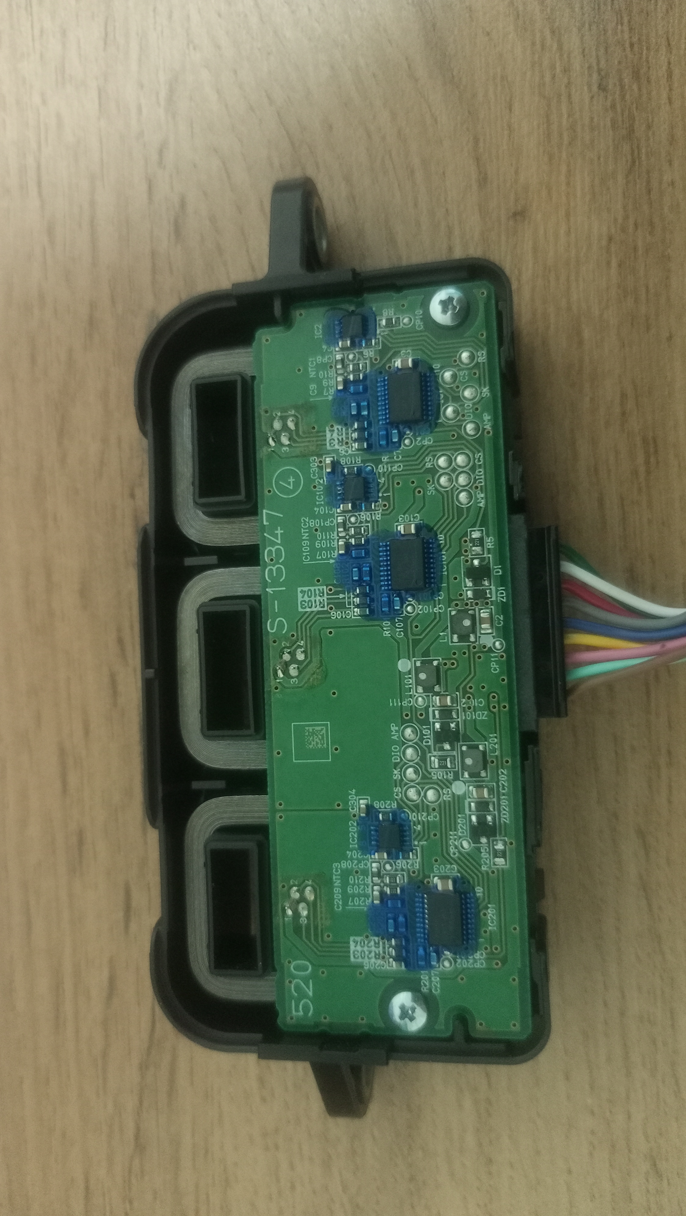

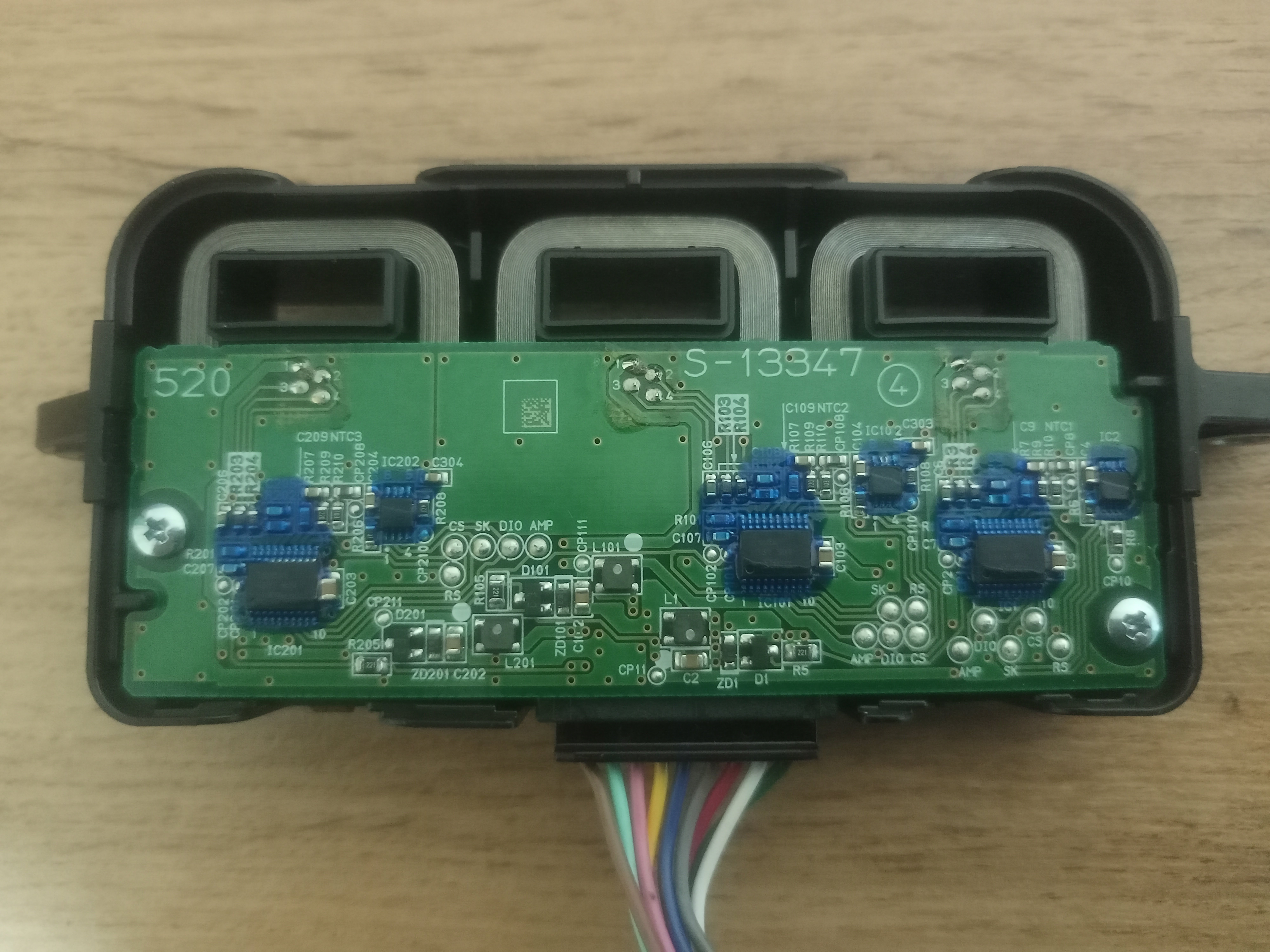

The current sensor has a pinout
Green ,Gray, pink - Signal output
White, blue, light green GND
Red, yellow, Brown VCC
I marked them in the
Current sensor from inside]

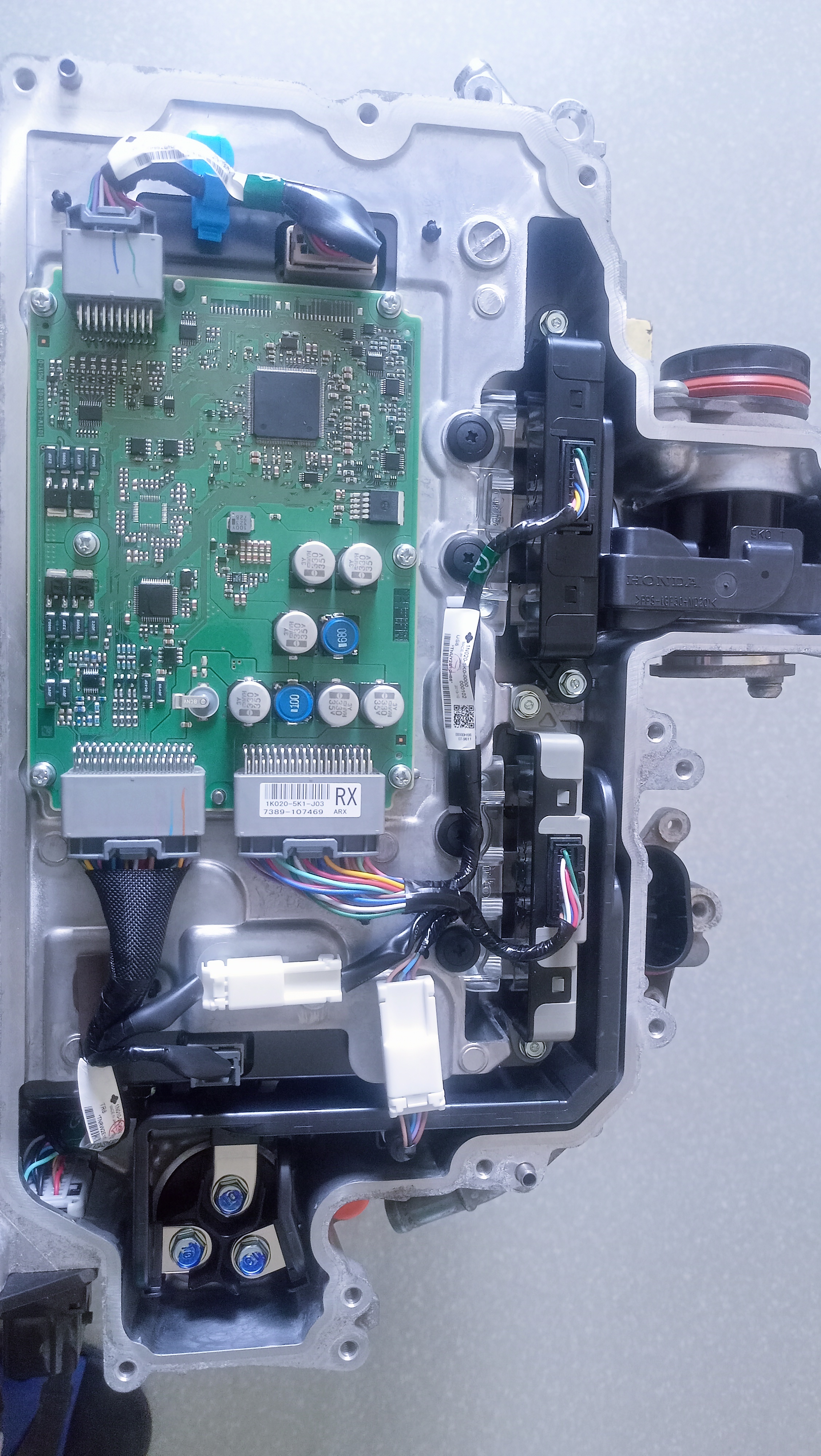

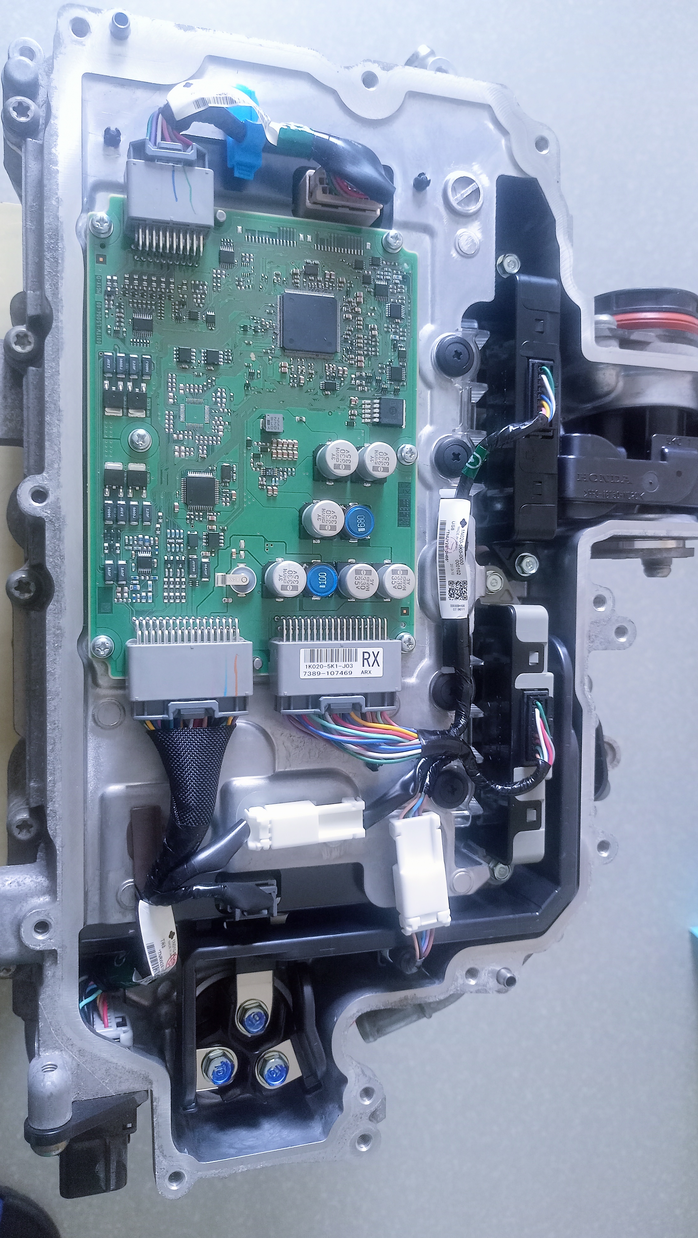

Post by hurricos »
It's also this one: viewtopic.php?p=25763#p25763
Based on the silkscreen, OP also has a 2014-2018? HAH inverter, which is Honda's first generation PCU, documented in some depth here: https://git.laboratoryb.org/hurricos/Cl ... System.pdf

hurricos wrote: Tue Dec 03, 2024 11:56 pm It's also this one: viewtopic.php?p=25763#p25763

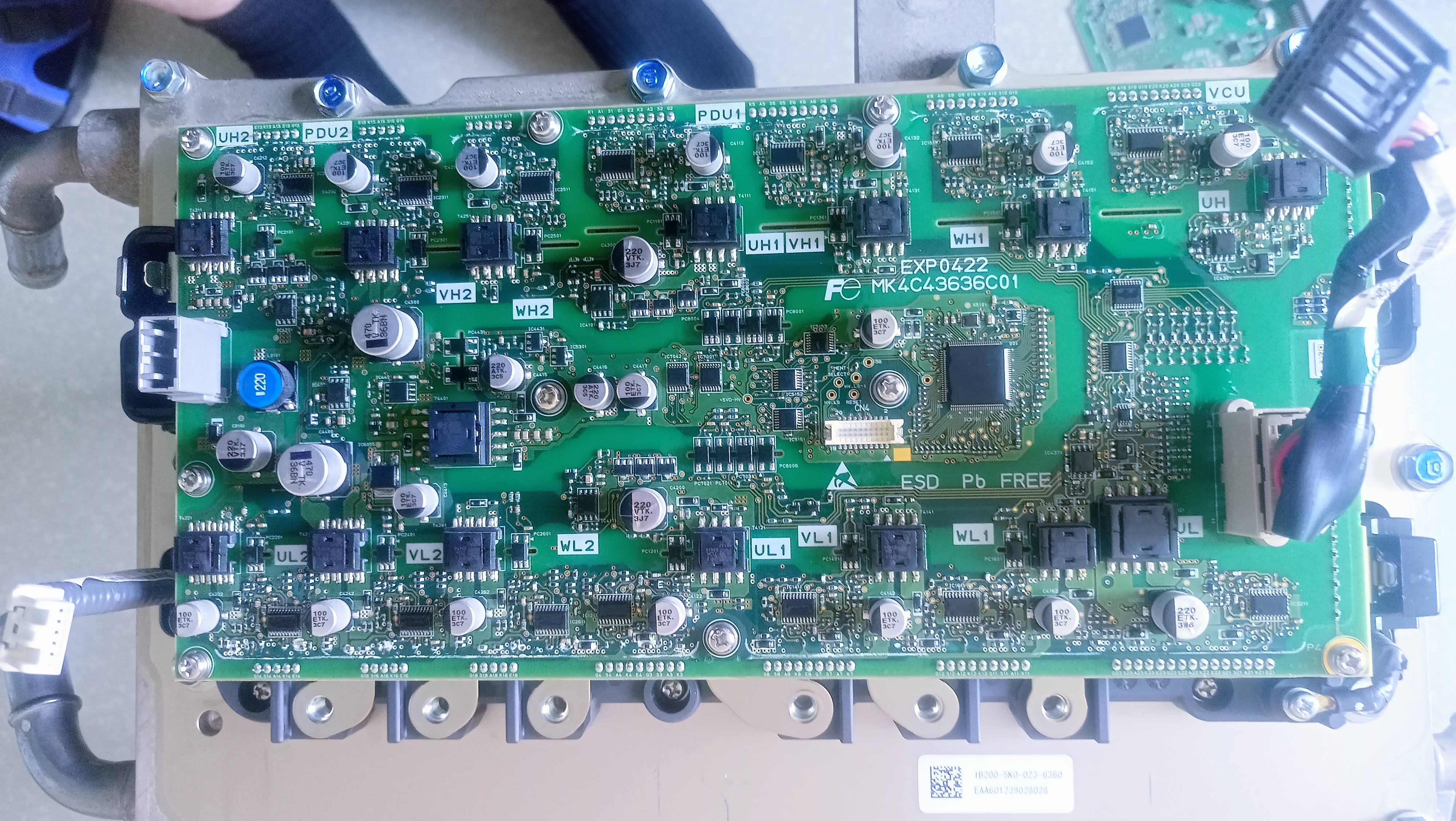

I wonder where I can find the marking of the PWM signals on it.
