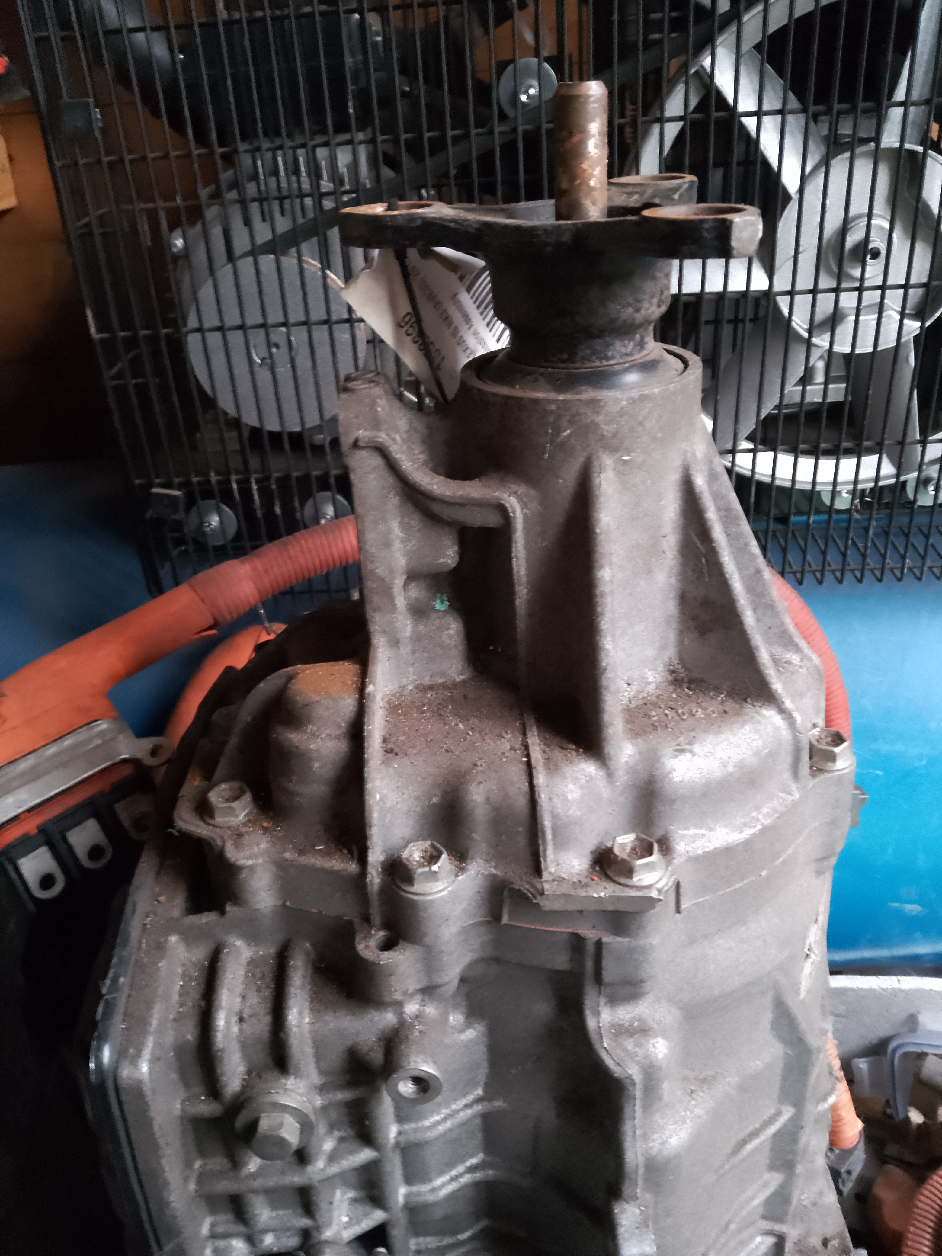

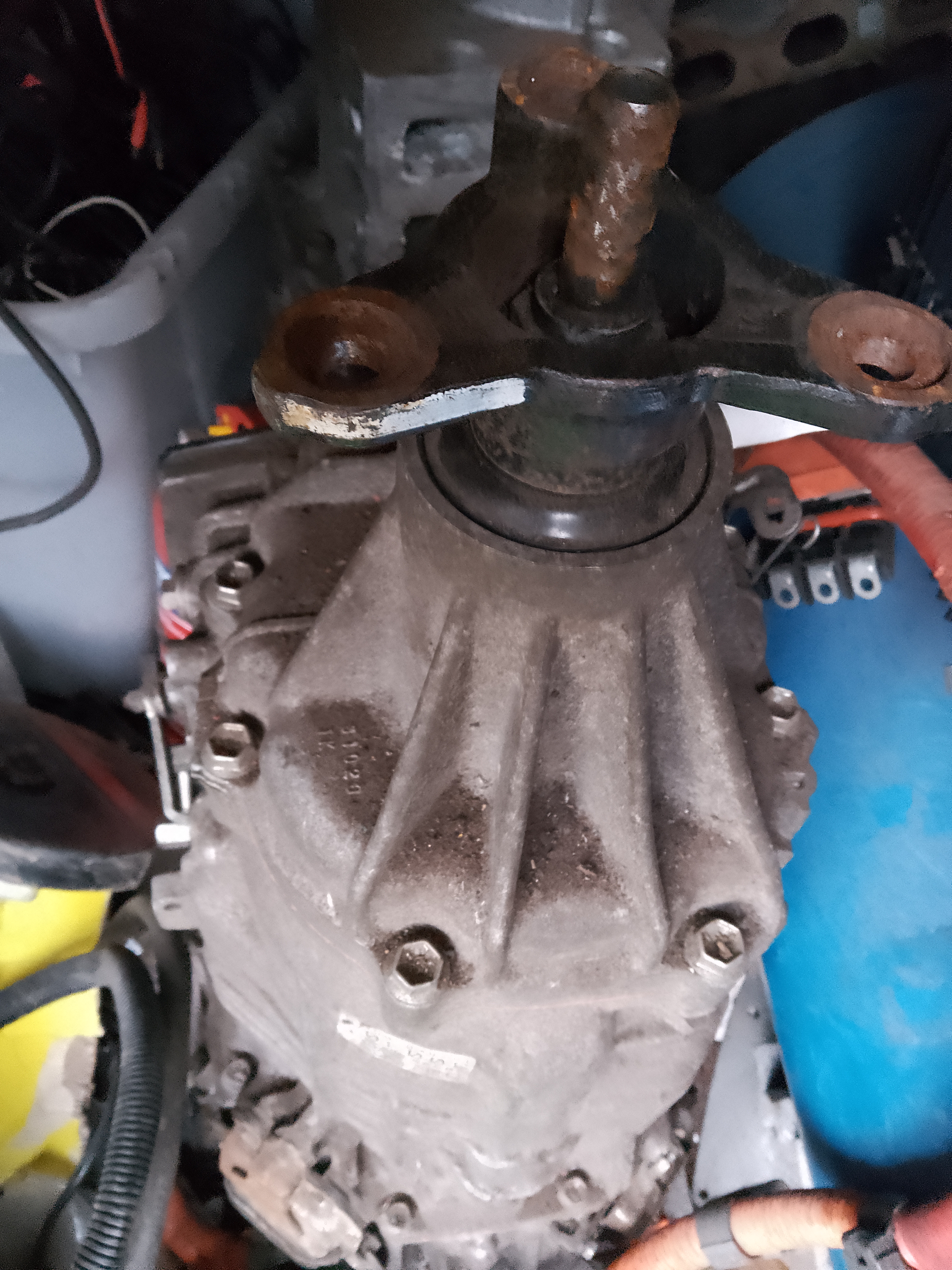

This my stock transmission (as with all good projects you have lots of spares of bits you might kill) now heres some pics of the lexi (sorry forgot to take pic of underside)...

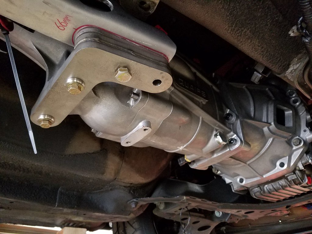

Well the bottom flange of the adapter should not be too hard... a little googling leads me to this pic (which os of a quaif sequential) the only way to not put the bolts on the bottom into bending (which is very bad) is to try and support the upper flange of the PPF, the only ideas i have had so far is to try and pick up on the bolts at the top by making some sort of bracket this would put the bolts into tension which isnt ideal but probably acceptable.
