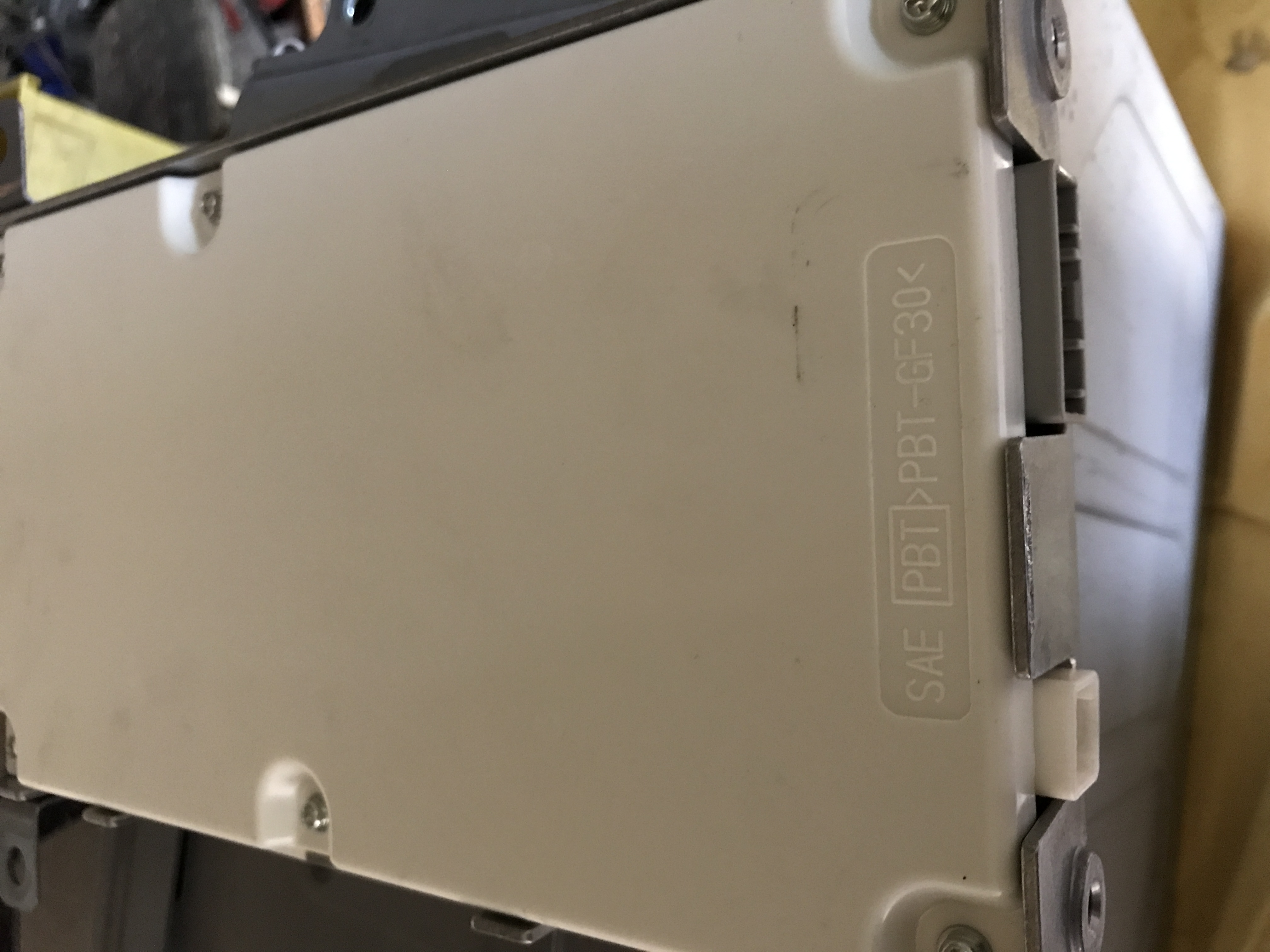

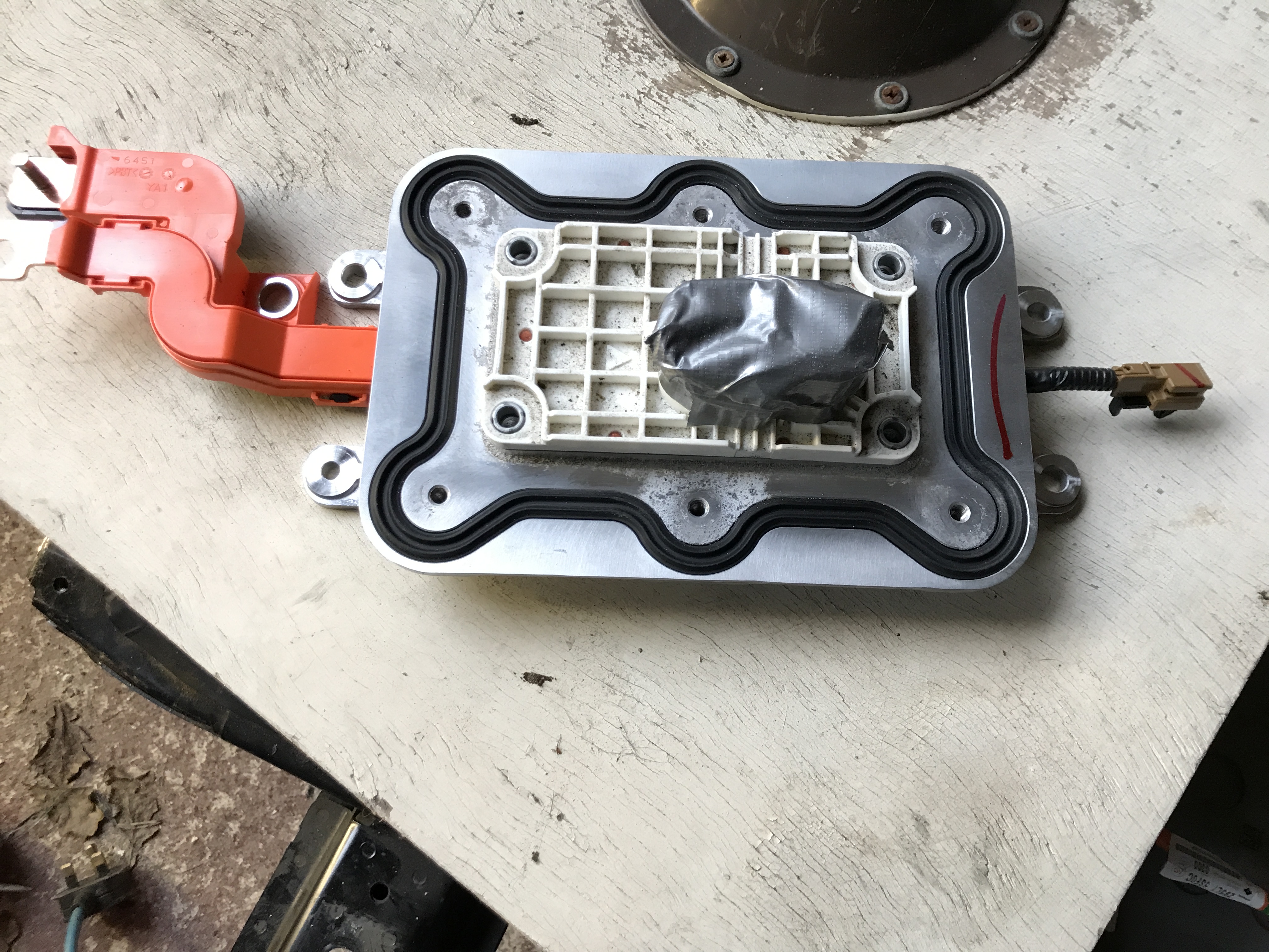

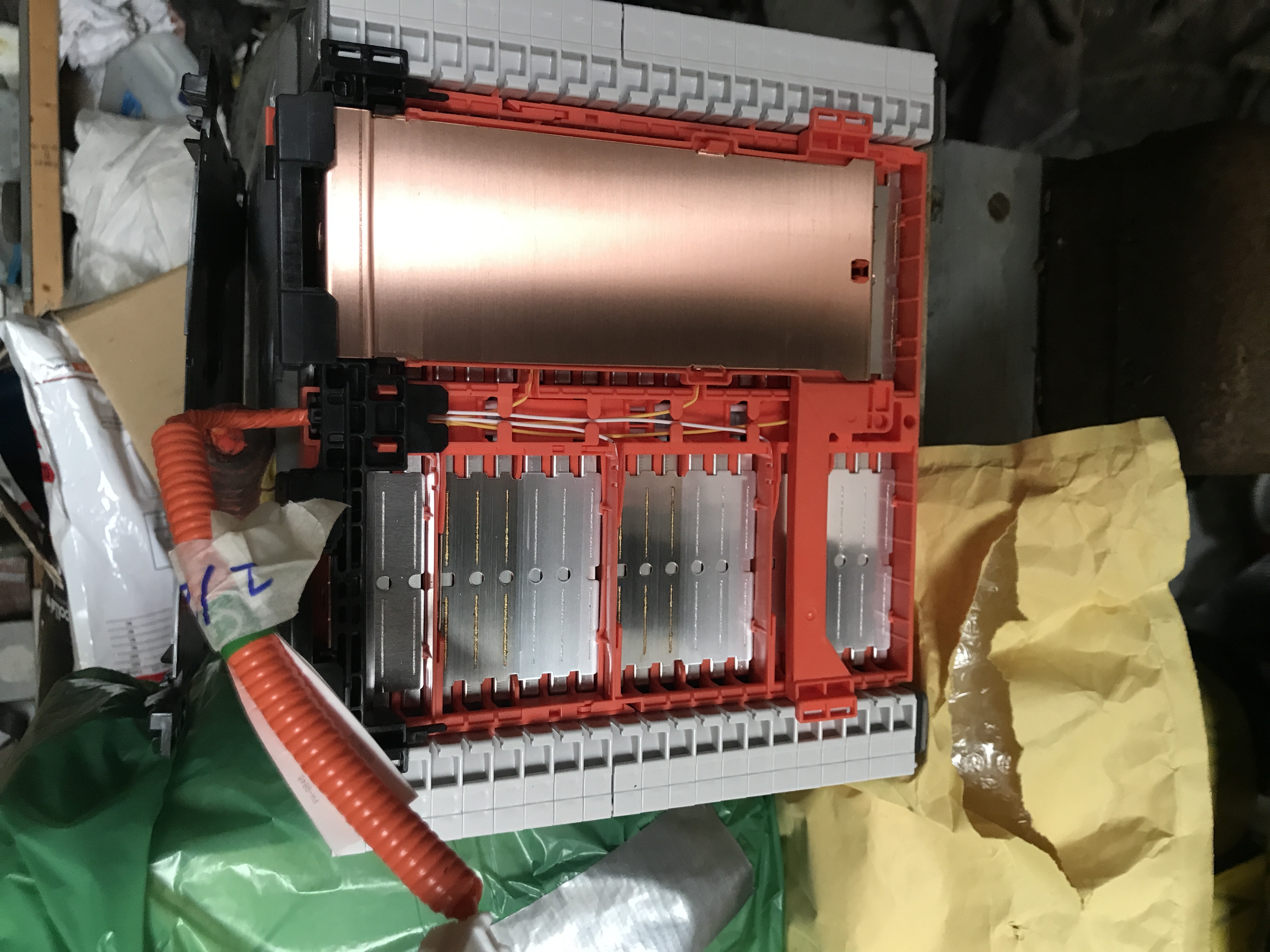

I have a UK 60kWh Leaf battery I’m taking apart for my project. Some details have been hard to be sure of so I will collate my own details here as I take it apart, plus add the other useful links I’ve come across. If there’s any questions I can answer while I work on it let me know.
For details of how the modules are numbered, this link answers…
viewtopic.php?t=5747
Don’t know exactly how accurate all the info is from this 2019 blurb, but the diagram of number of cells per different module stack may be useful.
https://insideevs.com/news/342009/here- ... ery-video/

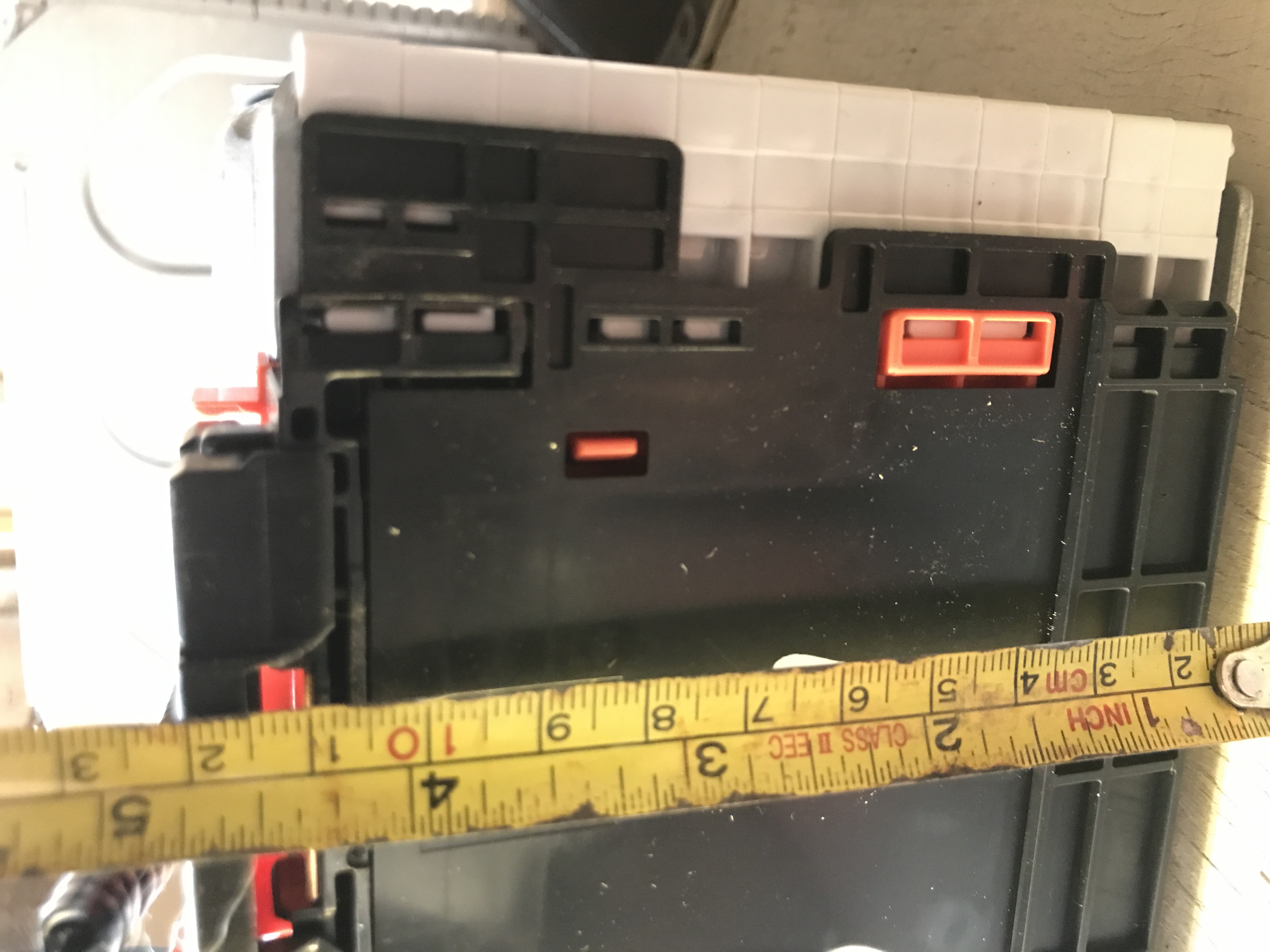

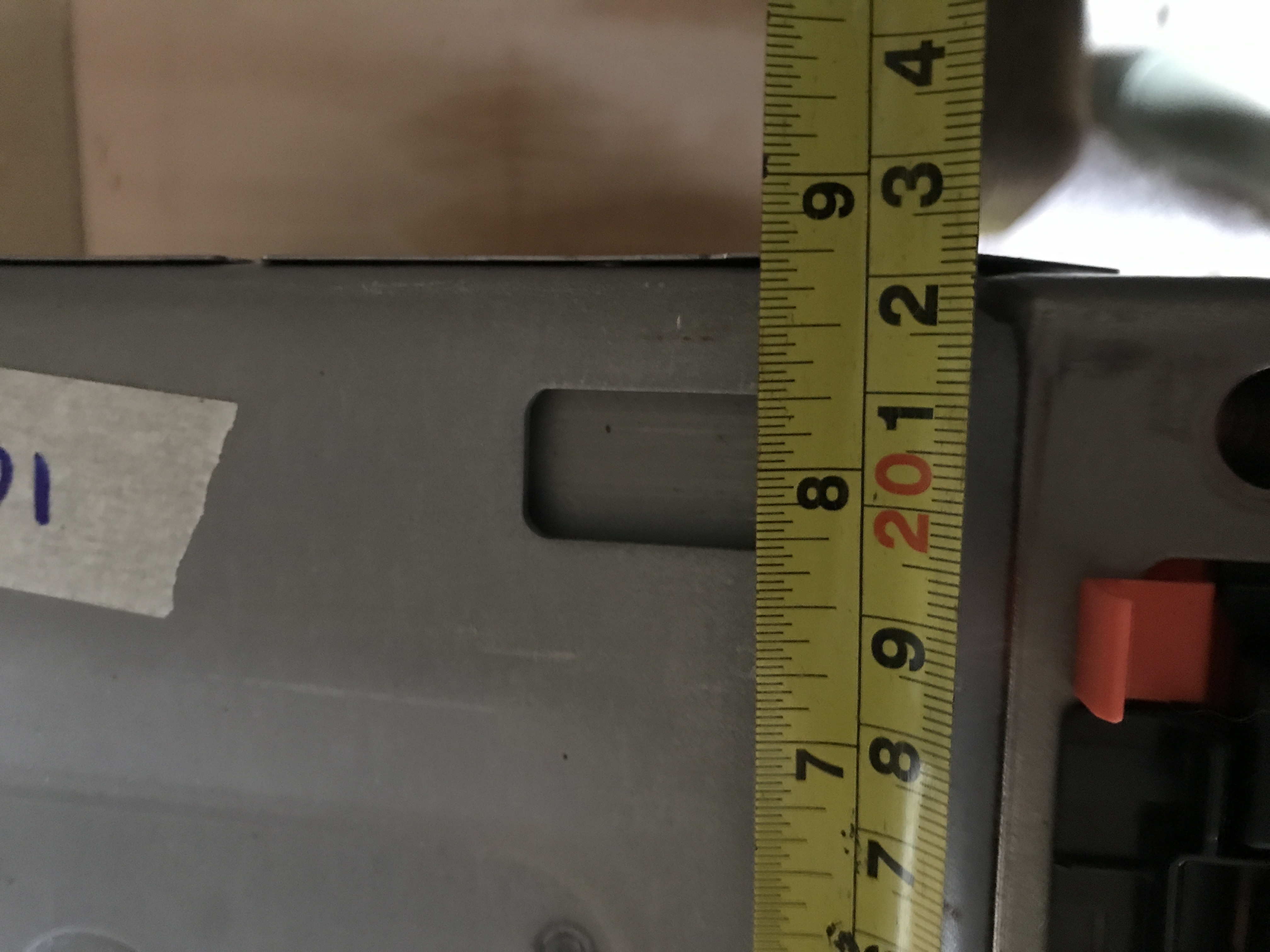

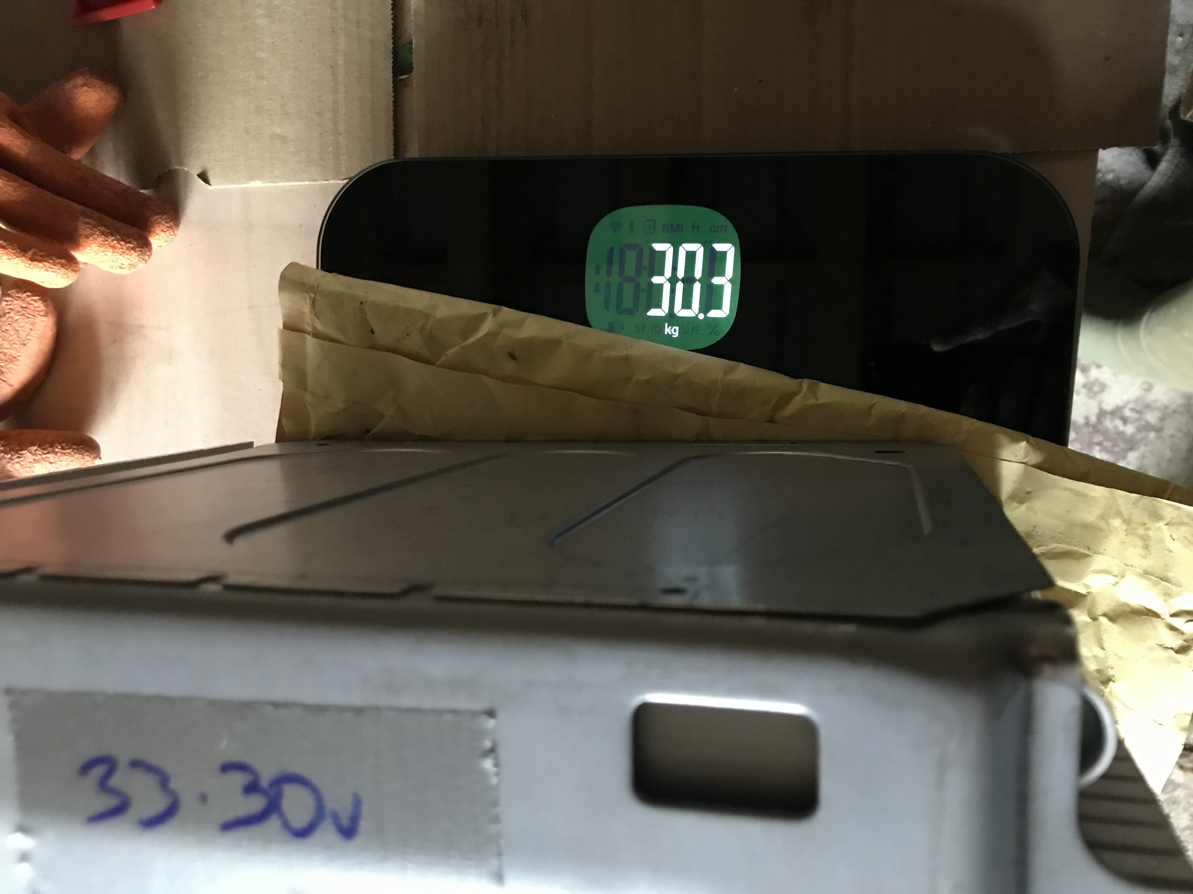

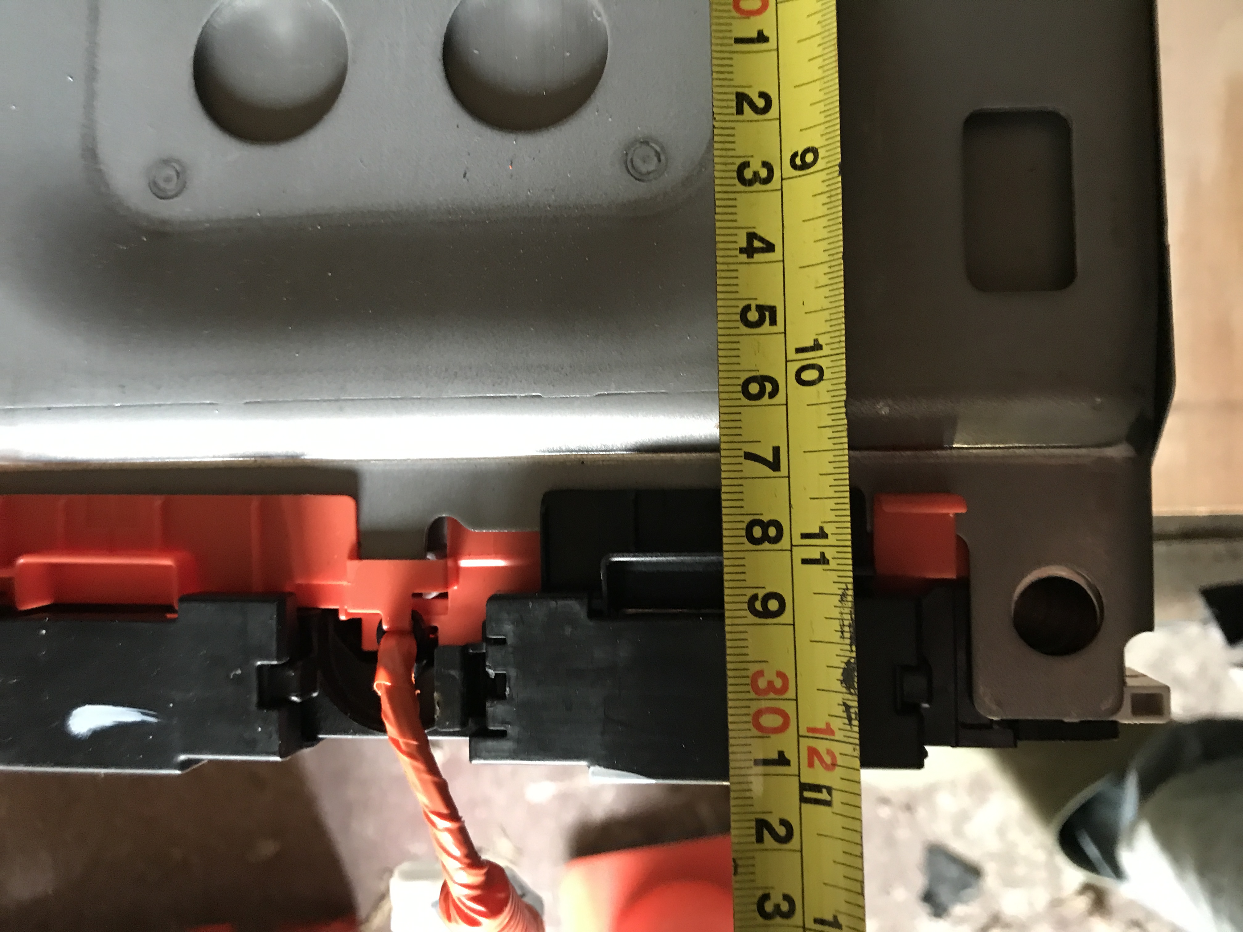

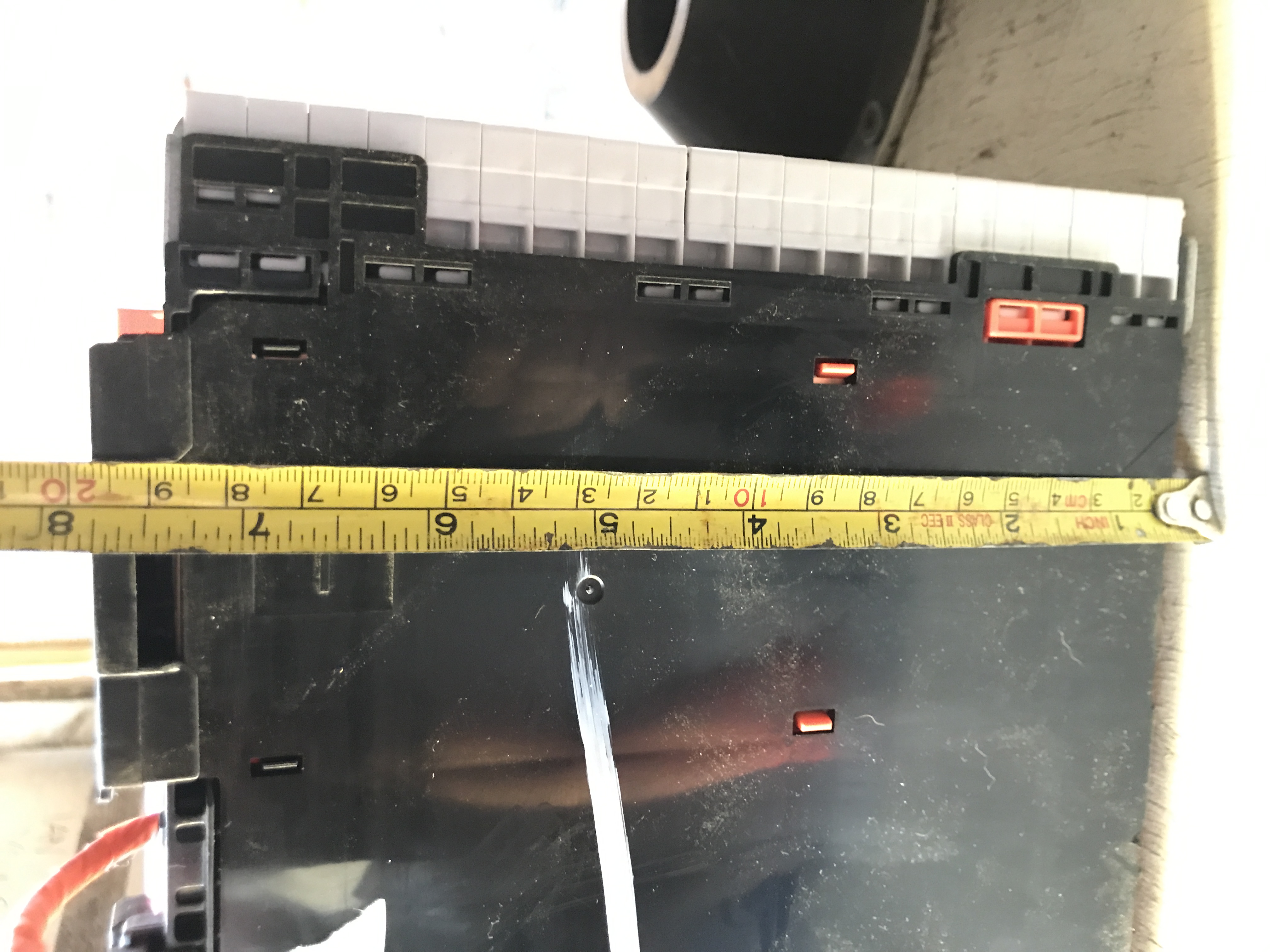

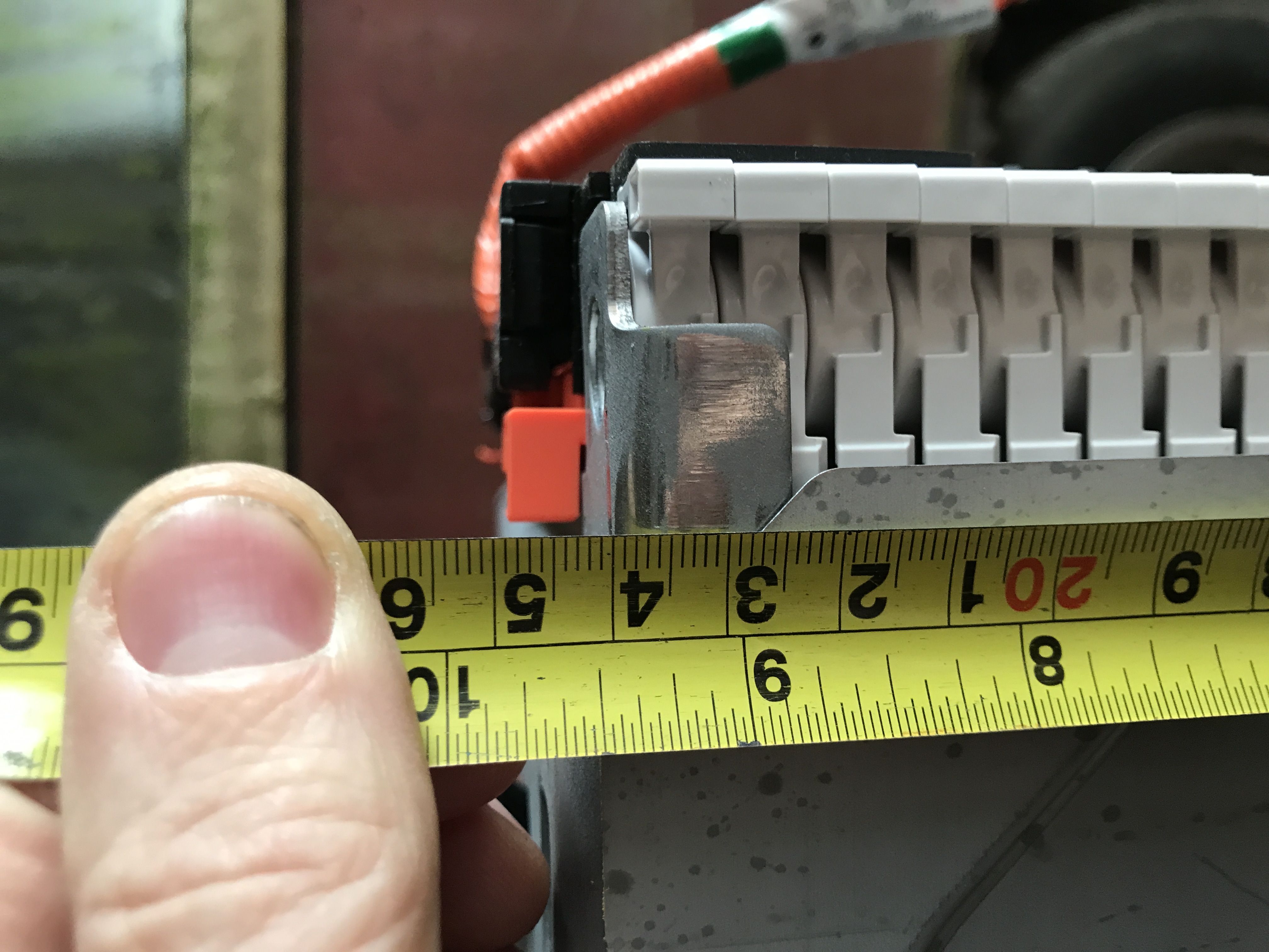

Photos showing real world dimensions and weight of one of the tall modules, 7, 8, 9, 10.
Height
Length
Width
And weight
I’ll do the other module sizes soon.

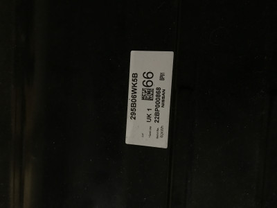

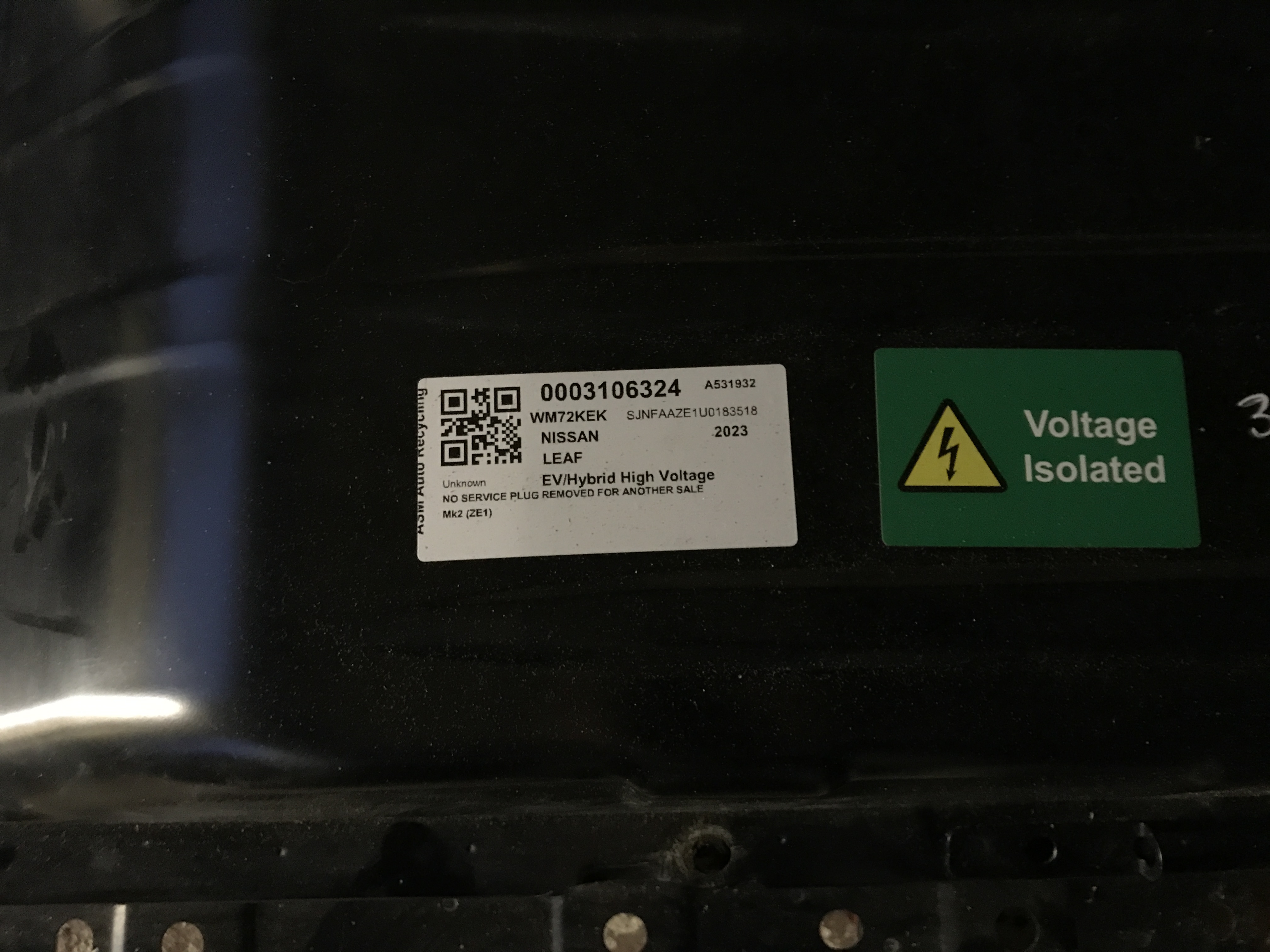

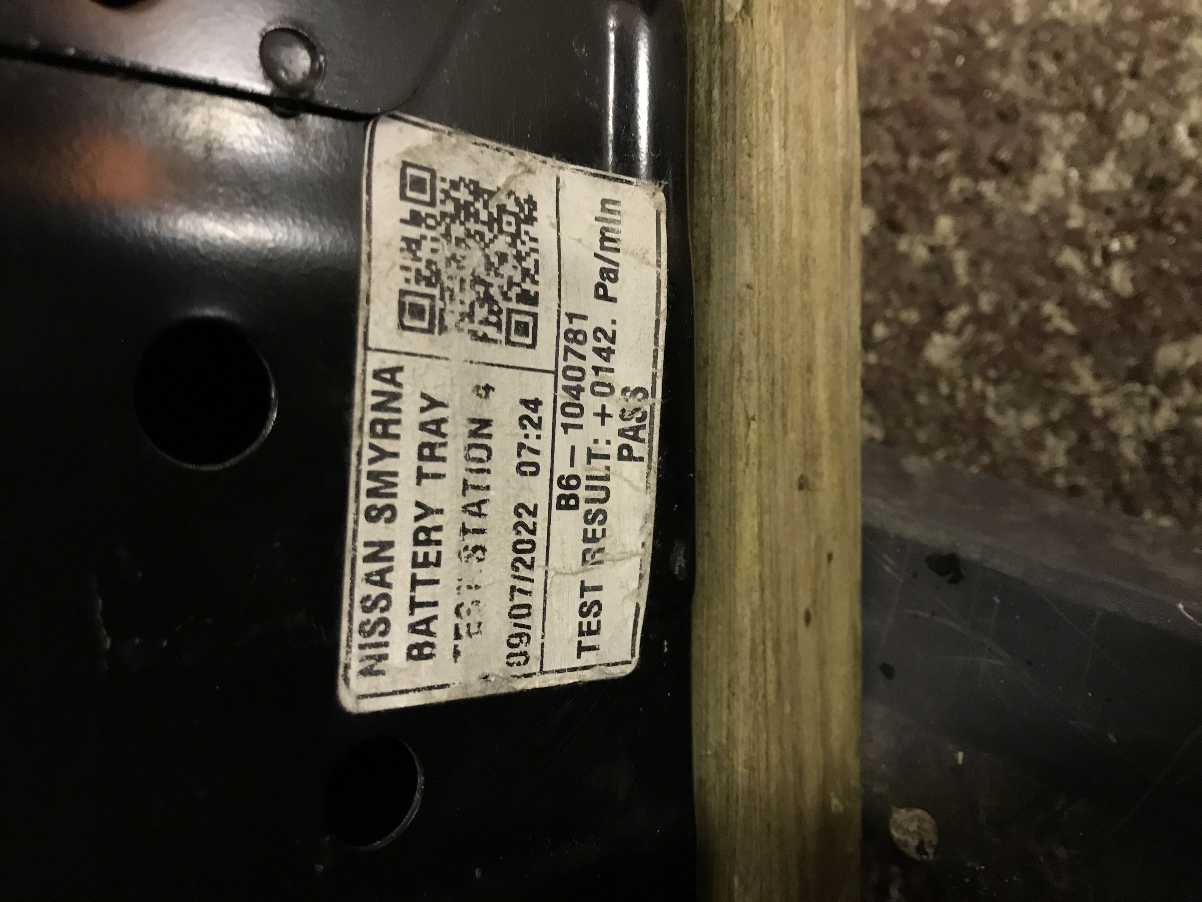

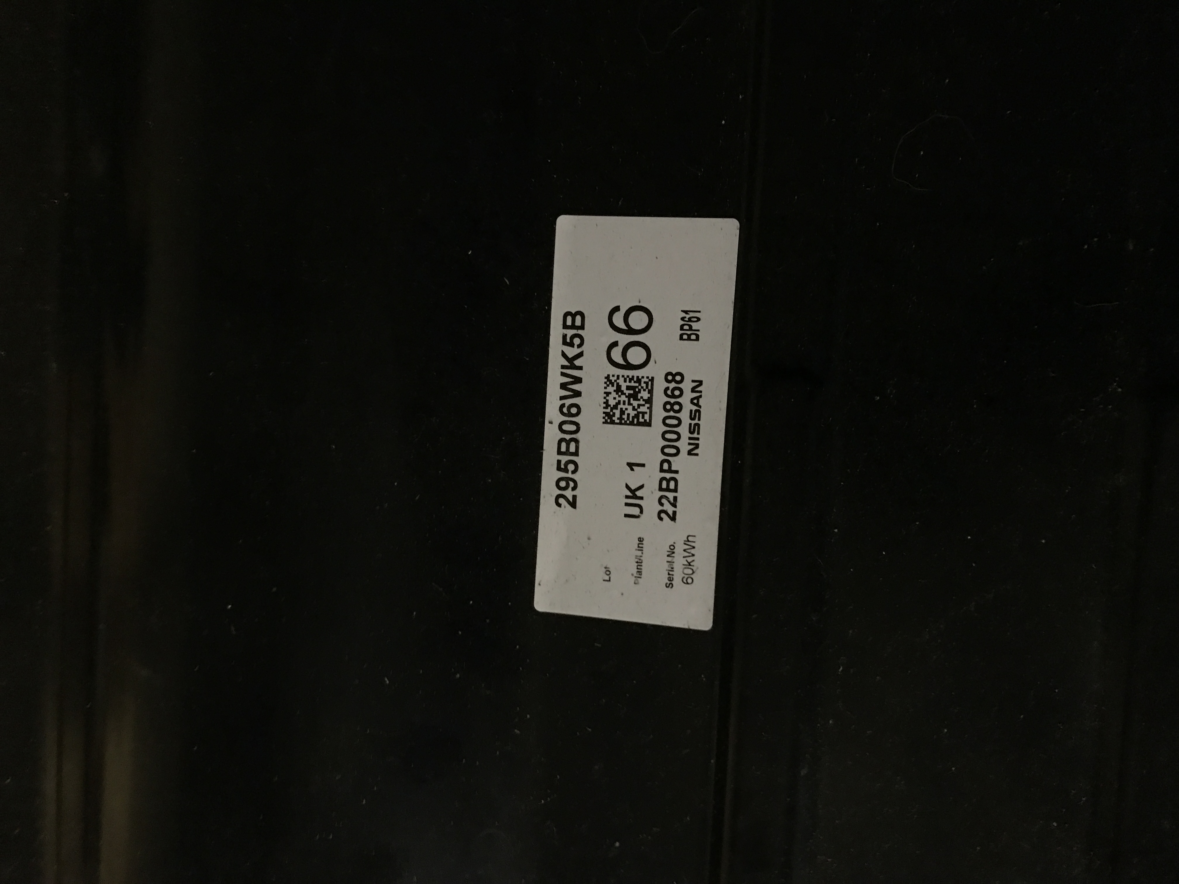

For reference, this is how Nissan labelled the pack on the outside

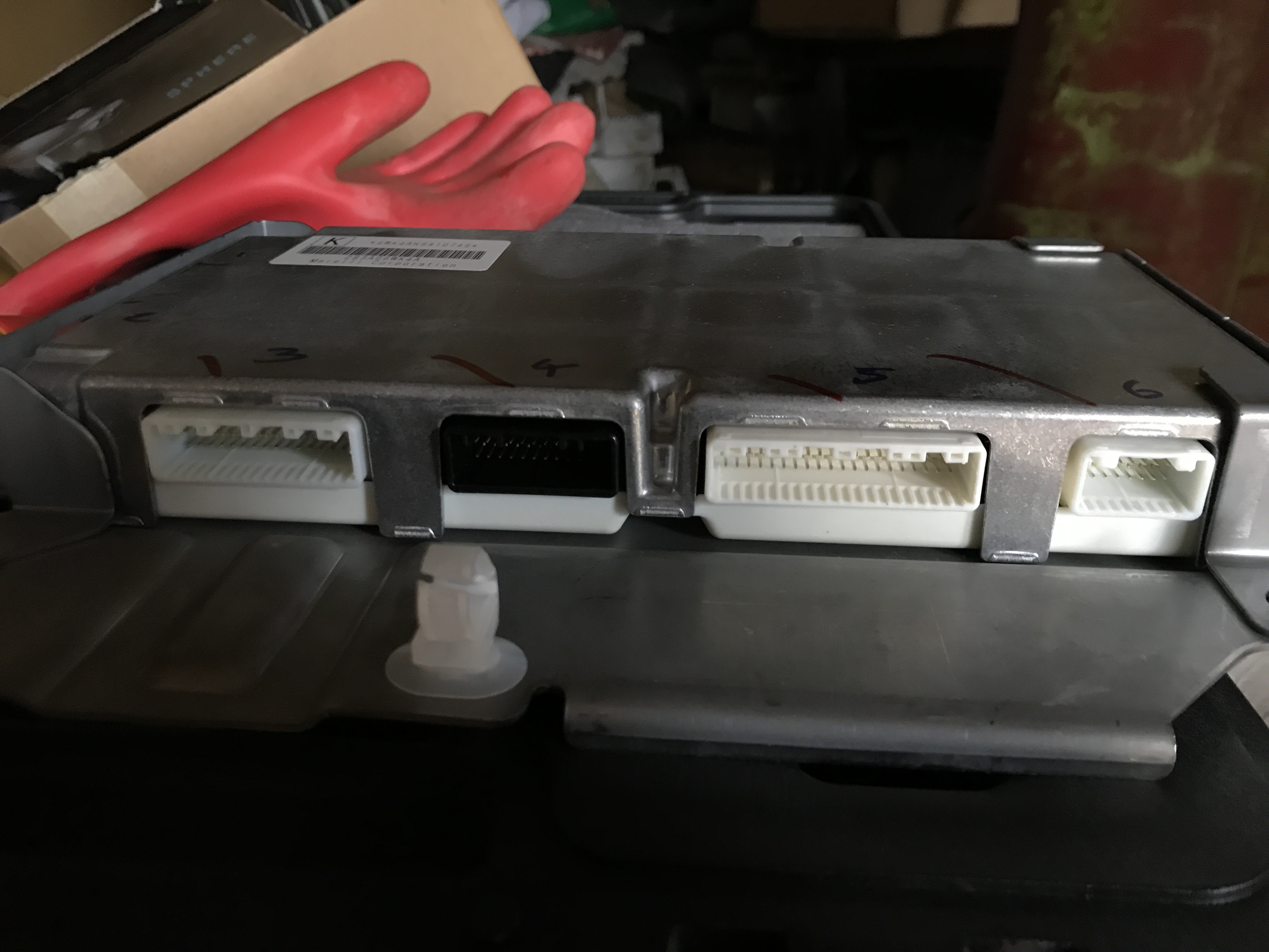

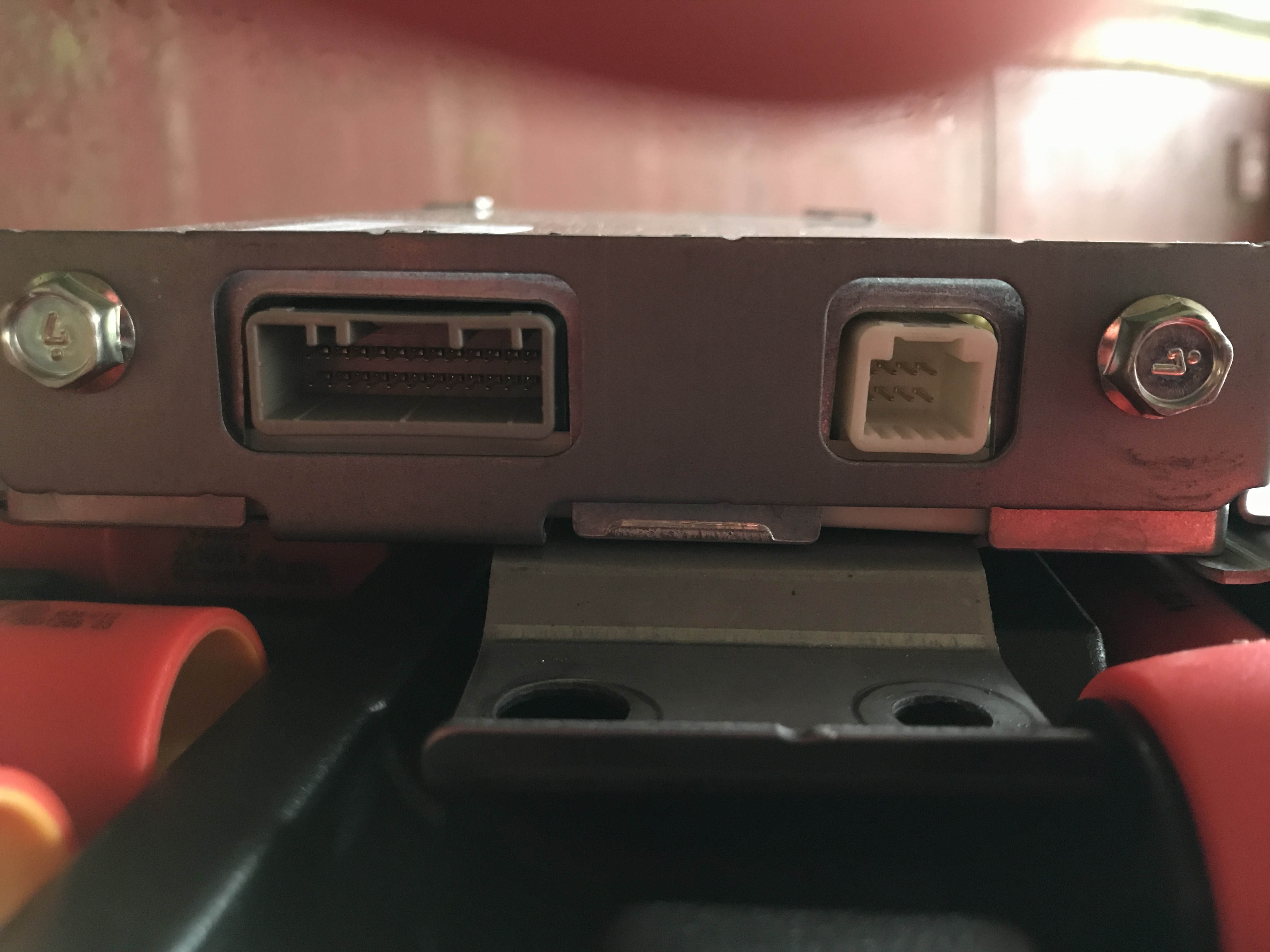

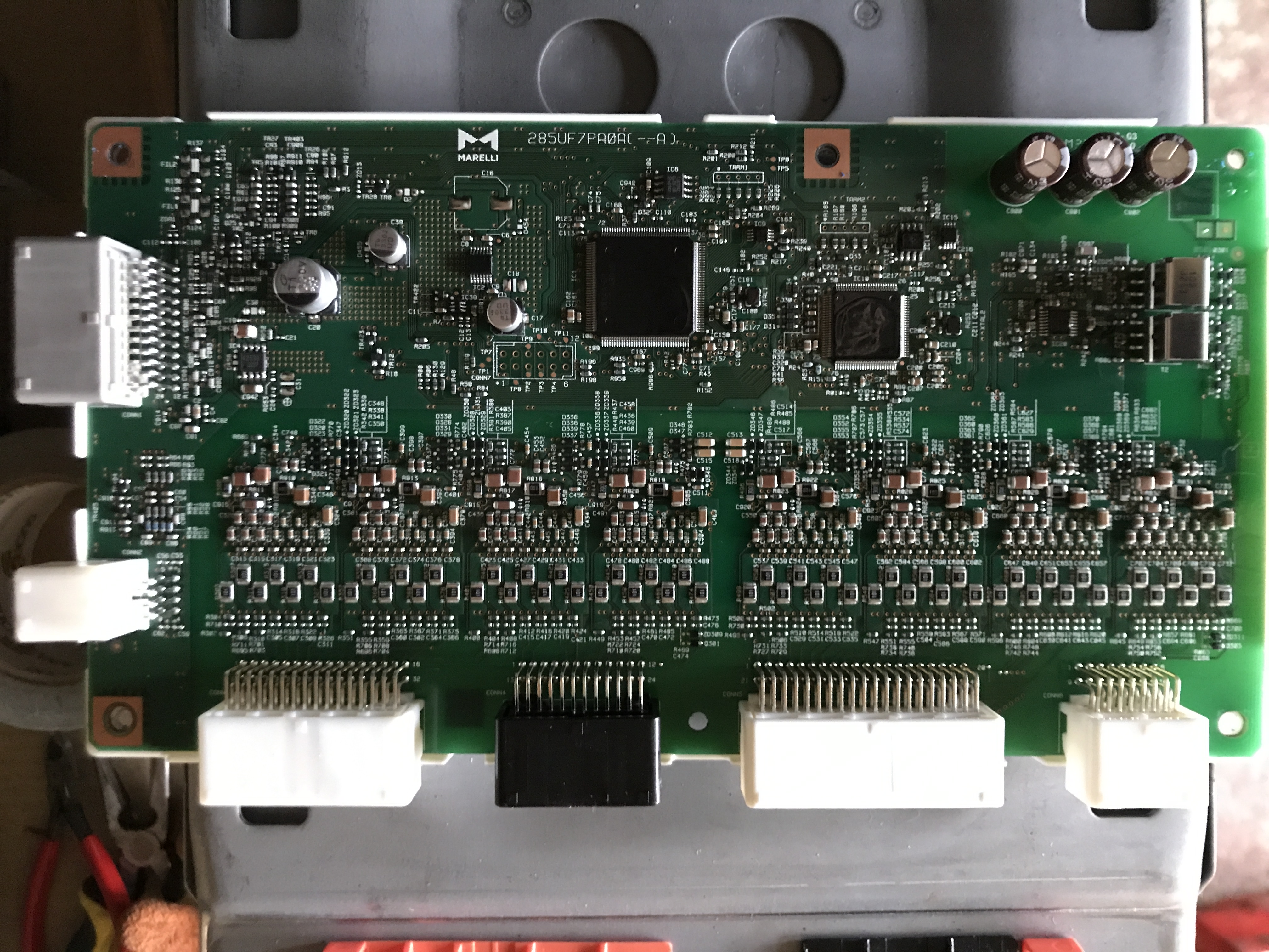

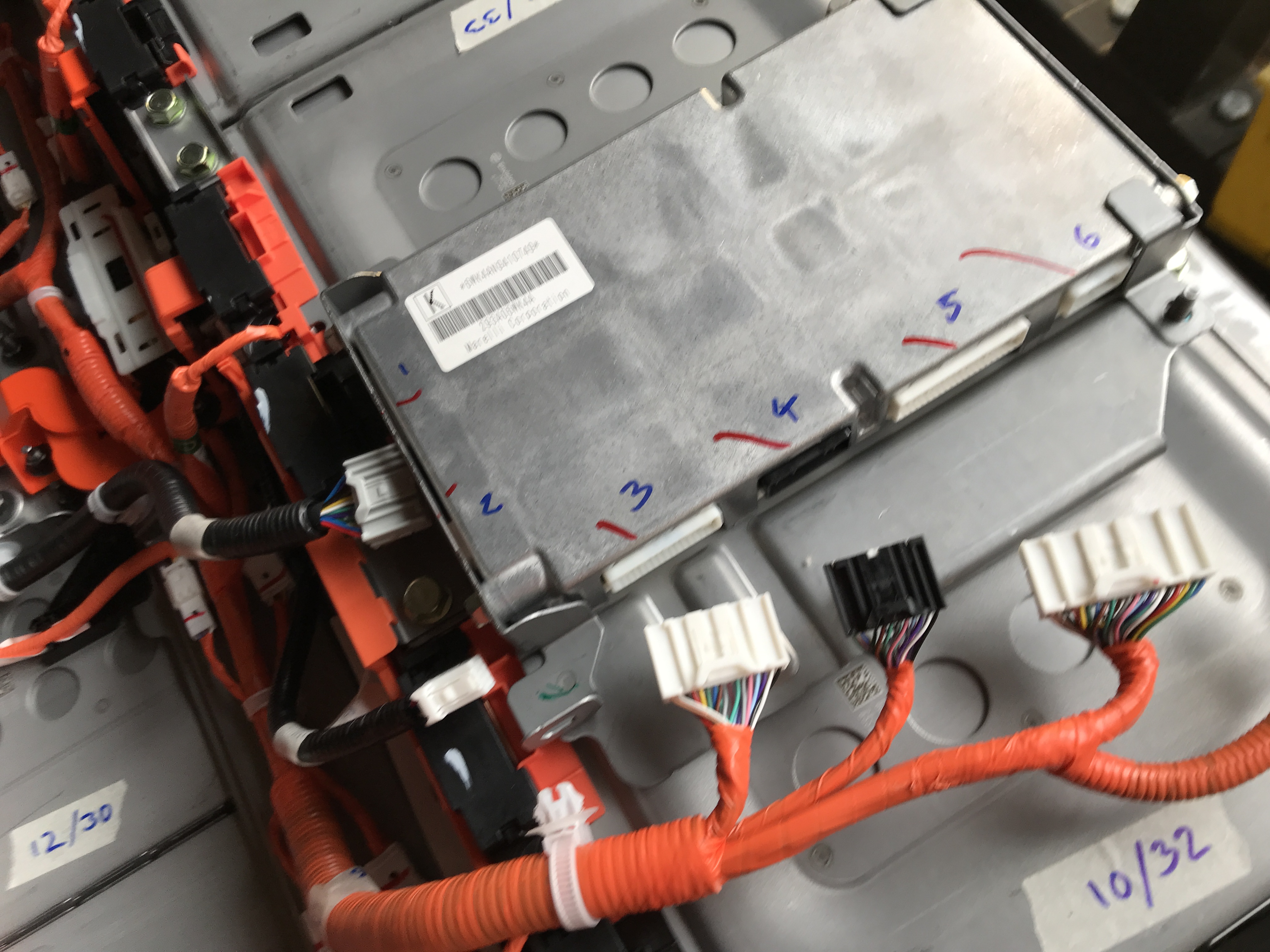

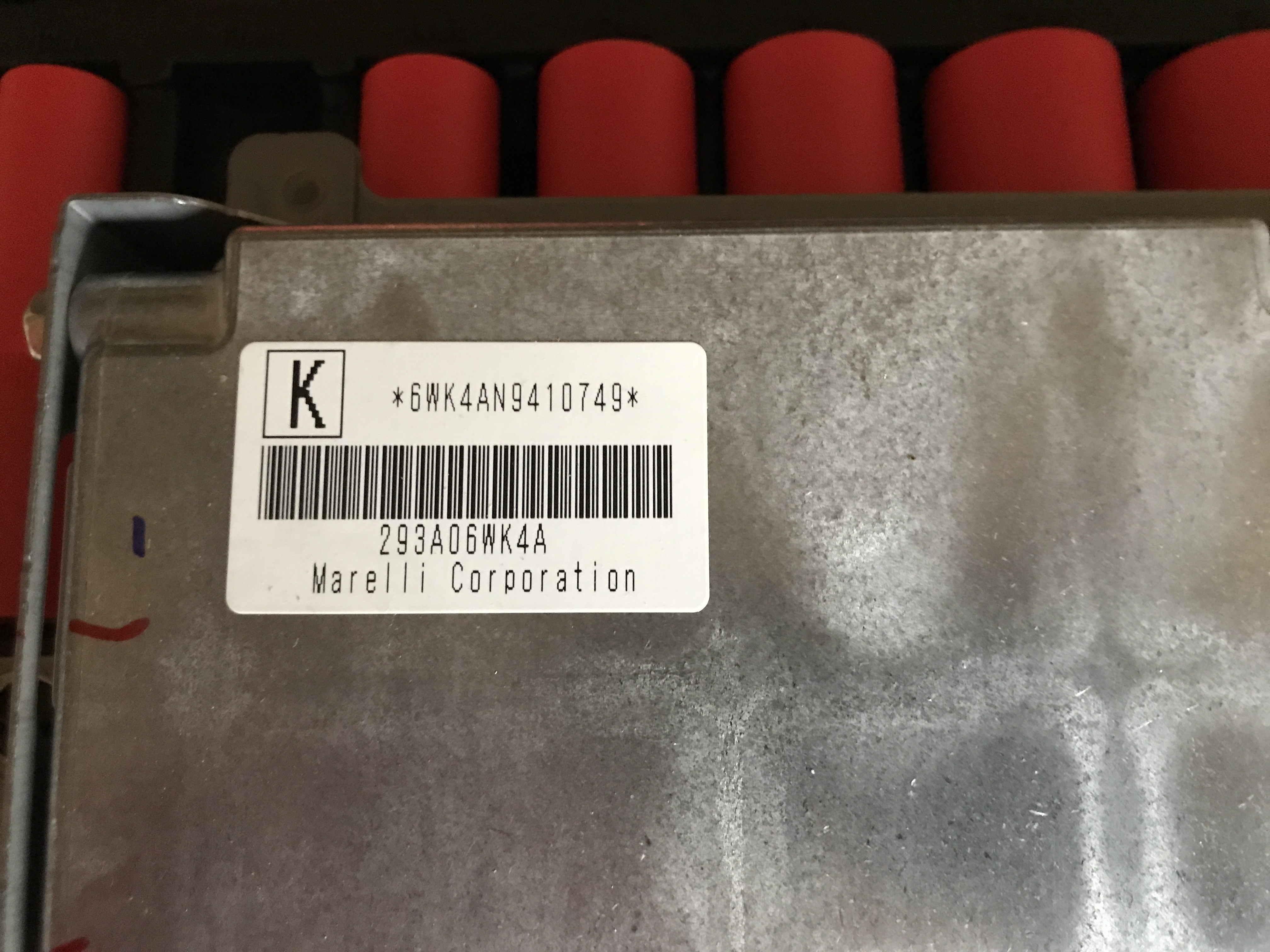

And now the BMS.

Height of tall module was shown above. 250mm. Weight 30.3kg
Height of medium module - 198mm. Weight 24kg
Height of short module - 121mm. Weight 14.8kg
So total module weight (not incl busbars, contactors, case, etc) is
4 x 30.3 =121.2
4 x 24 =96
8 x 14.8 =118.4
= 335.6 kg.

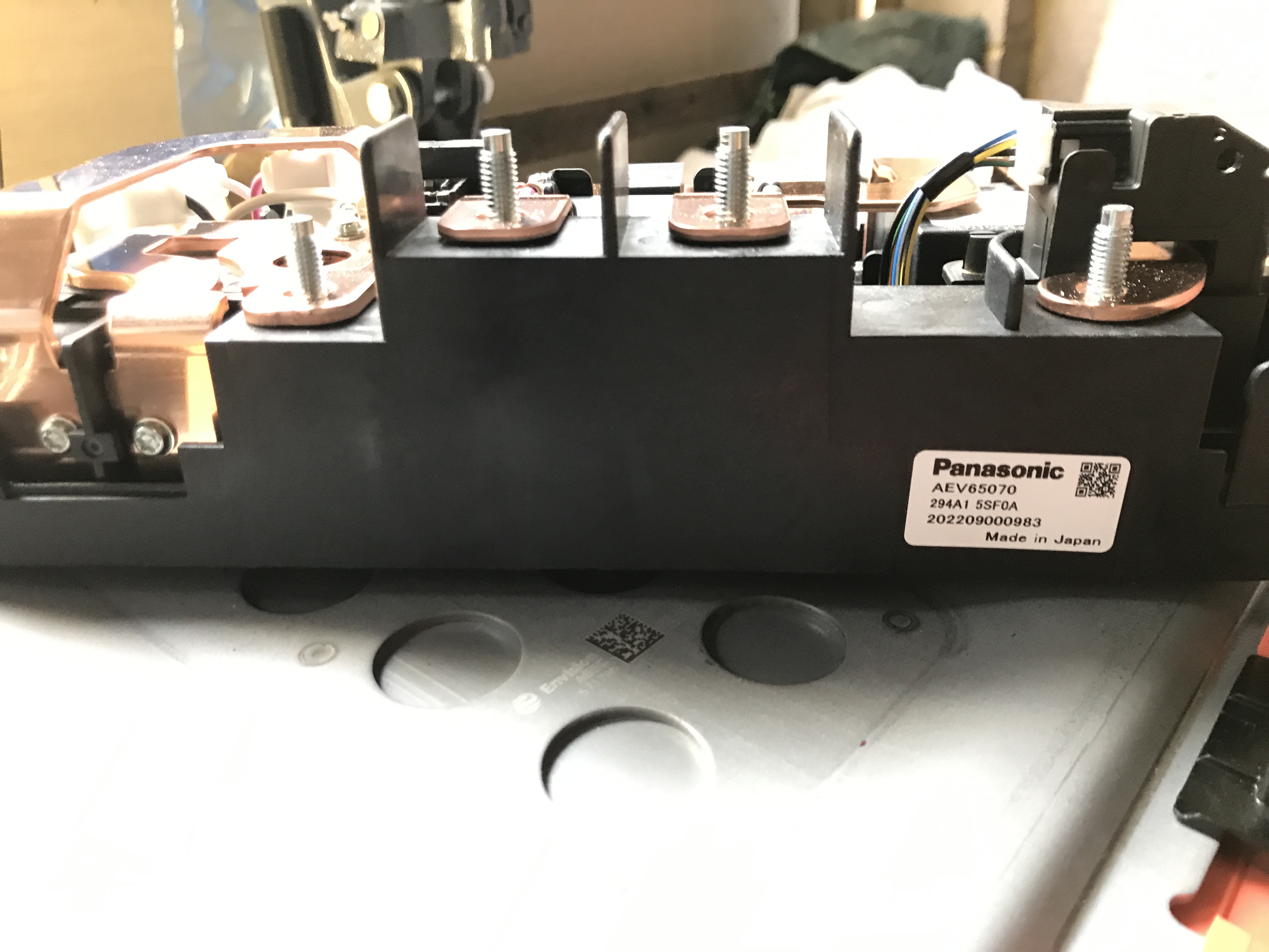

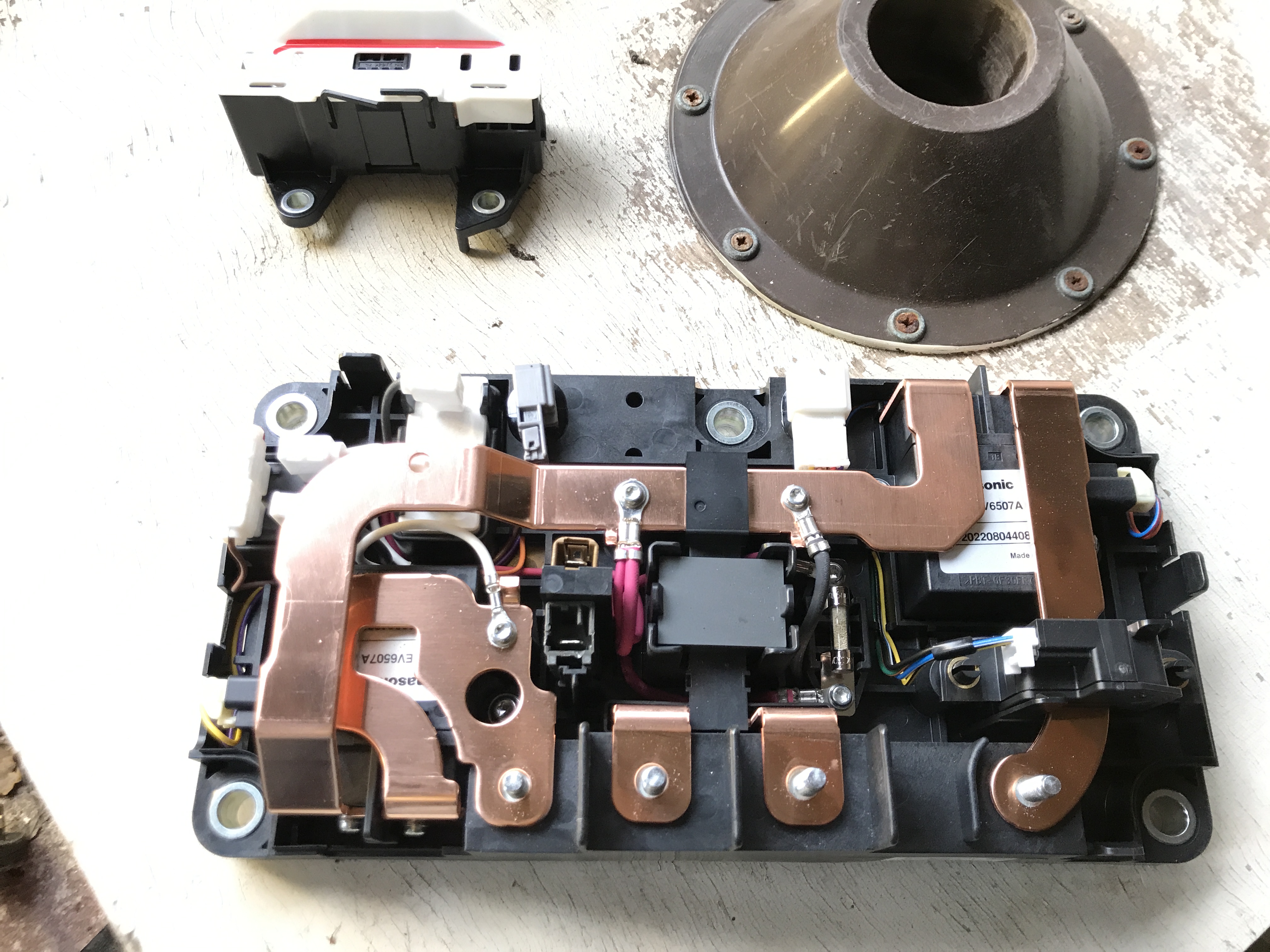

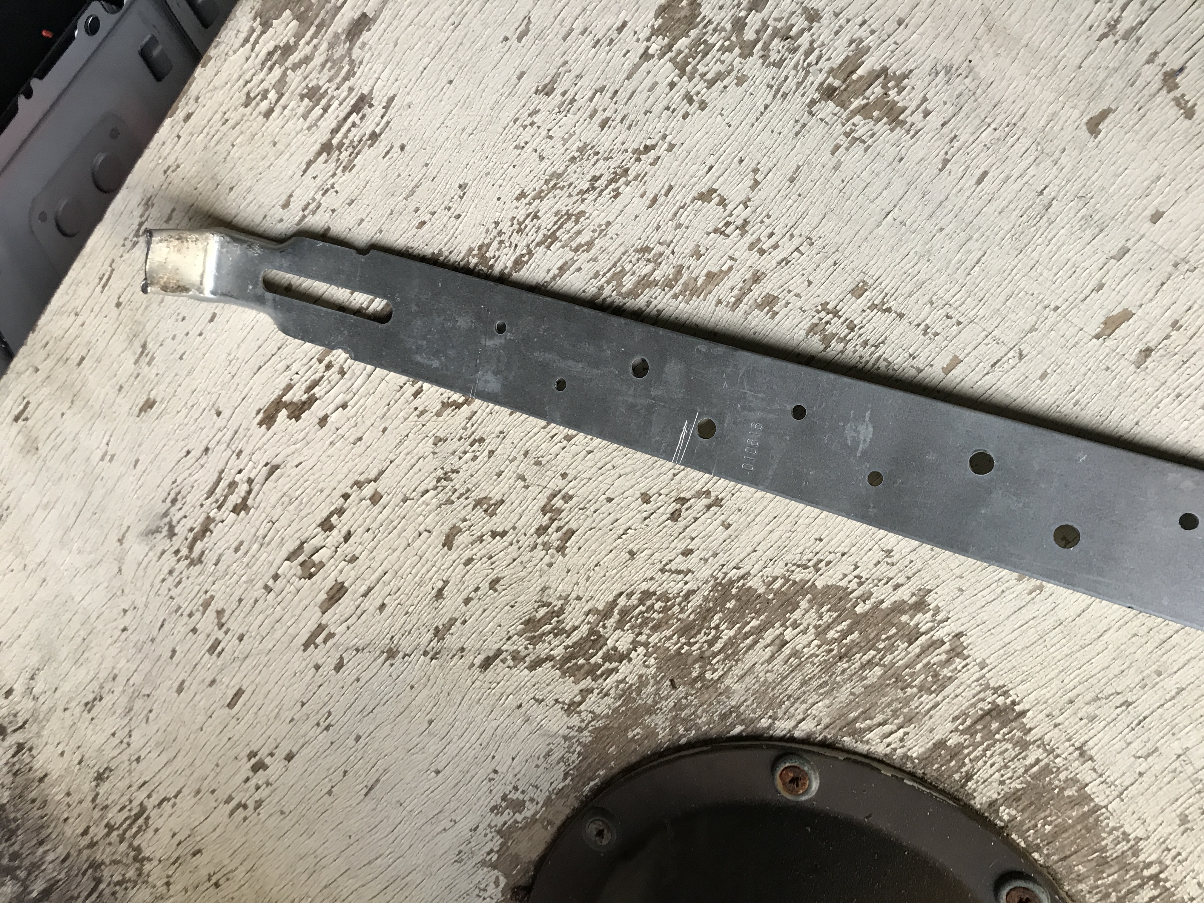

Getting the modules out of the case is a slight struggle. I found this building tie (for wall to roof) was a useful way to get a purchase underneath to pull them up.
A few of the other bits and bobs for the record…

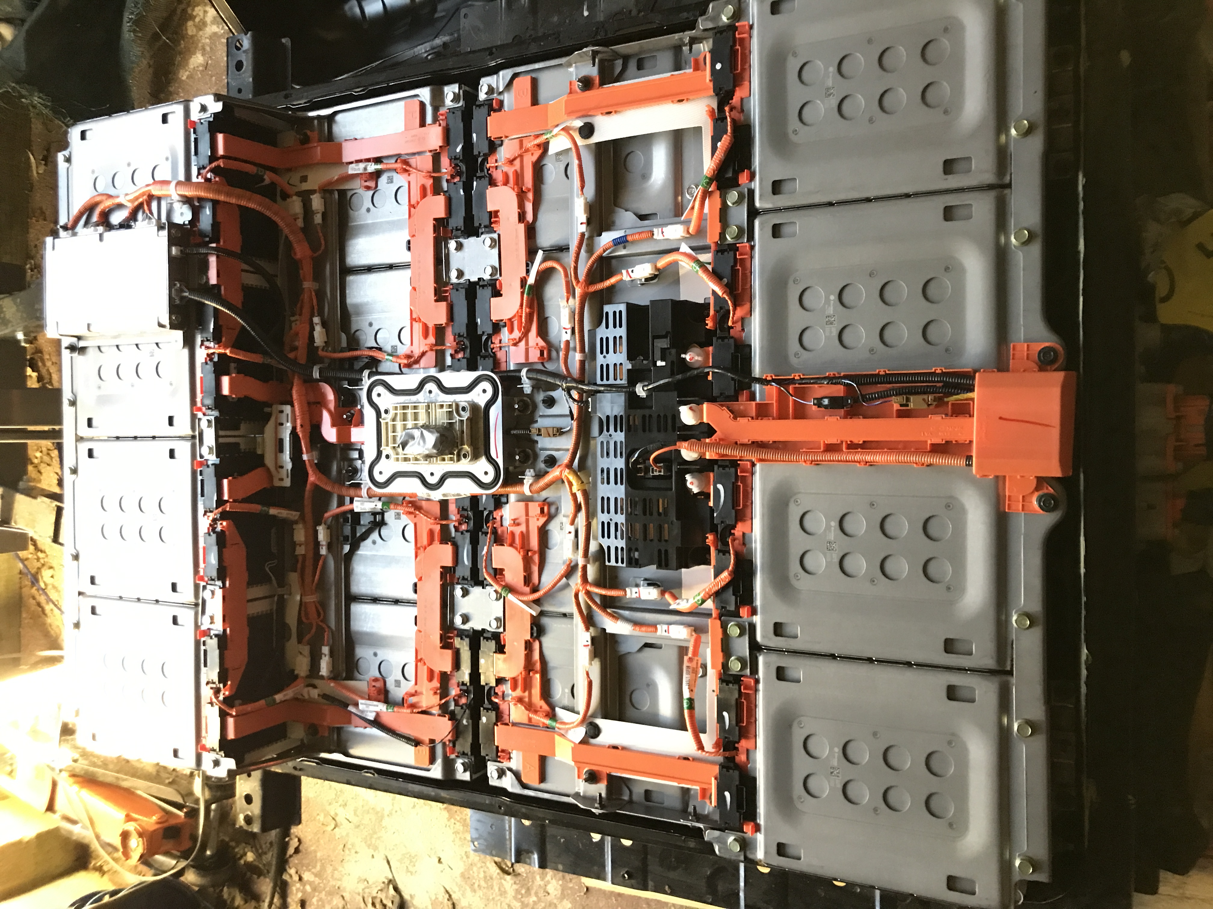

Re: Leaf 60kWh (not 62kWh) battery details
Post by ianlighting »
*Important*
The polarity of the tall and medium modules is the opposite of the short modules.

ianlighting wrote: Thu Jan 16, 2025 10:10 am *Important*
Are the modules flipped over?
ianlighting
Posts: 275
Location: Uk
Has thanked: 258 times
Been thanked: 189 times
Carbonized wrote: Tue Mar 11, 2025 9:34 pm Are the modules flipped over?
Not sure exactly what you mean. They all have the top at the top, the bottom at the bottom, but the + and - terminals are the opposite way around on the short modules.
Does that answer?
I think it’s all about the HV path through all 16 modules and always keeping any busbars to the shortest possible length. By switching the short modules polarity in this way there are no long HV bus bars.
Check out one of the first links in this thread to another post to see it diagram form which makes it clear.

ianlighting wrote: Mon Dec 16, 2024 3:30 pm Getting the modules out of the case is a slight struggle. I found this building tie (for wall to roof) was a useful way to get a purchase underneath to pull them up.
Edit - later I found that using thick cable ties was better. You can thread the cable tie through the casing from the access holes and then join them to make a handle to pull up and carry the module.
